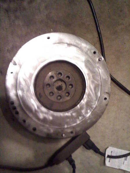

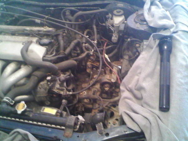

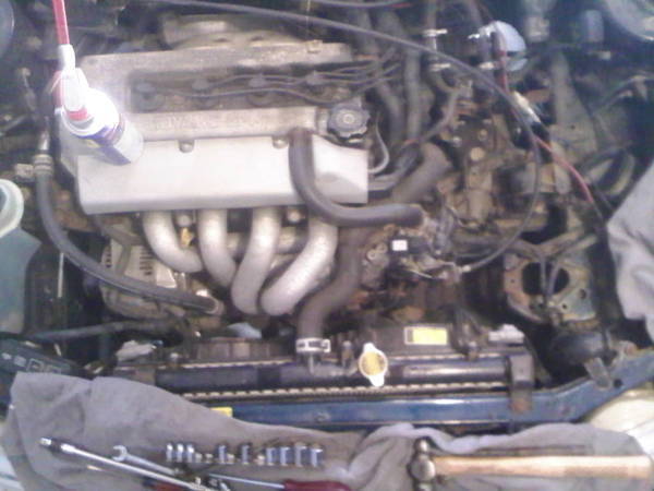

    So my clutch decided to crap out on me. It was so bad that normal driving smelled like burning clutch. As you can see in the picture of the flywheel that it has heat marks on it. This was all cleaned up before it was put back on. All I have to say is this has been the biggest pain in the ass for everything I've done to cars before.
    Taking everything apart-
    New clutch assembly-
    Flywheel before getting cleaned-

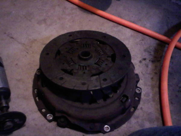

    Old clutch and pressure plate-
    I am pretty sure it is the stock clutch and throw out bearing, because they were made in Japan. If this is true then the clutch had roughly 156,000 on it. I knew when I bought the car that the throw out bearing needed to be replaced, just did not think the clutch was that bad.

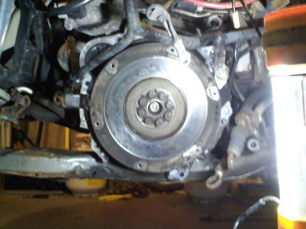

    Alright, my dad and I finished putting everything back last night at about 11:15 last night. This has taken what seems like forever, but saving some money on labor was probably worth it. It took us roughly 21 hours to complete. Using 2 jacks, 2 jack stands, air tools (impact, ratchets, grinder) and hand tools (screw drivers, ratchets, wrenches, breaker bars, and pry bars). It took longer because we did not have a socket to take out the nuts that hold the C/V axles into place, and with the car being 13 years old, a lot of bolts are rusted or corroded into place. I have 2 more pics, 1 being the cleaned flywheel and the other after we got the transmission back into place.
    Flywheel-
    Transmission back into place-

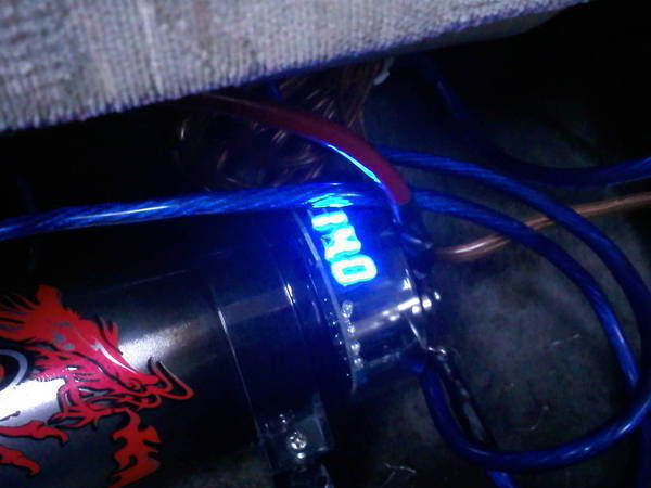

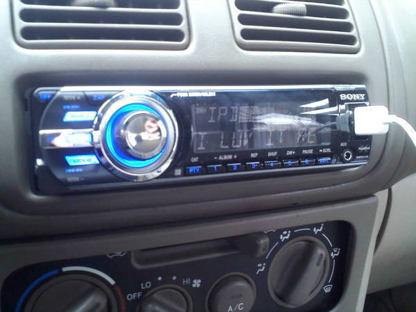

    I put my capacitor in about a week and a half ago. I really like it. No more dimming lights and the bass seems to sound a little better. I also realized i forgot a picture of my new radio so I put that in, even though I got it for christmas.
    Radio-
    Capacitor-
