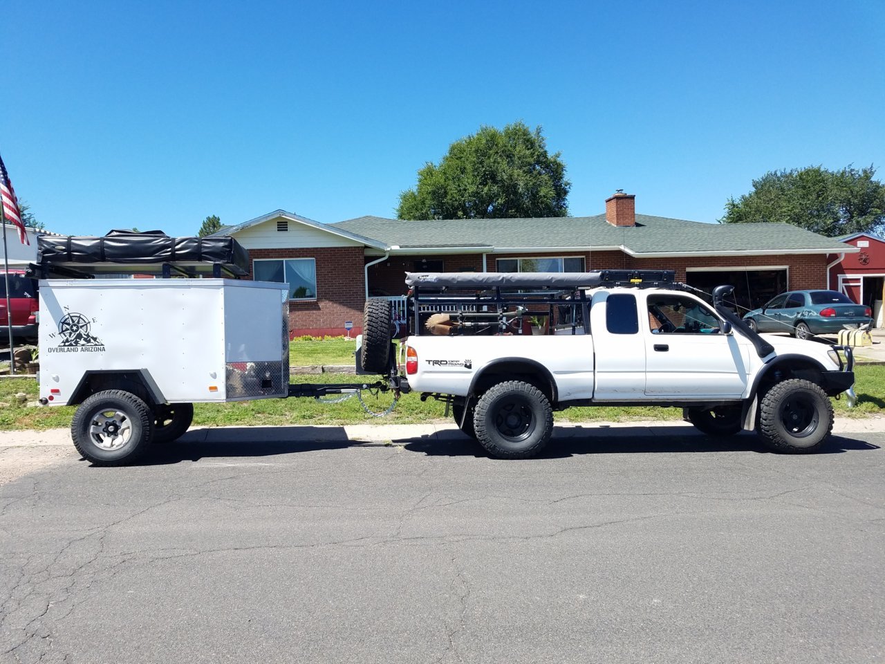

    Would you say this is a trailer friendly trail?

    The majority of the sections 1 & 2 that we ran are most definitely trailer friendly with open road/trail. There are a few spots on section 2 that goes through Las Cienegas NCA that might get a little interesting for pulling a trailer but I think they should be doable. There were some tight spots with dirt walls one each side and some fairly tight turns. Might take a little work to finagle the trailer in those areas. Also lots of low, overhanging branches in a few spots that where sweeping the snow off my roof but I don't recall them being large, thick ones either. I think we can find bypasses for most of the spots, if we need to. As for the other sections, I have no clue yet as I've never run them. I'd say bring the trailer, there will be plenty of us there to help get it though any problematic spots but there shouldn't be many of those and they might not be problematic for you anyhow.
