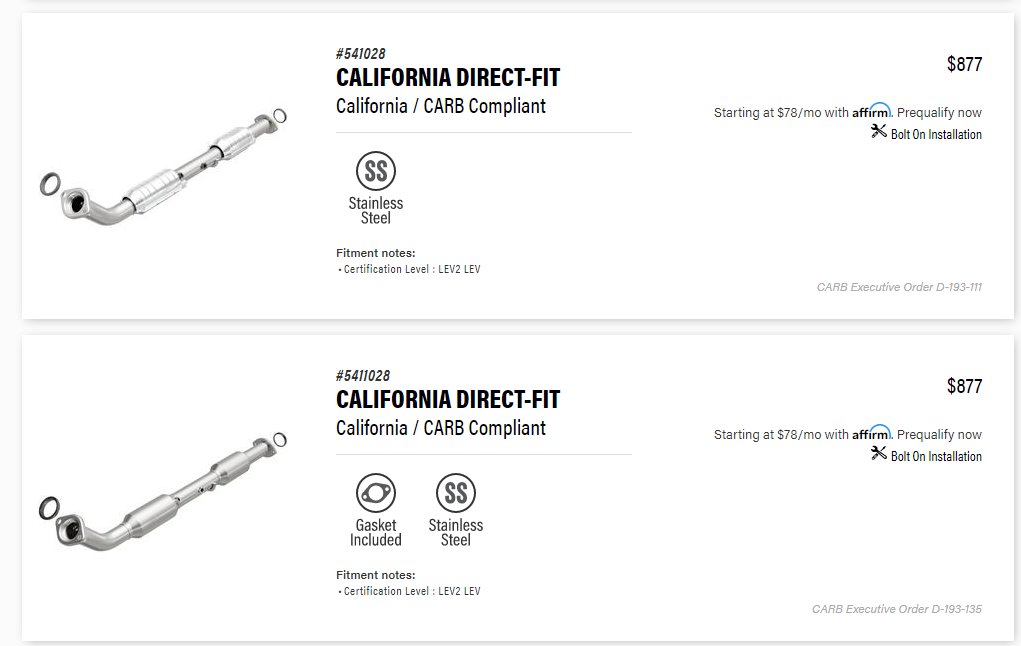

    I am going to get one of these two but I can't figure out the difference aside from one being smooth and the other having visible heat shields. Any idea if the smooth one has heat shields built in as well? It appears to be a newer model and i'd hate to have to buy a separate shield for both parts.

    I would bring this to shop asap (if you can't do it) and have the cat back pressure tested. They have fittings that screw into the oxygen sensor ports and you can measure the input and output pressure across the converter with a gauge. $877.00 is a lot of money to spend on a guess. I'd even disconnect the exhaust first and see if it makes any difference.

    The price is not $877. That was on magnaflow's website. I am looking at $800 or less. I found one at $570 that did not include California on it's option to ship. I'll call Monday. I really hate my state BTW!!!

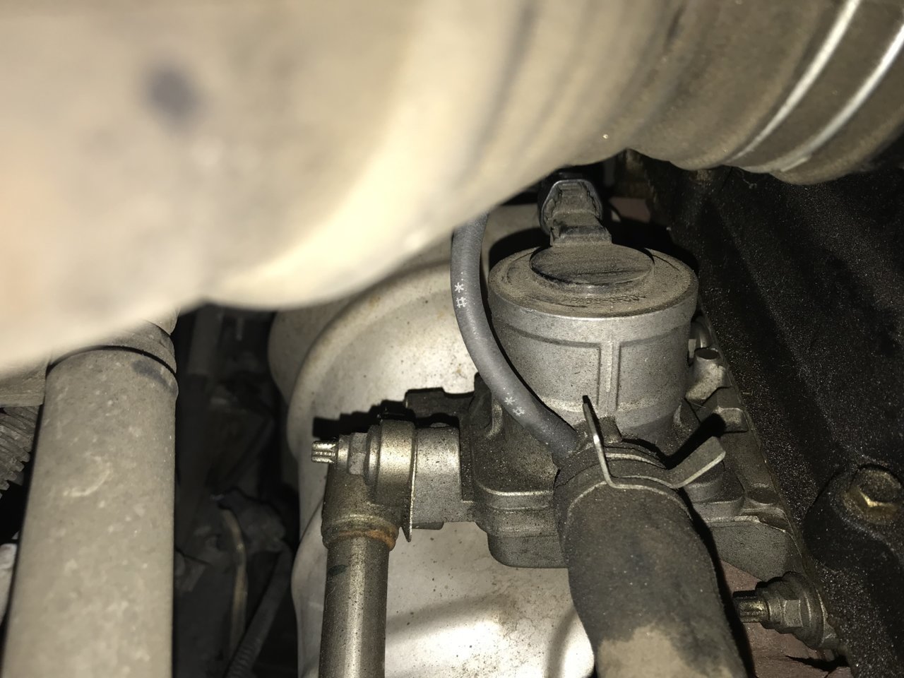

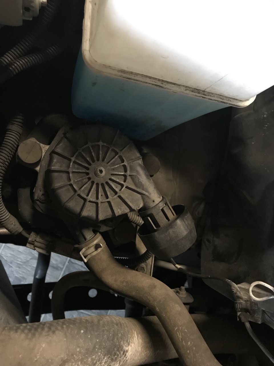

    Here are the two injection parts on my 2.7:

    Unbolt the exhaust pipe from the manifold and go for a (noisy) test ride.
    If the problem is a clogging cat or even muffler, this will relieve enough pressure to let it run well.
    Your symptoms also describe a clogged fuel filter. At least on older vehicles. Not sure if the Tacoma has one that can be replaced outside of the tank.
