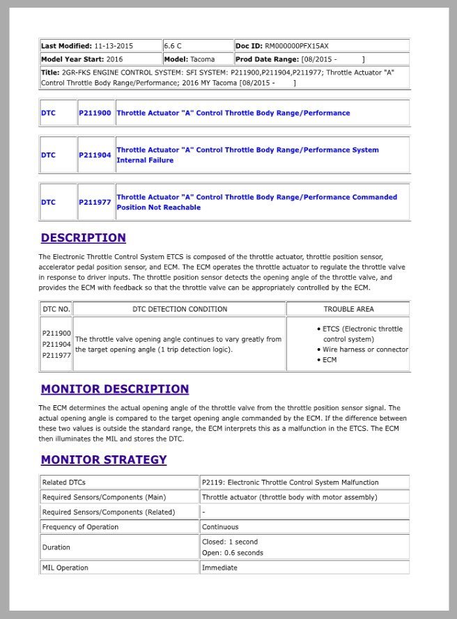

    Early M/T trucks on the 04B10 ECM calibration could definitely have problems if the settings are too aggressive. IIRC what is stated in the service manual, the ECM compares the change in accelerator position output to what the throttle is actually doing. If there's too big of a difference, a code will set and the truck will go into fail safe (limp mode). You do NOT want to be in limp mode, especially with a M/T. Ask me how I know lol.
    Edit: The code that caused limp mode in my case was P2119XX.

    Race settings in the upper range are pretty aggressive. I can see how a sensitive ecu in a M/T might mistake it as a sensor fault. If it see's the TPS signal moving way faster than it should but... you probably wouldn't want it set there anyways and it'd be an easy fault code erase ( I'd think)

    Yeah, but you just know someone is going to try it lol.
    The thing is, if it happens in traffic well you're in for a stressful time until you can safely pull over and correct things. The truck has almost zero power in fail safe mode.
