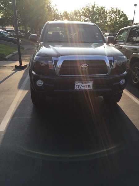

    Here's how they look:
    Off. Passive Amber demon eye
    Marker Light setting (I have Amber marker lights, but they weren't in when I took the photo)
    There's a white halo, an amber halo, and an active amber homemade demon eye
    Low Beams on w/ fogs. Looks SICK at night!

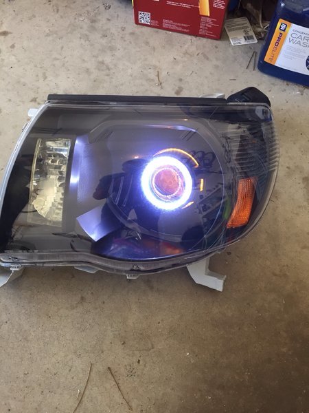

    Just curious, how is the headlight powered in the pic showing just the halo and sitting on work bench?

    I have mine powered with a computer power supply. But you can use car/bike batteries

    Yeah I wired all of the lights to splice into the marker light circuit and just contacted the main wires to a 9.6v drill battery

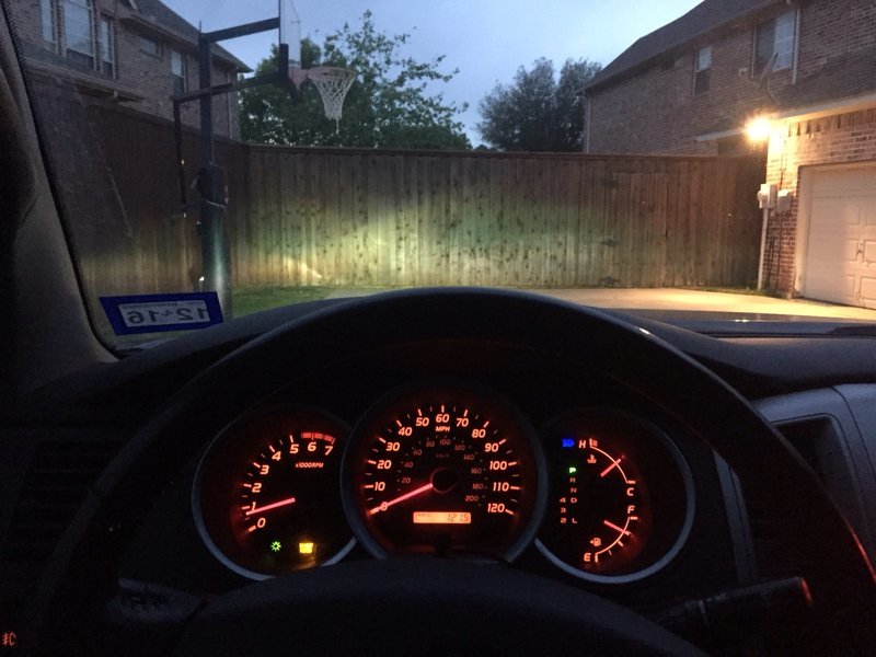

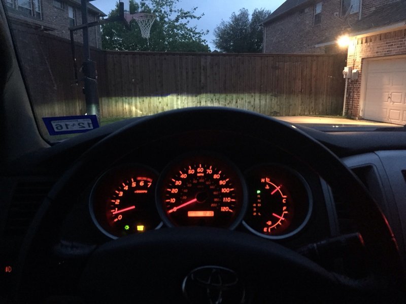

    Kind of a crappy, photo taken at dusk, but here is a picture of the light output. These headlights are very powerful in my opinion. Stronger and sharper light output compared to stock headlights with stock bulbs. Smooth color flicker effect that is visible when you drive behind a car and hit a bump in the road, flat and wide projection, no glare above cutoff like what you'd find in an aftermarket all-in-one headlight (I even had my "fog lights" on when I took the picture. They spew light everywhere with no real cutoff). Some may complain that the width of the beam and the crispness of the cutoff is not on par with the morimotos, and I'd never know, I've never owned morimotos, but for someone like me who was desperate for the retrofit look and output without putting my wallet on weight watchers, I couldn't be happier. From the rave reviews of the Morimoto products and The Retrofit Source's service, I would definitely go that route if I had the money, but I don't, so this is what I got!
    It's also oil change time :)
    Low Beams:
    Hi Beams:

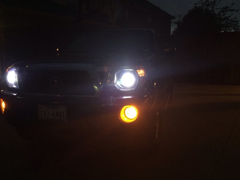

    Got any photos of your truck at night showing off them lights?

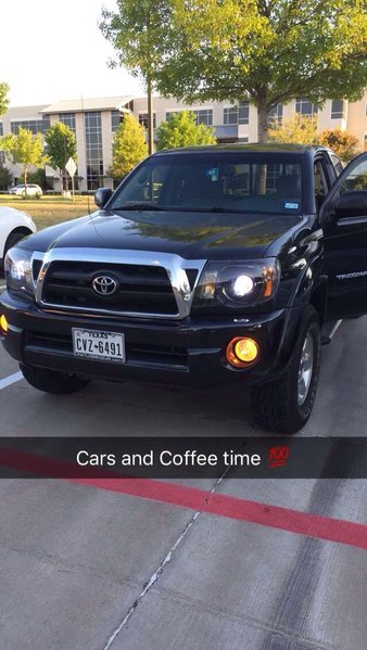

    This iPhone camera just isn't getting the job done for me at low light, but this is the only other photo I have of them. Also, agreed on the off-roady bits for the prerunners. These things will get stuck in a heartbeat without locker/LSD's and other gear
