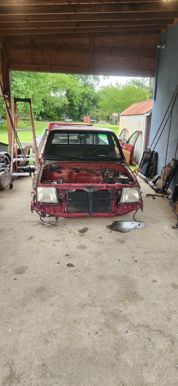

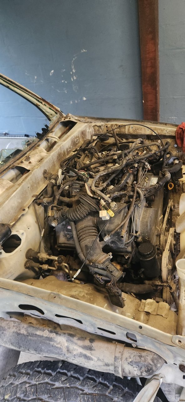

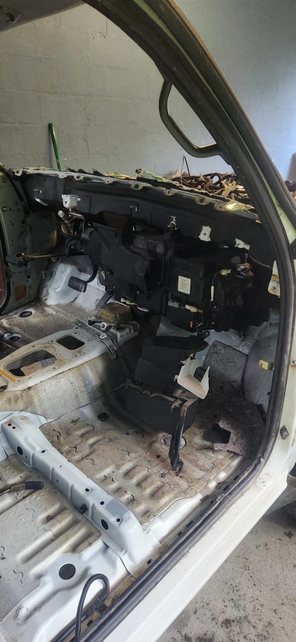

    Here is an earlier picture of the donor truck. This was last weekend when we started pulling the goodies from the doors. Power windows and locks are a nice addition.
    Today we finish striping the interior of the wiring harnesses and getting the motor prepped to pull maybe tomorrow.
    Debating if the best way is to remove the cab or pull the engine out the old fashion way. We have removed 90% of the weight from the cab so we might try the cab lift.

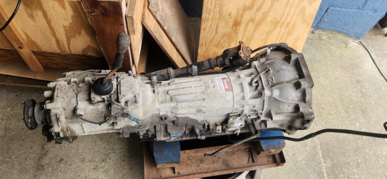

    Here is the 4x4 transmission, transfer case and front driveshaft that I picked up at a junkyard.

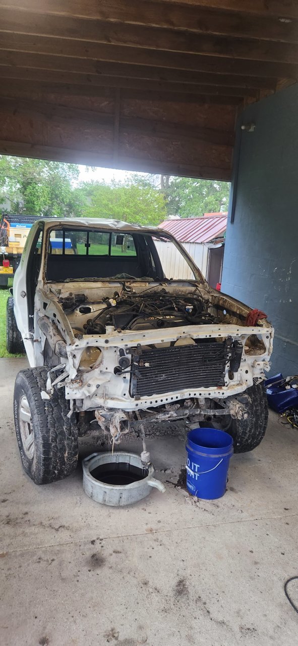

    Work continues slowly as I'm awaiting several parts.
    Took the cab off the truck for easier access to removing the drive train. Sorry for the crappy picture.

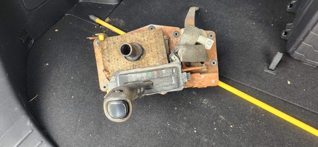

    Went to the junkyard and found one of the many pieces I need to make this conversion. The 4WD/Auto shifter. Needs some TLC but I think it should clean up nicely.

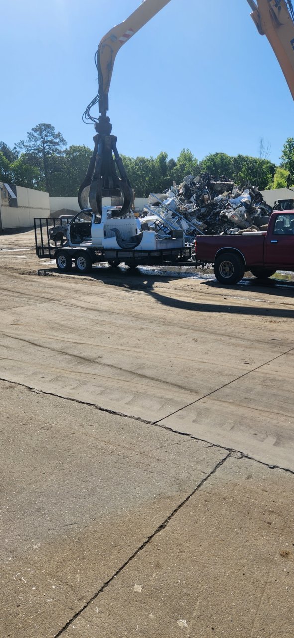

    And finally making some money back. Took the body in for scrap metal. Didn't make much, but it paid for some new gaskets/filters for the V6.

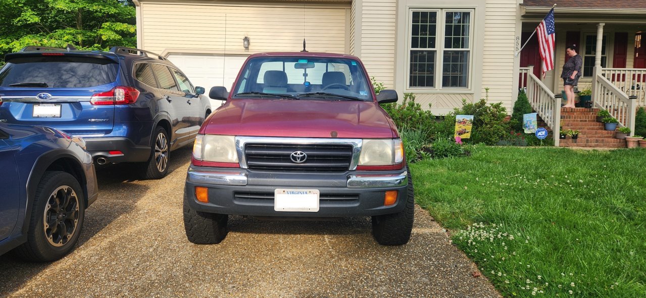

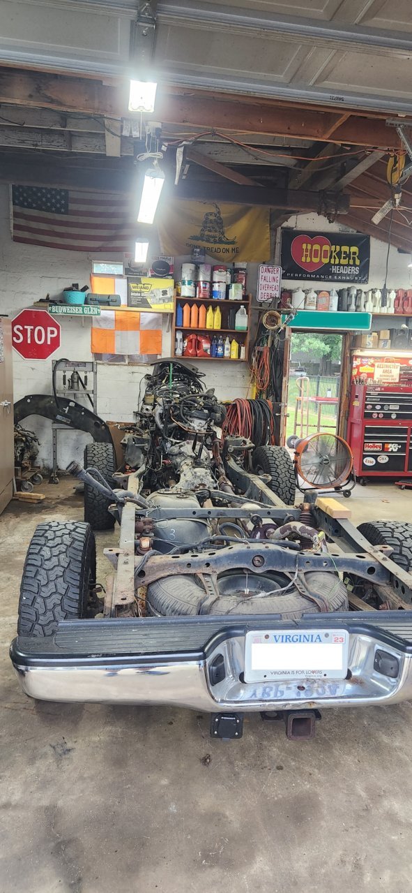

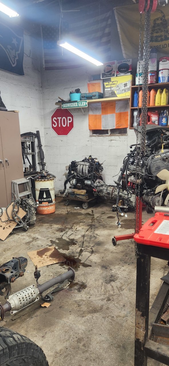

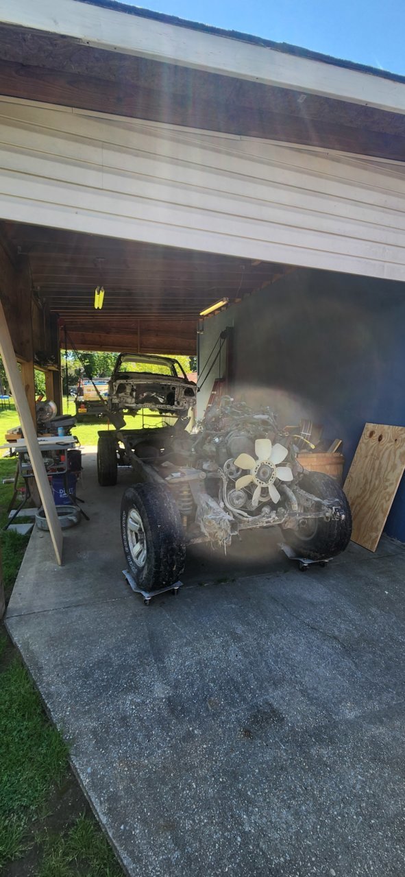

    Today was the day that I started to rip my truck apart for the new drive train.
    Went from this:
    To this in about 8 hours:
    All parts are acquired except waiting on the bushings for my rear leaf springs and driver's side armrest for power windows/locks (Brown in case anyone has got a spare laying around) :)
    Tomorrow starts the rebuild process. Looking to clean the frame and paint, replace power steering rack and do the front suspension/brakes. Might try to get the motor mounts moved but the weather may sabotage the plan and make me go fishing.

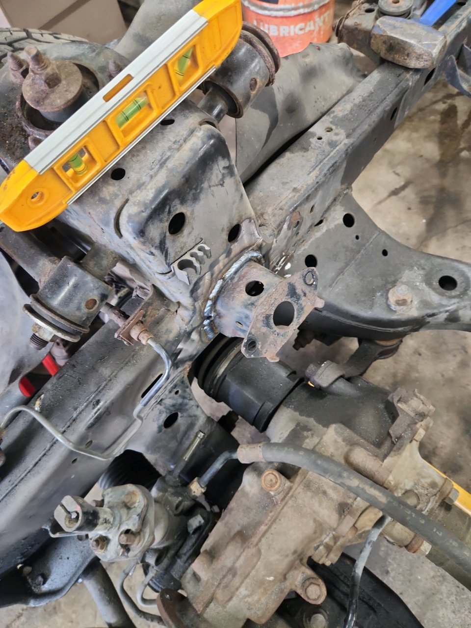

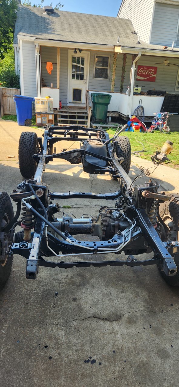

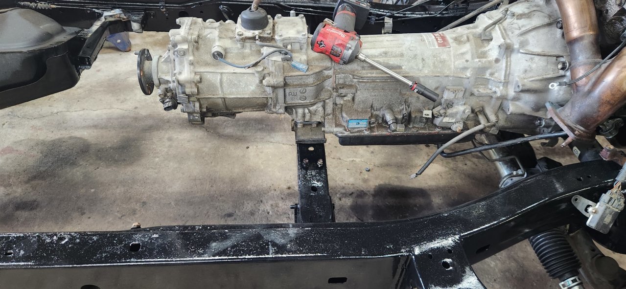

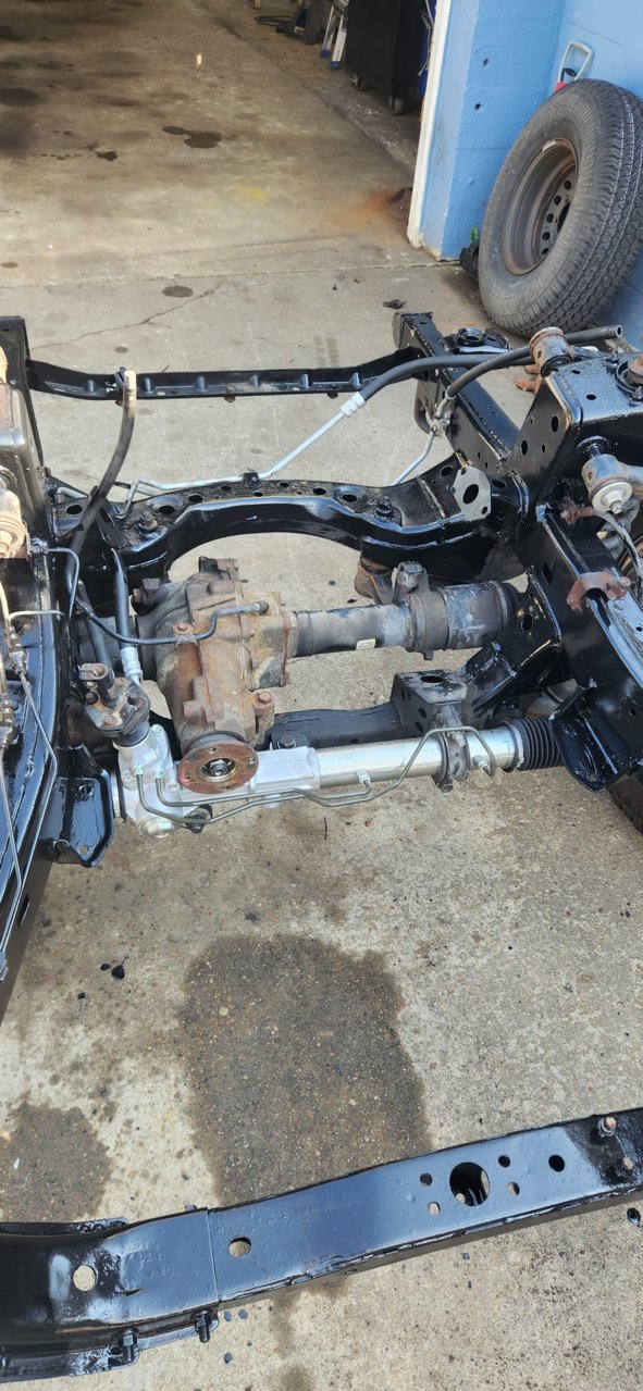

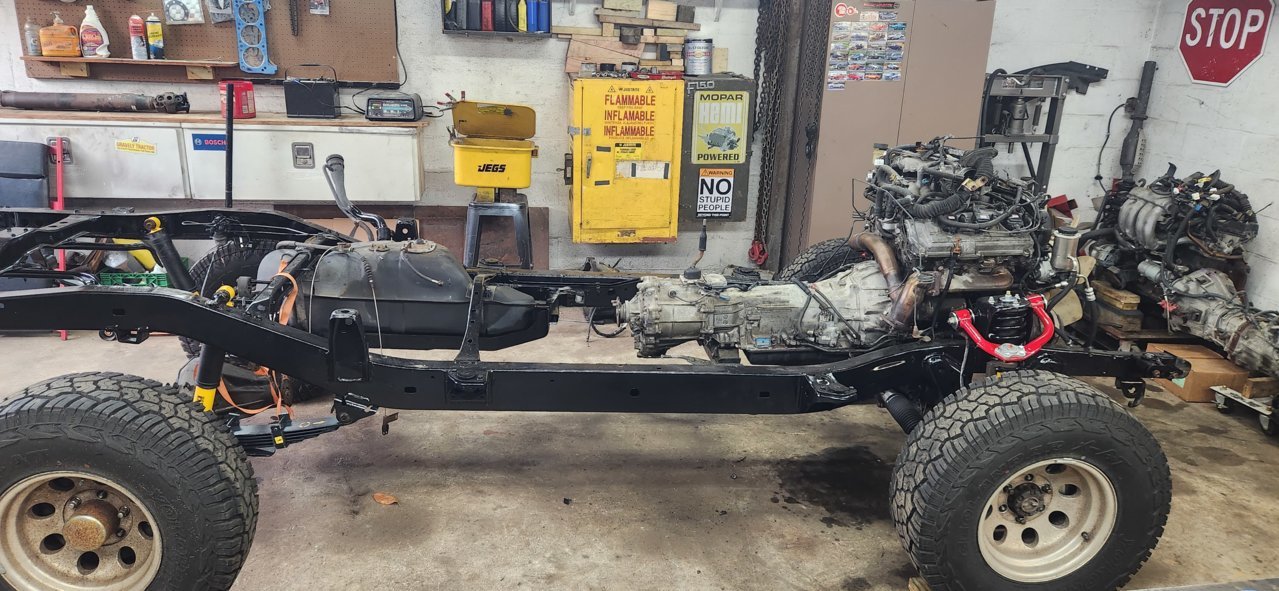

    Last weekend I got the engine mounts moved back. We contemplated bolting the motor and transmission together and lining it up that way and welding it with the engine in the way. But since I have the old frame still, we took many measurements and found that the V6 mounts sit 7/8" of an inch rearward from the 4 cylinder. So we cut and welded them in place.
    Early this weekend we got the frame cleaned up and painted.
    Then installed the new rack and pinion (old one leaking).
    The motor and transmission/transfer case went in next. Fought a little with the engine with the new mounts but got it bolted down. And when the transmission went in, it lined up perfectly!
    Just finished tonight installing the OME lift, JBA offroad UCAs and front brakes.
    We measured for the drive shaft and found that the original one from my 4cyl/5spd 4x4 will fit exactly with a 6cyl/auto 4x4. Who would've thought!
