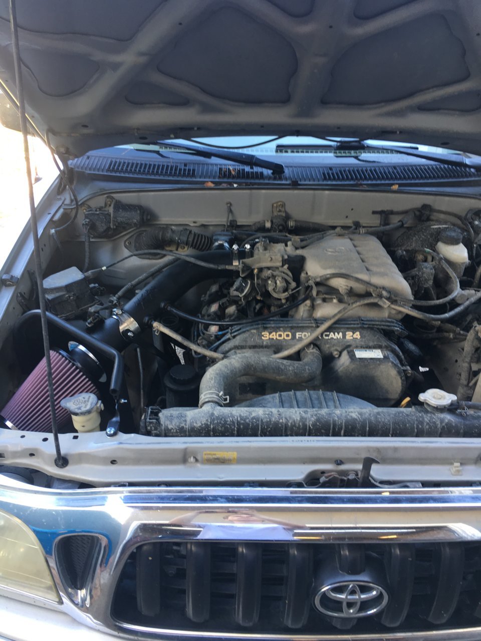

    After K&N Cold Air Intake Install about a year ago: IMG_2493.jpg

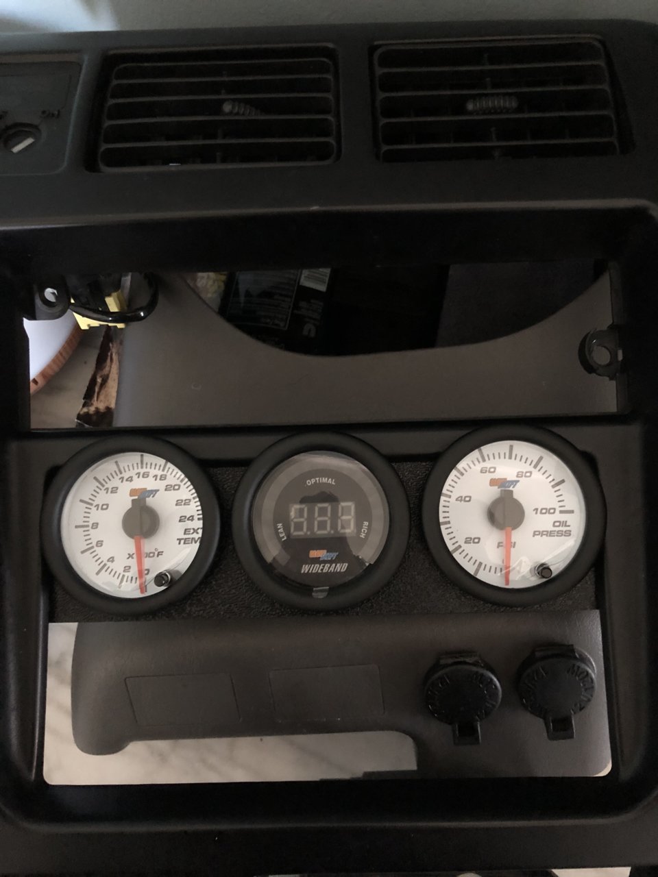

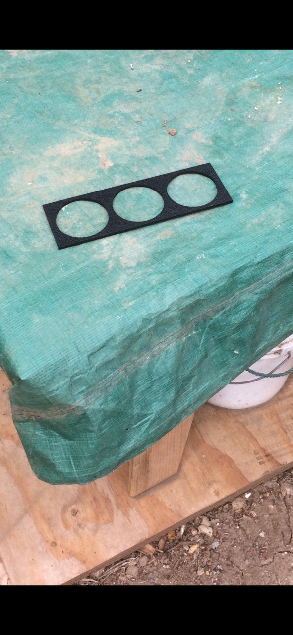

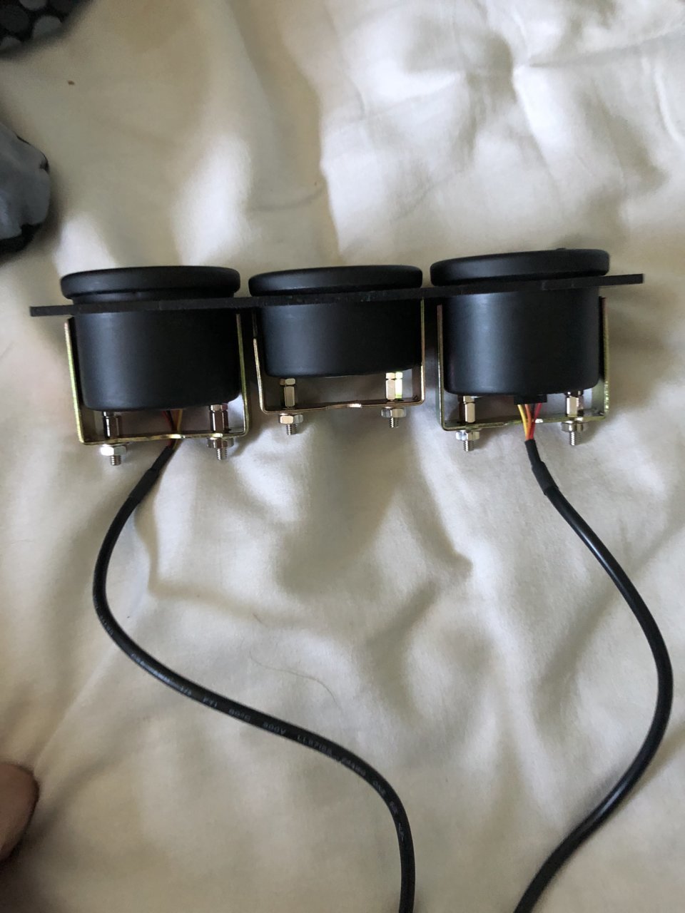

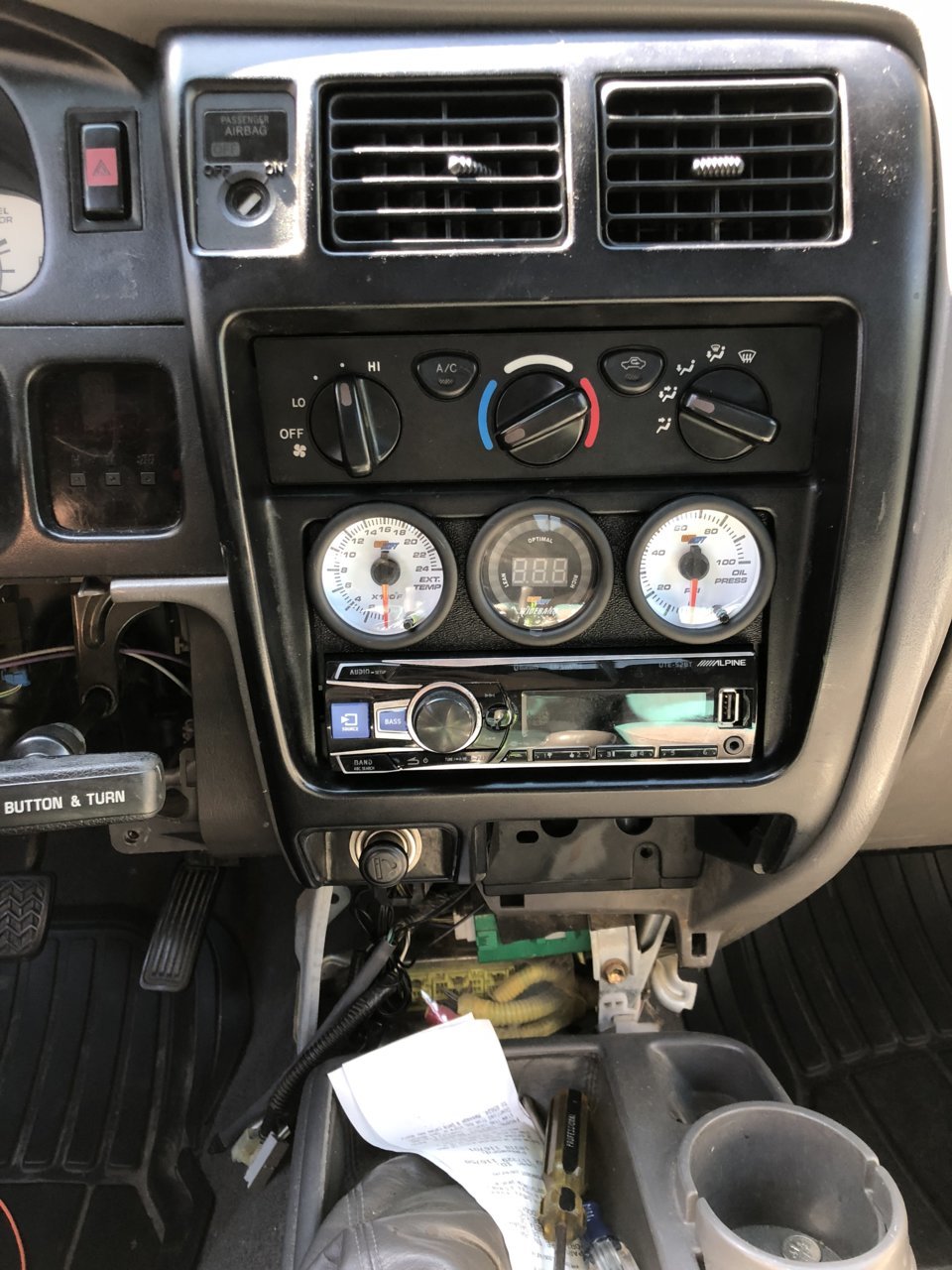

    I designed a laser cut piece of dash plastic to hold three of the gauges above my head unit. I while back I had a single DIN alpine head unit installed to replace the factory double din radio and a plastic pocket was installed bellow the new head unit to fill the space. To fit the gauges I removed the plastic cubby. Moved the radio down and mounted the gauges above. I got the idea for this gauge mount from speedys garage.

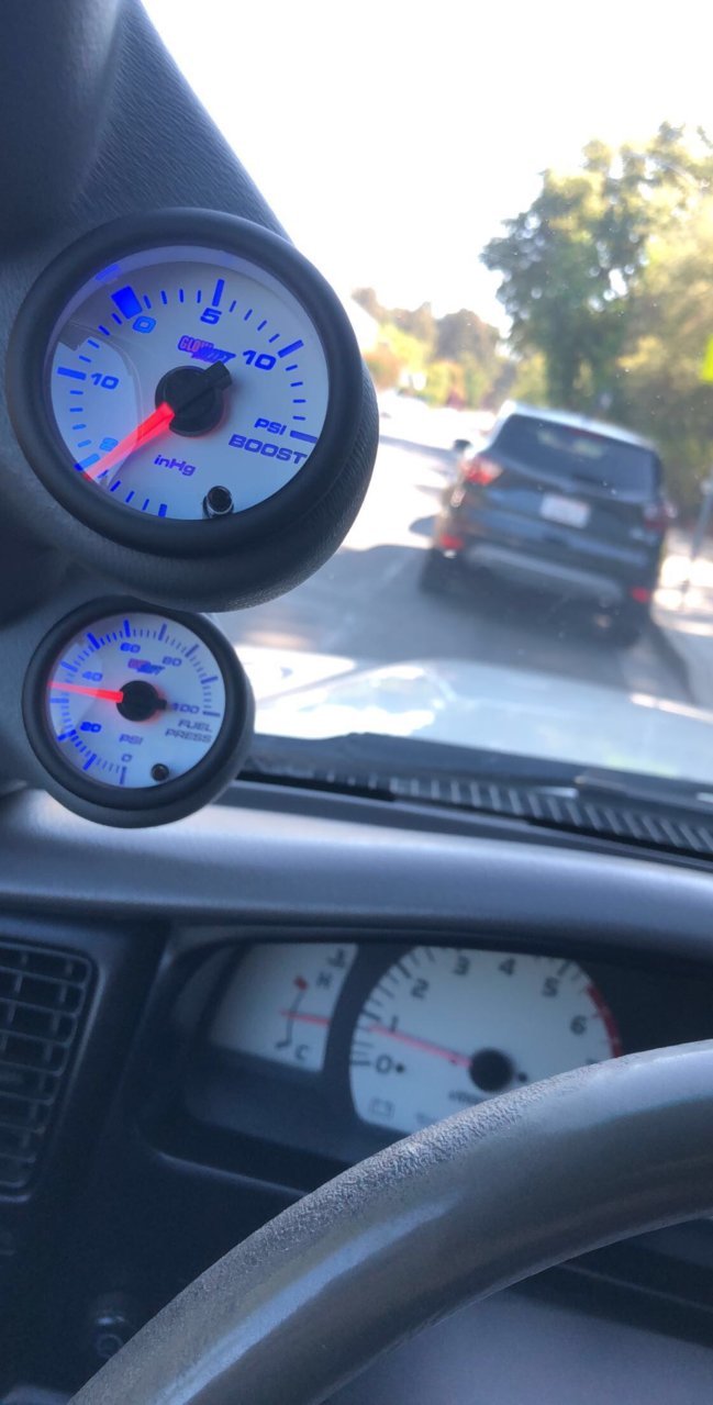

    I also purchased a 2 gauge pillar from LC Engineering for the two other gauges. To power the gauges I installed a cirkuit boss aftermarket fuse box so the gauges would be on their own fuses. I hid the fuse box behind the drives side kick panel. I decided to go with GlowShift gauges. The gauges come with a wire attached that wehn supplied power it dims the gauges. Ideally i would have attached this to the switch when turning on headlights so they dim with the rest of the interior but instead I used a wire from the cirkuit boss and put my own switch to dim the gauges.
    Laser cut mount for Gauges:
    Test sizing on center dash:
    Pillar Gauges:

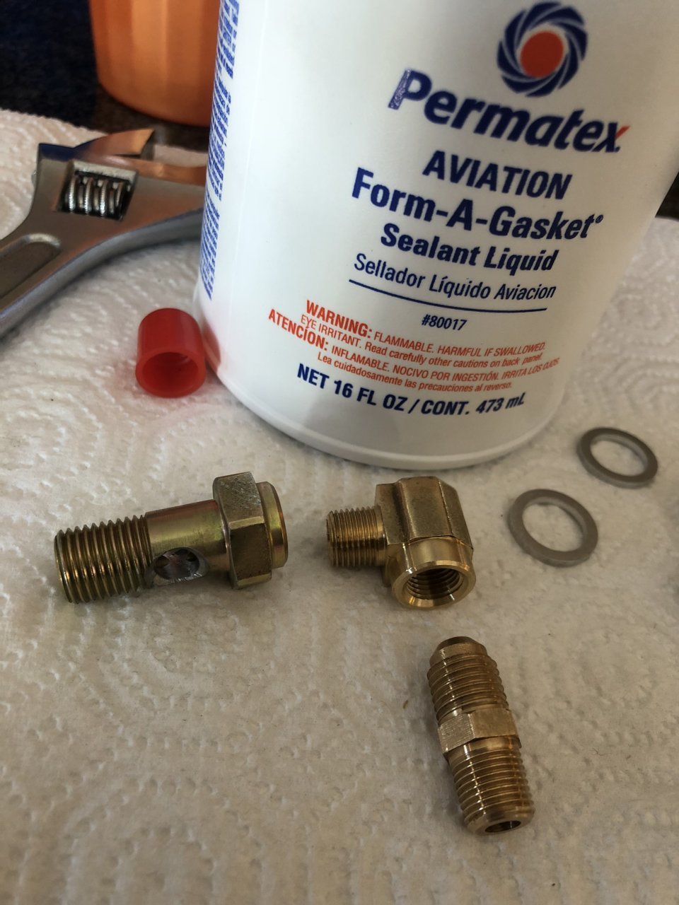

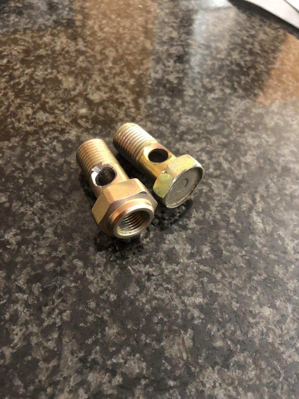

    For the fuel pressure sensor I bought a special banjo bolt that connected to the fuel rail and allowed to to attach a relocation hose which the fuel pressure sensor connects to the end.
    Stock Banjo Bolt on the right:IMG_5221.jpg
    I had to use a 90 degree adapter so everything would still fit behind the timing cover:

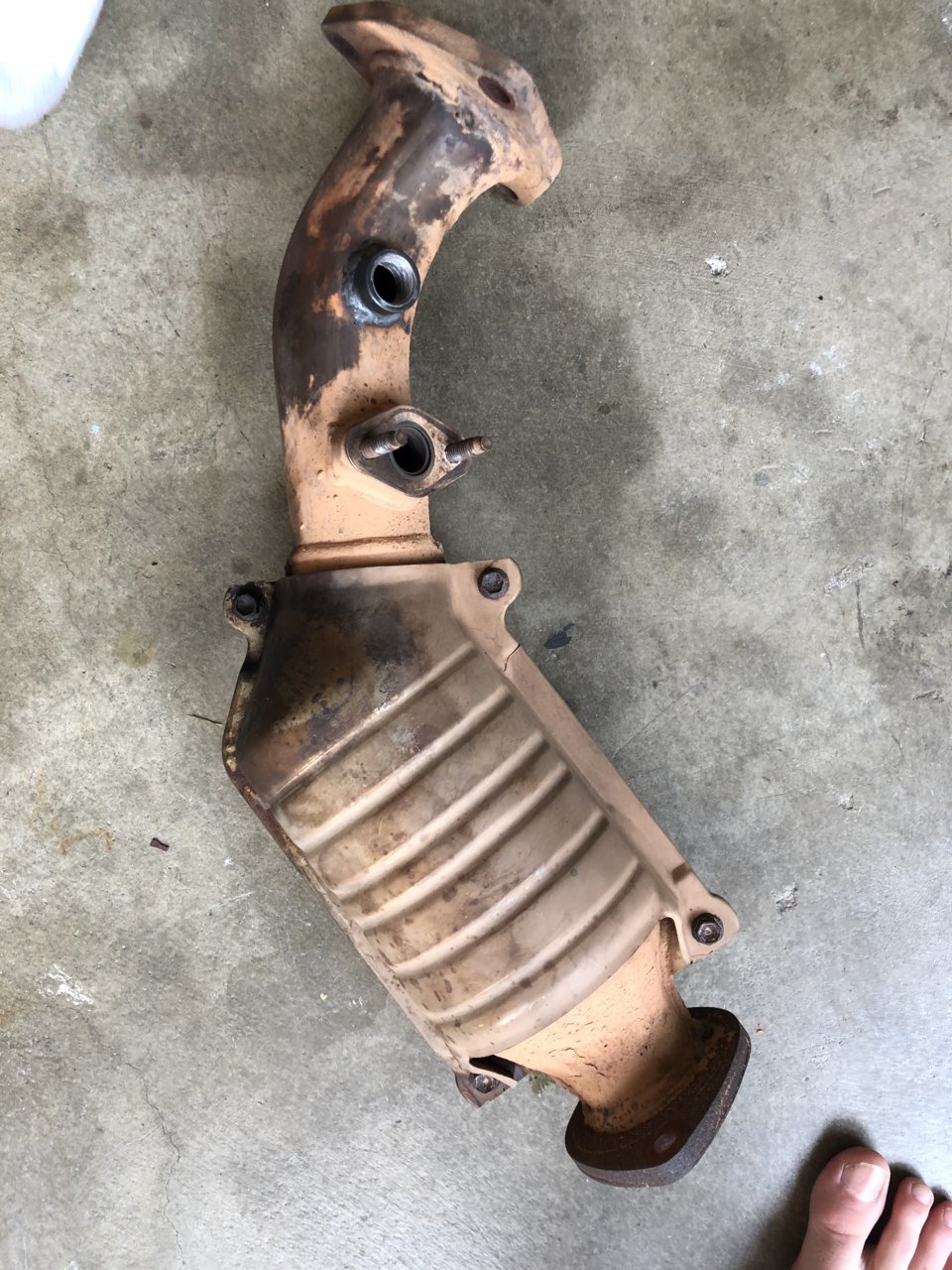

    For EGT probe I drilled and tapped a hole directly after the exhaust manifold on cylinder 1,3,5 side and sealed with extreme heat JB weld.
    Boost gauge is just a vacuum line running from the boost fort on the supercharger to the gauge.

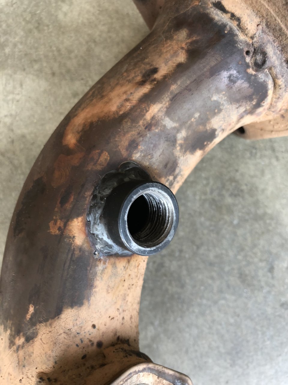

    Finally for the Air/Fuel Ratio sensor I had a bung welded into my exhaust before the catalytic converters.

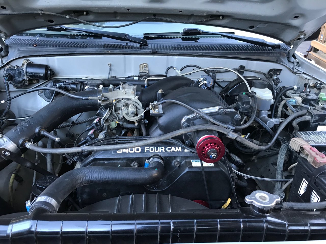

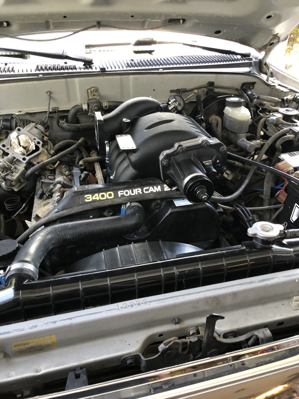

    Once I finished the gauges I moved onto the supercharger install. Ran into a few little roadblocks along the way but nothing major. During the install I also changed Valve cover gaskets.

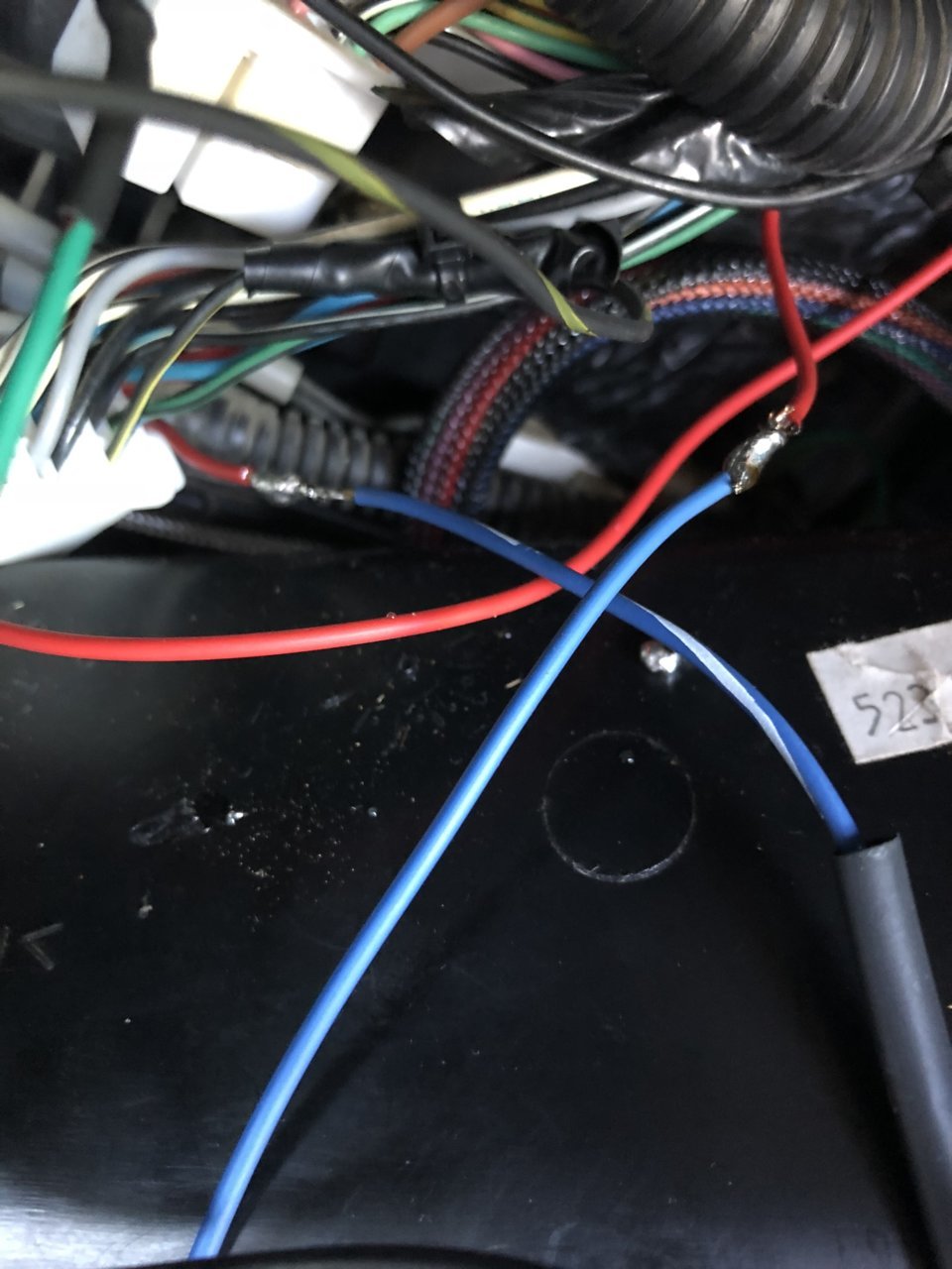

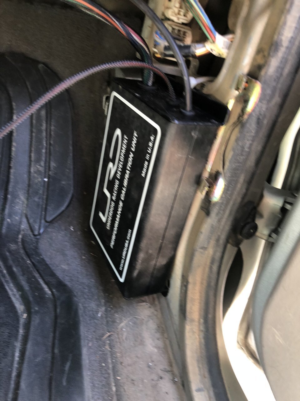

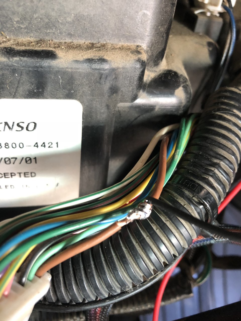

    Once I had the supercharger finished I started with the upgrades. Started with the URD 7th Injector kit which included an upgraded fuel pump. For the URD Piggy-back ECU install you need to tap into 7-8 ECU, connect a vacuum line to the boost port on the supercharger and solder the wiring from the 7th injector to the control box l. I chose to put the control unit behind the passenger kick panel. Its out of sight, close to the ECU wires and easy to run wiring and vacuum/boost line through the rubber boot in the firewall behind the glove box. The 7th Injector goes into the EGR port on the supercharger. You need to cut about an inch out of the high pressure fuel line and connect a T-Fitting included with the injector from the fuel line to the injector and you must solder the wires on the injector to the corresponding wires on the control unit.
    After the 7th Injector was complete the truck was running much better under boost. Previously around 5psi boost AFRs would be between 13-14. Now under high boost numbers AFRs drop to between 11-12.5

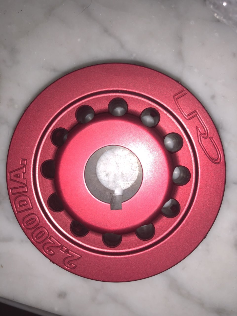

    Once the 7th injector was finished I installed the smaller 2.2 inch supercharger pulley. Before I was seeing around 7psi boost max with the stock 2.37inch pulley. After the 2.2 inch pulley was installed I am now seeing between 9-10 pounds of boost.

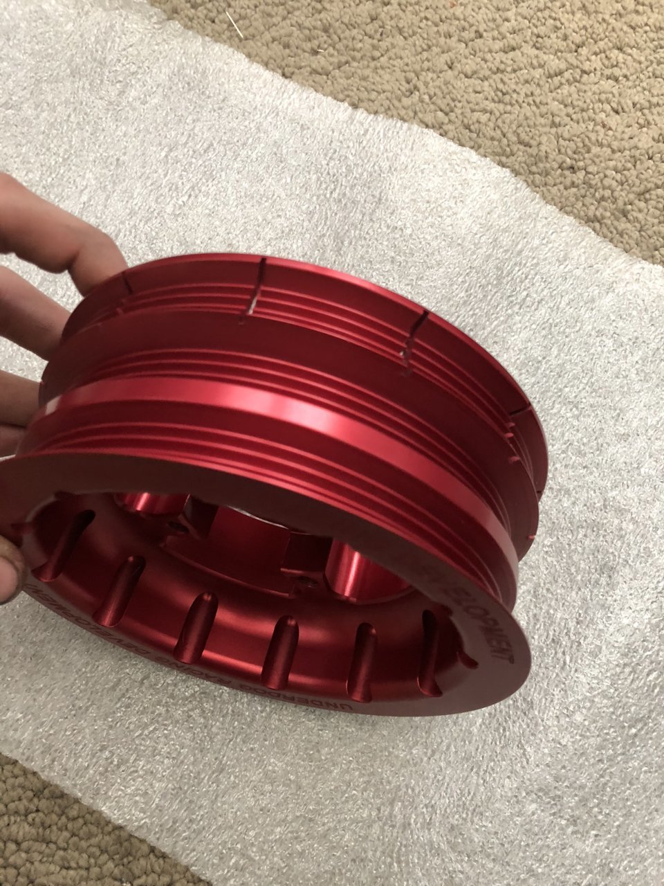

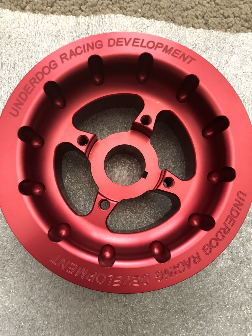

    Last thing I currently have to install is the URD supergrip crankshaft pulley
