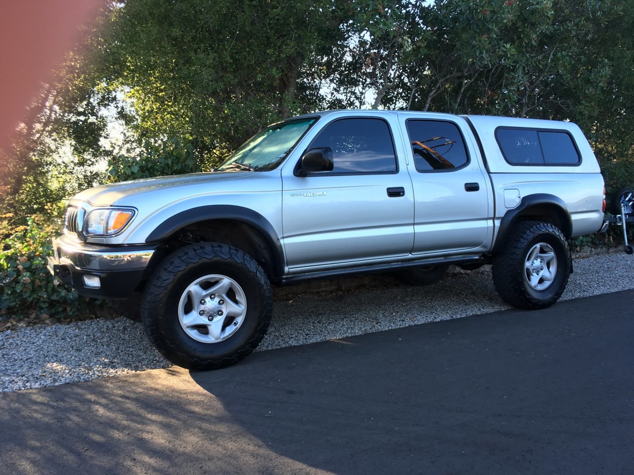

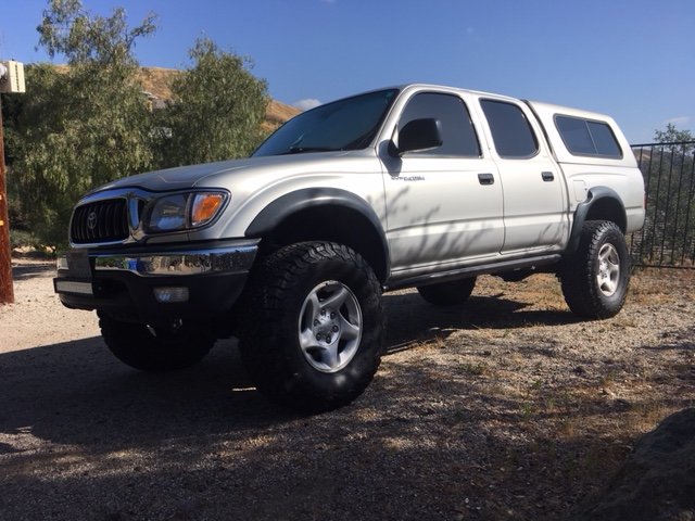

    So here is the latest.
    BF Goodrich TKO2 285/75/16
    Fox 2.0 coil over
    Fox 2.0rear shocks with rock guard.
    Add a leaf spring to level
    Re geared differentials with Yukon 4.88
    Nitro 8.4 pinion spacer
    lowered the front differential 1"
    1.25" wheel spacers all around
    A little trimming of the plastic in the front and hammered the pinch welds for clearance. Sprayed undercoating where ever the metal had been exposed.
    In addition to the standard 4wd I added:
    ARB air lockers front and rear
    ARB standard air compressor with port and hose to reinflate tires.
    I can use the rear locker alone, the stock 4wd system alone, combine the stock system and the rear locker.
    The stock 4wd system must be engaged in order to use the front ARB locker.
    TG rock sliders welded on
    The sliders and air lockers were installed by Eric at Yotamasters in Corona, CA. I highly recommend him. Great Guy
    Re build rack and pinion.
    ICON upper control arm w/ ball joint
    Other stuff:
    Relocate rear diff breather
    Optima Yellow Top D35( I added contact points for the auxiliary items, dense rubber on top of the batter bracket to help with vibration)
    High lift jack
    Rotopax fuel and water cans
    21.5" Trailmaster LED light bar.
    K&N cold air intake
    The truck has a little over 300k. I have a bit more
    The trans was rebuilt at 250k. Never go to Jiffy Lube for trans service. It turns out that they replace fluid but not the filter.
    I use synthetic oil and change at 5k. Religiously.
    Aside from routine maintenance like including timing belt, water pump, plugs, wires, valve cover gaskets etc.
    Ive replace little things like the exterior door handles, window trim, headlights. Recently replaced the radiator and the driver power window motor.
    I'm thinking of adding a supercharger and checked the compression to see if there was enough life left in the motor.
    Normal Compression is 174psi. Minimum is 145psi.
    The truck tested as follows:
    Cylinder
    1 170psi
    2 165
    3 166
    4 165
    5 165
    6 170
    Not bad for being 16 years old and having over 300k. There is still some life left.

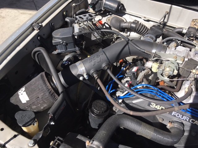

    IMG_0971 (2).jpg KN Cold air intake

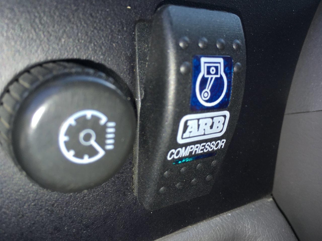

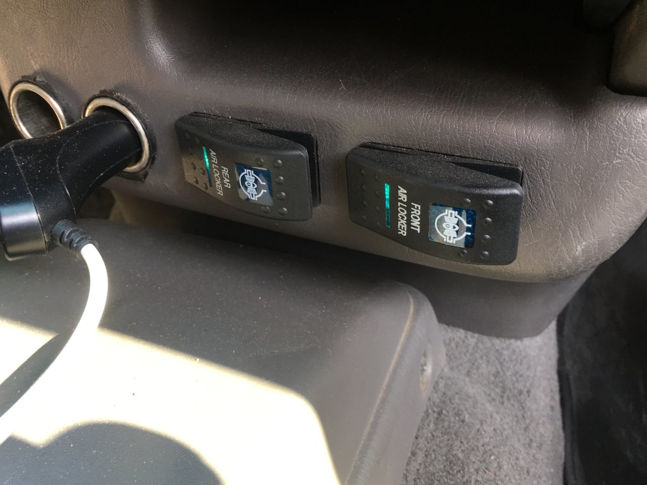

    IMG_1002.jpg IMG_1006.jpg Front and rear diff switches located by aux power ports. Compressor switch located left of steering wheel next to the dash light dimmer.

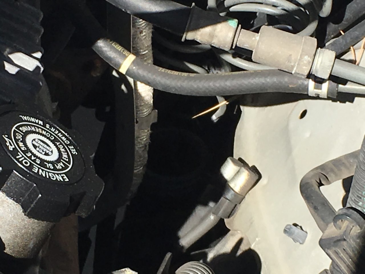

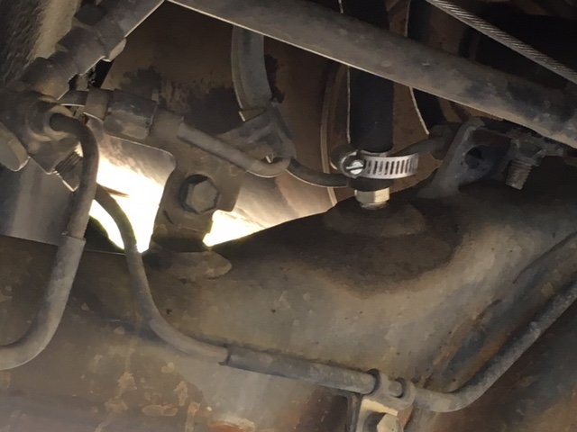

    IMG_0979.jpg IMG_0980 (2).jpg I read a thread here and follow their directions. The new location of the rear diff breather is behind the fuel filler door.

    IMG_0974.jpg The original location of the front diff and transfer case breathers are located on the firewall

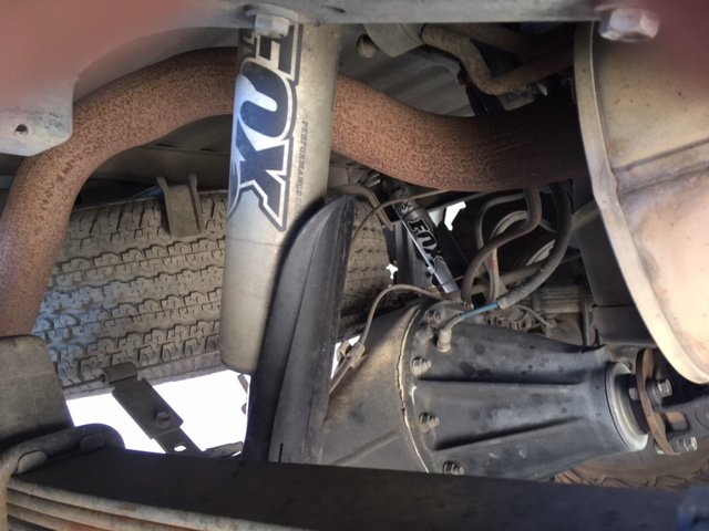

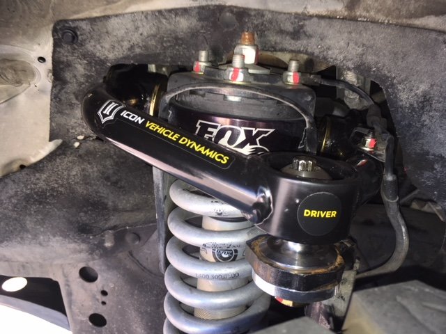

    IMG_0983.jpg IMG_0993 (3).jpg Fox 2.0 Rear shock with the rock guard. Strongly recommend the guard to keep sand from ruining the seal.
    Also shown are the Fox 2.0 Coil over and the Icon upper arm.

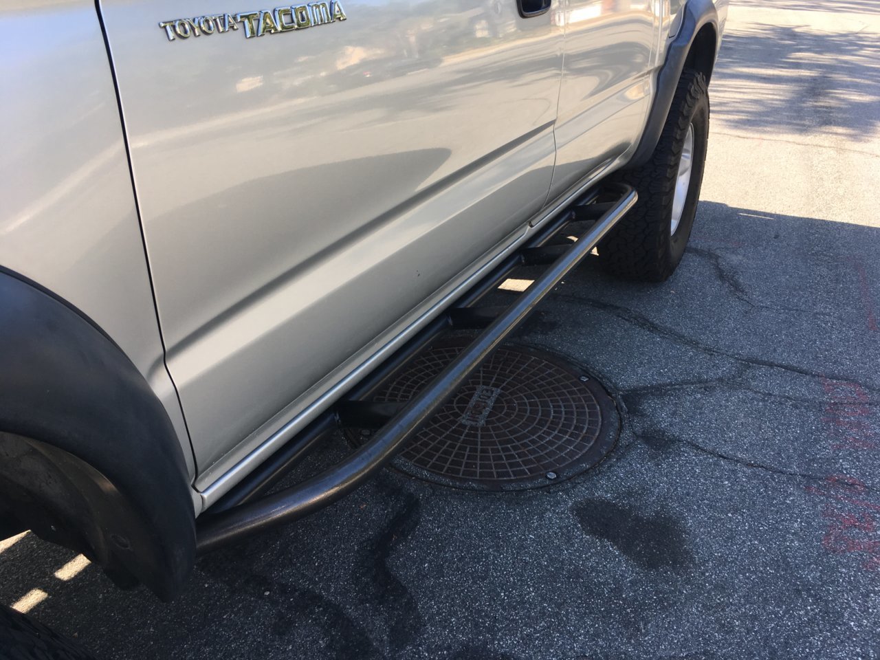

    IMG_0990.jpg Welded on TG rock slider

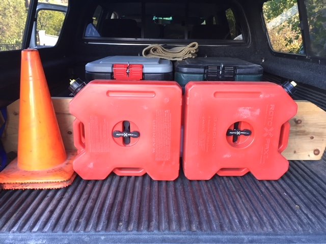

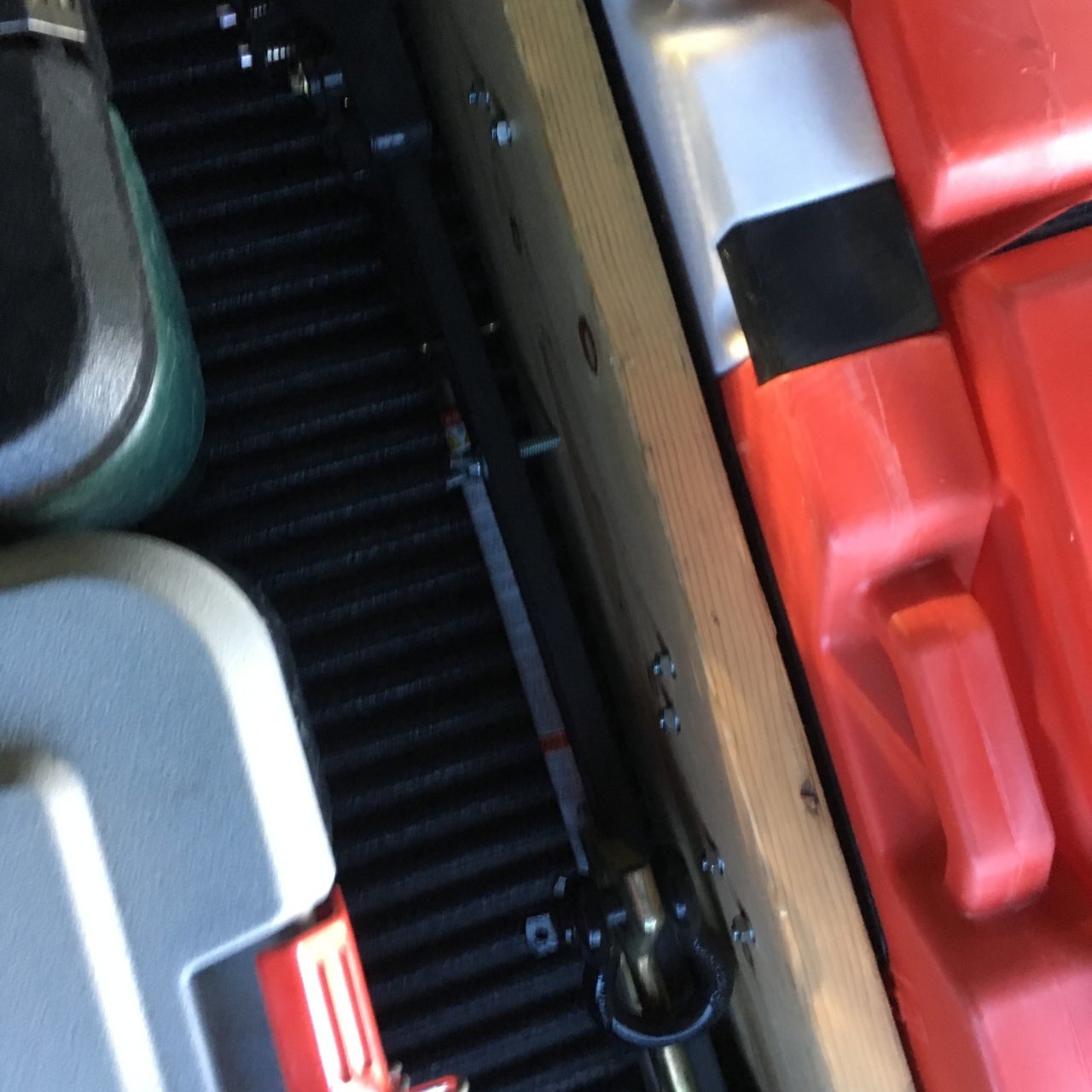

    The Rotopax fuel and water cans. The Rotopax mounting bracket is installed on a 2x12 that fits into the bed liner.
    On the backside of the 2x12 the high lift jack is mounted with a bolt, washer and wingnut.
    Between the high lift jack and the cans I've never had the 2x12 move. Very secure. Its worked out better than expected.
    Still leaves space for cargo.

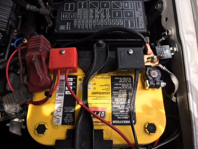

    The aux battery wires were installed into the contact boxes to clean things up. The dense rubber under the battery holder bracket keeps things snug but allows for a little vibration so the case doesn't break. The battery is also sitting on a plastic spacer that elevates the batter and also provides a little shock relief. There are some very cool battery retention systems that are on the market but none that I've found specifically for the '02 Tacoma. I'm thinking of relocating some stuff to make one of these systems fit but will give it some thought before I jump in. The fact is I'm not racing off road. Well sometimes 60 mph on the washboard road. But not racing Baja. More expedition stuff. And the Optima has held up really well.

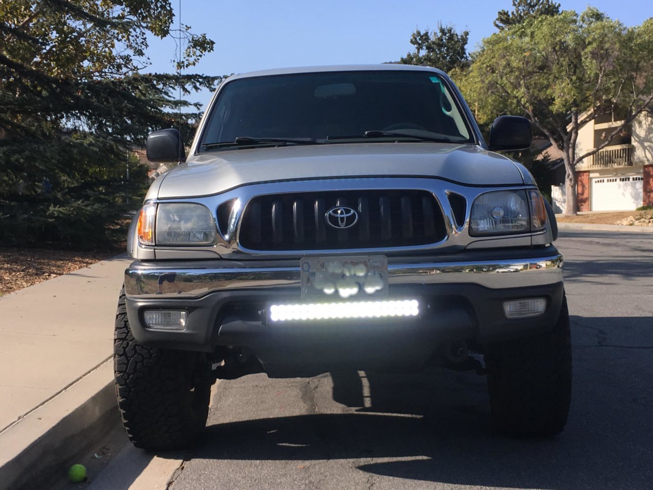

    I have had the BF Goodrich on every truck Ive owned. in the last 30 years. First on an '87 4wd Ford Ranger, Dodge 1500 4wd and now this Toyota. The only thing new is going to the KO2 for thicker sidewalls. Ive always been happy with these tires. the mileage I've received has always been good. Even on the heavier Dodge. They perform on the road really well. Ive never been stuck. And the road noise is low.
    I also added a Trailmaster light bar for giggles. It was on sale. The location its in isn't bad but I'm hoping to put a Frontline Rack on the cab and shell. If I can pull that one off, they are pretty pricey but a great system, I'll add a light bar to the front of the rack to gain elevation and spread.
    I might be moving all the switched around. I'm installing a CB and will need the space.
