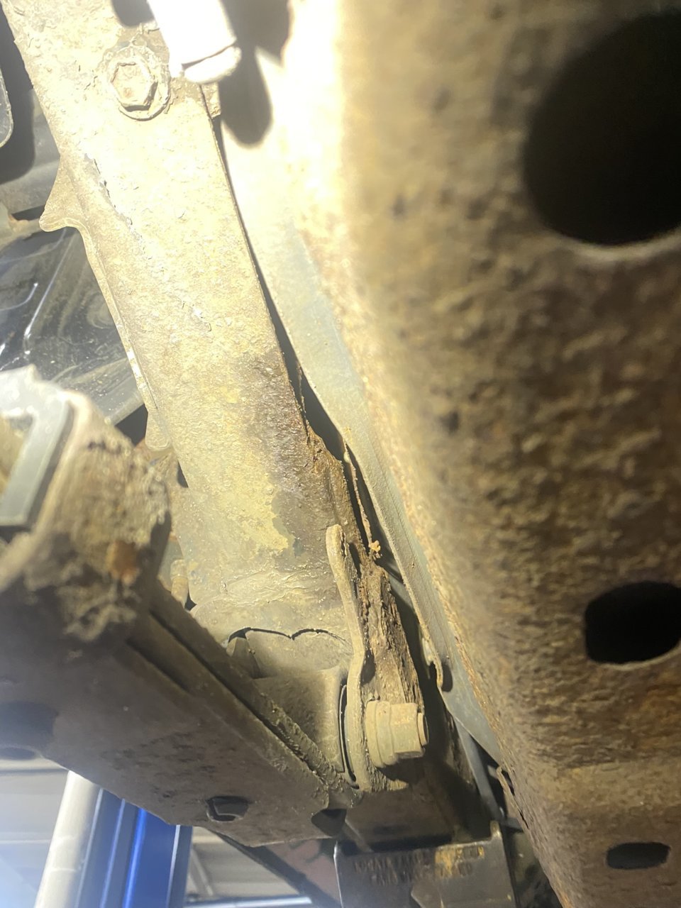

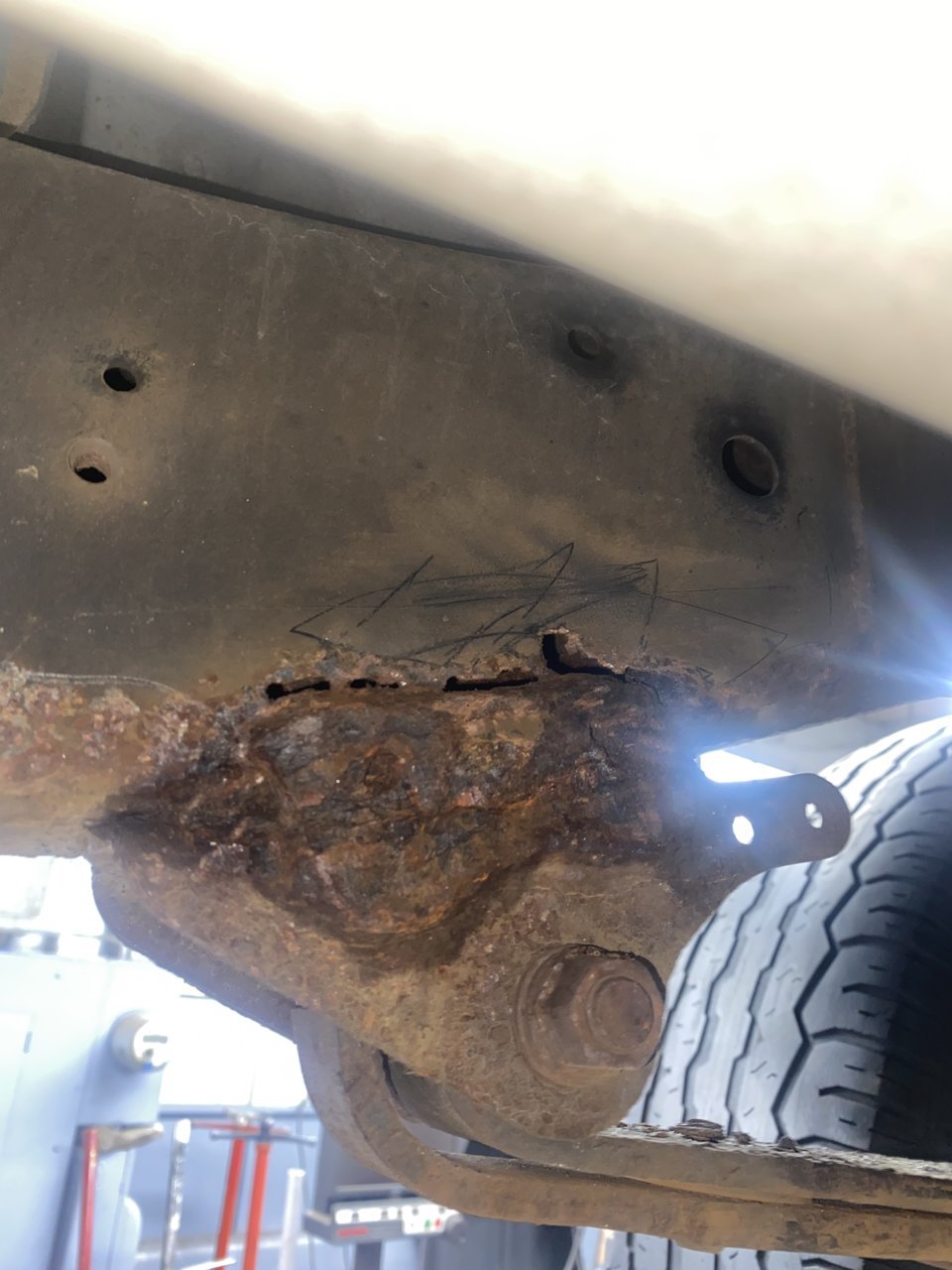

    Long story short….I got this truck approx 3 years ago off the original owner. It’s a 4 door …5 ft bed ….absolutely love it…only had 66,000 original miles on it. Just hit 100,000 few months ago! Now the bad part….took to get inspected and the frame is rusting away bad!!’ I have the original paperwork when it was recalled for the problem from dealership and all they did the undercoating and treatments crap back in 2010…obviously that didn’t work too well….my question now is what are my options??! I can’t afford to put money into getting plates welded …..the entire gas tank has to be removed to reach some of area. Do I throw a Hail Mary And see if dealership does anything for me….i sort of know it’s probably a waste but I just looking for options and suggestions

    You'll either need to spend the money to plate it or scrap it when the frame gets bad enough or try to find a good frame and switch everything over.

    20 year old truck and you bought it 3 years ago. It’s extremely unlikely the dealership or Toyota will do a thing.
    If the rest of the truck is great I’d say spend the money to plate it or install a new frame.

    With only 100k miles and being a double cab, I'd absolutely get the cancer cut out and the frame reinforced.

    I’d say fix the frame if you want to keep the truck. I had mine done professionally and it cost $1200 with some elbow grease on my part to clean the rest of the frame up. If you say you can’t afford to plate the frame, then can you afford a new vehicle’s downpayment and potential monthly payment? I’ve ran this situation in my head multiple times. Needless to say, I have kept mine and I’m glad I did. Good luck with whatever you decide as I know it’s a tough spot to be in

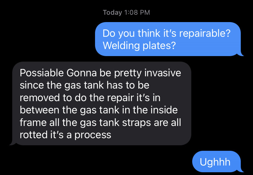

    Ever have those moment you just want to jump off a cliff? I am on the edge now!! Going through divorce is bad enough and now this….:(
    I am gonna prob look into trying to fix….but from sound of it it’s gonna be a pain in ass……see text from mechanic!

    Any pictures? I’d damn sure plate that truck. The bed comes off easy. It’s not an easy job, but it’s definitely doable. Or sell it to someone who wants to fix it! You will have no problem getting some money out of it..

    Am going to be getting it looked at in next couple weeks and get plates welded to it….and should be good for Atleast another 5 years hopefully

    I literally just had this done same place same procedure dropping the gas tank is a pain with rust but there are ways I got the bad cut out he fabricated new piece and it hit me for 1800$ Now keep in mind mine had pretty much rusted in half right at that leaf spring mount and he also welded on a new rear upper shock mount for me. I looked at it like this what can I get for 1800$ thats gonna be better than my truck and mine has 190k

    if you have a backup vehicle, remove/reinstall the bed yourself (fairly simple job, just cumbersome, don't hurt yourself). the tank, too. that's hours off the labor bill at the shop, and pulling the bed will make assessing/rustproofing the frame loads easier.
    find a buddy that'll help you tow it to/from the shop. bribe them with bourbon.
