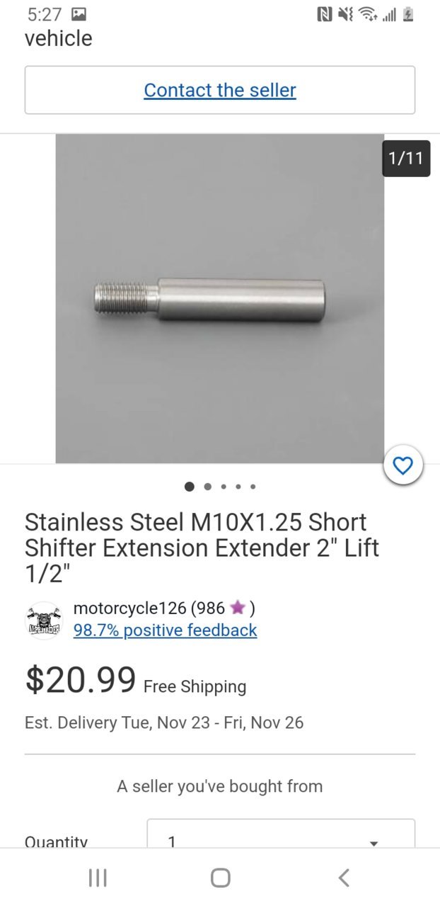

    I used the original link and it looks like that “listing has ended”.
    I did some searching and it appears this one has the same dimensions all around and should fit the bill
    https://www.ebay.com/itm/Stainless-...r-Extension-Extender-2-Lift-1-2-/174832441925

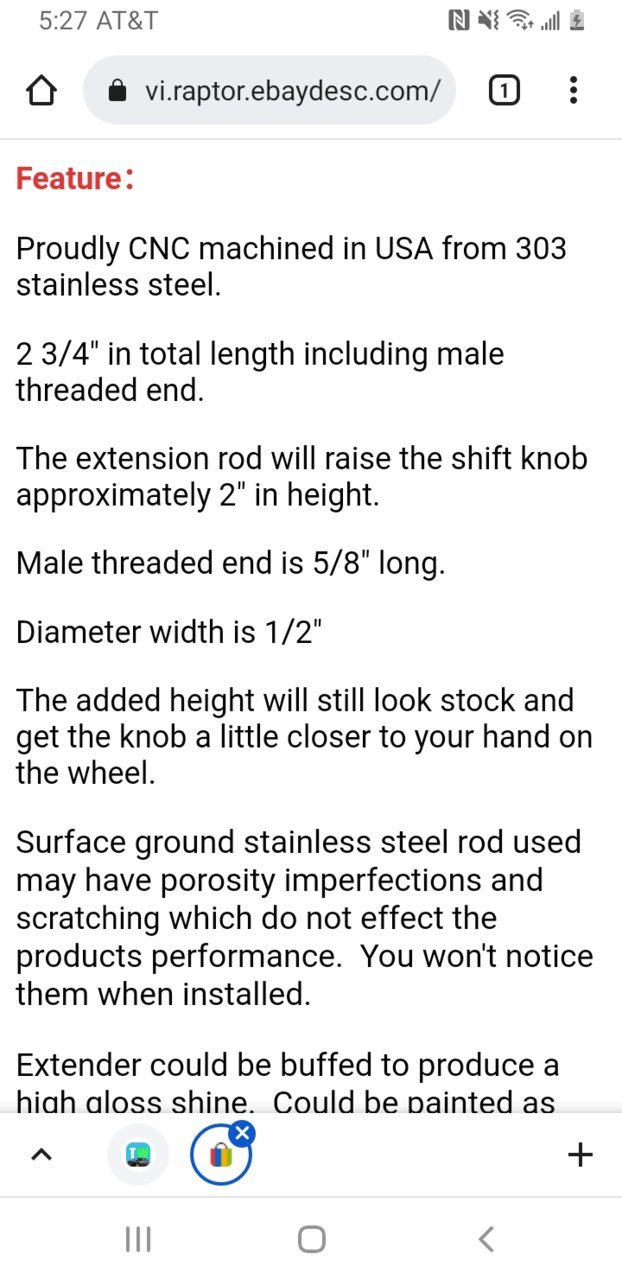

    Very much appreciated. Ordered one grabbed some screenshots of the lengths to memorialize them in case the link doesnt work down the road

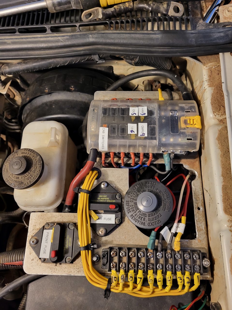

    Finished my brake upgrade thanks to this thread. I wound up picking up some new 17" wheels, so I did discs and calipers not just the master/booster like my initial plan. Definitely a noticeable improvement in braking power and pedal feel. Everything went pretty smooth with my install. I really had to wrench my custom made lines I made into the master and the steel couplings pretty tight. Like way tighter than I thought.
    Only additional parts needed for the manual trans are the bracket and resi, which comes with the float and cap. I had the bolts for the fender scavenged from other places.
    Biggest challenge for me was making my fuse panel work with the larger tundra master and booster. If you have stuff up there in that location, plan accordingly.
    Great mod! I feel a lot better about stopping this beast now.
