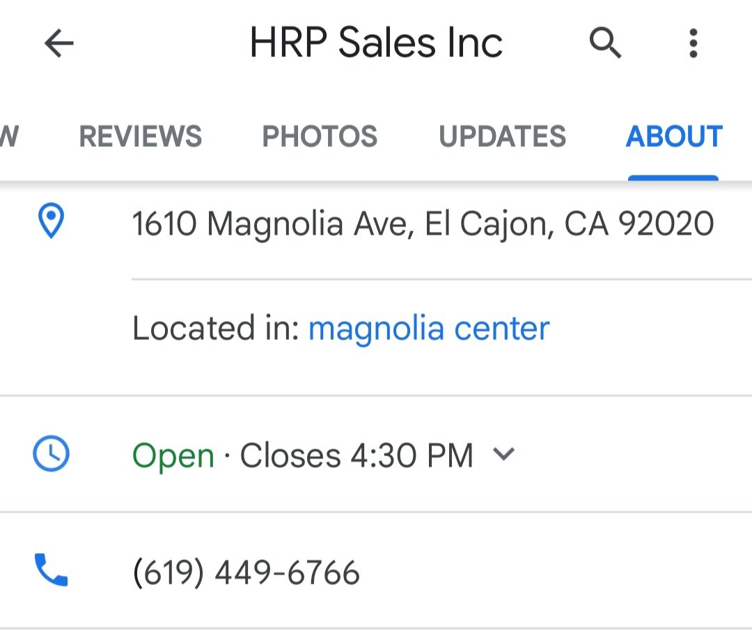

    I had my SS brake lines made by a local supplier and I'm positive they could make more of them. I thought I put that in the thread but maybe not.
