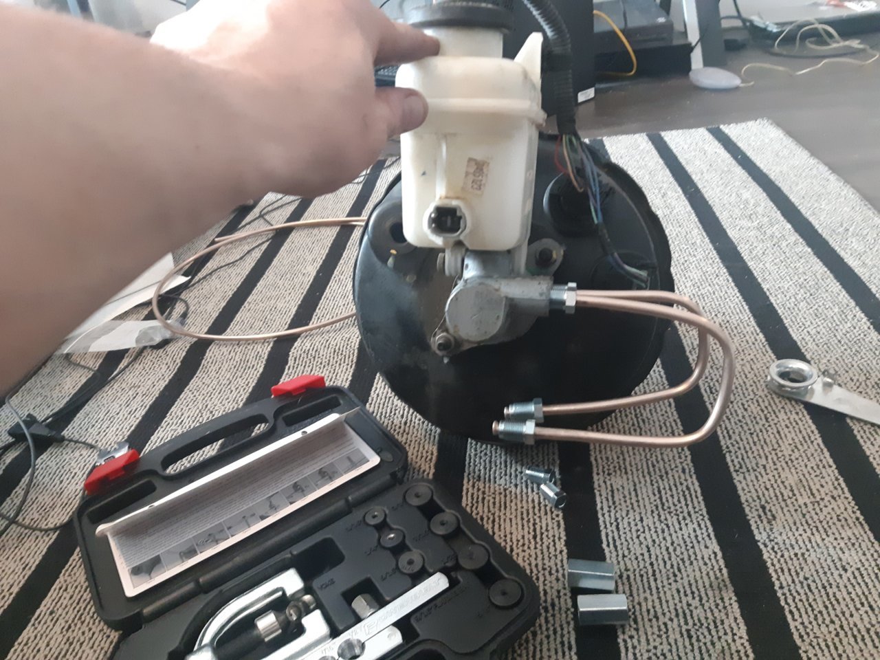

    That's a great price. I paid more for mine and they weren't shipped.
    That's exactly the lines I had made. Here's a repeat pic to show them on a Tacoma.

    If your Tacoma has 2 brake lines coming out of the master cylinder it'll fit. It'll fit your SR5. Models with 4 lines/traction control it will not fit.

    if you are referring specifically to the m10 to m12 lines he is having made for the booster swap, I highly recommend double checking the size of the existing lines coming off your tacoma master before committing.
    i cant remember if it was here or another thread, but I think we concluded that not all 2nd gen tacomas have m10 lines coming off the master. Mine had m12 lines.

    What did you use to extend the lines to the other side?

    I followed another members approach and made my own lines. Parts ordered on fedhillusa.com. Flare tool was a loaner from advance auto.
    Parts list from my build thread:
