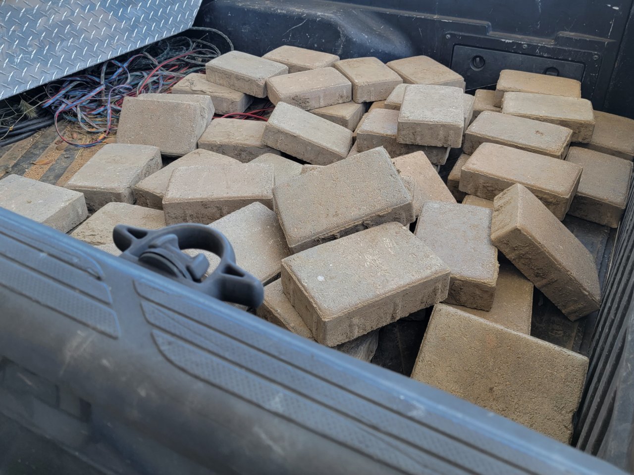

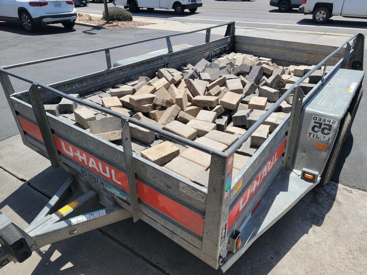

    This was definitely the trucks heaviest haul to date. 2006 V6 double cab, auto, PreRunner, 400-500 lbs in the toolbox and in the back seat's floorboard, plus 200ish lbs in the bed, plus a tandem axle utility trailer that had working brakes, plus several thousand pounds in the trailer. A total guess is 7,000 lbs in the trailer not including the trailer's weight. There was a lot of slamming of weight on and off my custom built hitch whenever the trailer's brakes kicked on or off and it would totally harshly move the truck. The truck itself never complained until I tried to tow the trailer up a really steep mountain so I left the trailer mid-way on the mountain, put more in the bed, emptied the bed, took more out of the trailer and put some in the bed a second time, emptied that, and then towed the trailer up the mountain.
    I definitely would not have tried it without the 4Runner front brakes and the Tundra master cylinder and booster upgrade. It stopped extremely well and a lot better than I thought it would.
    An all day job (11 hours).
