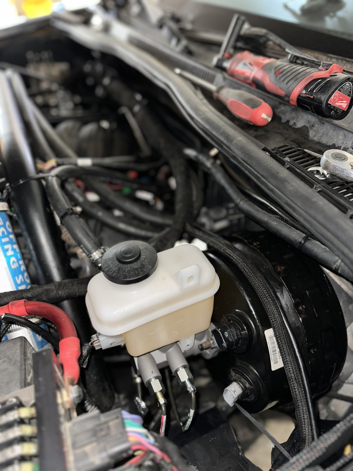

    Just completed my pedders rear disk brake conversion, changed out the master cylinder for the disc brakes, and bled, never touched the ABS module. Brakes are very firm, no sponginess.

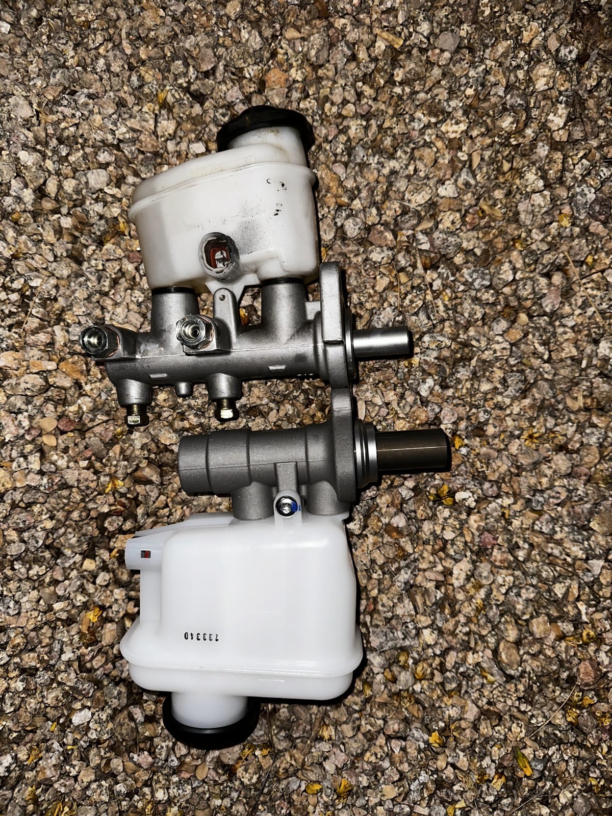

    For anyone that’s done a rear disc conversion, and bought the SOS performance master cylinder kit for your Tacoma booster, that mc will NOT fit the tundra booster. The tundra booster does not plunge far enough into the mc.
    Tundra on bottom, sos on top:IMG_1917.jpg

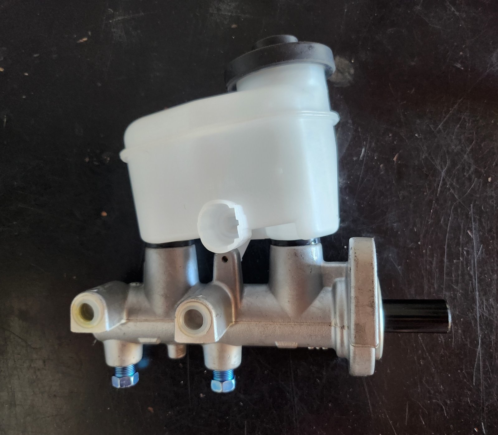

    I'm glad I saw this before starting the install. I also have the SOS tundra MC kit. And was planning to use it with the tundra booster upgrade.
    This is the MC that came with the SOS kit. Looks like what you got that you say doesn't plunge far enough.
    What master cylinder did you end up using? Year/model vehicle of the MC application?

    Yeah the one you have for sure will not work.
    I ended up just buying a tundra MC from AutoZone. 2012.
