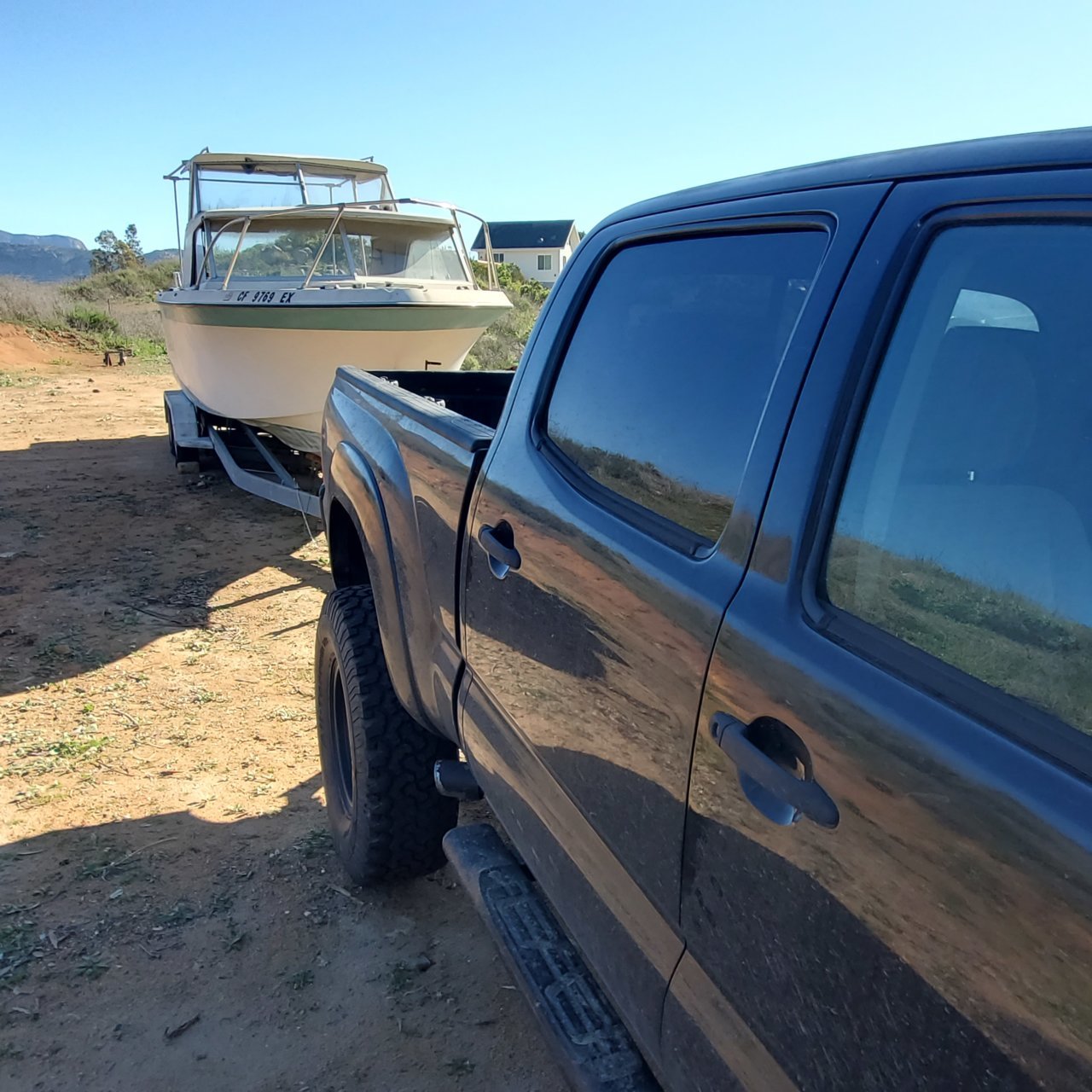

    About 2 weeks ago I towed this heavy ass boat and the braking performance felt extremely dangerous. The boat was either close to or over the Tacomas max towing capacity.20200130_121920.jpg

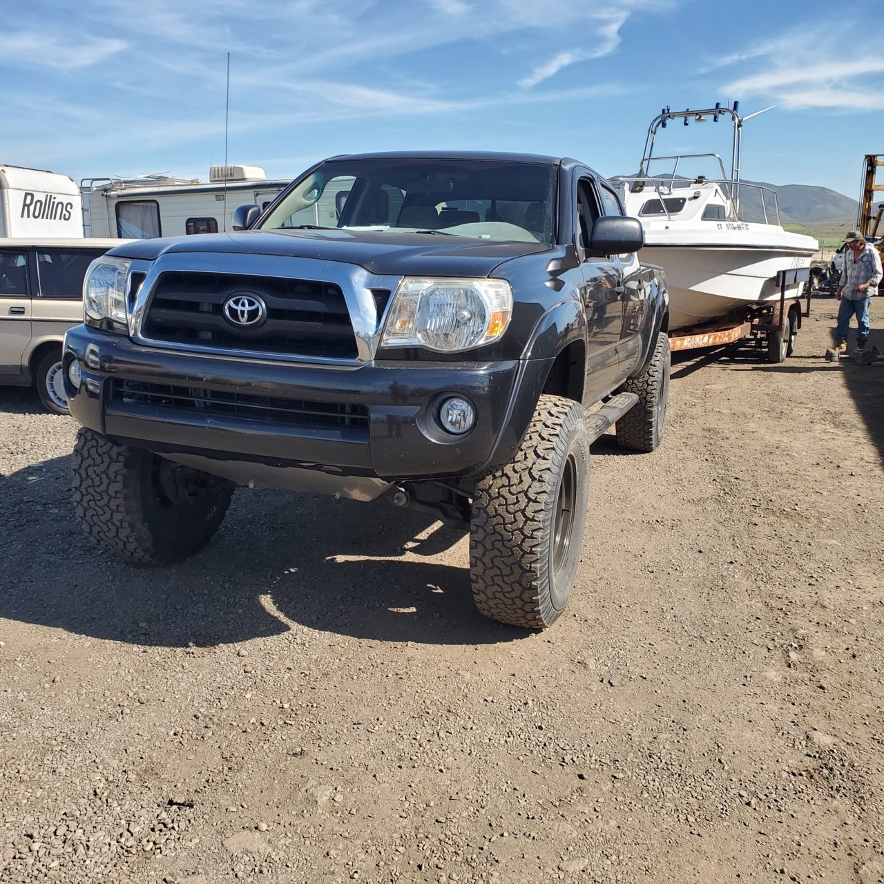

    This morning I towed this heavy ass boat that was close to or over the Tacomas max towing capacity.

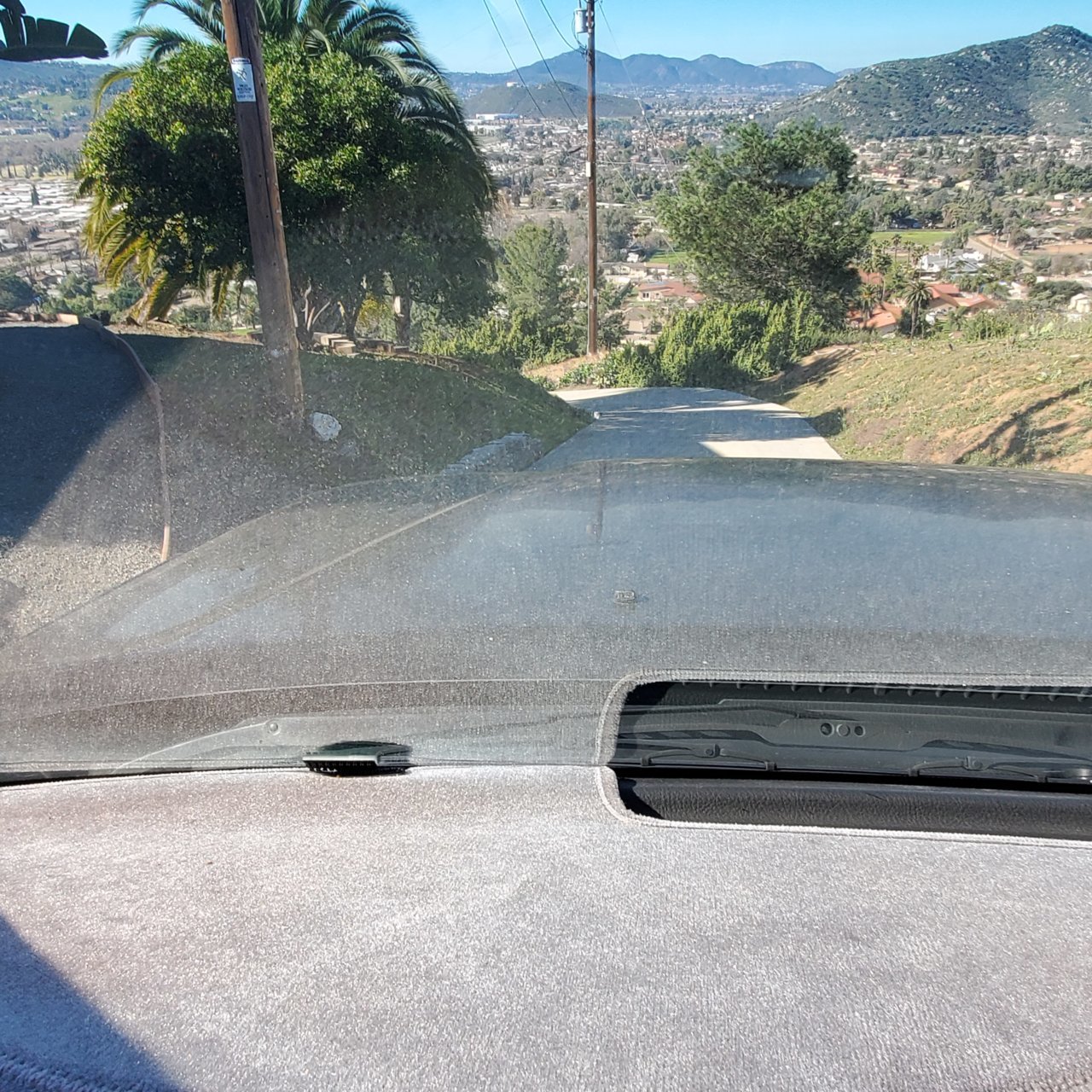

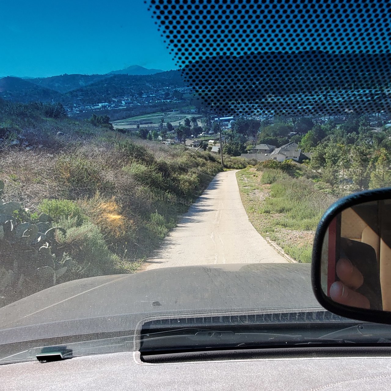

    The driveway for this morning's tow was at or over 20 degrees.
    I got the truck up to 20 mph going down this driveway and the truck had no problems whatsoever stopping on the driveway.
    I also did a panic type stop on flat ground with the boat in tow and the ABS worked as it should work.
    With the new brakes and towing this really heavy boat the braking performance is similar to stock brakes with an empty truck and towing nothing.

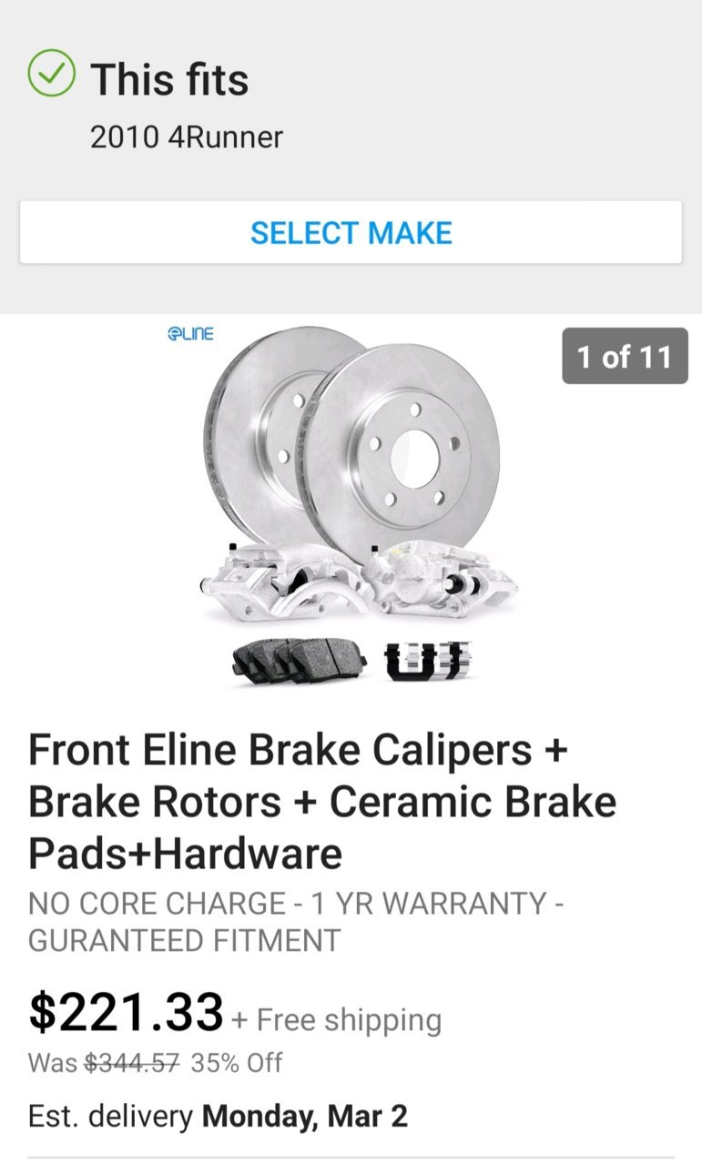

    Any chance you have a link to the brake kit that you purchased on ebay? Looking to do the same thing.

    There's a shit ton of pressure keeping it together and no pressure separating the 2. There isn't any pressure from side to side.
    I don't but here's a screenshot of what I bought on eBay. There are others now that are less than $200.
