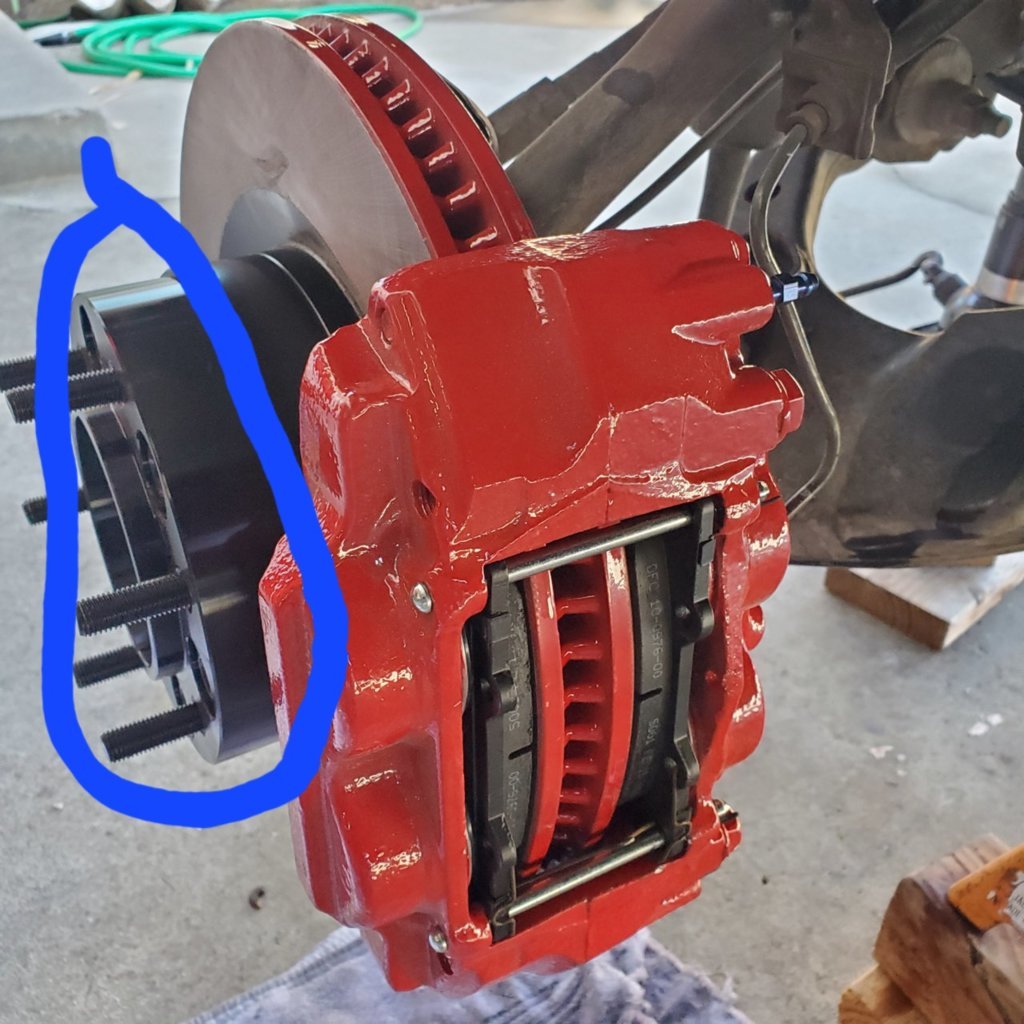

    Generally wheel spacers are frowned upon. Wheel spacers add stress to wheel bearings, hubs, and ball joints. As far as I'm aware, wheel spacers don't offer any additional brake rotor cooling. In the case of our Tacomas, wheel spacers move the wheel/tire further back and forward during turning so they essentially reduce tire clearance when turning.
    My Tacoma is ready for its 4th set of front wheel bearings which is one of many "prices paid" for installing 37's on these trucks. The front left is getting sketchy. NAPA pre assembled front hubs have lifetime warranties so for me it's solely about getting the time to do the work.

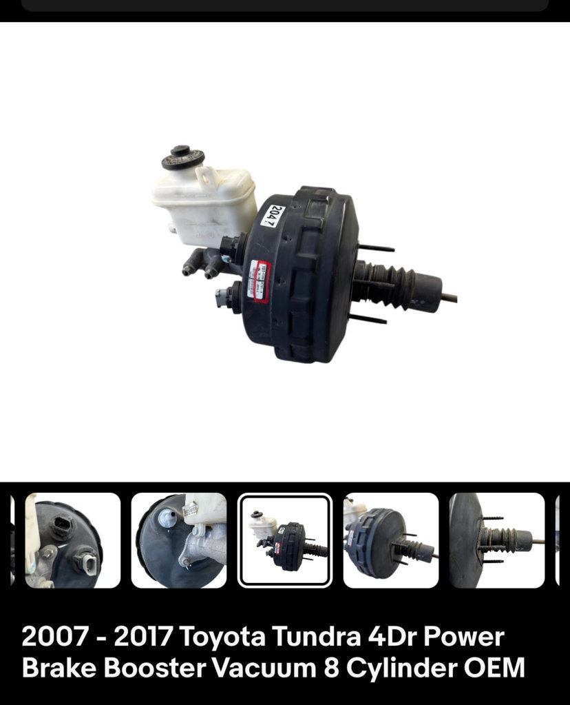

    Is this the correct adapter?

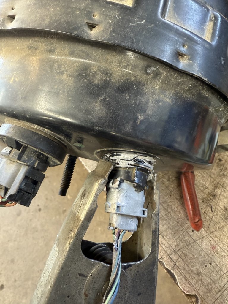

    Tundra brake booster swap is done. However. I was sent a booster with a broken fitting. I’m going to reach out to the seller (lkq on eBay) and check with Toyota. Does anyone happen to have a junk booster with that fitting I need? Truck is currently down.

    Was this the correct adapter? Can you post the link to where you found them?

    That was the correct adapter.

    Hey, I'm finding that it's a stroke sensor and ONLY available with the booster so don't break it if it doesn't come off easily.

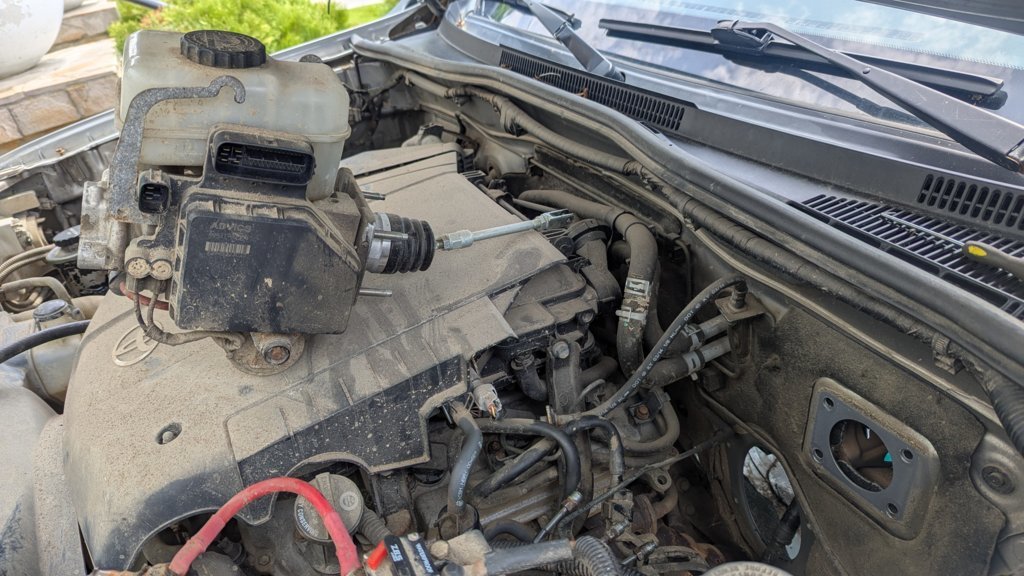

    I got my Tundra booster and brake cylinder installed. Yes, it's a huge difference. I actually have brakes now. Too much in the front actually that I may have to put a proportioning valve on the front to back them down a bit but I want to give it a run in the dirt first. If my brake system before was "good and working" (I don't know if it truly was) this Tundy swap is a 75% improvement. I'm on 35" tires with stock front and rear brakes. Install was easy too. Only needed 2-short lines, 2-female couplers, 2-12mm-10mm adapters and the pedal rod extension.
