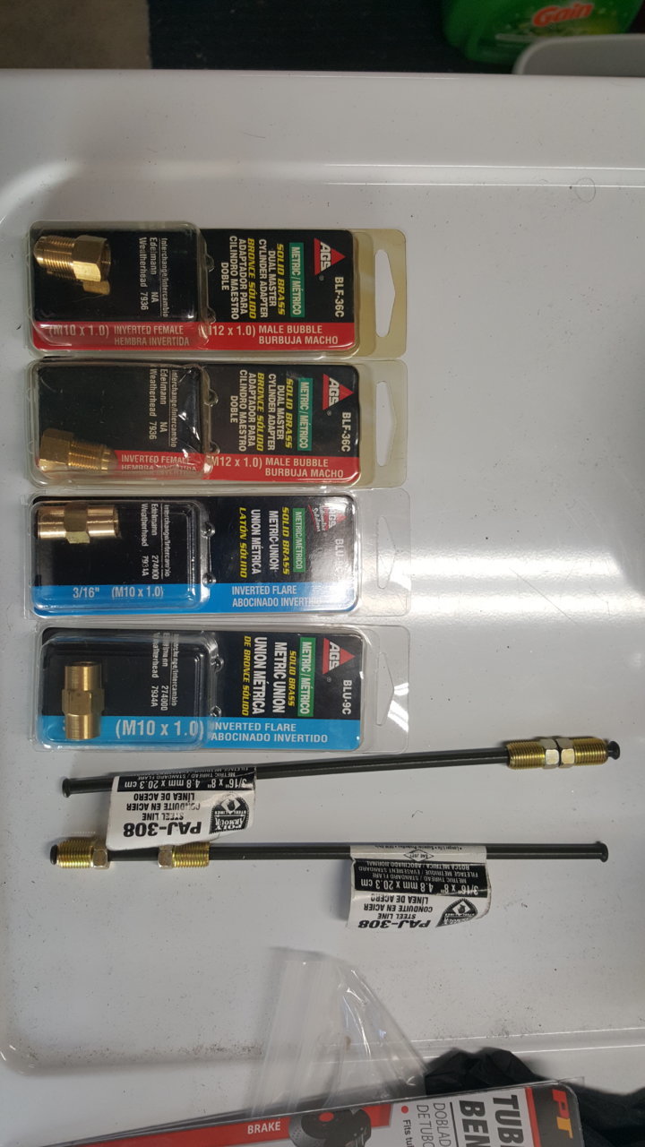

    I found all the parts at a local Auto Zone

    07 DCLB
    Nice! All they had at my local autozone were bubble flare fittings.

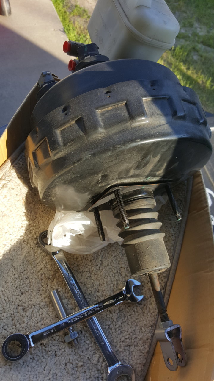

    Here are the AutoZone parts... NOT! WRONG, DONT BUY the parts I did and get stuck with your truck taken apart! Lol, take advice from the professionals :) 20200227_161653.jpg
    Prepped the brake lines
    And booster is ready to go in, just need a bout an hour or two20200227_162514.jpg

    I didn't see some of this post previously... how are you planning on extending the Tundra's brake booster actuating rod? Wait a minute, is that the booster rod's extension under the wrench? What parts did you use to achieve that?

    07 DCLB
    Your m10 female x m12 Male adapter has a bubble flare on the m12 side. Not sure if that'll work correctly.

    07 taco 4x4
    Long story.. i can try to find it! It was part of a kit for the swap which came with brake lines but I didnt want to swap my lines. I got my parts for this swap over a year ago but havemt made time to swap it. If you can find a supply place with metric parts like rod and threaded coupling you can make one

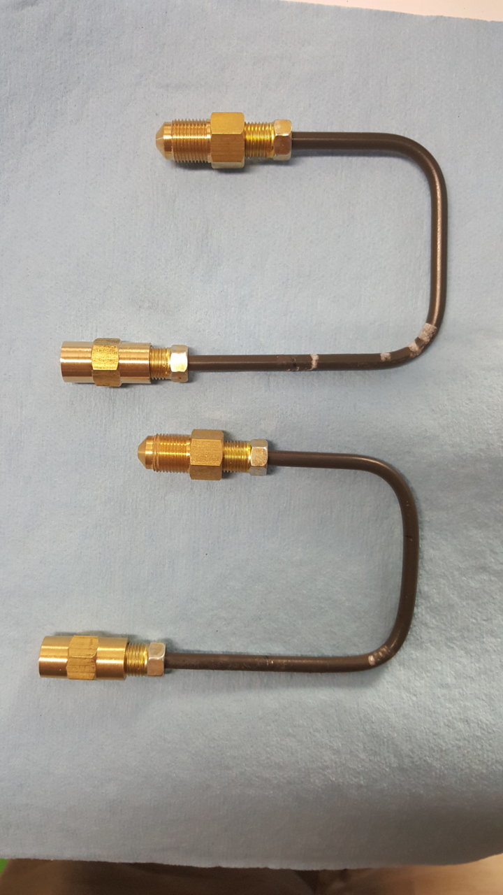

    I hope for my sake you are wrong :) .. I have my truck all taken apart, whats the difference?
    Edit: I see the difference, I think I am wrong..
    So I went a different route after serching all day for the right m12x1 to m10x1 adapter. I changed the whole lines that have the right ends on both sides20200228_201112.jpg
