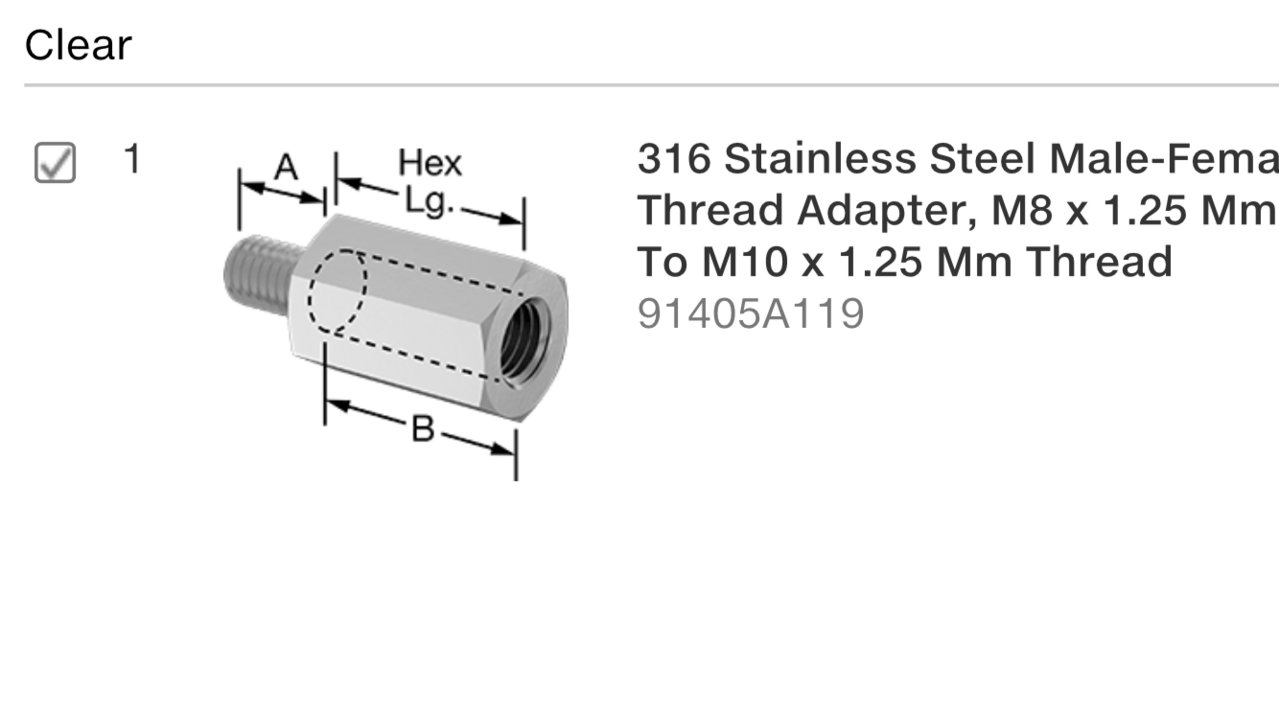

    They also sell these in all sorts of combos and sizes:
    eliminating the need for a piece of all thread. Actually just ordered one for another project. Their shipping times are slow now though. 2-3weeks

    I gather the thread pitch on the tundra actuator rod is 10x1.25. Is the tacoma the same, or is it 8x1.25? Do you have to use the Tacoma clevis part or will the tundra one work if you simply extend the rod with an extension? According to the OP, the difference in length is 9.25 vs 7.625 inches, or 1.625. This part I found is 10x1.25, and 2" lift. Seems like it could be threaded down a bit further onto the existing tundra rod and make up the 1.625 very easily with no welding. But, would have to use the tundra clevis, unless the tacoma one is also 10x1.25. Little help Please!

    The Tacoma and Tundra brake booster actuating rods are both 10x1.25mm. Either clevis can be used but they're different lengths so as long as the end result is the correct overall length it will work. I never measured each clevis for their lengths. These shifter extension rods are looking like the easiest answer to solving the actuating rod length differences between the 2 boosters.
