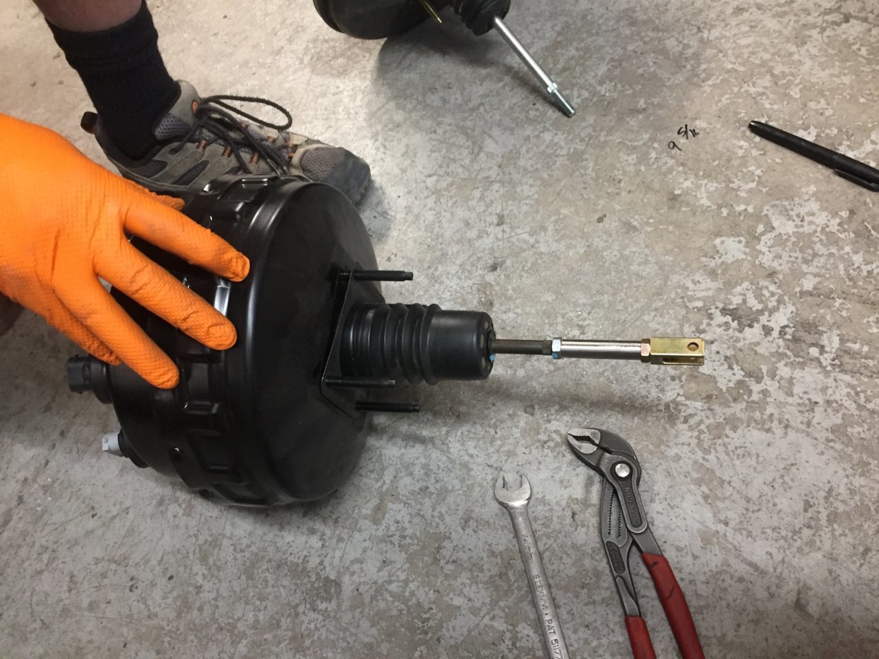

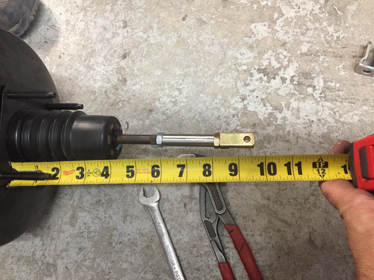

    If you have any pics of this, I would appreciate them. Just ordered and I kinda want a visual before I pull the old Mc and booster.
    Also
    1. When messing with the new booster, I noticed the push rod had play left right up down, is that normal?
    2. Anyone know where to get a new check valve on the booster? Mine didn’t come with one. Got it from a parts lot for $60 so a steal, came out of a 2017 tundra.

    You are aware the master is done at same time correct? Lines and adapters needed to make that work, moreso than the extension of the pedal pushrod.

    Yep, already have everything else, I was just debating whether to weld something up, have an adapter machined, or now finding that one you posted.
    Was there any play in the pushrod left and right or is it supposed to be rigid?

    there is play in it, the pedal pushes it in an arc.

    Got it. Thanks. Only thing I have to find is the check valve in the booster or I’ve got a buddy who can get me another whole setup just in case a diaphragm is ripped etc Did I read somewhere that the check valve is like $85?
