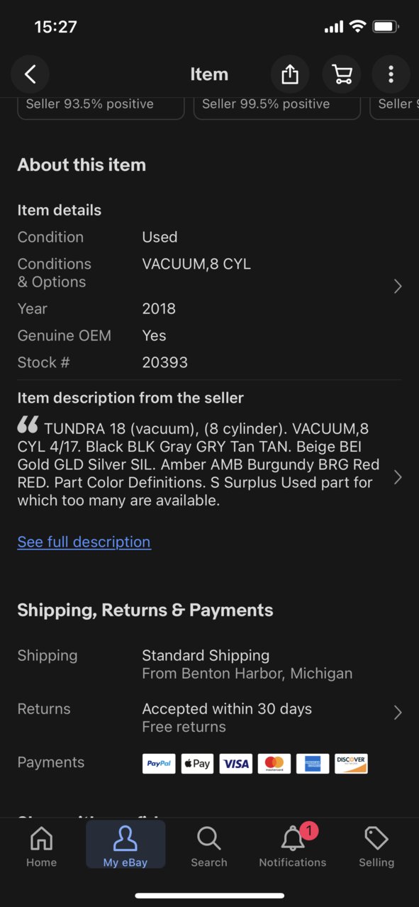

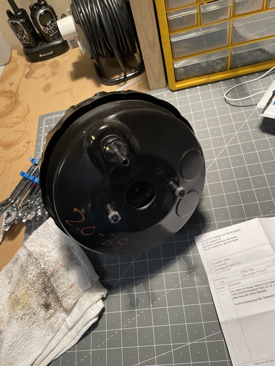

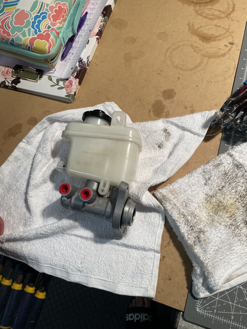

    gents I have a question. I ordered what I thought was a tundra booster and master cylinder from a 2018 but this one looks different than the ones you all have been posting. This one doesn’t have the “electronic ports” on the front like the OP’s does.
    the master cylinder looks to be the right part however....... just need some guidance!
    I have a 30 day return and will send back if it is in fact the wrong booster.
    edit: searched the VIN and it’s coming up as a 2018 tundra 2WD.
    thanks in advance!

    Based on those photos, and comparing against OP's original post, the photos look similar to the Tacoma booster except vacuum port is in wrong spot. You probably need to find a different one to make this work.

    To me it looks like the booster that I used and the booster that you bought are identical with the exception of the missing electrical plugs on your booster. I would definitely try to use the booster that you bought unless you won't be able to install it before time runs out to return it, if you can't install it before time runs out to return it then I would return it and get one identical in every way to the one I used because we know that version works well.

    2007-2018 Tundra master cylinder and booster.
    You can't install Tundra rotors and calipers on a 2nd gen Tacoma, use 4Runner rotors and calipers.

    You have a defective booster, either rebuild it or replace it.
