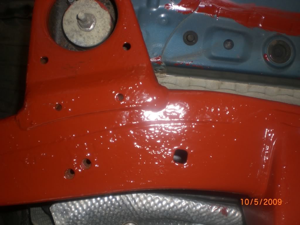

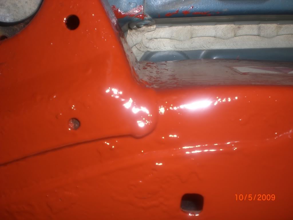

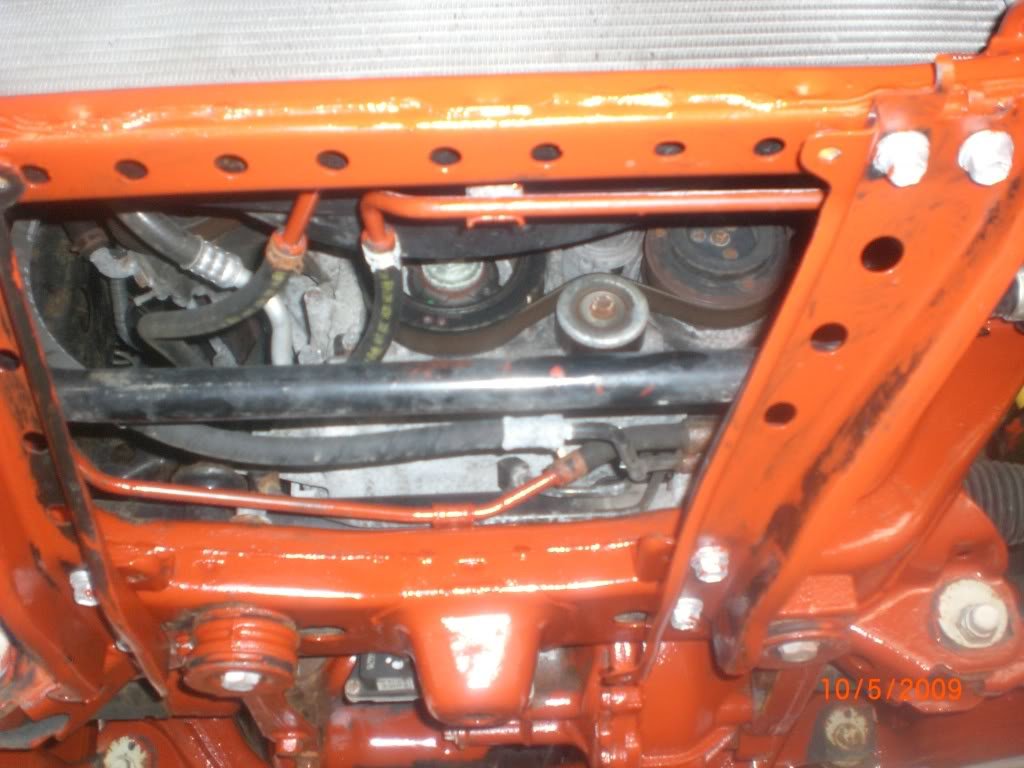

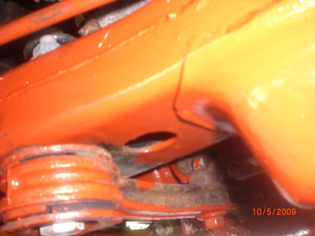

    Here are some pics, unfortunately I started painting my frame but on some you can see rust erosion under the paint
    P.S. On my truck front diff is steel and rusted (now painted a little)
    Work is still in progress but I m plannign to double coat with primer then paint it black.
    You can see some of the lines that I painted due to rust, also (not shown o nthe pictures) brake line connections under the driver side had show lots of rust so I painted them too.
