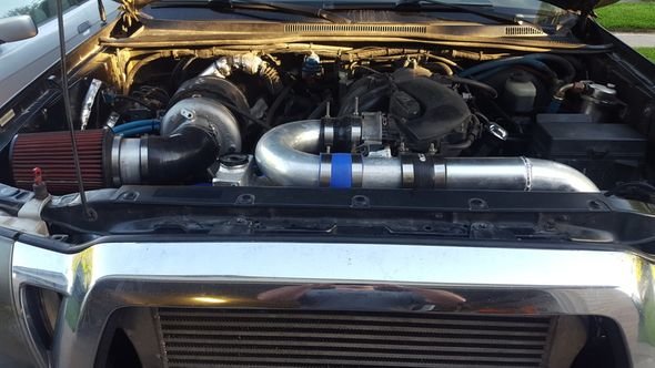

    Also where did you install your maf? Right now mine is laying below the intake plenum with my aem iat sensor tapped into it. It def didnt like it not being plugged in at all

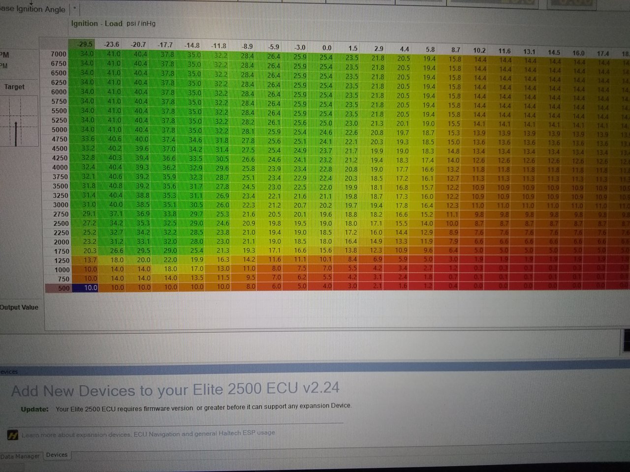

    And lastly can you post or pm me a shot of your timing tables? Was shooting in the dark which I dont like to do with the initial tuning. However really want to keep timing at safe levels as once my timing replacement is done this weekend I'm planning then we're adding the Aem meth injection kit with 5 gallon tank since got the box to put it in next to my washer tank back there now, with straight meth and then going to start increasing boost past the current 5psi. Was thinking 8 maybe 10psi

    In the tubing shortly before the throttle body.
    I will get a photo of it for you will take a few hours.

    Thanks for all your help Torspd. Any pic of your maf placement and those timing tables. Thanks again dude

    You can see the MAF just barely, between the two silicone couplers.

    I totally forgot about the timing map. I will try to remember again, after work.

    Be tuning for the AEM meth kit this weekend and finally turning the boost up to 8ish and see what kinda power I'm making. Don't want to go too crazy on this motor so truck isn't laid up until I do a built motor over the winter. Any chance I can get a peak of your timing maps Torspd?
