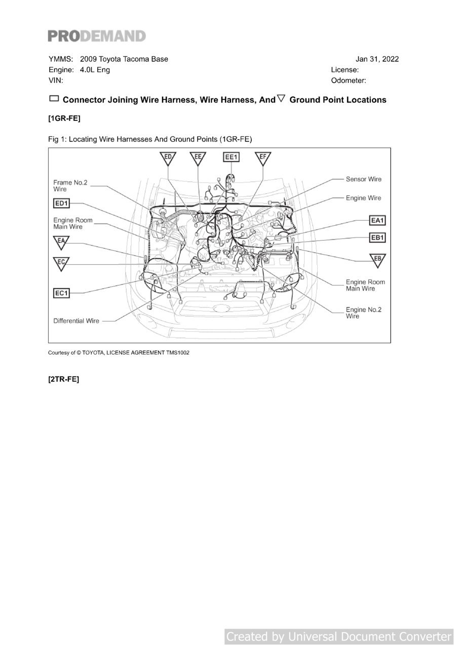

    Dm93
    Dm93 Test Don't Guess
    Mar 3, 2015
    #150066
    13,067
    Texas
    2014 DC OR 6spd 4x4
    Predator tube steps, Ranch Hand grill guard, Magnaflow CatBack exhaust, Toyota tool box & bed mat, 2LO Module by @Up2NoGood, Rearview Compass/Temp Mirror, Tune by @JustDSM.
    You may want to check the grounds at ground point EE, all the coils and some of the ECM grounds are on that ground point.
