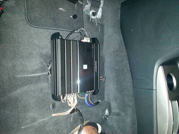

    I was going to install the amp on the box, but there would be no room for adjusting the amp, so I went under the passenger seat, which is a very easy spot to run wires:

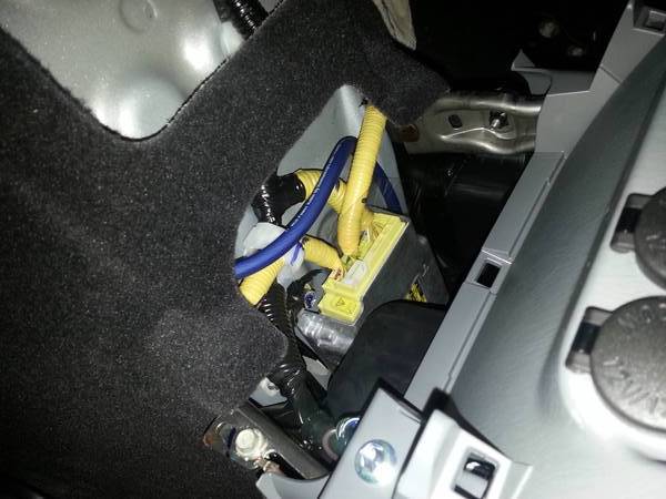

    I ran the power wire through the center console to keep it from the speaker wires:

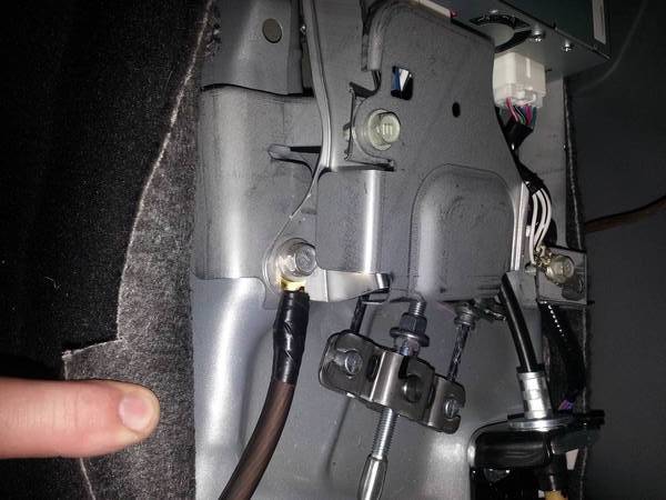

    I ran the power wire from the battery to the fuse and through the firewall where all the wires go (in front of the driver). I found an empty place to put the wire through (under the big spot of wires), but I could not fir the 4 guage wire in the hole, even with grease :( so I ended up pulling the plug/gasket out and running the wire through, then put the gasket back in. This could leak over time I guess, but no issues (or light can be seen through the edges) now. Here is my ground:
    It seems to touch metal here and all over the structure.

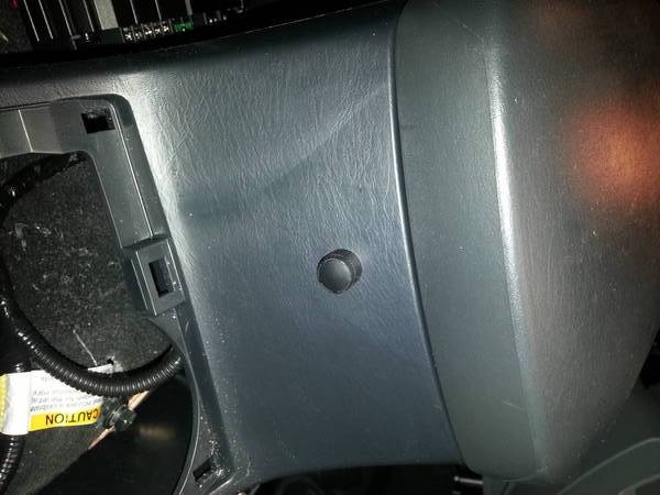

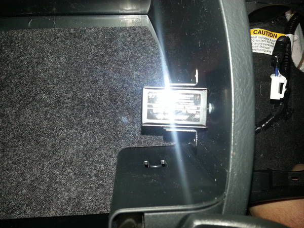

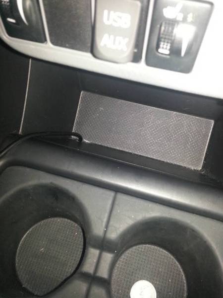

    Next I ran the sub control module. I wanted to have one, but not where everyone can see it and not where it is hard to reach, so I mounted it in the center console, where I can turn it right from where my hand lays anyway:
    I think this turned out well:
    See you on the next post

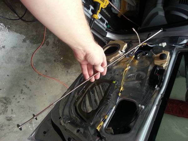

    Wait wait, I want to show you my favorite tool for this job. It helped me run the wire through the firewall, the wires into the doors and under a little bit of carpet under the seat:
    This tool has been on my garage wall for 5 years and done almost nothing until it saved me unknown hours here on this job.
