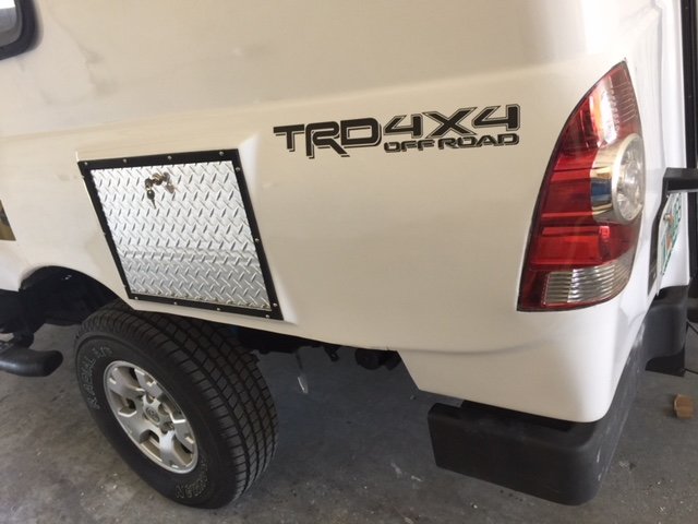

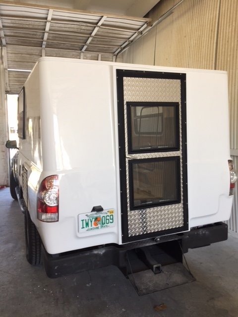

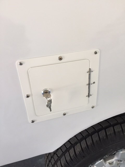

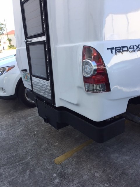

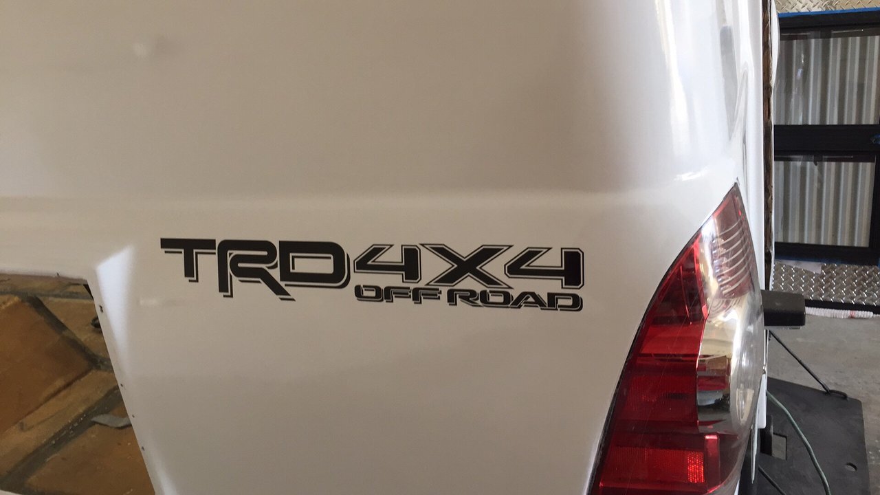

    Installed the back door, side hatch, shore power hatch... it's fun bolting on the shiney stuff... and the TRD graphics!

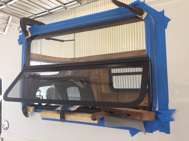

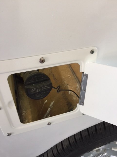

    Bedded in the windows and installed the fuel fill hatch. Going to try to get the roof back on tomorrow so I am weather tight. The exterior is getting close to finished. I have the utility boxes, wheel wells and LP mounts to do... then on to interior finishing!

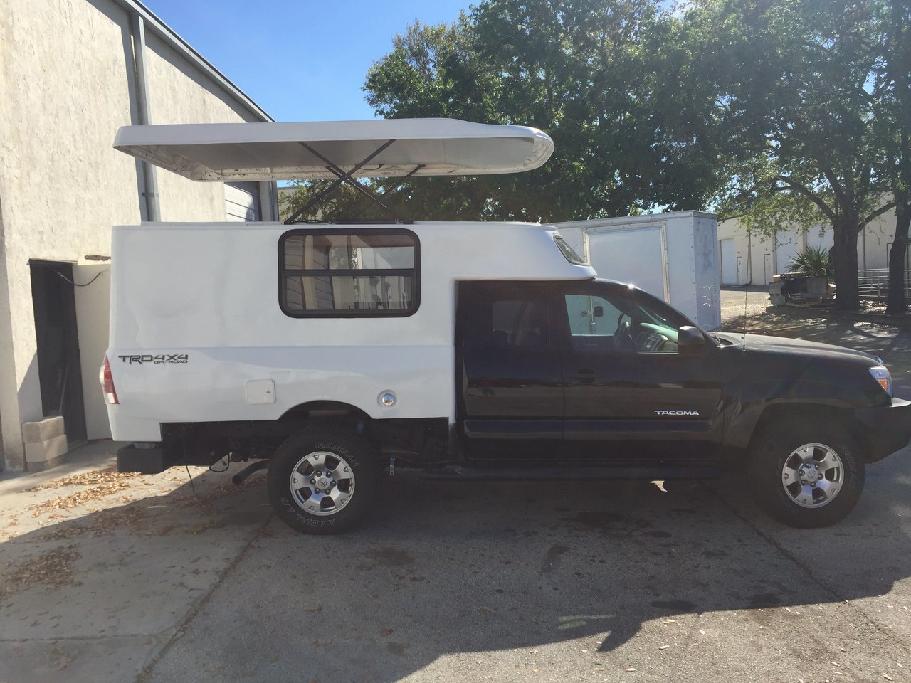

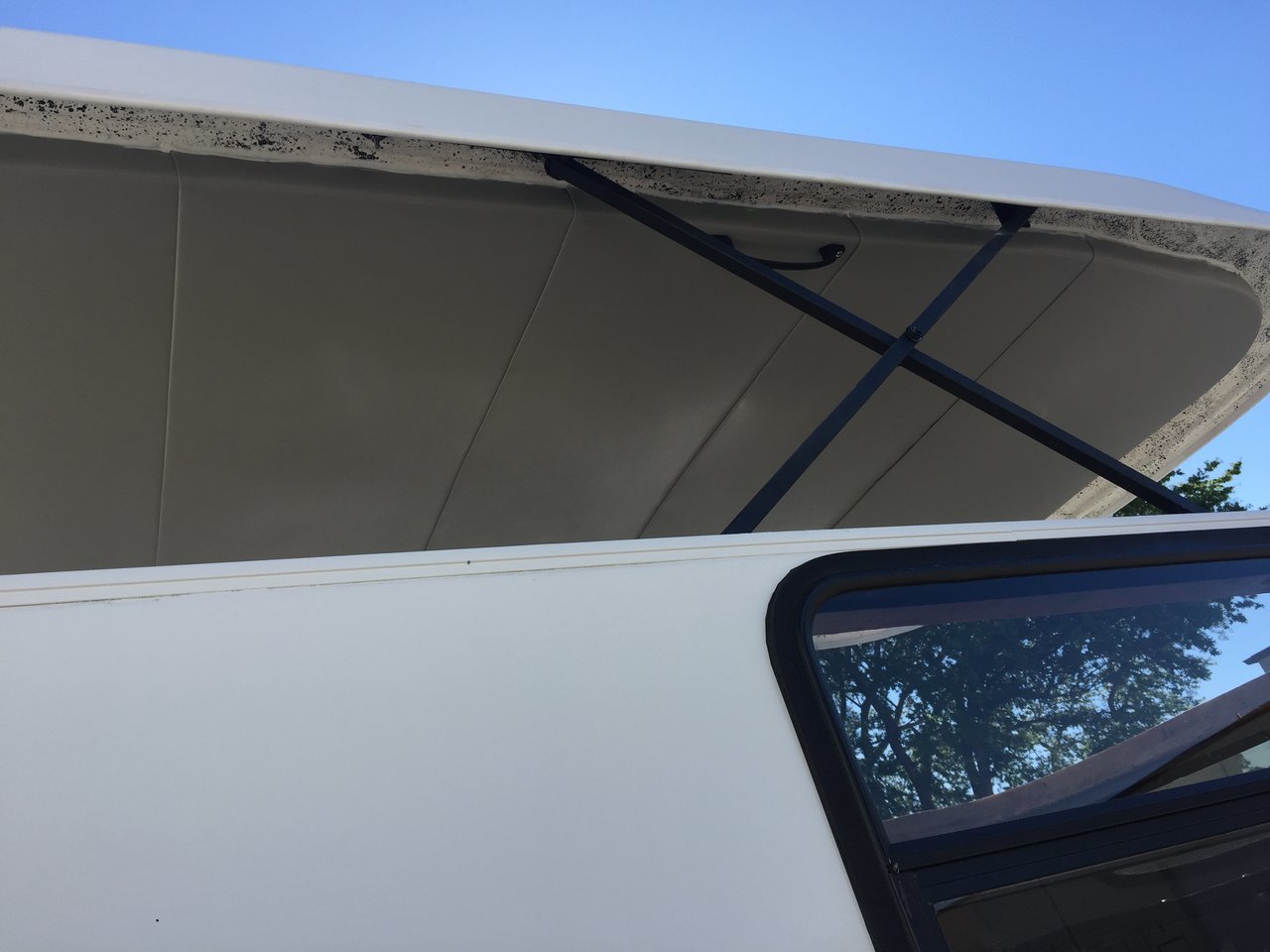

    Got the top mounted... it is all weather tight now...

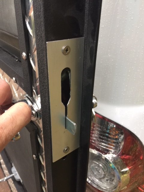

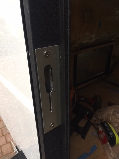

    Have some fabricating to do on the door latch... I asked my neighbor Stan the machinist if he had a square tiny rat tail file so I could open up the square latch mechanism... he said hold my beer.

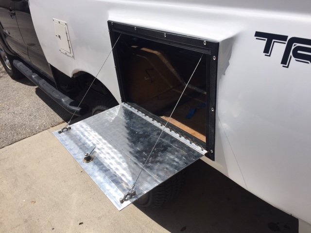

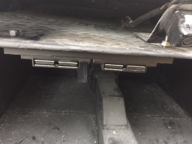

    Took care of a bunch of little stuff today. Installed the magnetic catches on the step bumper... fabricated and installed the plates for the jamb and door for the latch... installed the stainless steel cables for the side hatch for my outside grill area and redid the ss cables on my step bumper. The last ones were a tad long so the step was not level when open... The cables are swedged on and then covered with shrink tube...

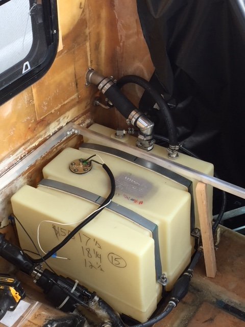

    277
    Also my extra fuel tank system works great. I was low on fuel so I filled the auxiliary gas tank and then transferred the fuel to the main tank... turn a gate valve 90 degrees, pump the priming bulb a couple times and perfect syphon into my “Y” fuel fill splitter. I wanted to test it all before I built it in...

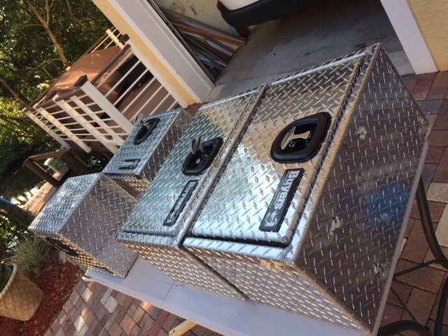

    Got the utilility boxes clear coated with Everbright. .. had some left over from coating the tuna tower on my boat (just sold)... great stuff. Apply with a foam brush, self leveling. with the coating I dont have to constantly wax the annodized aluminum! Boxes are ready for final installation so I can template out the diamond plate wheel wells.

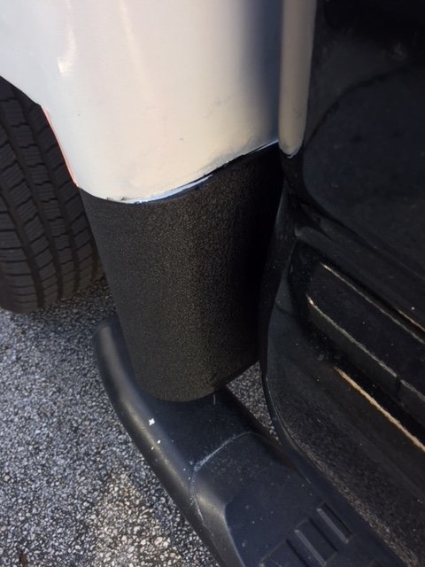

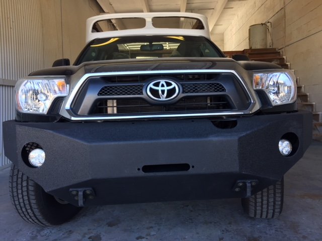

    I got wrinkle coat finish on my side brush guards and back bumper today. Now the utility boxes can go in!

    ... I am on the home stretch on the outside! I have a brush seal finishing between the back bumper and camper shell going in tomorrow as well as the utility boxes. The LP mounts are under way , 1/4" aluminum plate...
    still need to fabricate the diamond plate between the utility boxes that will include the wheel wells. It will look badass, at least it does in my mind!
