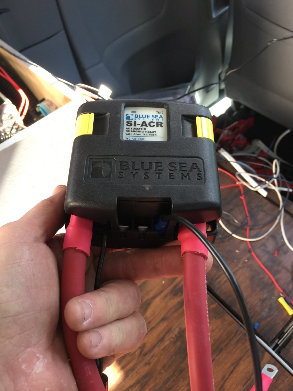

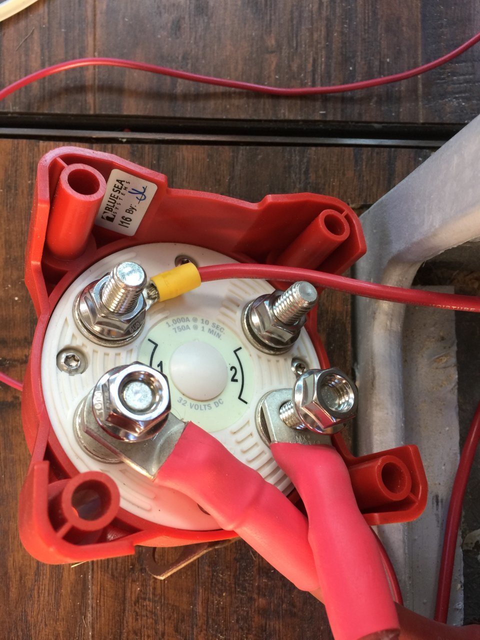

    Great progress on the wiring... all the 12 volt is wired and the house battery wiring is well under way. Did find and confirm the green/yellow wire for the starter circuit to tie into the isolator...thanks again Left Coast Nerd! I am able to tie in to it inside of the main fuse panel box which makes for a clean job! The #1 battery cable is in plastic wire loon and mostly run... still a bunch of split loom and a couple million wire ties away from calling the wiring done. The battery switch gives me the option of having the house battery completely off so no drain when not in use and to combine the batteries for jump start if needed.

    The electric is all connected and tested. The 2 battery system is connected through the isolator and the house battery is mounted in the back bumper. A milestone! The interior finish is pretty simple from here. I see the light at the end of the tunnel!

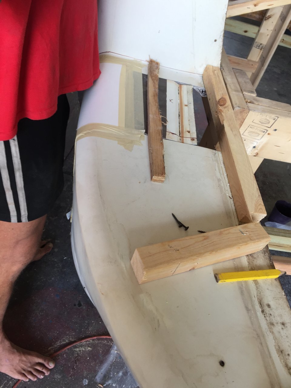

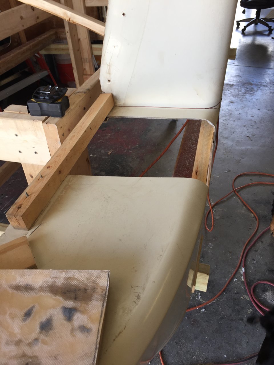

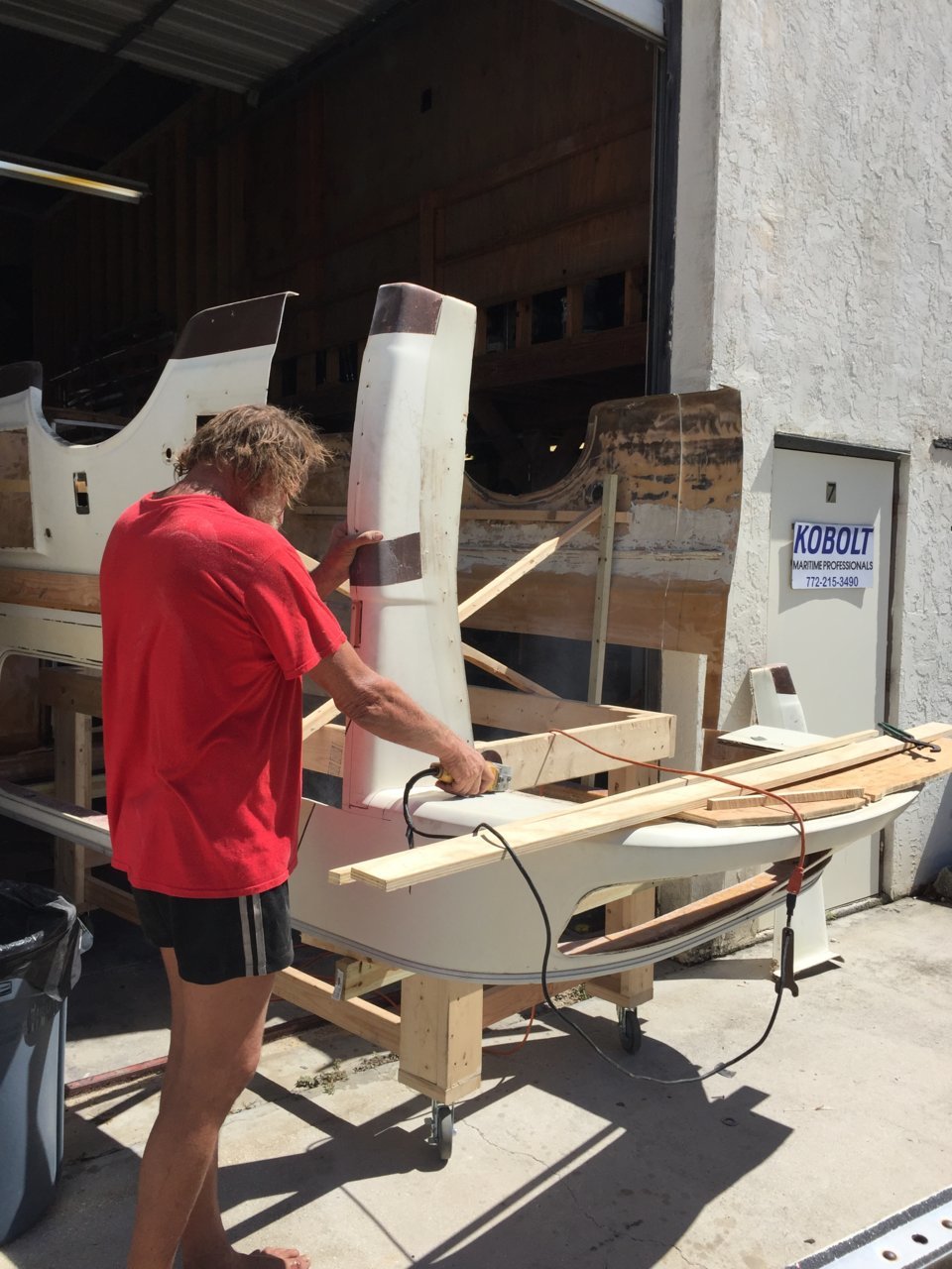

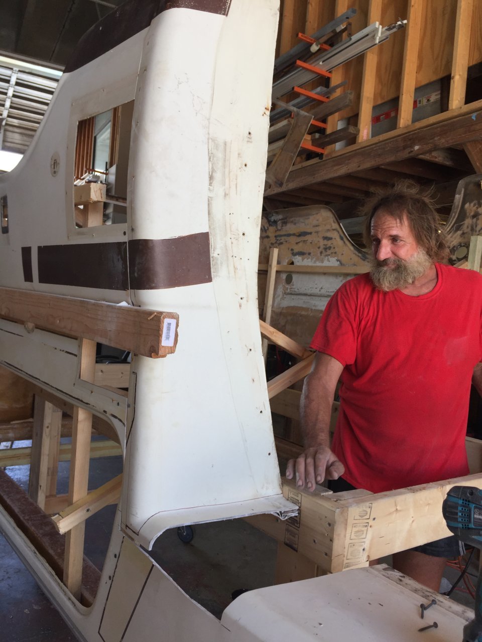

    jaybashant i have a chinook slide in camper and i want to remove 12" from the front which will make the top longer and will make it fit on my truck better. i saw you did this same thing. any information you can throw my would be very helpful ive never fiberglassed before so any info will help thanks

    Do some research on fiberglass work ... you can use polyester, vinylester or epoxies resins. Make sure you grind all the surfaces that you are laminating or you will not get a good bond. Grind off all of the Gelcoat to bare glass...after you make your cut, use a piece of plywood and drill and screw the pieces where you want them from the outside and then glass the inside first.... good luck!
    Attached are some not great photos of mine at that stage...
    PS...fiberglass work sucks! Cover up really well when you grind. Wear a respirator and eye protection. Baby powder the crap out of all your skin and it helps keep the itchy shit out of your pores!

    did you use mesh and resin or just resin? also did you just put the two pieces together after you removed the 10", resin and mesh from the inside only? also did you leave a gab between the two cut pieces or did you butt them together? sorry for all the questions

    The cuts were butt together and then we had to make the 10" section over the cab....used both fiberglass matt and woven cloth for strength. Also to fill in where the window configuration was changed... see if you can get a boat or body shop guy to help or coach you.... it may not be the best first fiberglass learning project... it is pretty major.
