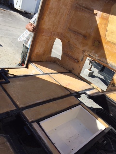

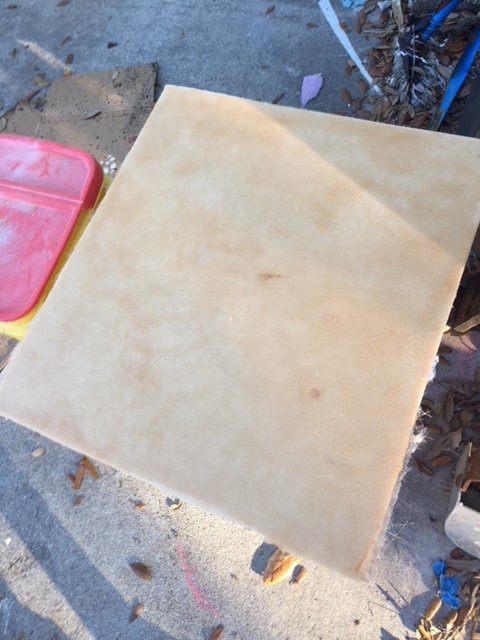

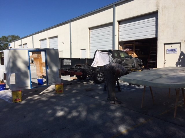

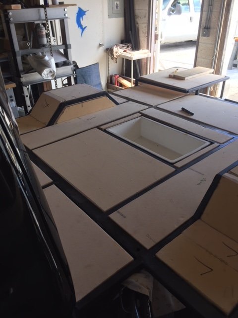

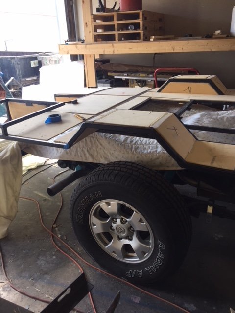

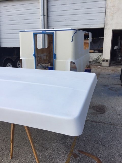

    So, tomorrow is the day to finally join all the pieces...pulled it apart again first thing this morning.... the steel frame is all painted. The foam floor inserts are all fiberglassed on the bottom side ... after the shell is installed the camper, floor and steel will all get laminated together.
    It is a puzzle to put it together. The steel floor first then fiberglass camper then the steel floor has to be lifted in front to install the cab frame.? The camper shell is being sandwiched between the cab and the 1"x3" steel frame. The seal is being done with a butyl rubber gasket and 3M 5200 chaulk.... 5200 is one if not the strongest marine sealant.

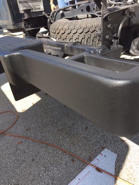

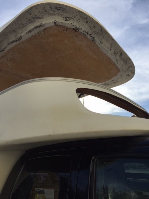

    I got finish on the back bumper using a shaker can bed liner. Came out pretty good! Also got the outer under rim of the pop up camper top painted in a white bilge paint and spatter coated with black. It will only show when the top is up... we are boat people and I am using materials I know from boat construction including the structural foam used in my composite floors...

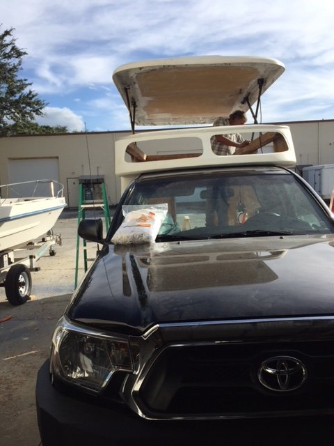

    Well I will not get to mount the camper until Monday. Just not enough time in a day. Had to cut and fiberglass the rest of the foam panels for the wheel wells and back corners. After fitting them it made sense to glass them in from the top....
    I had planned on doing that after the shell was mounted. I had to not install a few floor panels where we need to mount the water tank. The inside of the wheel wells will, be fabricated in aluminum diamond plate and tie into the under body utility boxes. Monday the floor section comes off and will be sprayed with a rubberised black undercoating. Water tank goes in and then the camper gets mounted.
    Got a coat of white primer on the pop up top as well...

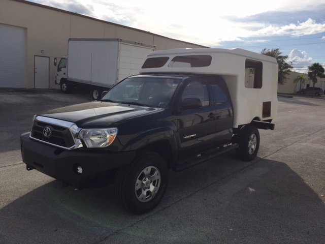

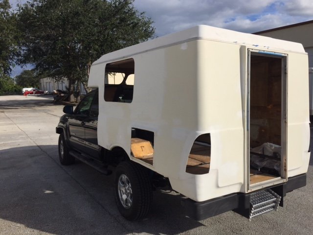

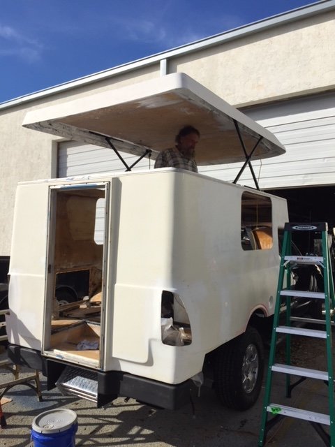

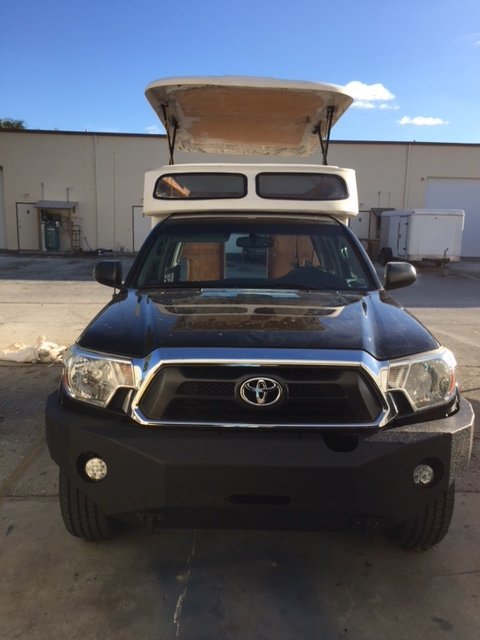

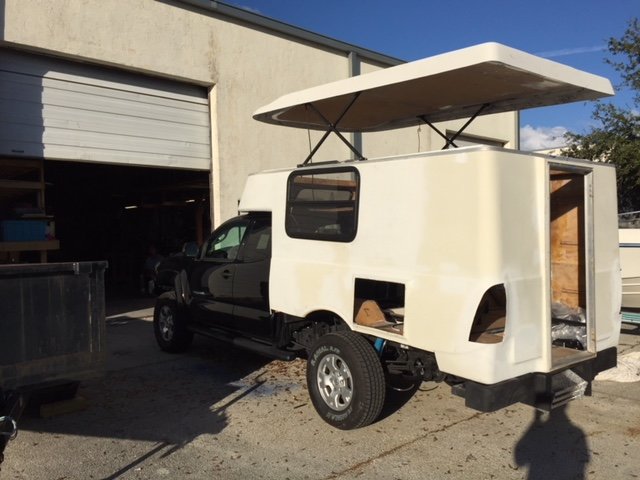

    The camper is mounted! Rubber gasketed, tech screwed, through bolted and then the shell is glassed to the floor and steel frame...
    The pop up top is temp mounted. the scissor ladder is mounted in the back bumper and the generator is finalised with the muffler mounted remotely behind the bumper.
    Next the 4 diamond utility boxes get permantly mounted...
