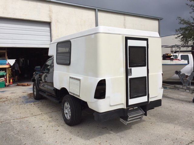

    There is a black butyl rubber gasket between the fiberglass shell and the cab as well as a bunch of 3M 5200 Marine chaulking. Then on the inside is a custom welded 1"x3" steel frame that is through bolted with 3/8" stainless steel care age bolts...sort of sandwiched the shell between the steel frame and the steel cab...

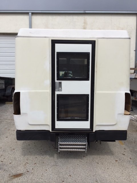

    I got the back door rehung today with the new crank out windows.
    I took it for a drive today (with no tail lights and did not get stopped) and it feels great! Not heavy or awkward... no weight issues at all. I think that the steel subfloor and camper shell and generator weigh about 900lbs... I probably took about 300 or so lbs out of the pickup with the cutout, back window, bed, fenders and tailgate... so estimated 600lbs added so far.

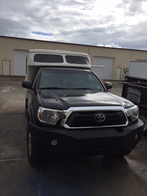

    Thanks shark! Amazingly the factory mirrors are wide enough.... it still drives like a pick up.
