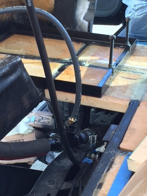

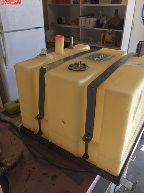

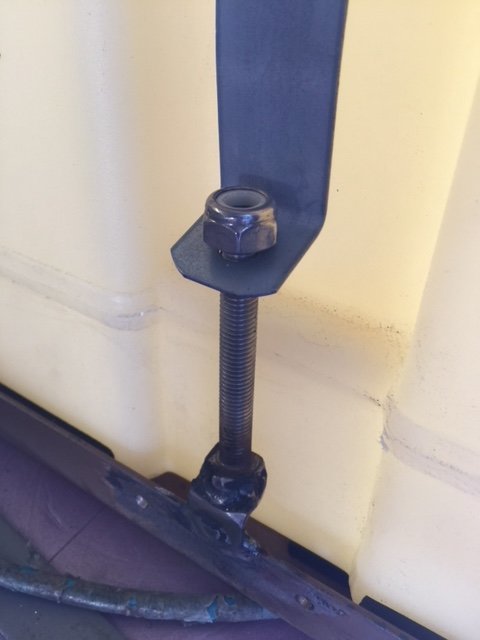

    Got the spare fuel tank mount fabricated. Steel angle base with galvanized straps with nut tensioner. The angle will be welded to my steel subfloor frame.... rubber spacer will insulate the plastic tank from the frame and mounting straps to avoid any possible chaffing...

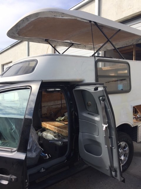

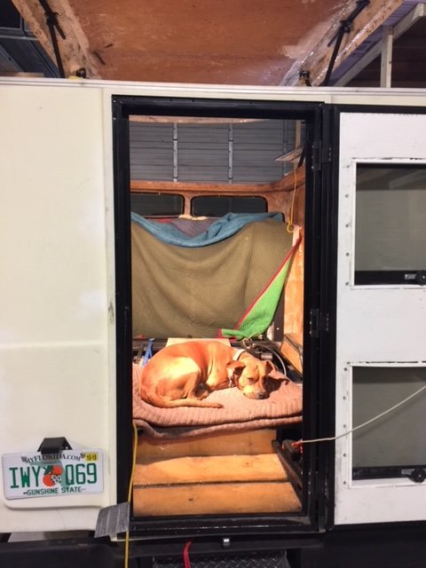

    Cool today. Pat's dog Sparky was hanging out under the drop light for the heat.... Lots coming together. Fabricated a couple of floor pieces with divinicel laminated with fiberglass, made a call to extend the rear bumper to the aluminum utility boxes. Pat worked on that... I was going to have to fabricate a filler and this is easier and adds more heavy steel to protect the rear quarters... also scrapped my sexy diamond plate scissor ladder for a step hatch to fold out of the back bumper... this gives me a space in the bumper for a house battery (or 2) plus we can extend the trailer hitch reciever...win, win. Located a space for this little safe in a future cabinet. Tiny but room for passports, cash and a handgun.

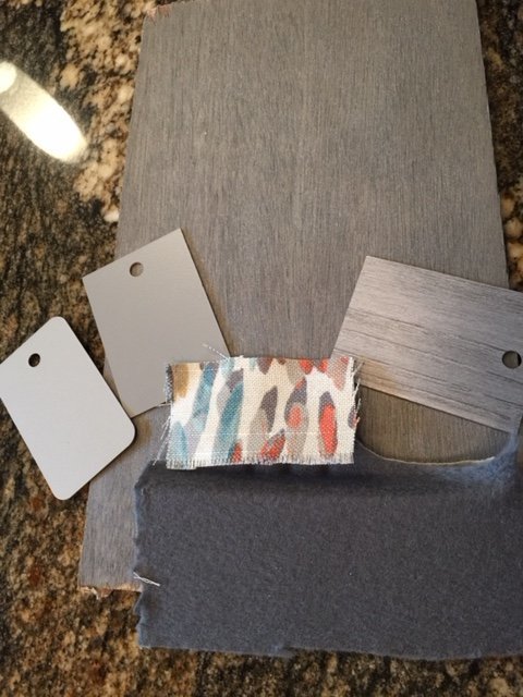

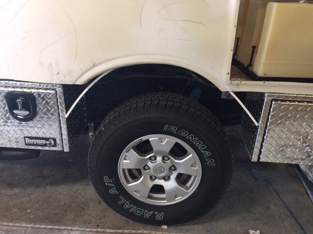

    Hoping for a big push this week. Ready to pattern out the diamond plate wheel wells and tie them into the utility boxes. Also hope to glass in the last couple of foam floor boards after finalizing the water system plumbing and the gasoline fill split to be able to syphon feed my spare fuel into the main tank.
    Also need to glass in some structure where I need it ... propane tank mounts, tiny flat screen articulating mount, electric panel mount etc... in general I want to be done with the fiberglass work inside.
    Then the interior build should be pretty fast. Attached are some choices on interior finishes. Ceiling a pale grey upholstered vinyl... most walls in a non woven hull liner polypropeline. The few cabinets built ultra light of 3/4" welded aluminum frames covered in Formica over door skin... a little color with the upholstered sofas/bed... and a glue down vinyl floor.

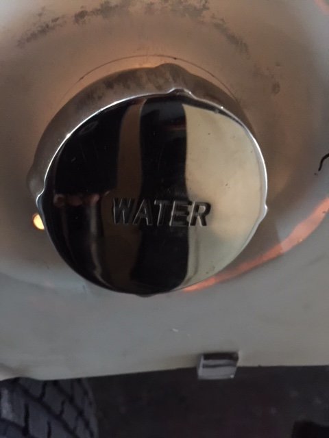

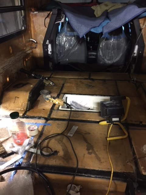

    Got the water tank fill plumbing done and the fuel system connections made below floor for the auxiliary fuel tank.... needed to extend the factory gas fill to reach the camper wall where the locking fuel fill hatch is to be installed.
    The extra gas tank of 15 gallons will have a seperate fill, vent and fuel guage... It will syphon feed into where the main tank fill hose was split with a 3 way fitting... used a ball valve to isolate the tank and a pump ball like a marine outboard tank to create the syphon. Super simple and effective.
    Also got the floor to cab floors glassed in and mounted the aux fuel tank frame with hardened carriage bolts through the steel flood sub frame...the plan, after the tank is strapped in with the steel mounting straps is to box it in with divinicel foam and fiberglass so the fuel tank and fittings are completely isolated from the camper living space... coming along.

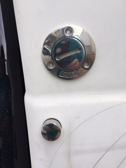

    Finished all of the below floor plumbing for water and fuel and got the last few floor panels laminated in.... the main gasoline fill has been mounted near the camper wall where the hole will cut for the 6"x6" powdercoated fuel fill door.... used a marine fill and vent for the auxiliary gas tank.
    Now that the final floors are installed the auxiliary gas tank will be installed.

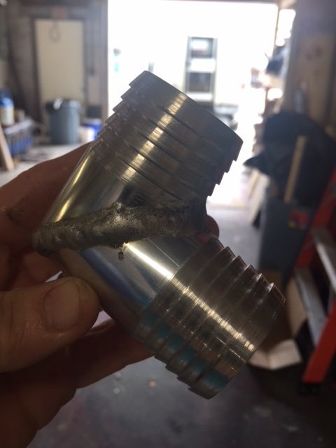

    My neighbor made the fine aluminum hose barb 90° for me... lathe turned then welded... nice to have talent and equipment in the hood.

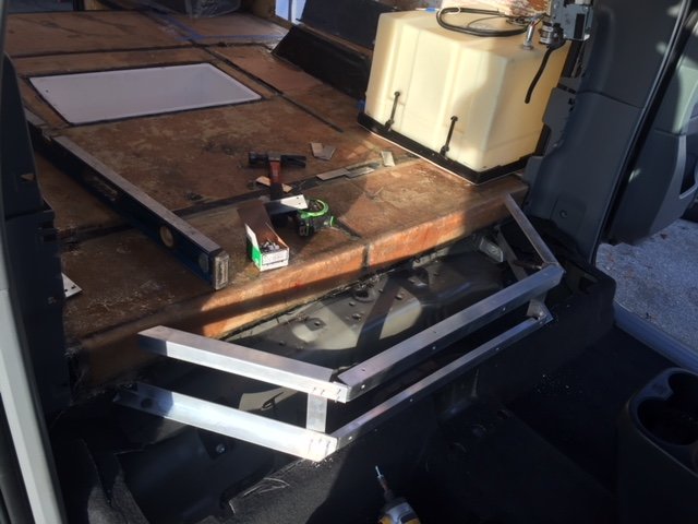

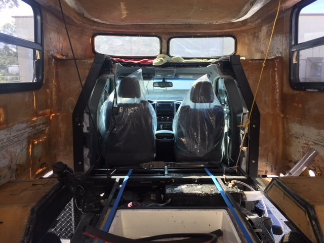

    Began sorting out the interior plan... placed some of the components to get a better feel for the space planning. Framed out to extend the floor into the access cab and create some storage. Both of the seats will still lay back completly....
    Tomorrow the aluminum cabinet skeletons will start to come together. Using angle and 3/4" square tube tech screwed together and the spot welded so they won't squeak or move.... keeping the interior cabinets ultra light.

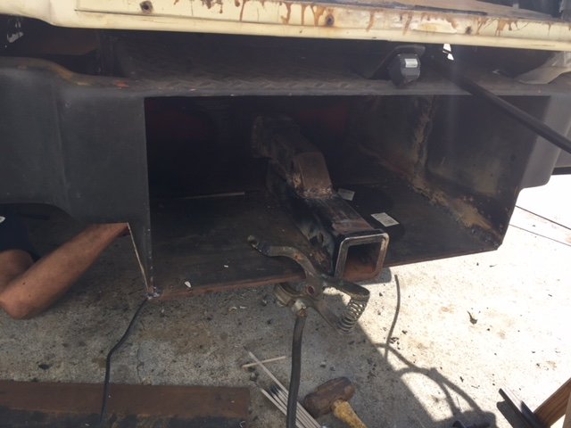

    Sorry for no posts for a bit... got tied up with some other stuff. Making some mods to the rear bumper. Scrapped the scissor stair for boxing in the center of the back bumper for battery storage and a hinge down lid that will be the step... it will be simple and functional. Also taking advantage of the thick walled 2"x6" construction as an air tank...... the back bumper will double as compressed air storage for on board air...

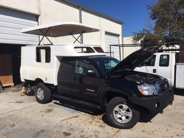

    Back from my travels and I have a little change of focus... my friend who is letting me use his shop is vacating one warehouse month end. I want to plastic it off and do my paint job in it so I am prepping for that... took the windows out yesterday as well as the back door and tail lights.
    I have a bunch of final fairing to do on the body in prep for paint.
    Also was not happy with the back door window position as they were not great for my rear view mirror vis... I am rebuilding it with aluminum diamond plate and a new lock set.
    Patrick is working on finishing the back bumper battery box/step modifications. He will also fabricate a piece of radius steel structure to protect the fronts of the forward aluminum utility boxes which would be vulnerable to branches and brush.
