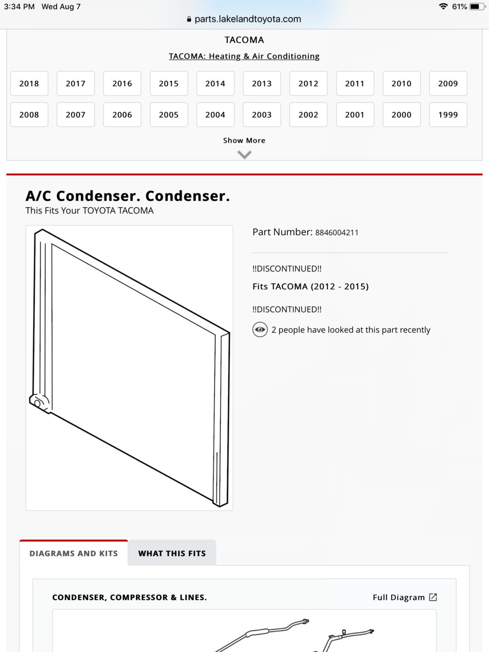

    Dang it! Only 21k miles and a condenser leak. I put some dye in 2 weeks ago and it showed it’s ugly yellow head last night with my UV light. No damage from road debris, just leaking on the side next to the right edge. I think it’s a really slow leak and it’s probably been leaking a long time. Maybe a defective condenser or problems with it since Toyota says that part number is discontinued. Rock auto has some decent prices though. Anyone else have a condenser leak on a 15 with low miles?

    I find it very shocking that Toyota would discontinue a part for a 2015 so soon, is there a new part number that supercedes the old?

    I don’t know. I just search that part number for a 15 condenser at a Toyota dealer to see what a 15 oem condenser would cost and it said discontinued. I then just went to rock auto and Amazon.
