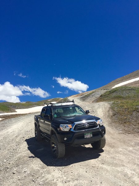

    Sorry dude, but damn it looks great!
    I will be getting a '17 Taco & need the look as well, but also gotta have some additional ground clearance , as I off-road
    My black '13 kind of resembles yours, but with Toy tech basic lift & 285's.
    This pic taken yesterday near Tellurude CO in the San Juan MTns when we reached the easy part !image.jpg

    That's a good looking off road machine Craig! I've been to Boulder many times but never there.
