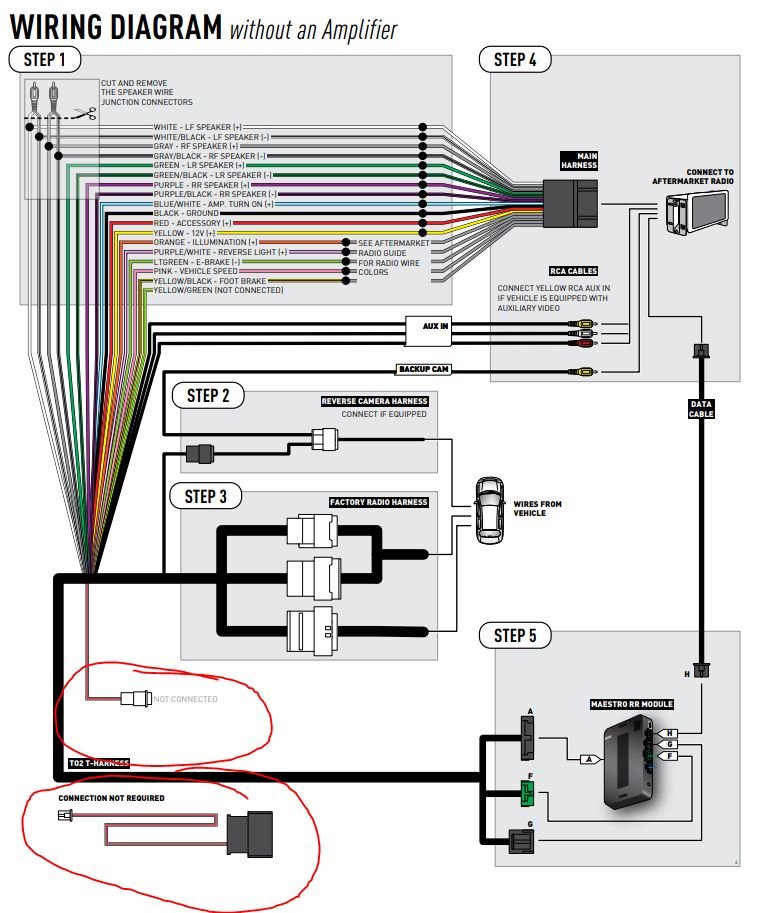

    Removing jbl entune head unit and installing a Kenwood dnx994s with maestro rr.
    Using the TO2 T-Harness and have a few wires left and not sure of the connections, or if used at all.
    1. LTGREEN - Ebrake (-)
    2. PINK - Vehicle speed
    3. YELLOW/BLACK - Foot brake
    Help greatly appreciated.
    Thanx,
    Justin

    Trailer Brakes
    So it is pulling OBDII data. Just hooks in differently. Actually had to figure out how to disable it to get my transmission flashed as it was causing an issue. There is a setting to disable it so the techs tool would flash properly. You can even clear codes from the HU.
    Thanks,

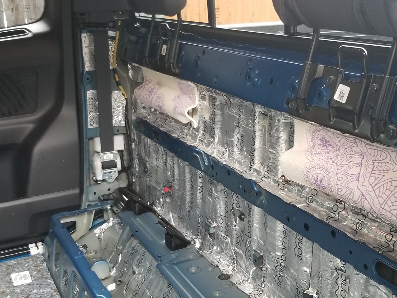

    Try adding a cover over the vents that still allows air flow. I used yoga mats as my decoupling layer, and spray glued these yoga mat scraps to the stick on deadening I applied to the back wall. No noise from the vents now. Not shown in the pic is the yoga mat decoupling layer and the 1/4" MLV layer. 20180602_180200.jpg

    That's a great idea!! Thanks
