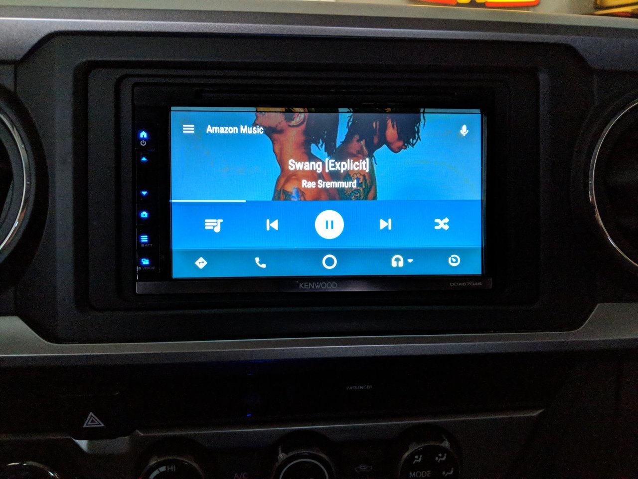

    Does the Kenwood head unit have Amazon music built into head unit or is it coming from your phone via bluetooth?

    Nice build, how does the head unit pull the tire pressure readings?

    Coming from my phone via USB. I bought mine before Wireless Android Auto was a thing..... :(

    It is tied into the ODBII. It pulls all gauges from the Truck, and is configurable.

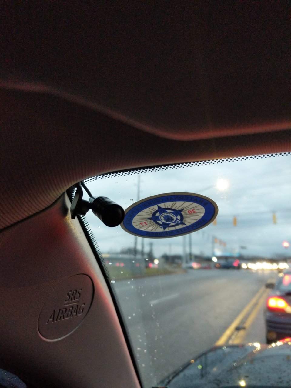

    I know I'm a bit late to this conversation, but what did you do with the mic for bluetooth? Where did you place the new microphone? I know you can't use the factory mic with replacement HU even with the maestro.

    It is run to the driver side A-Pillar. I'll post a picture later.

    I installed my mic just to the left of the rearview mirror in the headliner. You just run the wire up the A Pilar, stuff it up into the headliner and hook it somewhere on the headliner.

    Here is a picture of my microphone location.

    Great build. I like the work you put into it for the clean factory look. I have been reading through the 3rd gen threads looking for ones taking everything out. I was curious what the people you call think of the feedback they hear (if any) based on that mic location? I noticed you replaced everything. I have a few other questions as well if you don't mind answering. You are basically doing everything I want to do and I am trying to learn.

    People claim I sound just fine. I do have to turn the audio up and down depending on the call. It plays out of both speakers. Order thru a local shop. Did a lot of research into what I needes to keep everything stock looking. New speaker wire was run to everything. I listed all the harnesses I used, that should be everything you need to connect the truck to the Kenwood Receiver. If you have any other questions let me know. I am a year into the install and I am still very happy with the setup. I am blown away at how well these little Sound Digital amps work.
