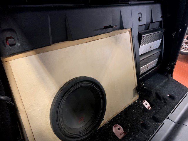

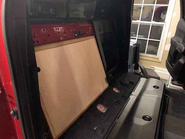

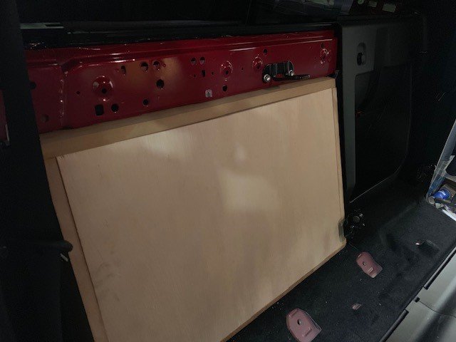

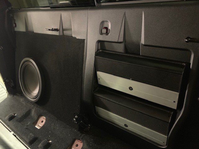

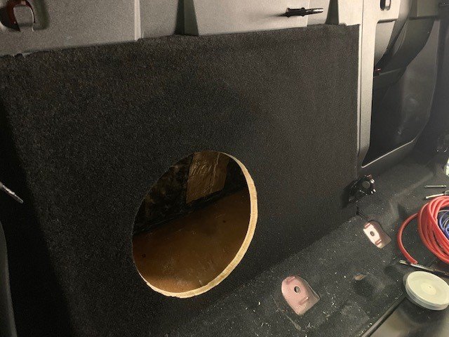

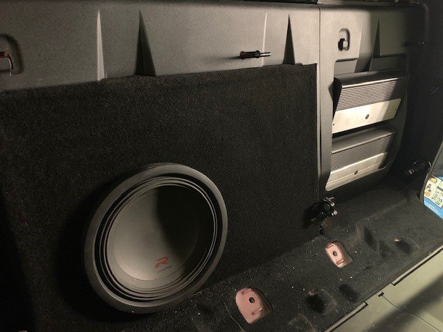

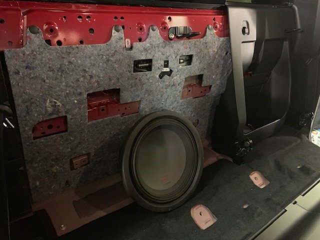

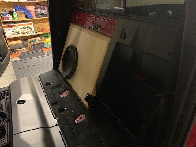

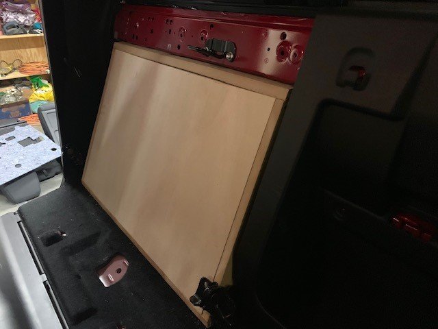

    ok first I am not a car audio pro by any means.. I had some leftover equipment from a previous car and didnt want to buy anything new so...... I wanted to put an alpine type r 12 behind the seat whick required me to take a shot at fiberglass due to space restrictions.. amps are jl xd 800/8 bridged 4 channell for mids and highs and xd1000/1 for the sub.. kenwood 7 inch components in fornt and 7 inch coaxials in the rear. I am overall pretty happy with the outcome. next I will try building some a pillars with mid/tweeter.

    looks great. any issues with the sub hitting the back side of the seat at full excursion?

    no problems... I removed the plastic seat back so there is about an inch of clearance between seat and woofer.
