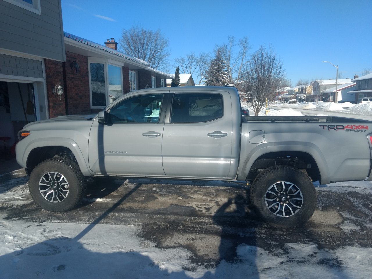

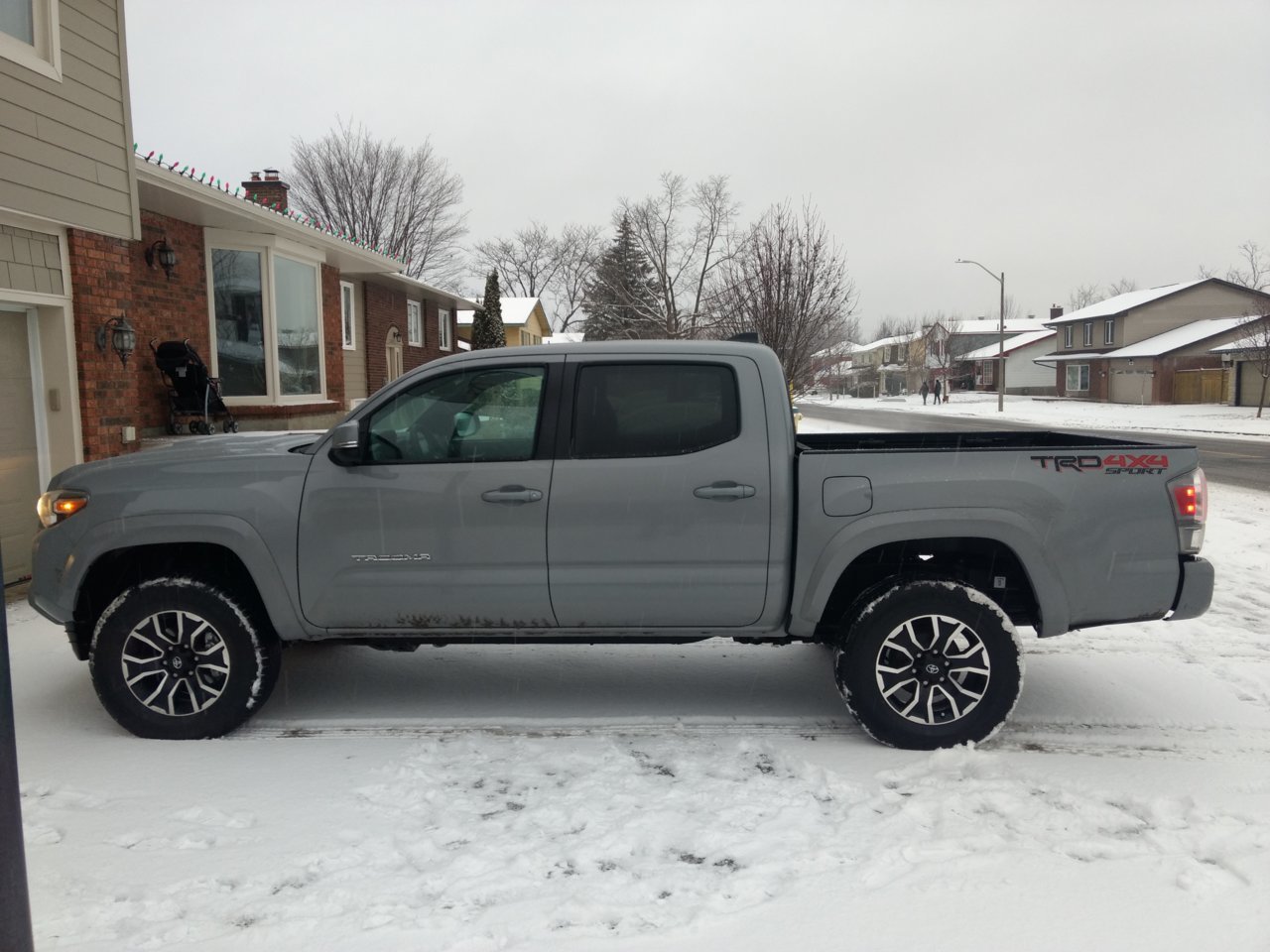

    Here is my 2021 lift before and after
    Here is what went into it:
    Bilstein B8 5100 front
    Bilstein 5100 BE5-B110-T5 rear
    SPC upper control arms 25470
    Old Man Emu #2888 front coils
    Old Man Emu leaf packs el111r with OME bushing kit OMESB108 and OME U-bolts x4 OMEU53B
    Carrier Bearing drop spacer FK-29
    The winter tires are 285-70R17 D8 Nokian Hakkapeliitta LT3 121Q (best I could find, and don't have them in the 75 profile)
    Spidertrax 1.25" wheel spacers

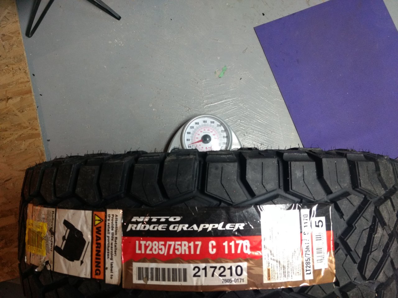

    For my summer tires I went with 285/75R17 Nitto Ridge Grapplers. I found some in C load. They weight about 65lbs. They are bigger than the 285/70R17 winters and would require more cutting

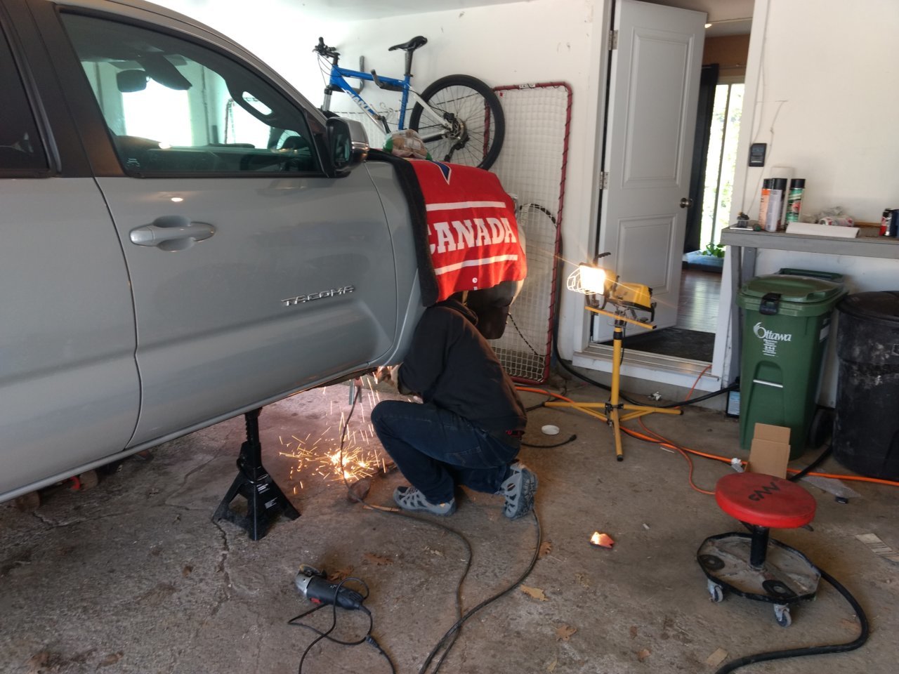

    Here is a picture of my buddy doing the cab mount chop getting ready for the 34"
