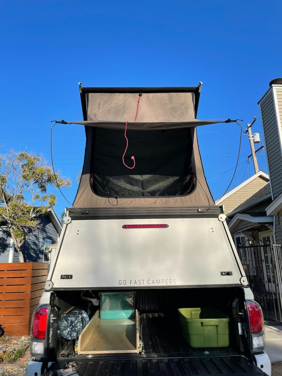

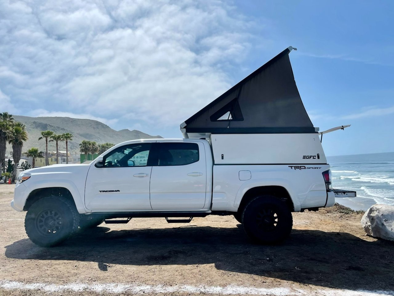

    Mod #1: GFC Camper
    We acquired it from Craigslist San Diego on 2/5/22 for $7,000.
    But, it was originally installed on someone else's White Tacoma Double Cab 6 Foot Bed on 9/2/21 - https://gofastcampers.com/blogs/pro-team/toyota-tacoma-1870.
    Order #: 1870
    Product: V2 Camper Panel
    Color: White
    Install Date: 2021-09-02
    Location: Idaho

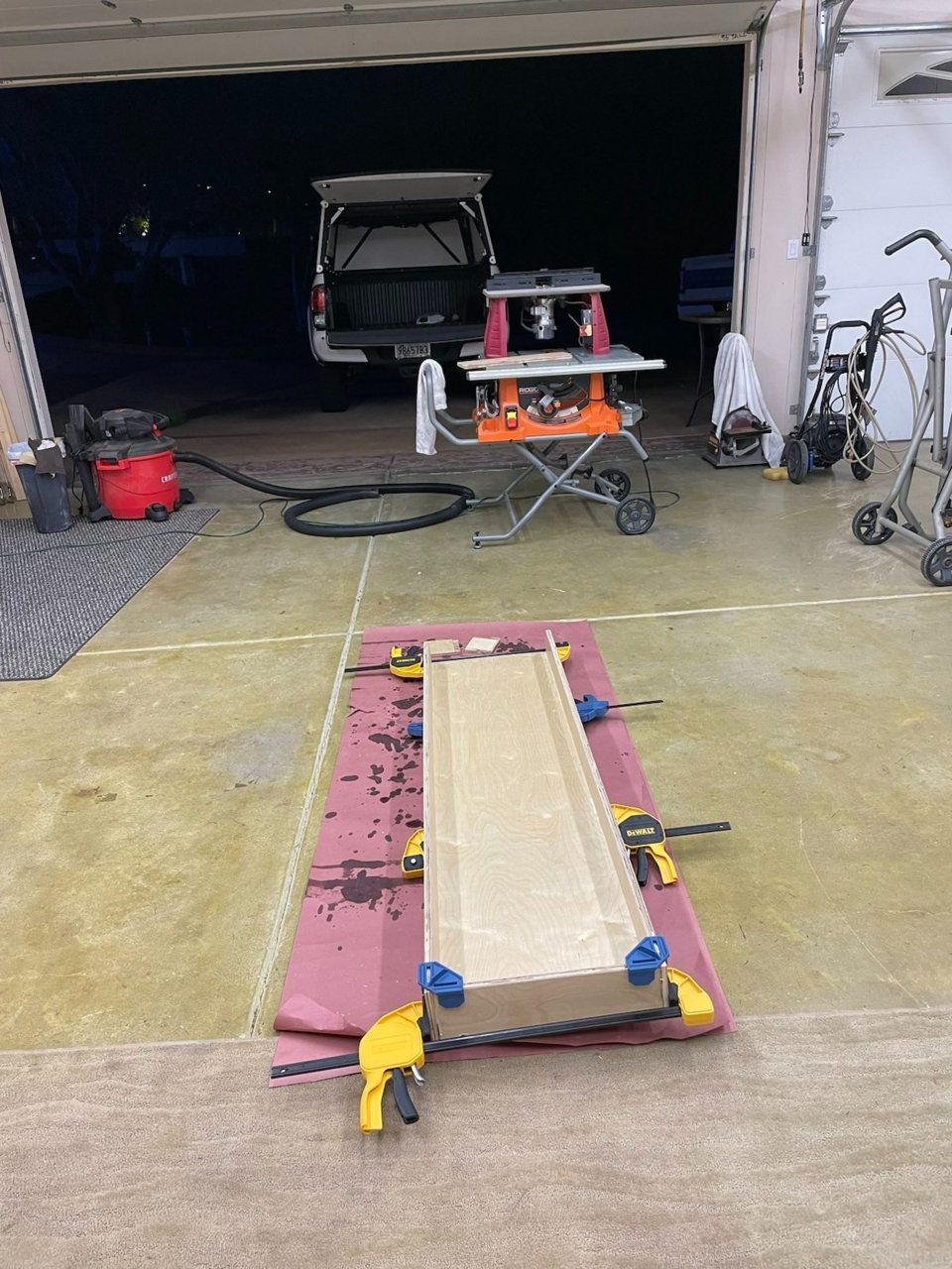

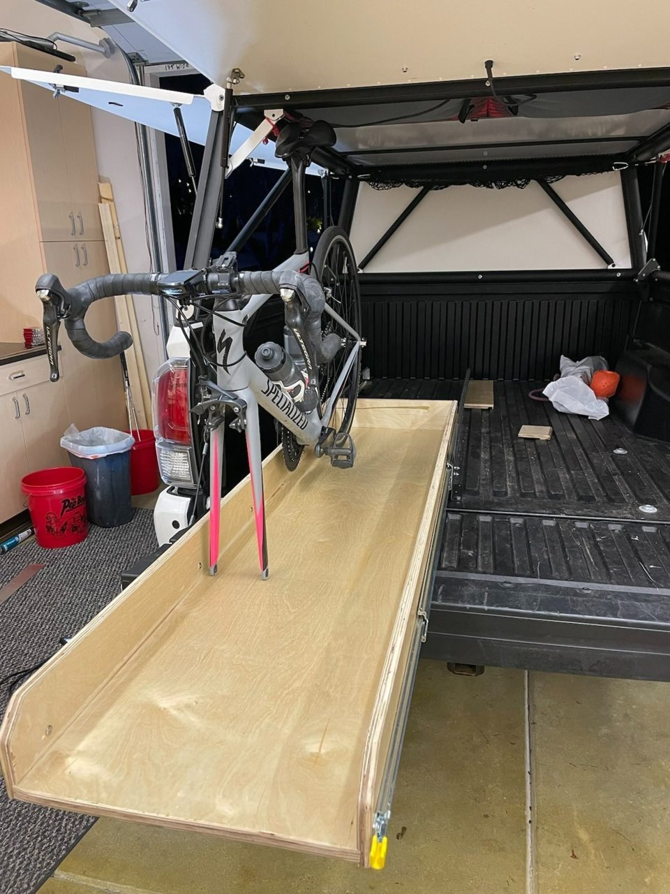

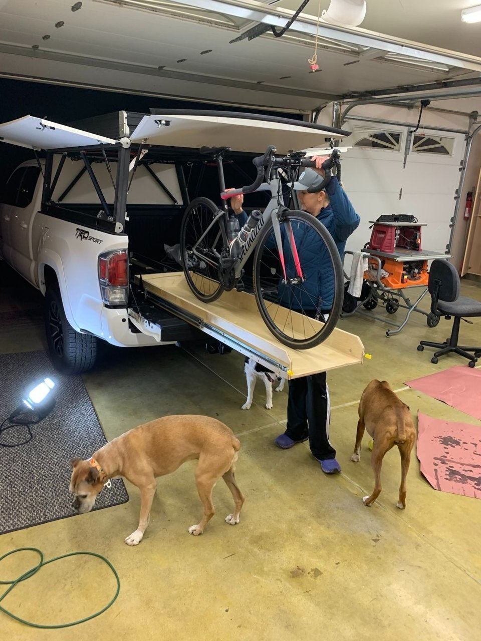

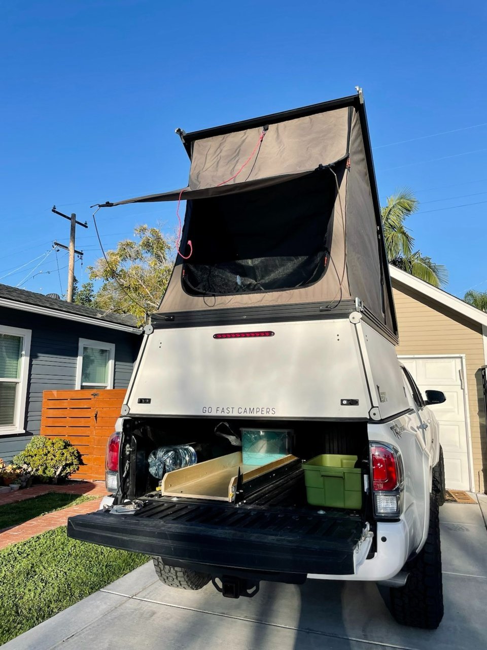

    Mod #2: Pull-Out Bike Tray
    Idea credit: https://faroutride.com/slide-out-bike-rack/
    **Note: Tacoma with camper shell has WAY LESS height/clearance than a camper van... There will be a V2 for truck bed bike mounting in 2023.
    This ended up being overly heavy/bulky for our use case. We don't actually need the tray installed for everyday use. We'll move to a simple plywood plate with fork mounts on the next build... stay tuned.

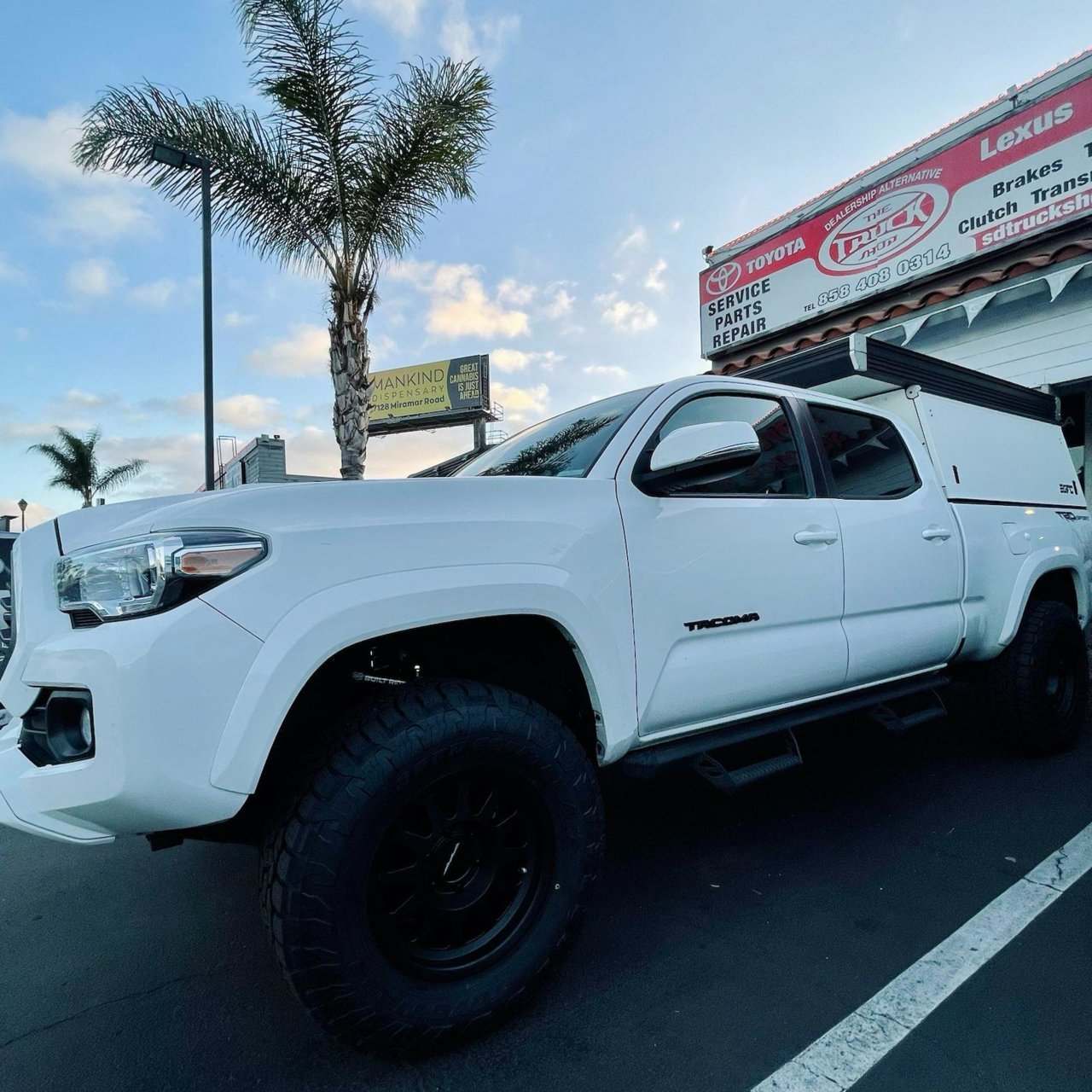

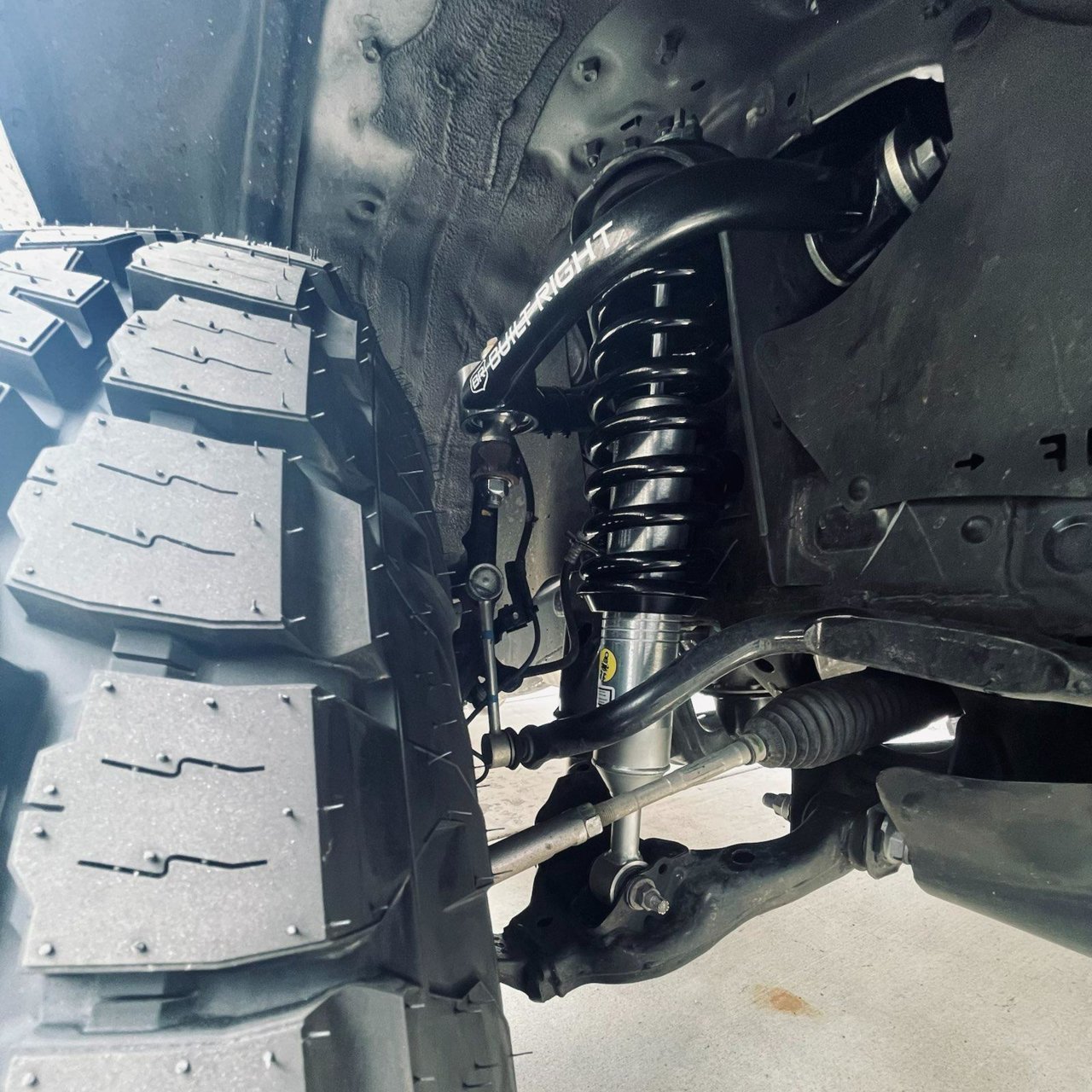

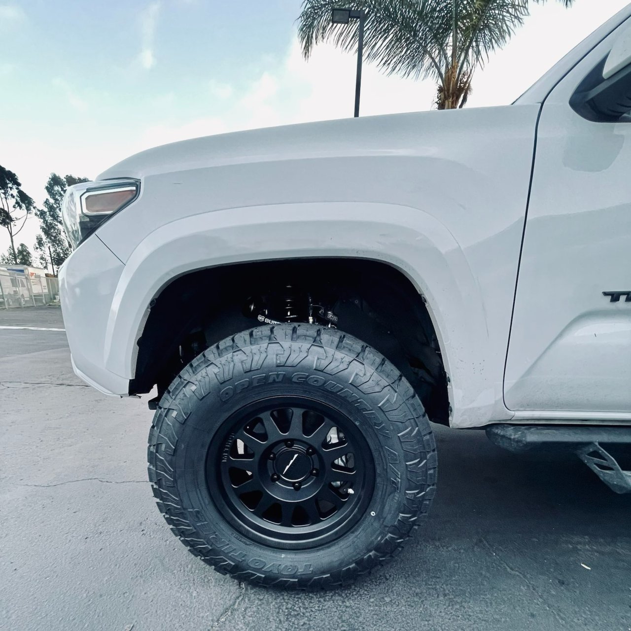

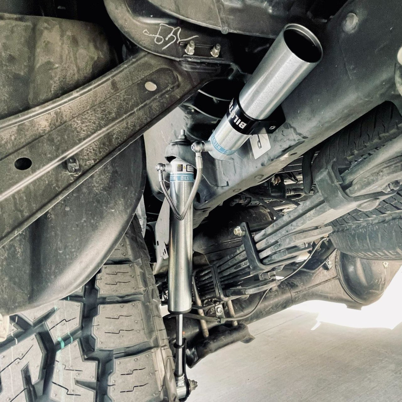

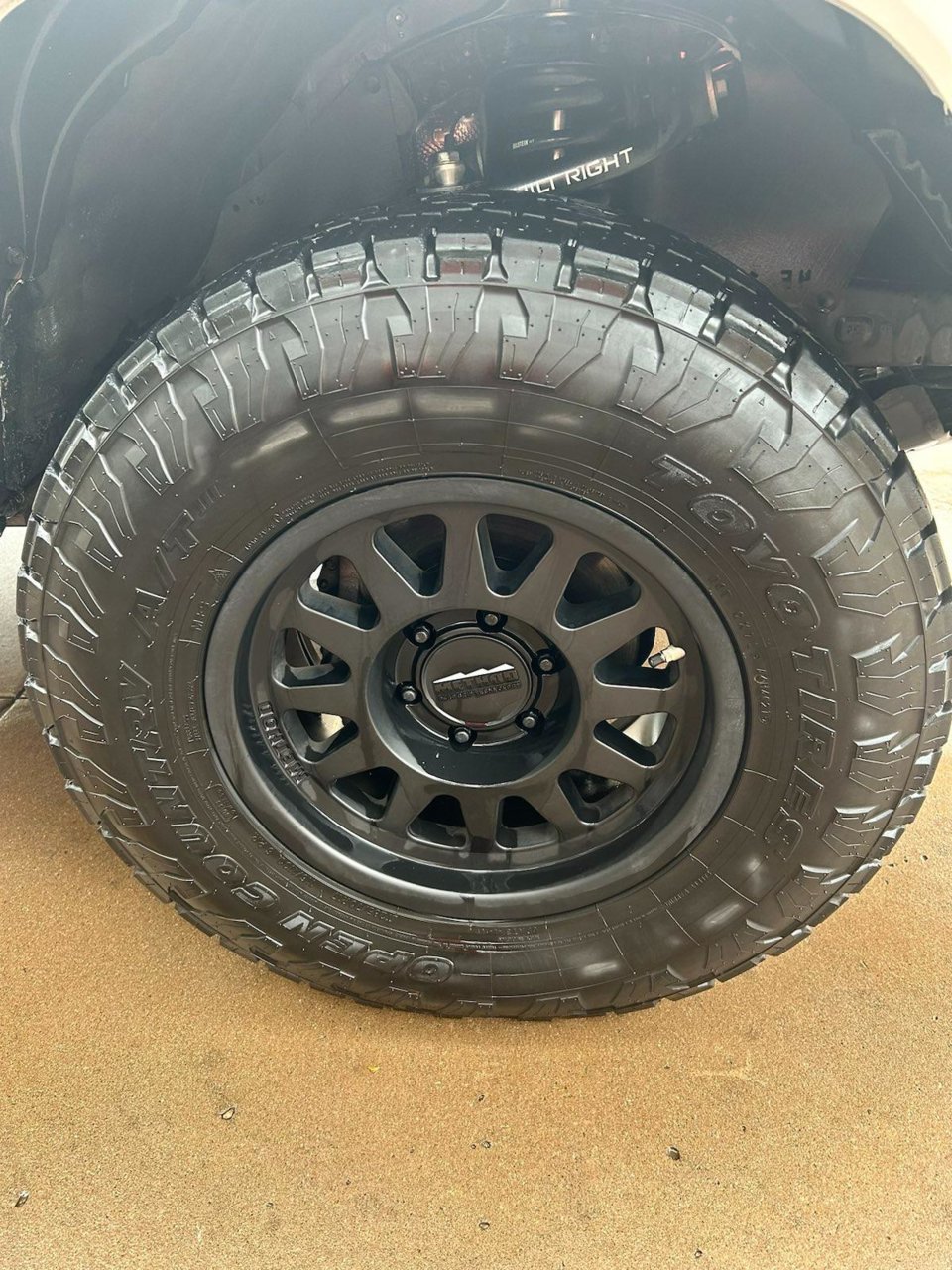

    Mod #3: Suspension, Wheels, & Tires
    SUSPENSION & 2 IN LIFT: Bilstein 6112 front; Bilstein 5160 rear; Built Right UCAs
    WHEELS: 17" MR704 Method race wheels
    TIRES: LT285/70R17 Toyo Open Country A/T III
    INSTALLER: THE TRUCK SHOP ($6,500)
    INSTALL DATE: 3/9/2021

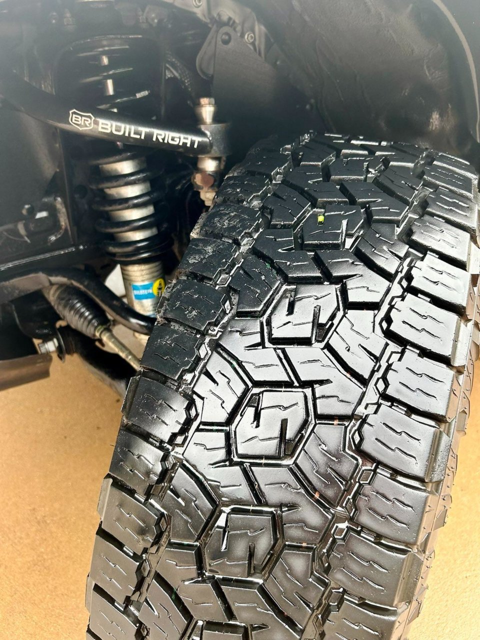

    Note: Tire tread is 14/32 inches after ~1 year (2/25/23 garage photos below versus 3/6/22 install above).

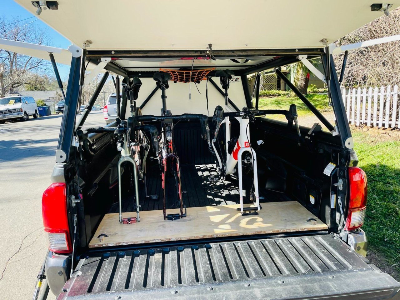

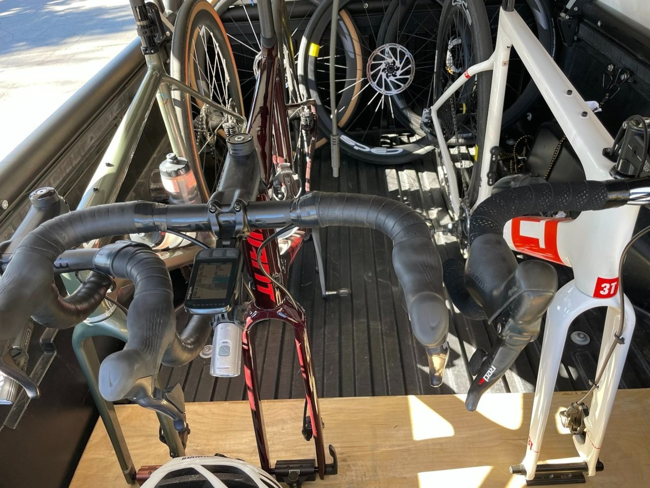

    Mod #2 VERSION 2: Plywood Bike Tray Deconstructed
    Step 1: deconstruct the bike tray
    Step 2: repurpose the base plywood to fit the width of the truck bed
    Step 3: cut holes to secure it to the stock D-rings imbedded in the bed cover
    Step 4: secure it with some wedges and screws**
    *We'll revisit this part on VERSION 3. This was a temporary mod to enable a Presidents Day adventure ride (3 secure bikes, 1 truck)!
