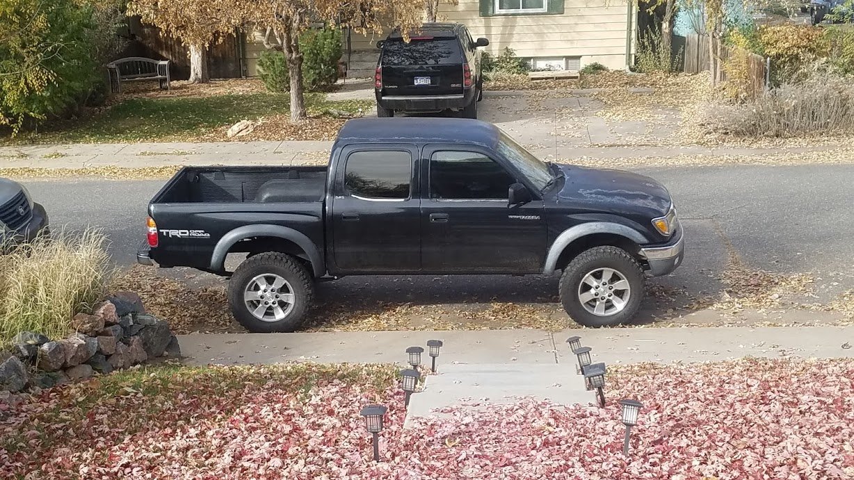

    Better shoes for the time being, can't roll around on steelies anymore.
    Will get bigger tires after the lift etc..

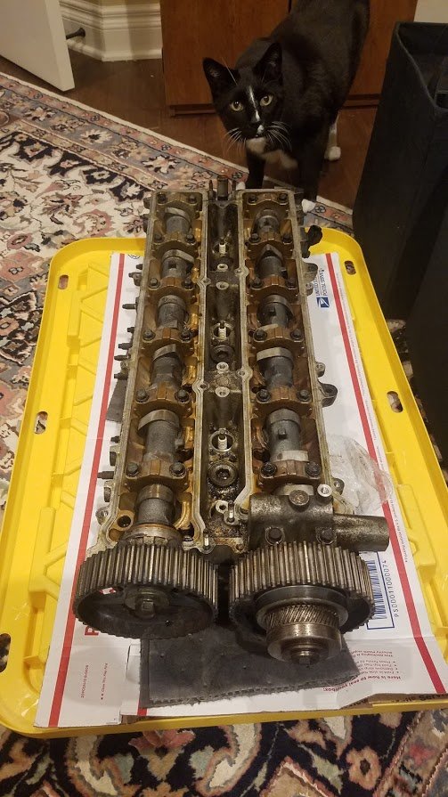

    Got my SC300 vvti harness in (runs into the cab and a 2jzgte vvti ecu plugs right in), and an IS300 vvti cylinder head.
    Will find some time to get the cylinder head cleaned up and install some new viton valve stem seals.
    Then it will be ready to drop on my non vvti 2jzge block with a 2jzgte headgasket and ARP headstuds.
    Still collecting parts as I go, the intake manifold will have to wait till I drop the motor in so I can see what I can fit in there.

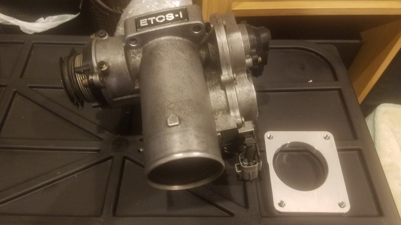

    Since I want to keep the stock 2jzgte vvti ecu for driveability, I need to use a vvti ETCSI partial drive by wire throttle body.
    The is300 throttle body would work but is very bulky sideways, so I tracked down one off a 1jzgte vvti motor that comes with the factory FFIM and bought a weld on throttle body flange.
    My thinking is I will adapt one of the available front facing intake manifolds by shortening it some and welding this throttle body flange on at an angle towards the drivers headlight.
    That should give me enough room to get everything in and the intercooler piping will go straight down where the battery currently is (will have to relocate it somewhere else).

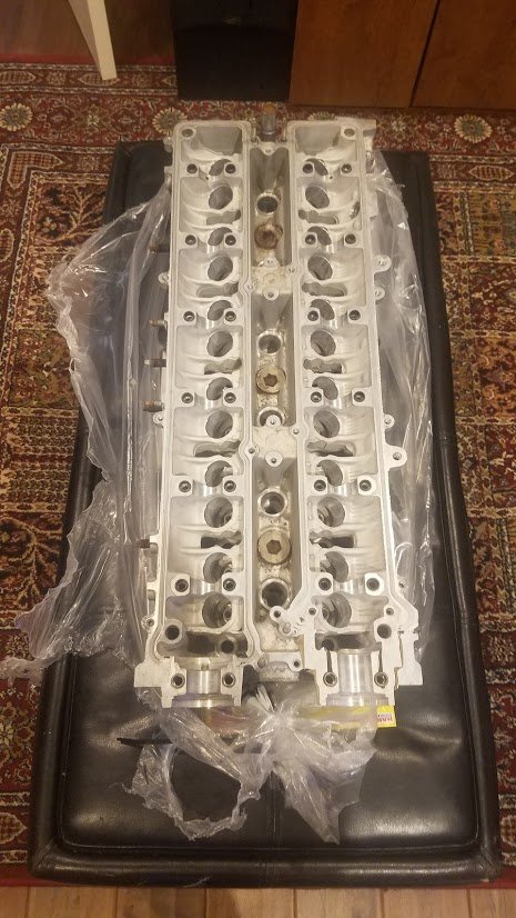

    Picked up the cylinder head, was hot tanked and 10 thousandths milled off of it.
    With a tt headgasket and early n/a pistons I should be around 9.2-9.3 compression.
    That will work well for my altitude and power goals.
    Its so clean now I am really happy I didn't have to clean it myself :D
    Going to slowly start putting it all together..

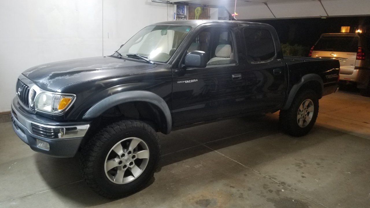

    For now got the rear OME Dakar leaf springs installed with bilstein shocks. Looks a lot better I think.
    Front has a spacer lift from when I bought it and will be doing bilsteins up front with some OME coils at some point along with fresh uppers and ball joints.
    You guys think the tire size looks ok or should I go a little bigger?

    I was actually debating between a 285/70/17 (almost a 33) and a 285/75/17 (almost a 34).
    I am a little concerned about the amount of bashing that would be needed for the 34".
    So my brother brought up a good point that I won't be able to put 2JZ power down in 2wd.
    I can already spin the tall skinnies.. so with a stick and much more power it will just spin.
