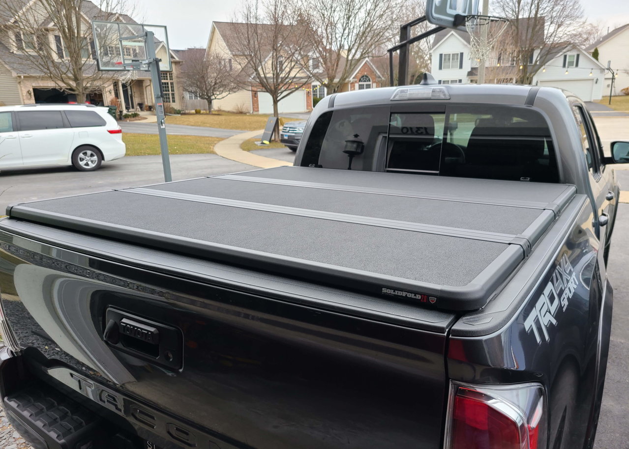

    First was bed cover. Just like the ’16, I put the Extang solid fold 2.0 on the back.
    https://www.amazon.com/gp/product/B016BXX1GO?ie=UTF8
    Some out there like full bed accessibility but even with 2/3rds exposed I haven’t had any issues (no tools) removing it for extra space when needed. In regards to its lack of a low profile design…who cares. It does the job.

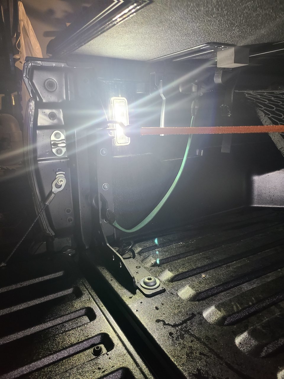

    Of course it is hard to see at night when unloading, so clearly I had to add on the bed lights. Using the plug buried behind the taillights, I added the SUPAREE LED Bed Light Truck Bed Light.
    https://www.amazon.com/gp/product/B08ZSBV9G4?ie=UTF8
    This is a real simple install/mod with the very well known 10 mm socket. Now the bed is fully lit when needed. Couldn’t be happier, but of course I can try…

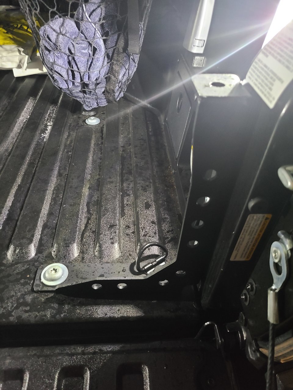

    Therefore I wanted to add some bed stiffeners. Bought the ENIXWILL and these added more anchor points beyond what I will ever need back there.
    https://www.amazon.com/dp/B08M15PBP7?ref=ppx_yo2_dt_b_product_details

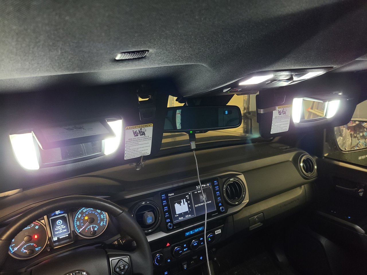

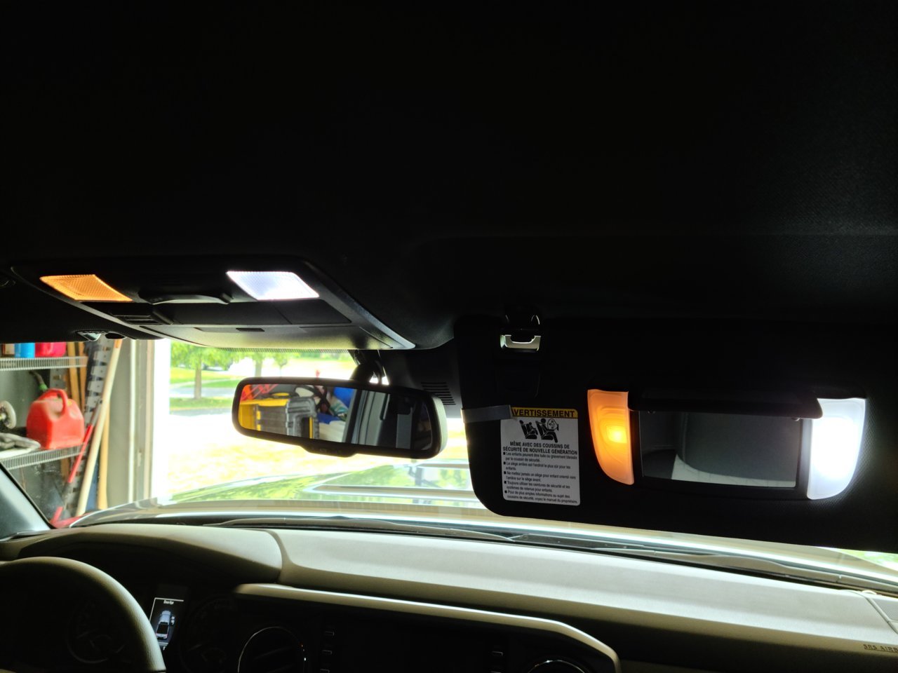

    Even better I decided to use the torque wrench for the bolts through the bed to the frame. However the bed can’t be better lit than the interior. So went and bought the same interior lighting kit I had for the ’16 with AUTOGINE Super Bright 6000K White LED Interior Light Kit. https://www.amazon.com/gp/product/B0834MGNHM?ie=UTF8
    The kit is complete with all interior lights and the license plate lights. Of course I had high confidence in all bulbs minus the map lights. That f&$%ing bulb is so hard to get out of that socket. If you have tried, you know…20210608_120113.jpg20220206_152118.jpg

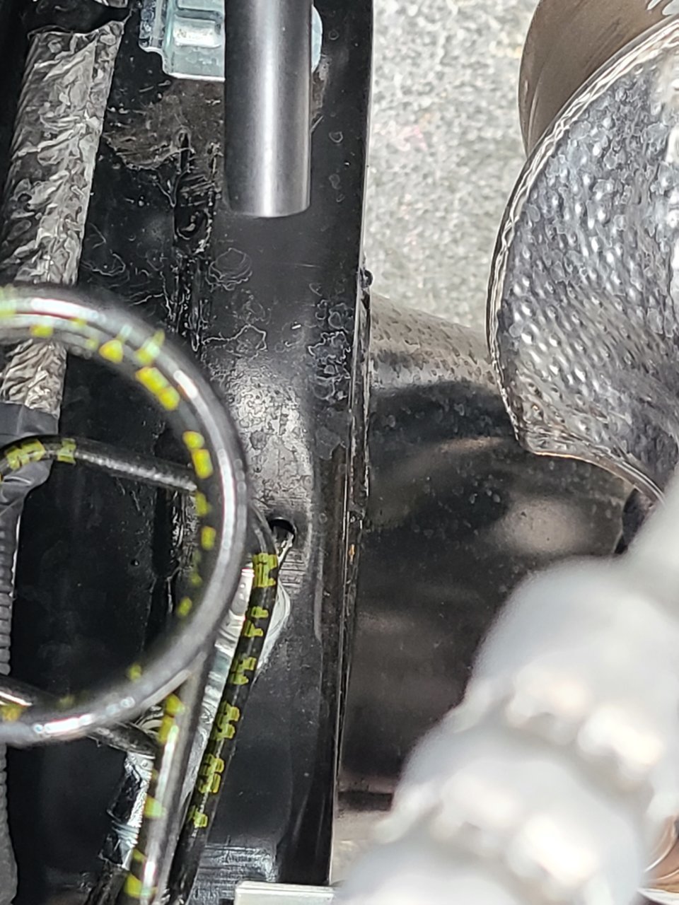

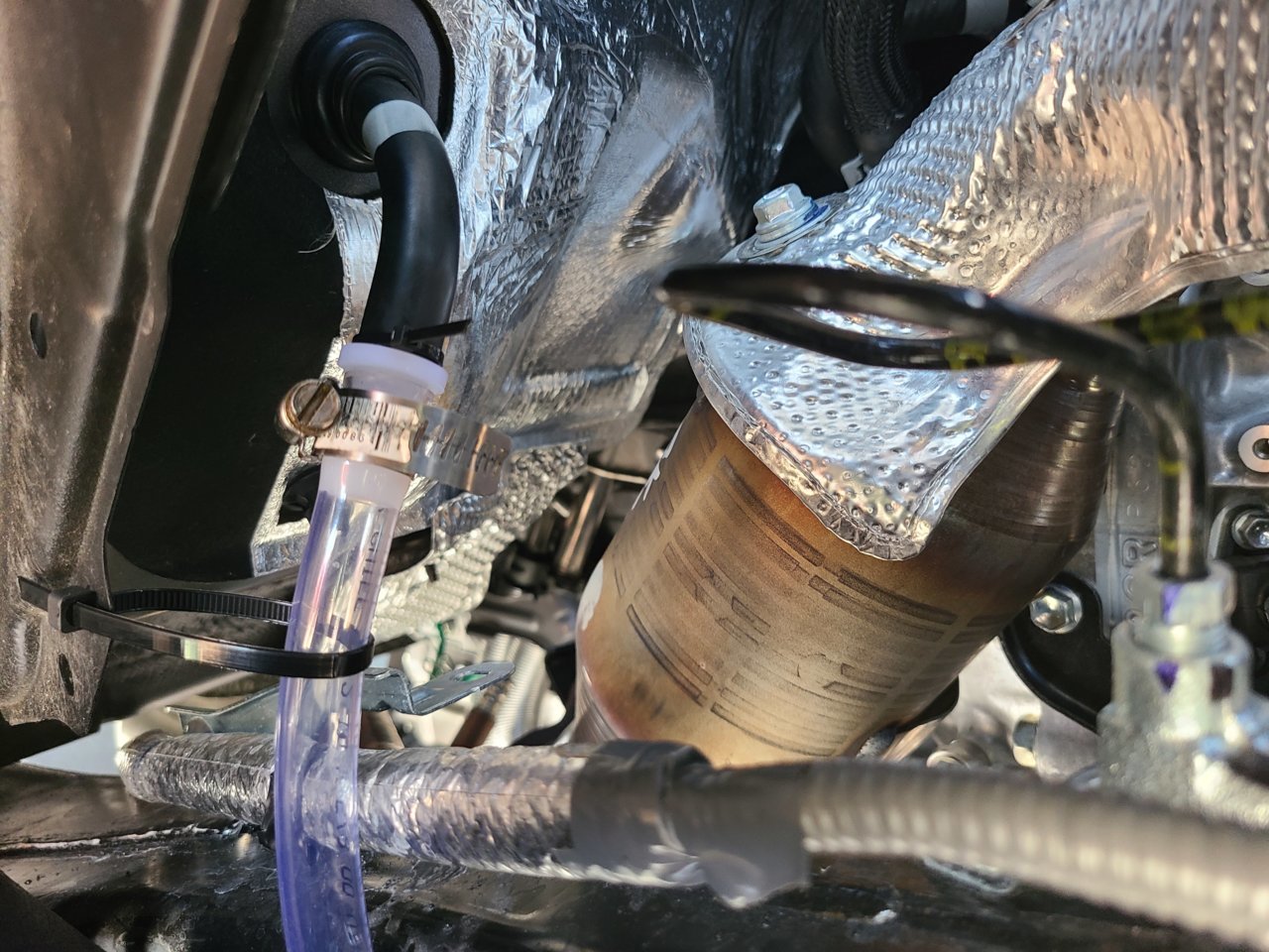

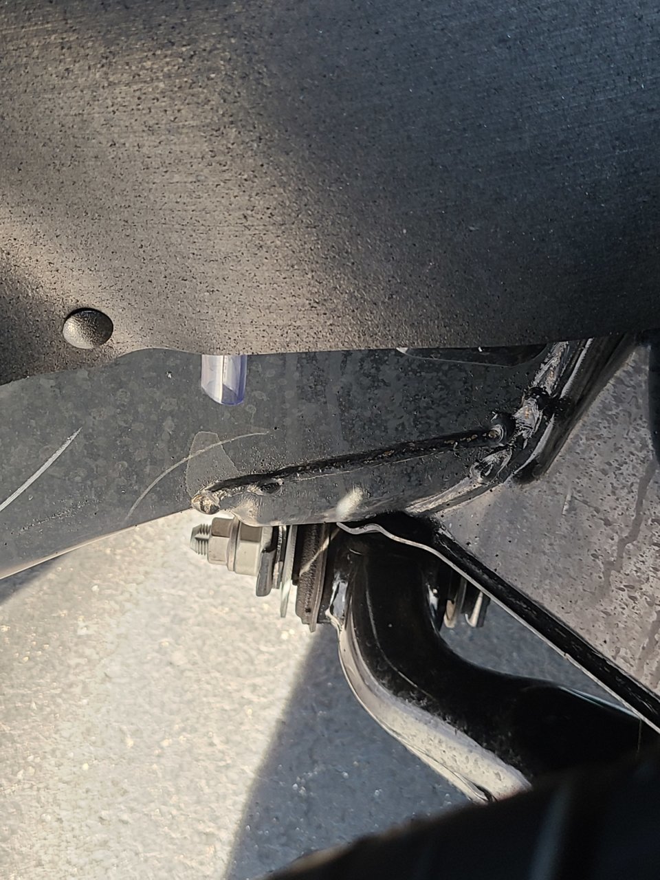

    In the summer, reading through heard about the AC drain problem with some of the later 3rd gens. Looked into mine and sure enough found the water evidence on the frame. Found some clear tube, adapter & hose clamps in the garage routed the extension out to the wheel well. Stupid problem to have got the not elegant solution.

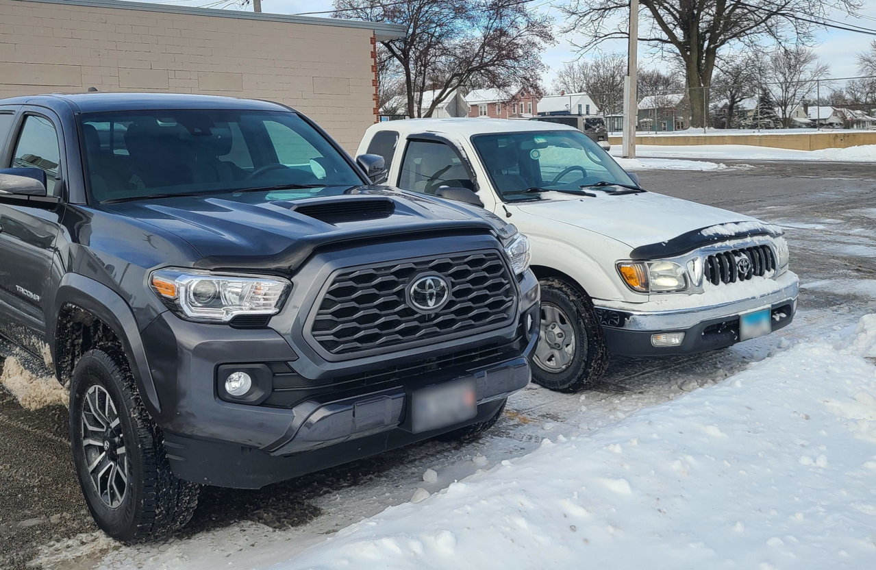

    I started looking towards the grille and researching the mods I wanted through this forum. Started with the easy one of the hood deflector. Had the same one as before however this ’21 is MGM. I really like that it blends in a bit more and doesn’t look like a pencil thin mustache. I found a G1 SR that also had a deflector, times and designs have changed.

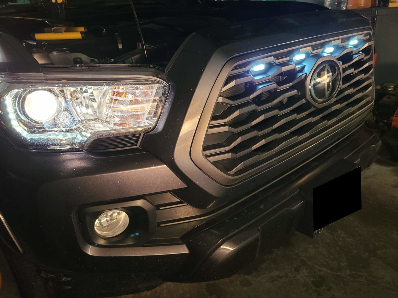

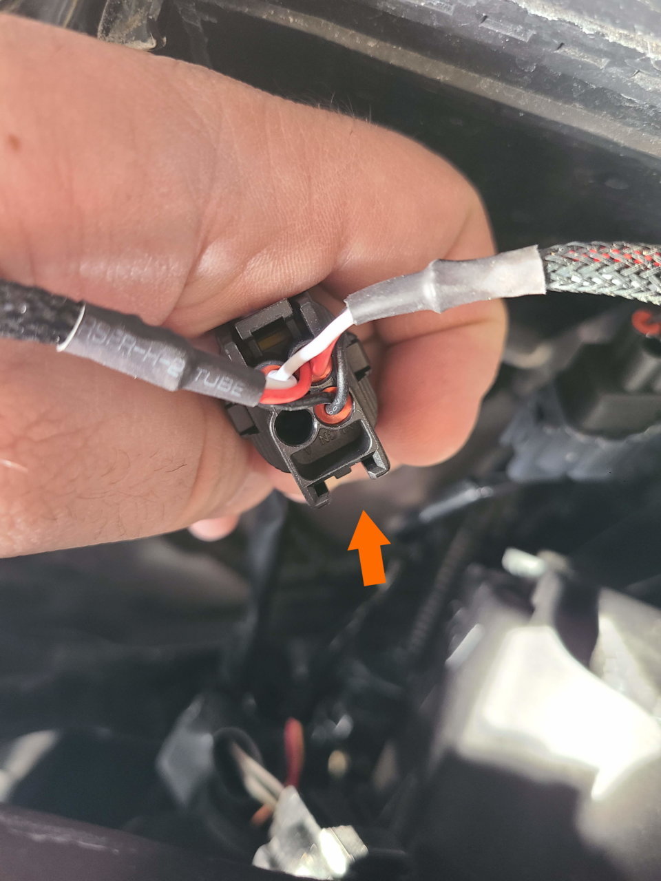

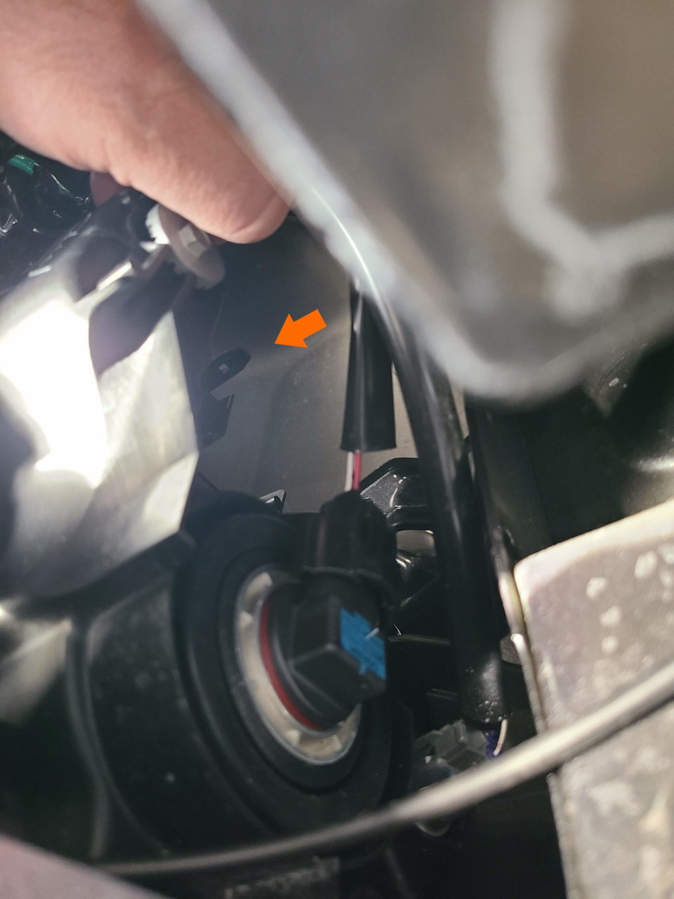

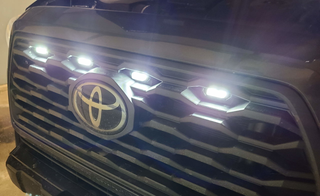

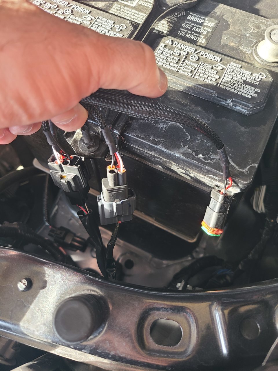

    Now for the more difficult mod, Grille lights were next and the most involved mod to date. I wanted the install to be streamlined to the DRL LEDs. I didn’t want an additional switch, nor add a fuse to the box. So I investigate the already made components out there. I first found the DRL Headlight Harness for 2016-2019 Toyota Tacoma.
    https://www.amazon.com/dp/B085B9ZJW8?ref=ppx_yo2_dt_b_product_details
    This plug and play was key for my requirements and clearly worked for my ’21. The connector is mounted on a tab and this made it easy to remove and plug in the tap for the Grille LEDs.
    Once this was installed I added the TOMALL Deutsch DT DTP 2 pin retrofit connector with exposed leads.
    https://www.amazon.com/dp/B07DCLRJCL?ref=ppx_yo2_dt_b_product_details
    With these open leads I connected to the retrofit connector and measured with the DVM 12 Volts on the circuit. More than enough potential but didn’t know about the load, but it can’t be too much. I then took butt connectors and connected the retro fit leads to the Tacoma White Grill Lights leads.
    https://www.amazon.com/dp/B09FZ6Y2YR?ref=ppx_yo2_dt_b_product_details&th=1
    Tested the entire harness successfully without drawing any current/light from the DRL LEDs. Wrapped with electrical tape, then finished the installed (lights snapping in the grille, routed & tucked the wires). Couldn’t be happier with how to turned out.
