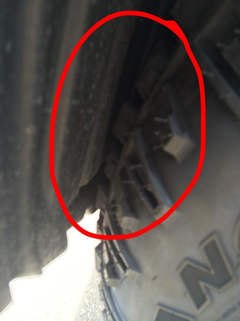

    Here is how close my tire was before moving the lining and after removing the small mud flap like thing on the bottom if the bumper.

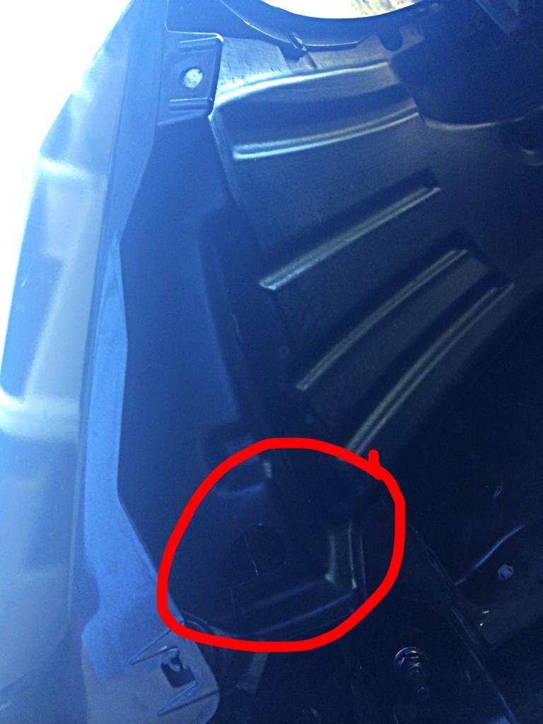

    1.) Unscrew the two bolt screws that hold the inner lining. On the bolt without the washer, there is a black Clip you have to remove to move the lining, and also remove it so you don't lose it.

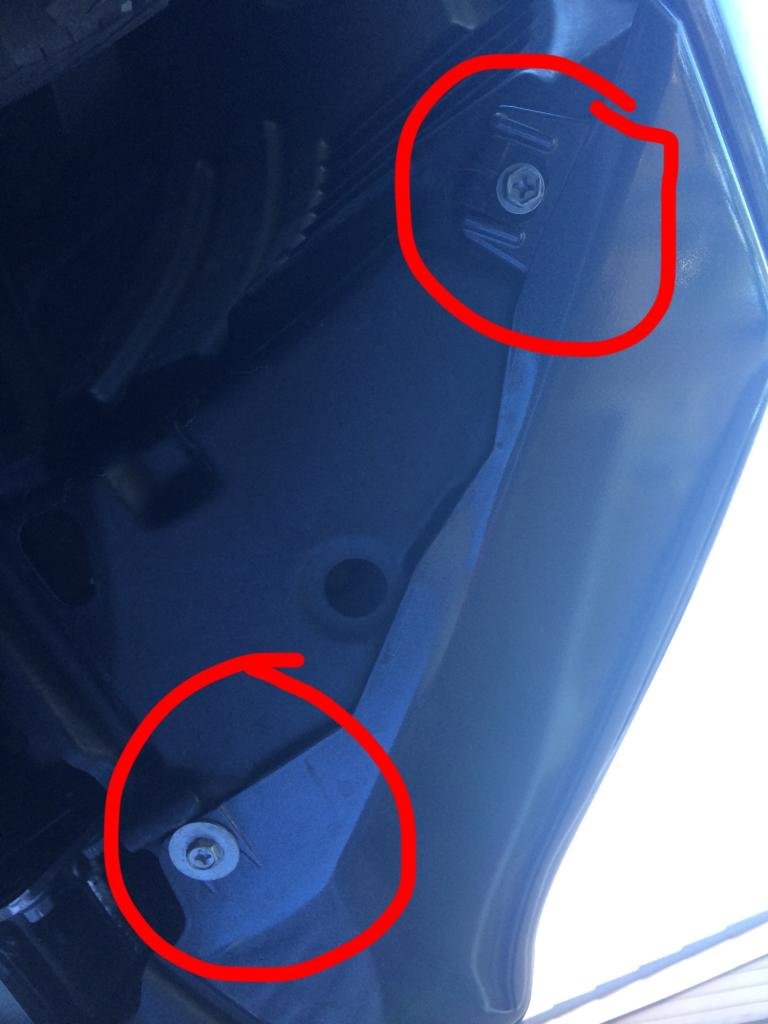

    2.) once you remove the bolts and the plastic clip, there is a bigger hole that you can use to anchor the lining

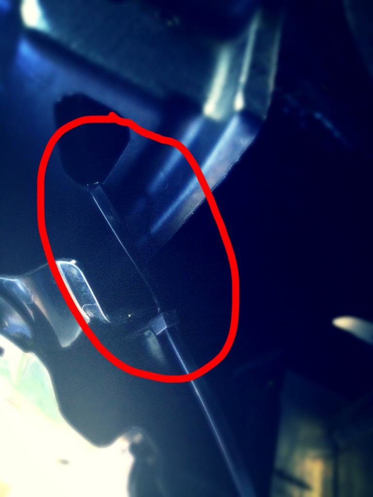

    3.) there is a little metal arm that comes out of the frame, it can be used as an anchor for the zip tie. Thread the zip tie through the whole in the plastic lining and to this metal arm. And pull tight until the plastic doesn't move around

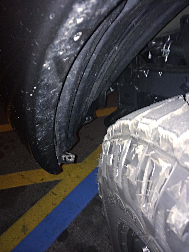

    4.) the distance between the tire and inner lining now, no more rubbing!
