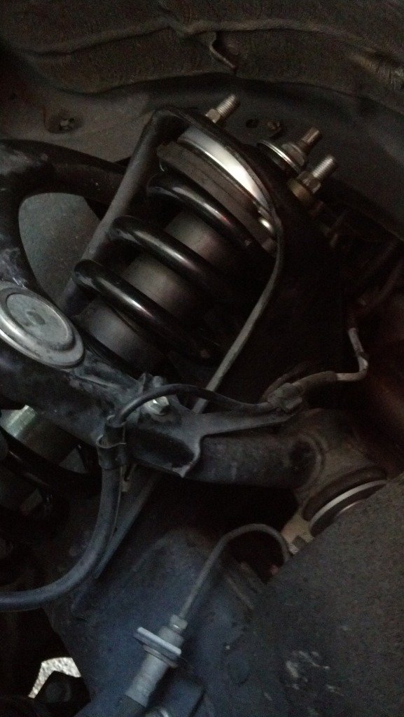

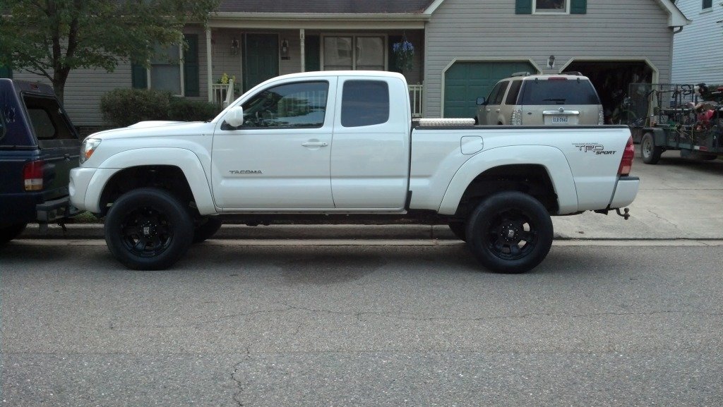

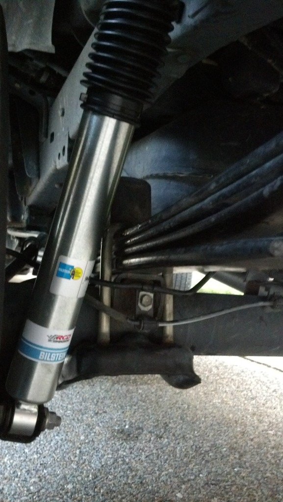

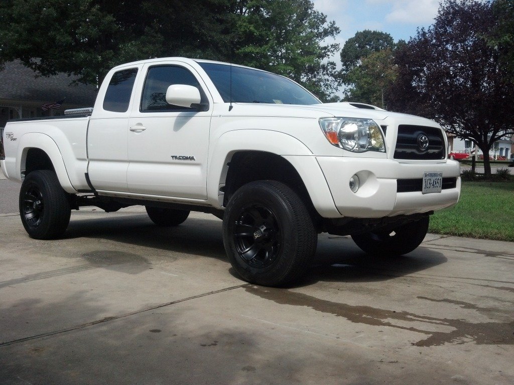

    finished doing my lift saturday took about 6 hours.... this is 5100 all around, ome 885x coils, toytec top plate spacer, 2" aal (sense i dont have tsb)
    i have stock tires on (for now) with the 17x9 XD Revolvers, will post pictures when the 285s are on at the end of the week
    Truck rides better then stock (IMO) completely with every cent!

    yeah they are, stock uca, ill do alighnment when i get the 285s on. rear was around 37 inch and front was a little less then 37. did u want exact? and i have no lean

    i got 23.5 from center of hub to bottom of fender in the front both sides and 24 inch in the rear

    i think the truck rides better with the new parts, tho i havnt banged around off road with it yet. i have steering wheel shaking but i believe thats from a crummy balancing job on the old tires w/ new rims. well see if the they're still there after a legitimate balance job when the new tires go on... also, when i slowly take off, there's a small vibe, im pretty sure its the carrier bearing angle tho. when i lifted my f250 6"s, i dropped the carrier on that thing and it went away. i ordered the drop bracket kit just didnt feel like messing with it...(easiest part of the whole job) ill keep yall posted on what goes on...

    Ok ya..........at 2" rear lift your gonna want the CB drop prob. Im prob gonna grab axel shims as well so if I have(which i will i think) a take off shudder or vibe im gonna install them. You didnt do a diff drop either huh? Im still on the fence although it seems that its not necessary is the concensus.
