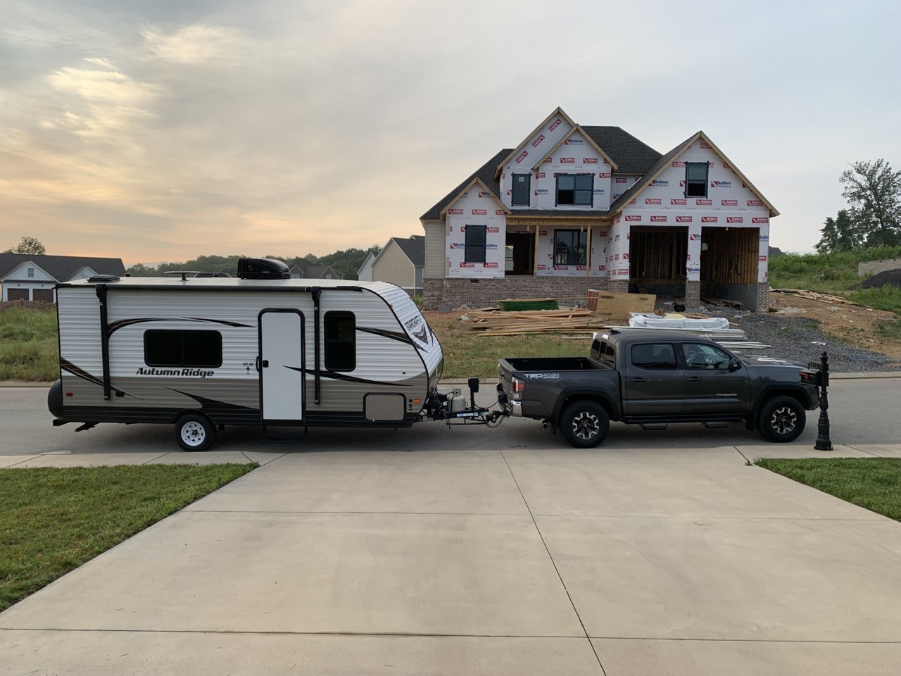

    Recently the wife an I took a vacation and due to all the virus stuff, we decided to rent a camper so we could distance as much as possible. We rented a Starcraft 182 RB with a 4,200 # GVWR so that comes in at about 66% of the capacity for the Tacoma. Thank goodness, the rental company provided a weight distributing hitch and anti sway bar, as I doubt the trip would have been a success with out it.

    1796 miles and 152.29 gallons of gas averaging out at 11.79 MPG. I Also used OBD link to monitor trans temp 1 and 2 throughout the trip. Never exceeded 225 until day 6, were trans temp 2 hit 240 and trans temp 1 never exceeded 227. This was also the day we were trapped at a slow speed going up the mountain and the truck stayed in 2nd and 3rd. I would have pulled over and given it a rest when it hit 230, but could not as I was boxed in. The truck is also a bone stock TRDOR for reference.
    My conclusions: Yeah it made the trip, mostly ok with the exception of trans temp on Day 6 and it was comfortable throughout the trip, but if I were to make this a regular thing, it would be good bye Tacoma and hello Tundra. I'm likely going to be changing the trans fluid soon due to the heat on day 6, and also may replace the trans cooler with a bigger one since we've opted to sell our pontoon that was slipped and replace it with a boat we'll keep at the house so that means more towing.

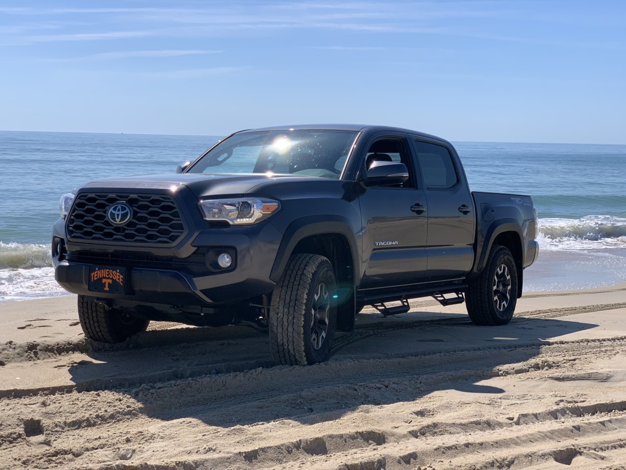

    Also got to drive on the beach which was cool and the Tacoma didn't disappoint. Saw some wild horses fighting over poop while others napped in someones front yard. Gorgeous views and generally a good time.

    Also, my wife and I have narrowed our RV choices down to two: Forest River Ozark 1660Fq and Starcraft Autumn Ridge 182RB. Good to know on the tranny cooler subject...been thinking on upgrading to bigger...maybe we'll lean toward the Ozark, being much lighter.

    Curiosity made me look up the Ozark, very similar layout. I had no complaints on the Autumn Ridge, it was a rental, in excellent condition and very clean. Looks like the biggest difference in layout is the Autumn Ridge had a ton of storage room in the bathroom. Otherwise very much a similar layout.
    Only a few hundred pounds different in Gross Weight, but 500 less unloaded. My only real concern was the trans temps. and being that you should already have a cooler up front, the swap to a larger one is very easy.
