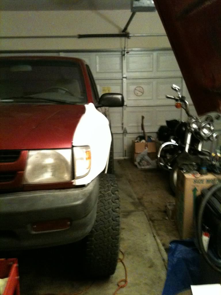

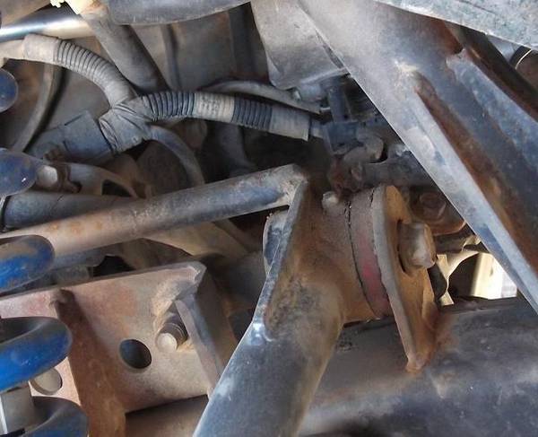

    yes i'm having an issue with the steering shaft/coupler hitting the upper a arm mount, pic would be great.
  2. Feb 6, 2011 at 9:06 AM
    #22
    MadTaco461
    MadTaco461 BRO runner
    Dec 30, 2009
    #28470
    13,408
    CA
    99 turbo 5 lug long travel
    Kinda stock
    I put off cleaning the front until my current project is done. here you can see that it is relocated closer to my zerk fitting. Just articulate the suspension to what you feel wont make it hit anymore. I welded it to the gusset. Just a simple cut, it will come off, but all I need to do is remove the shock from the LCA for removal. 3 hard desert trips and still going great.

    damn i was hoping it wouldn't come to relocating the upper arm mounts. it looks like you have some legit coilovers with a hoop. I currently still have the stock coil bucket so i don't thinks that'll work for me. I'll have to re-evaluate. Did you try moving the steering? Mine seems like its at a very awkward angle anyway so i'm going to try to straighten it out.

    Yeah JD fab has a pretty sick LT kit. My steering is straight so I didn't mess with it, but the driver side has a half inch spacer so something had to move. Yeah just try to take off the "cross spacer" and slide it forward along the gusset til it hits nothing. Mine moved forward a little under an inch.

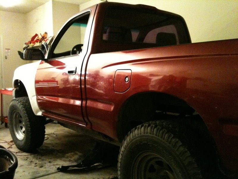

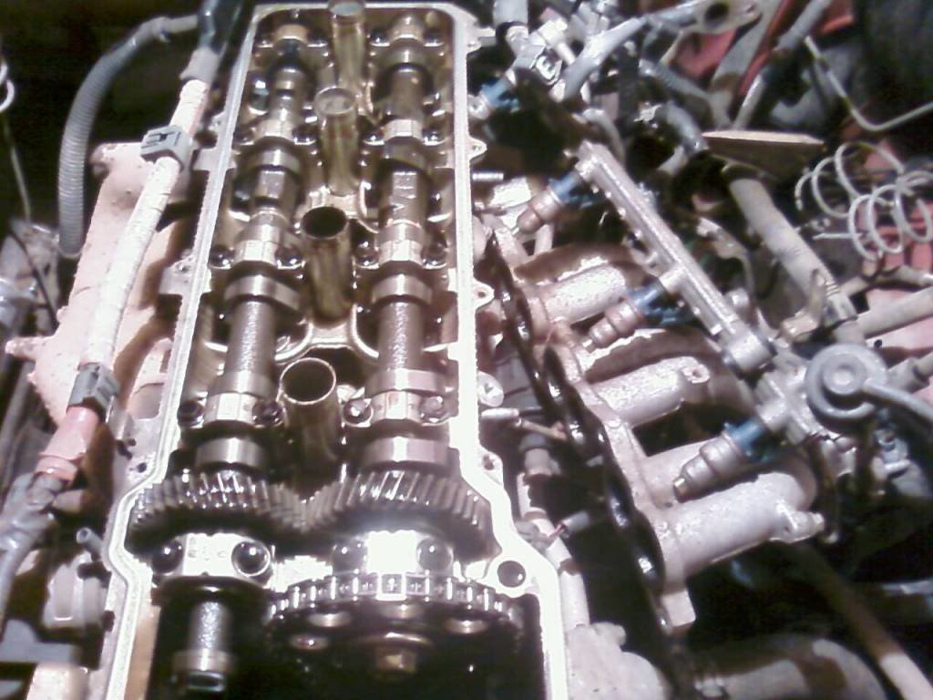

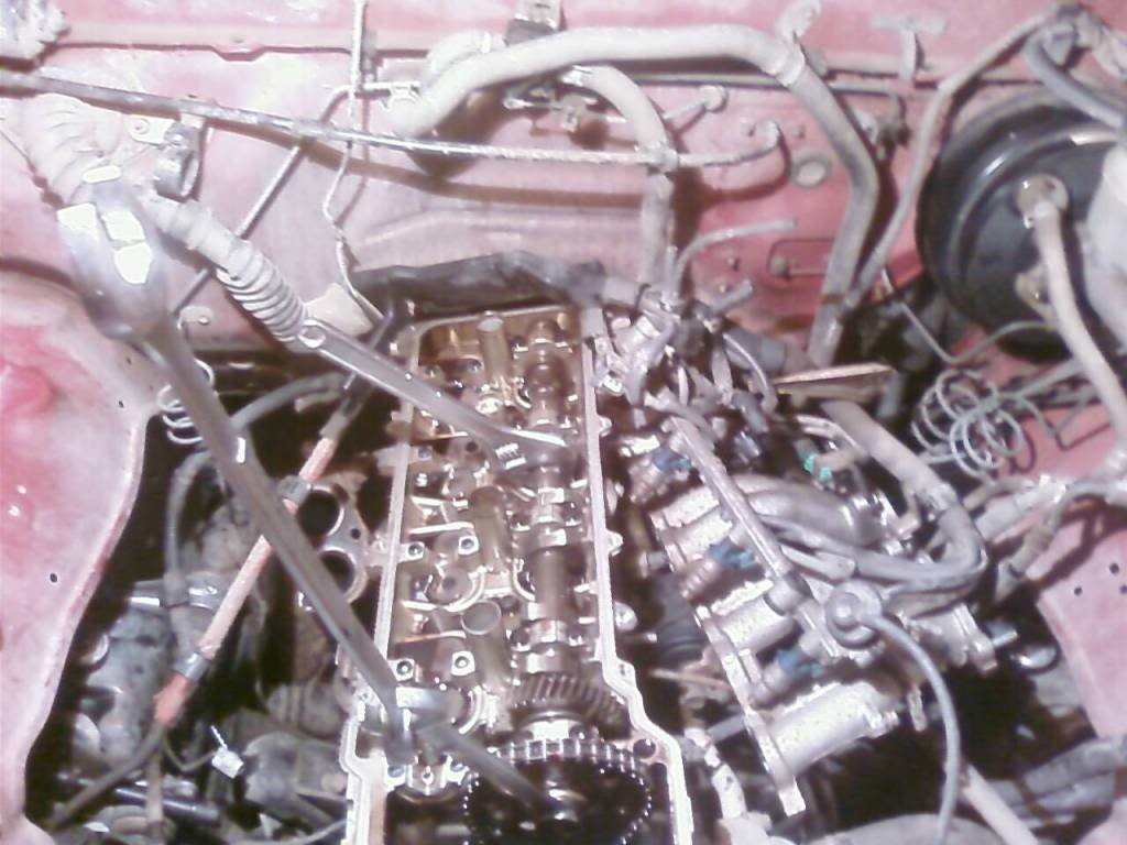

    Well i hairlined my collar bone and bruised two ribs in the worst crash of my 16 year snowboarding career so i've been out for two weeks. Been basically just soaking all the bolts in anti seize for two weeks after and engine bay cleaning...
    Finally felt strong enough to wrench tonight after work. Got most the upper end apart. Should have the head off tomo after work if i can find help pulling as shoulder isn't strong enough to lift it yet.
    looks clean so far, no upper end sludge. Hopefully the bottom looks the same. Love working on motors that run lower viscosity oils.
    stopped here

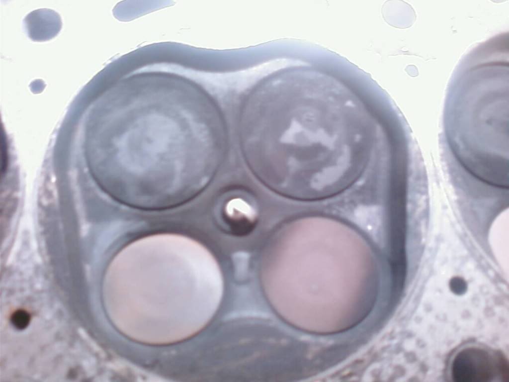

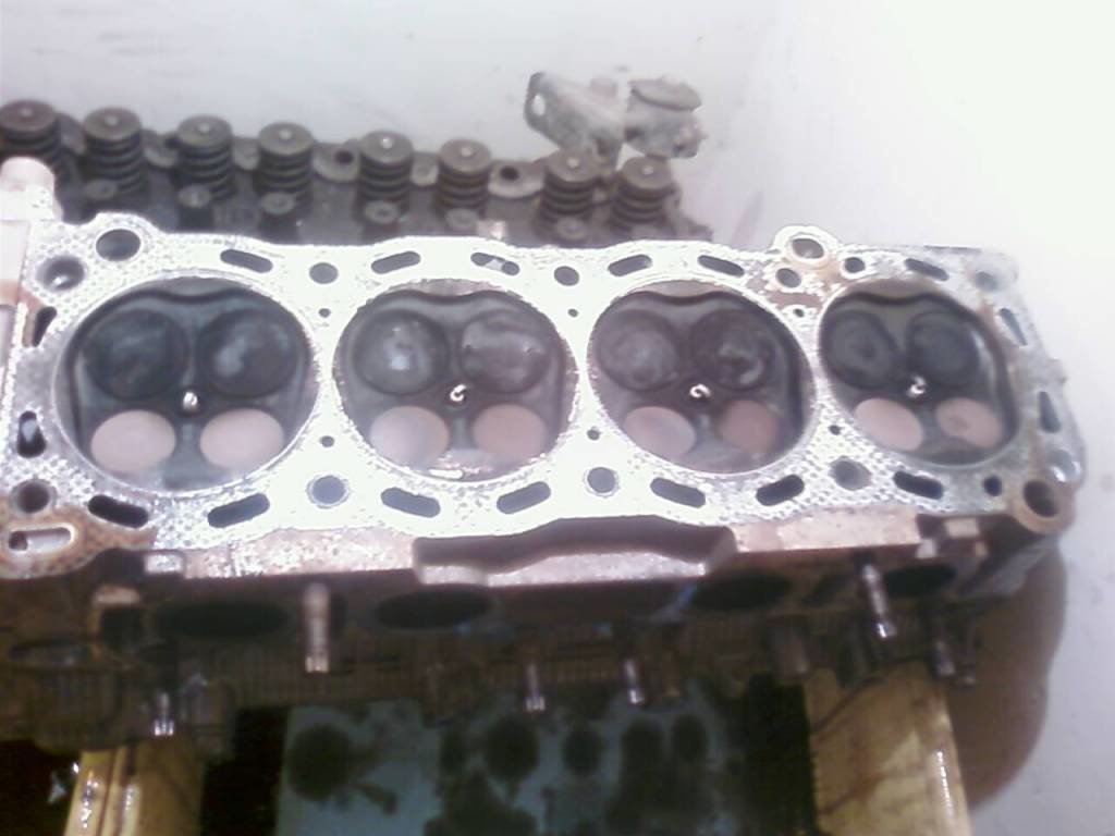

    well i finally had enough strength after the injury to get the cam bolt off tonight, had to use two open ends and a foot on that bolt and two hands on the damn wrench at the middle of the cam...
    anyways the 3rd cyl valve was just starting to burn up, just as i expected.
    not sure why but it looks like one of the intake valves on each of the last 3 cylinders gave each other kisses
    [​IMG].
    taking it to a head shop tomo

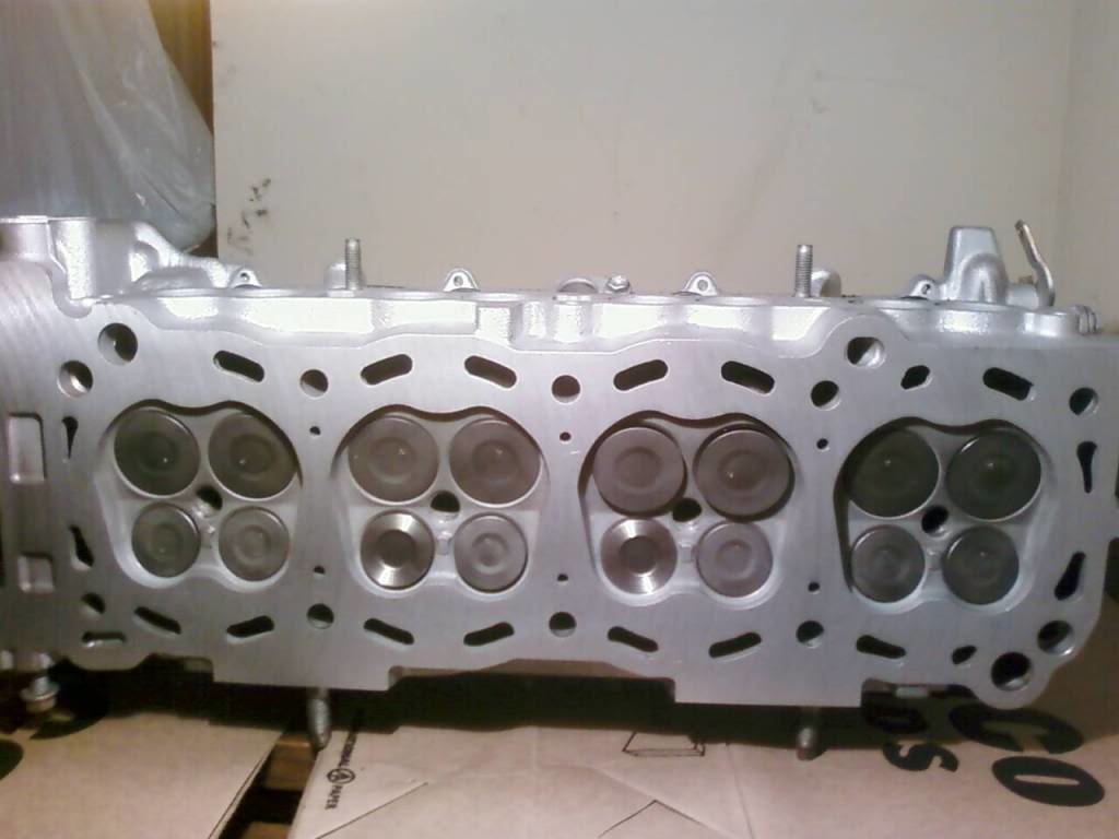

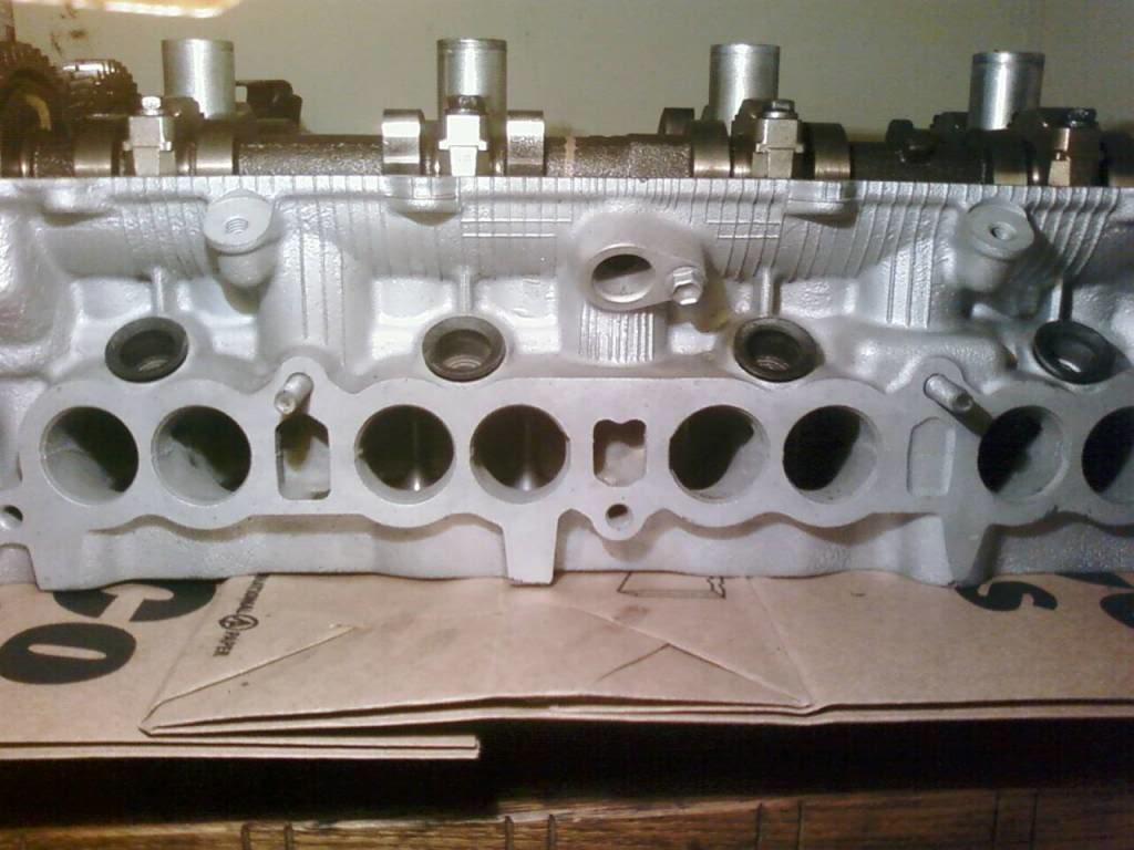

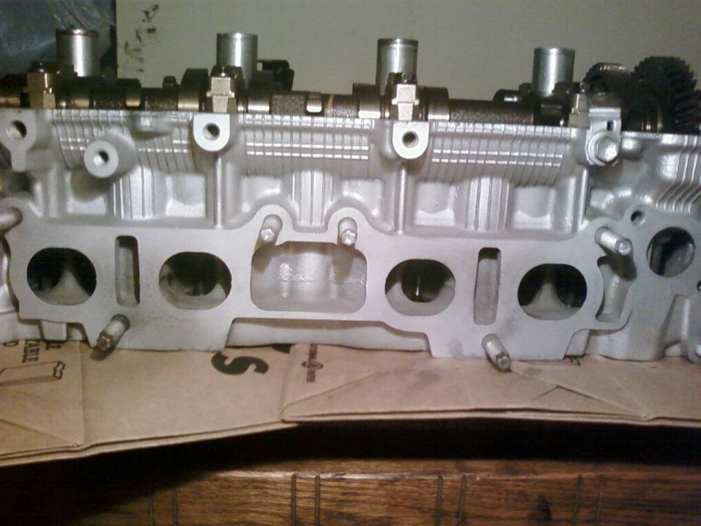

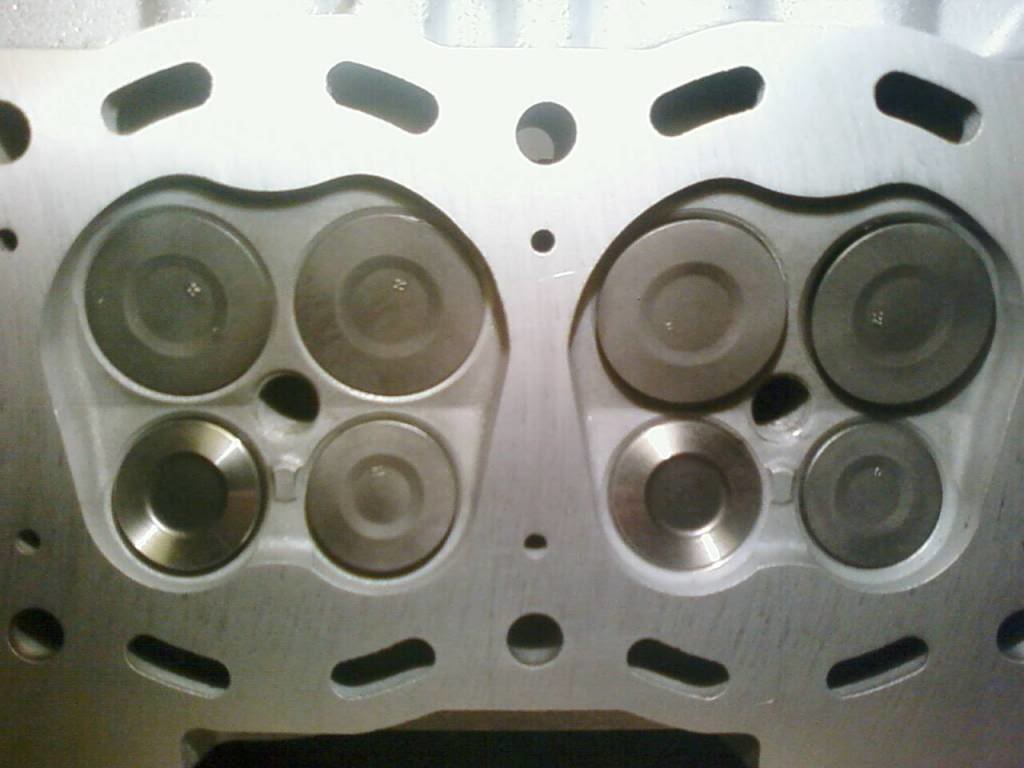

    Picked up my head from the shop today.
    I had him:
    re-surface
    hot tank
    check for cracks
    re seal valves
    grind valve stems or lifter buckets to get proper valve tolerance
    and he put in two new valves as two shrank from the crack in the manifold
    Guy charged me 216 our the door for everything... He said he does these head frequently as they don't seem to be too reliable:-(
    I'm really happy with his work for how cheap he was
    Now i need to decide if i wanna get this engine put back together tonight or go out on a pub crawl get drunk and chase this hot lil yoga instructer i'm after... hmmm. What is a boy to do

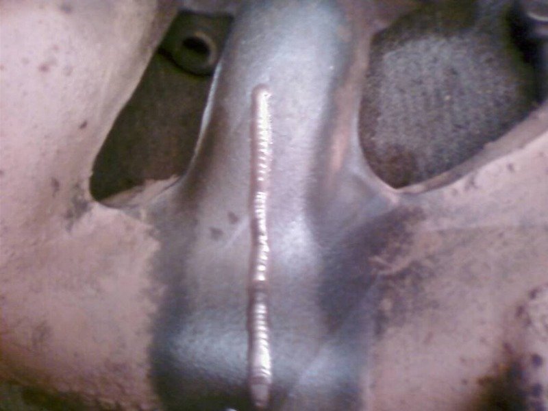

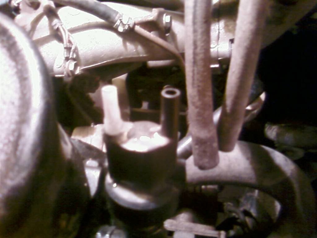

    I got it all put back together last week and as i was topping off the coolant right before the innaugural start i hear dripping, it was coming out of the muffler... So now i have to take the entire motor apart again and figure why the hell that's happening. Can't think of anything else but a crack in the head, which either my head guy did or i did during install, i tourqed everything to specs so i'm not sure how i could have. I'm soo angry right now... 15 hours of work and 210 bucks down the drain.
    I also broke this lil power steering breather thingy. Dismanteler wanted almost 100 bucks for a used one so i just jammed a nylon spacer in it and spread adheasive all over. Hopefully it'll hold.
    no project ever goes smoothly right...?
    Tig welded up the ex...
    I was fed up so i haven't been in the garage for a week, i'll get in their tonight and see what the damage is.

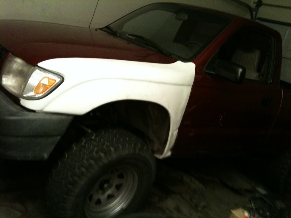

    I did a round trip of 300 miles yesterday in it to pick up the fiberglass fenders in the pic below, a spare upper a-arm/bj assembly identical to my current arms and a toolbox.
    I love driving this thing.
    No money to match factory paint so I’m going to rattle can them gloss black
    The guy sold them to me for 100 bucks, didn’t know what brand they were. But they seem legit after mock fit pre-paint.
    Nothings bolted yet
    Anybody know what brand these are?
    I hope they’ll tuck at full stuff, don’t really want to spend money on new wheels.
    Need tube bumper stat.
    Thanks for looking

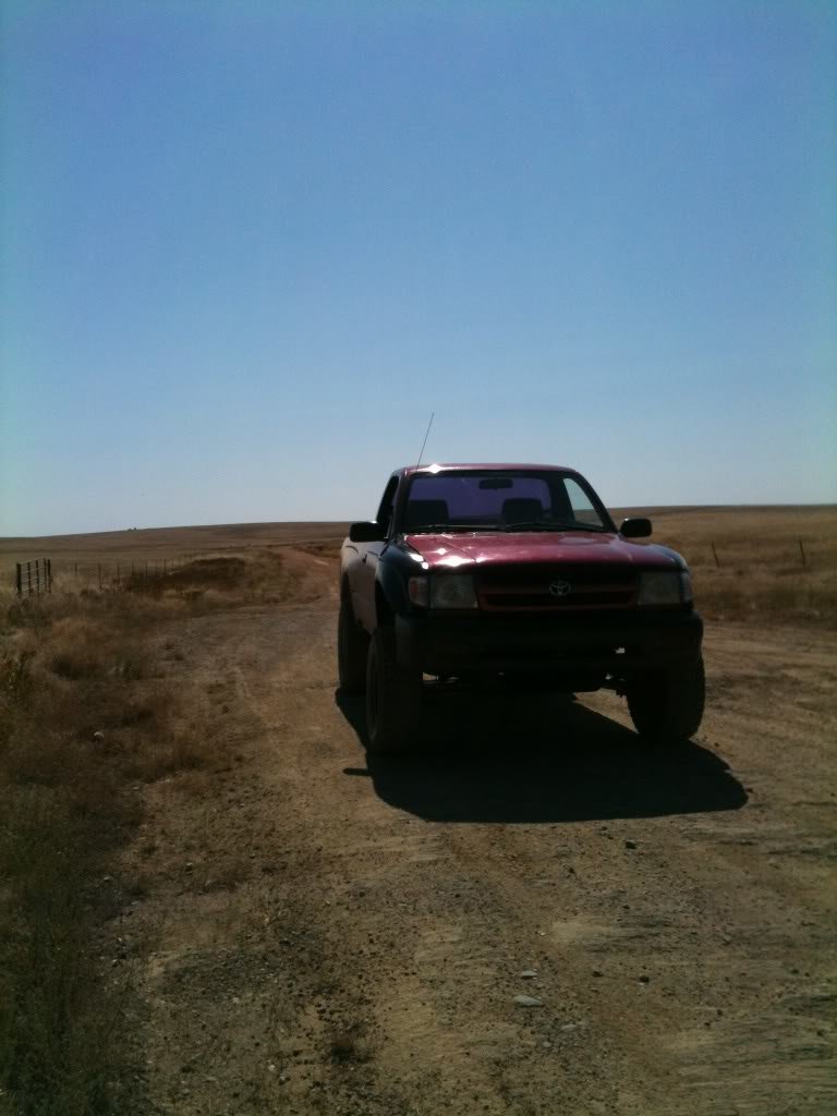

    Adjusted camber, pAinted fenders and took it on a fast and twisty road today. This truck is a blast for what it is.
    So far I have a little over 750 into it including cost of truck, head rebuild, gaskets, fluids, fuel filter and fenders.
    Blasted I phone won't select IMg code...

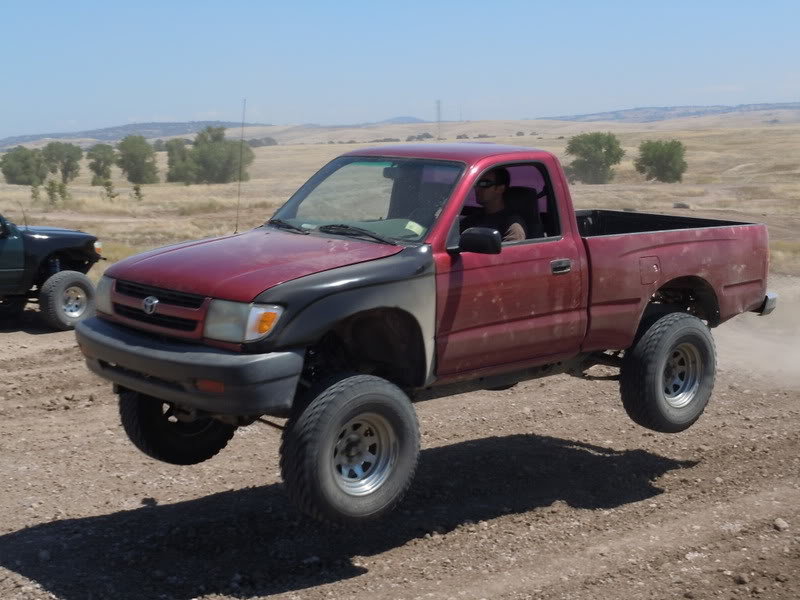

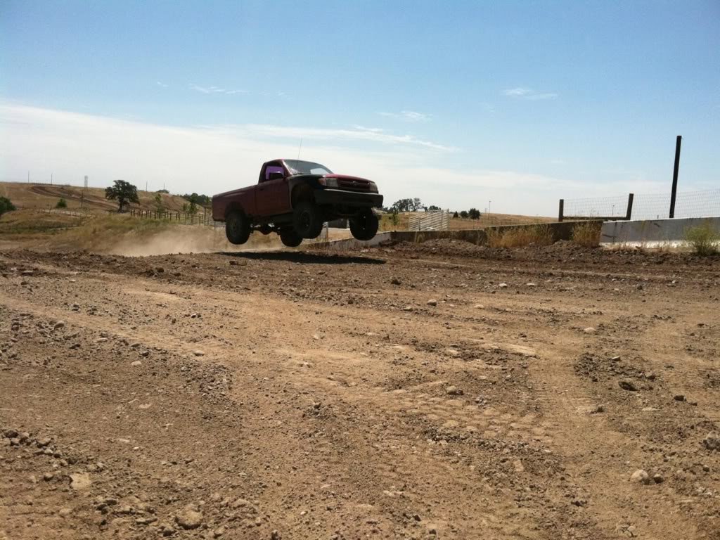

    took it out for some airtime...
    it actually land quite smooth.

    Niiiiice. Where is that?
  19. Aug 1, 2011 at 4:21 PM
    #39
    87xjmike
    87xjmike [OP] Well-Known Member
    Jan 25, 2011
    #49899
    800
    Folsom
    98 5lug 2rz
    downey mid travel 2wd set up
    its on the vorra track at prairie city ohv park.
