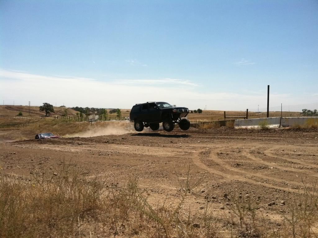

    ripping around chasing my buddy...exploder gets better traction with the weight and lsd in the back and...20"s of travel.
    If i had a better camera man i'd have pics of us in mid air in sympatico but his timing was off so:-(

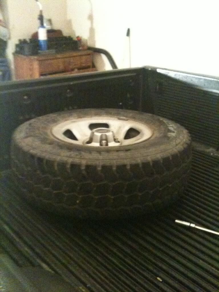

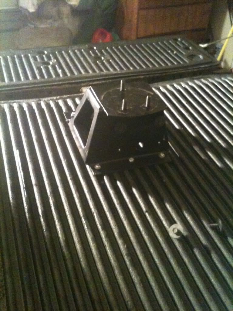

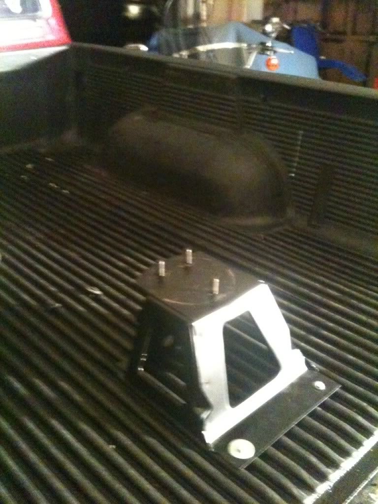

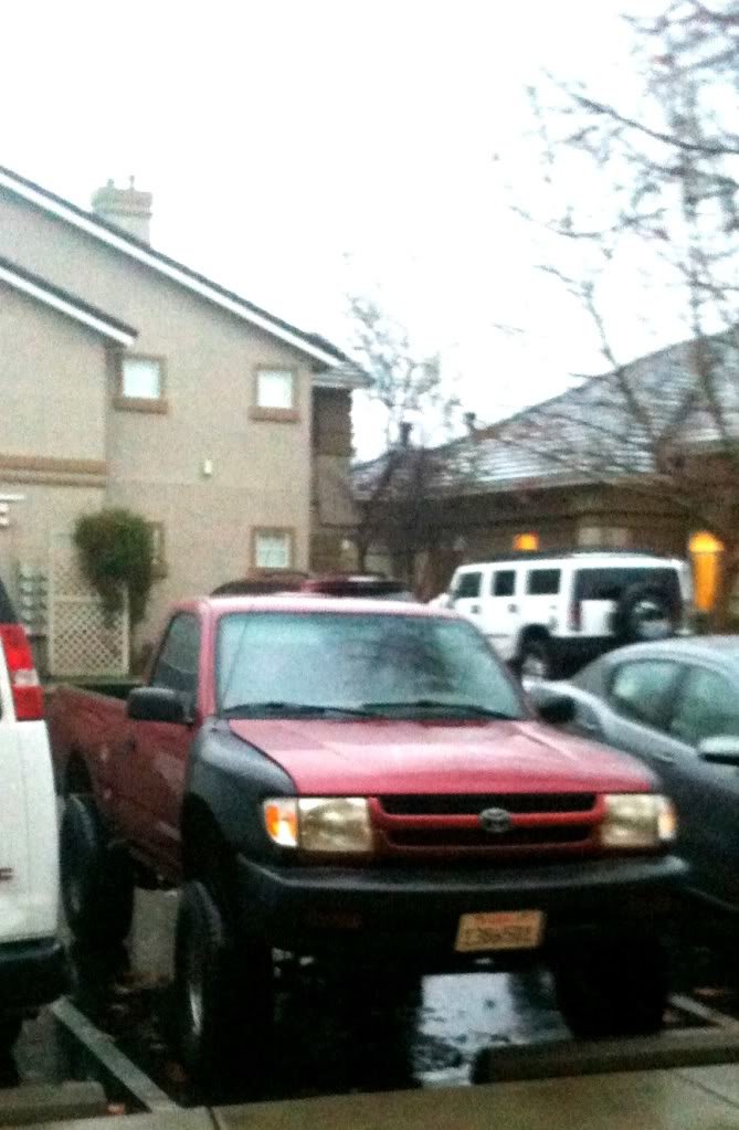

    Picked up a stock jeep wrangler tire carrier for 20 bucks off c-list and bolted it to the bed...
    works great

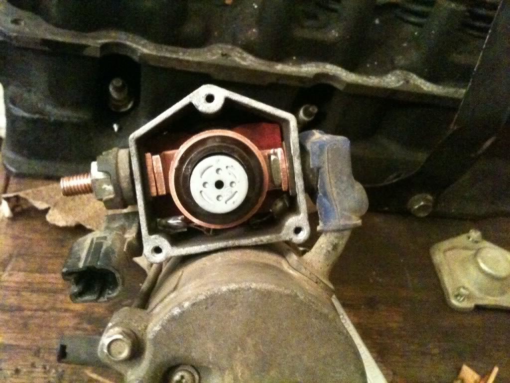

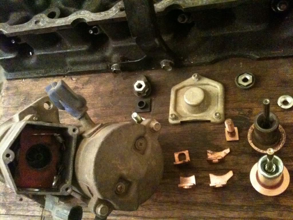

    rebuilt the starter
    flipped the lower ball joints to the top side of the spindle (they were under the spindle when i baught the truck) and got another inch of lift. Apparantly this thing was a mini truck at some point in its life and nobody knew any better to switch back to original mounting position.
    Thanks to joels98taco i now have much better lower control arm angles and a smother ride. And most likely the root cause of why my buddy broke so many bj's.
    took it wheeling last weekend, still waiting on pics from my buddy.
    Also welded up all the cracks in the bed, got a bed liner/insert to cover up its nastyness.
    Also got my paint in the mail to paint my front fenders factory sunfire red. Just need a gun.
