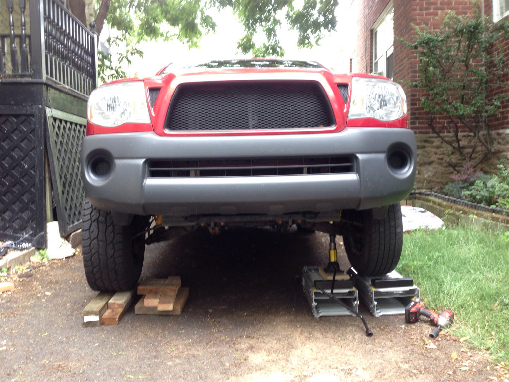

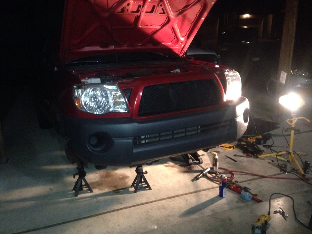

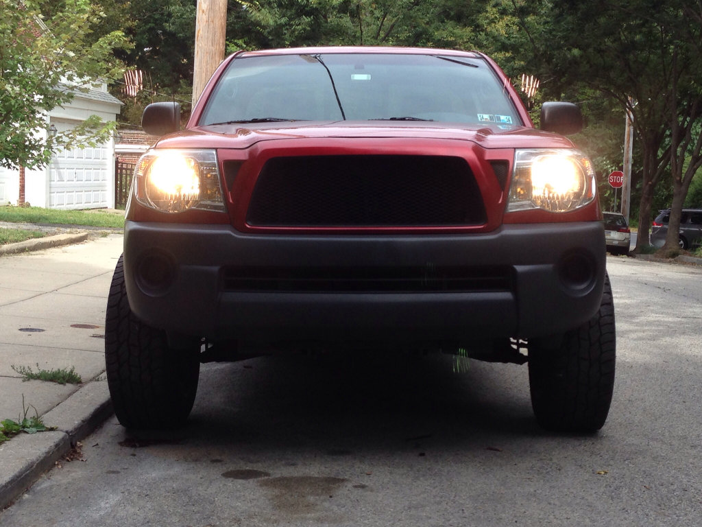

    However, in the midst of all the changes I finally managed to put the lift on the truck! Doing so was not an easy task however.. I thought me and my buddy could get it done in an evening, but we were very wrong. Every single bolt with on the front suspension components gave us grief -especially the uca bolts.. We struggled for a good 10 hours on the first day trying to get to get those seized suckers out. Most of that time was working on the one bolt that snapped off and was seized inside the bushing. Long story short, we eventually got it out but got the air chisel bit stuck in there instead. We had to call it a day and I was humbled by calling the wife at midnight to come pick me up.
    0408d4631b56568cac0601719d9ddad0_zpse932_0eb04cf6810061115b353477cfa089be8dd304b4.jpg

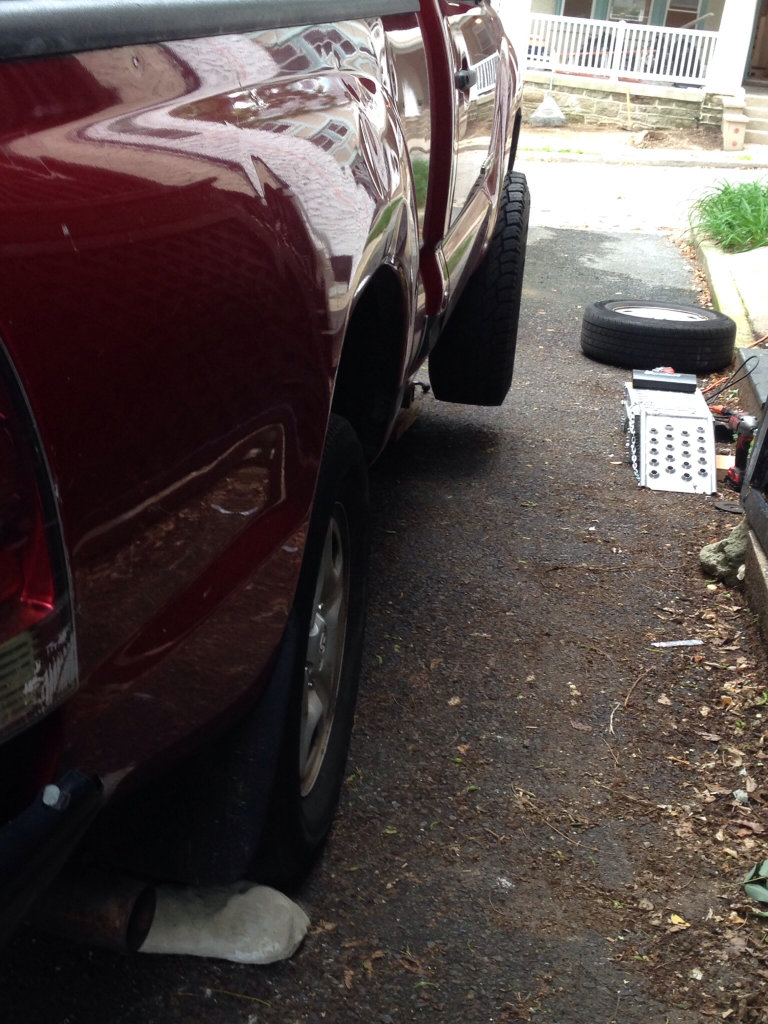

    I got the front lift installed by myself later that week and then the rear on another evening. Tires were done by myself in the driveway with my puny bottle jack.
    1fc61c6b0c808d6050788afb3e822e50_zpsd23f_6797f2e003836e84687bef23e9f3927eb39a3890.jpg

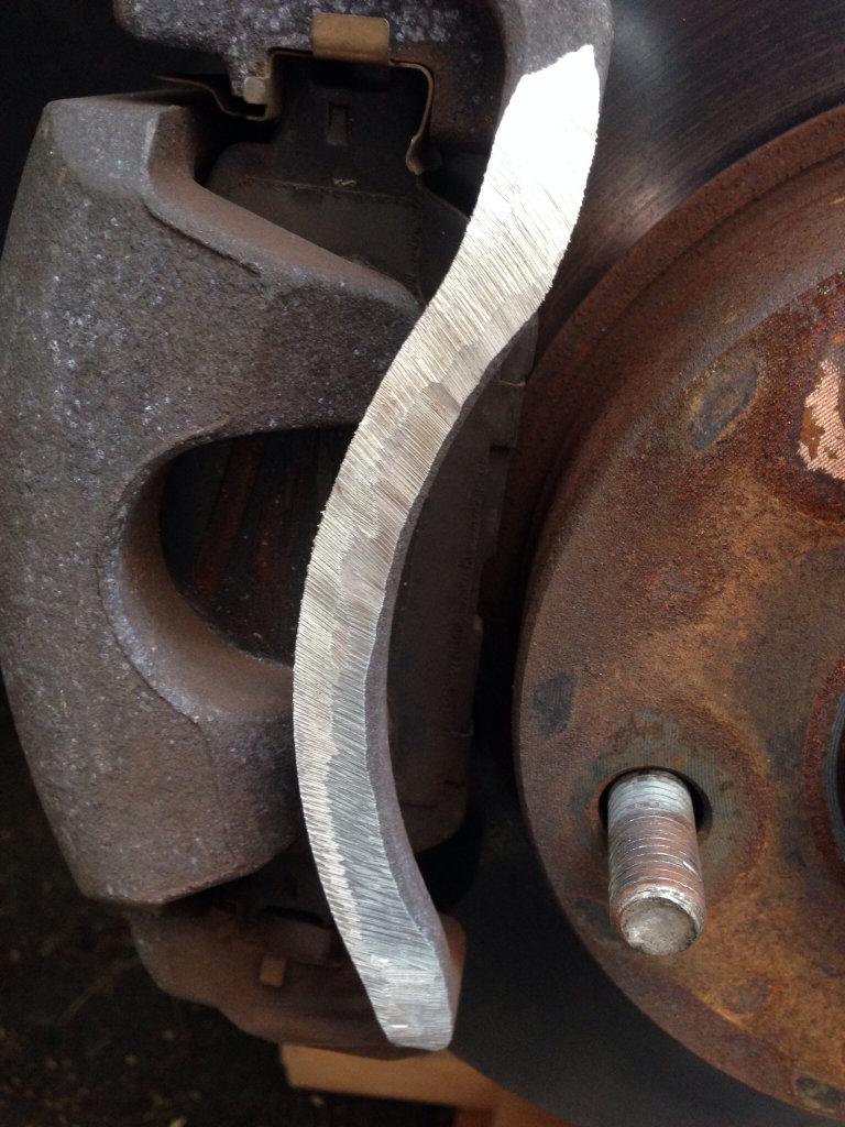

    The Mickey thompson I got really pop the tires out, but like others I still had to trim my caliper bracket down to get them to fit. Black boxes also had to be removed for clearance.
    3df23996ec2a676641239c20de0bdb83_zps1dd4_05d663bf811d4cc5cfab927f60d5df0d765b4441.jpg
    7f0b6a46daf0bf0842581a8769aa4d93_zpsbb4f_482cc5eda83701f033f6532d5ba919c0b9d6790b.jpg

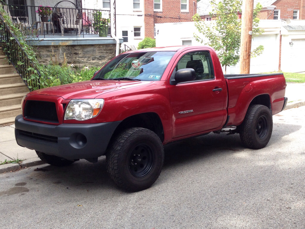

    End result looks awesome though! Was a bit off compared to how I'm used to seeing the truck at first, but I definitely like the new look and stance!
    37d130d174b4422535bff2c32747083d_zpsab75_dfdb853456bc67212684d3b0c1d5a32165a60130.jpg
    2c515e9ad20d7aee735417e68bf64d07_zpsd8de_ca6e1b2bdf50122d6599cfec6b0d2a1154d92c49.jpg
    Now I just need to find a garage that will align it. Apparently the kids at the toyota garage can't align anything other than factory specifications that they can select from a computer :facepalm:

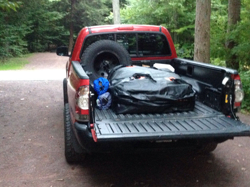

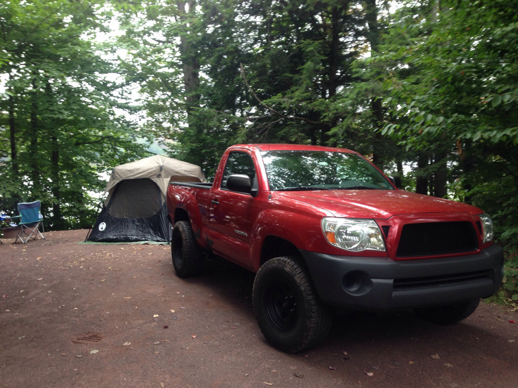

    The camp site.
    268c460625978064589ecbf0a2d11066_zps5865_ce0e9a11695423682a51fc5c19895c7ea2de2a52.jpg
    The gear. I used our car top carrier to keep everything dry and organized in the back of the truck.
    14d67bb48d3a5cf95e6796937a702920_zpsa820_3aea7e8dcd6a33db48a99d866f799682abf373d6.jpg

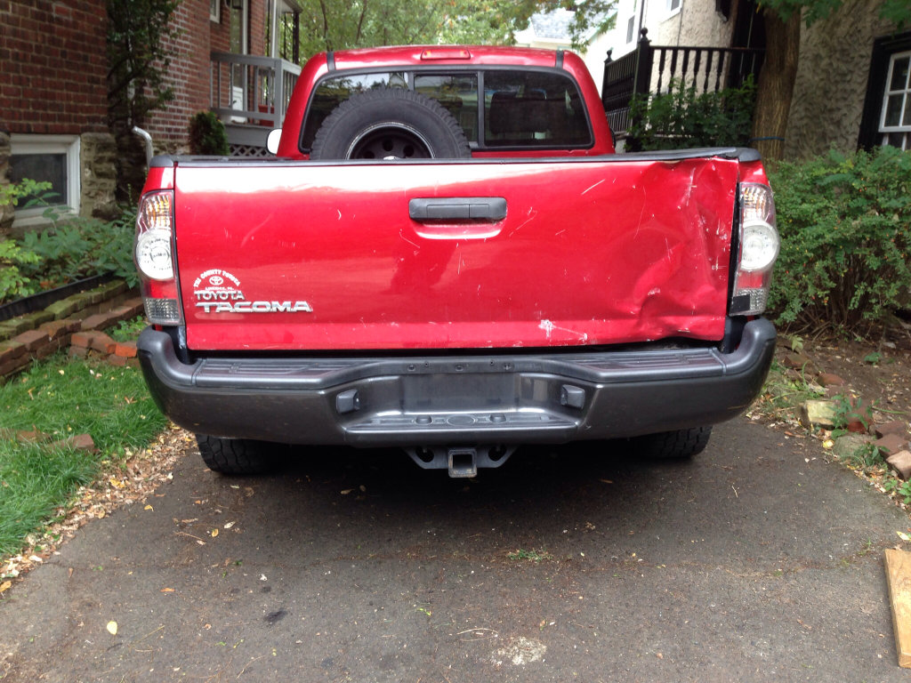

    Finally was able to do a little more work on the rear of my truck yesterday.
    I've had a hitch bumper sitting around for quite a while and haven't been able to get a hand installing it, so yesterday I just decided I'd do it by myself.
    So for the pics..
    Before:
    02b2cec45695e36564836b0b742cc2df_zpsf8c2_b2f8fd82b0ebac29d10eece491dc6e3a972b29ac.jpg
    After:
    37bb9190ba9dd6c43ccb308584dc8de2_zps20c0_91f13c56621de2812da605d9909b4a3cd8a12cdb.jpg

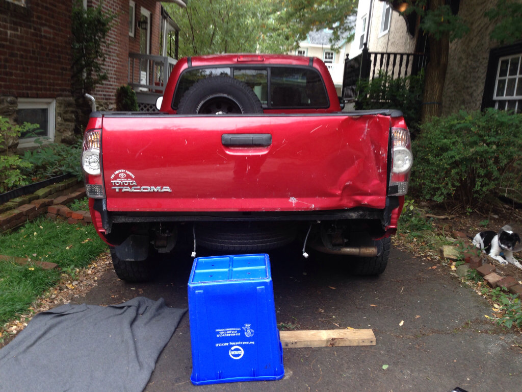

    And my custom lift for one man removal/installation:
    17f1ade765e6b53b393f378cc8981ad8_zpsd90f_4ad3e131dfc680746a1773e3bd190d935e397002.jpg
