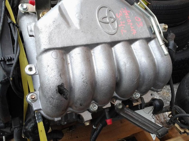

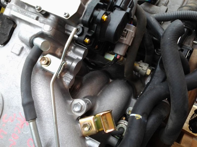

    Its been a while, i've been moddifiying my 4runner lately, but i finally located and purchased a low mile tacoma engine, only 69k miles, from a 03 tacoma prerunner from a salvage yard in Tuscon, $1200. plus $285. shipping. I was surprised after i unwrapped the shipping plastic to see a hole in the plenum, it was'nt there in the pre-purchase photos that i received and the plastic shipping wrap wasn't damaged. I'm gonna use my old plenum, i'm just concerned about any loose pieces of aluminum in my engine, i'll inspect when its off. Hopefully the inside is as clean as the outside. I'm gonna replace the tb and wp along with the oil pan/gasket and valve cover gaskets. I've read here that since the donor truck was a prerunner and my truck is 4x4 that i would need to swap out the ex. manifolds too. So now my $500 dollar project is a $2 grand project.

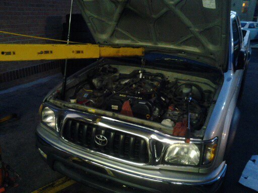

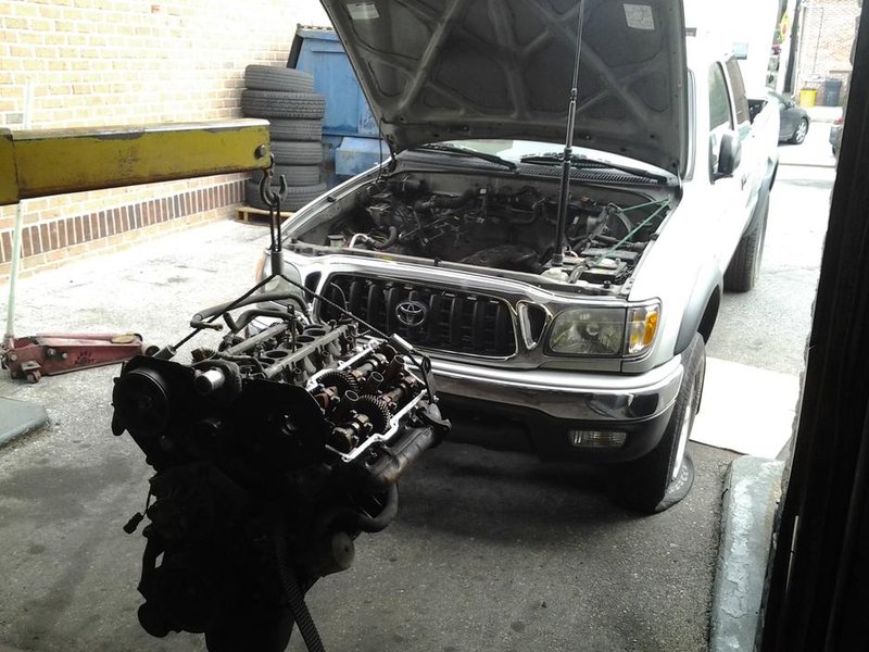

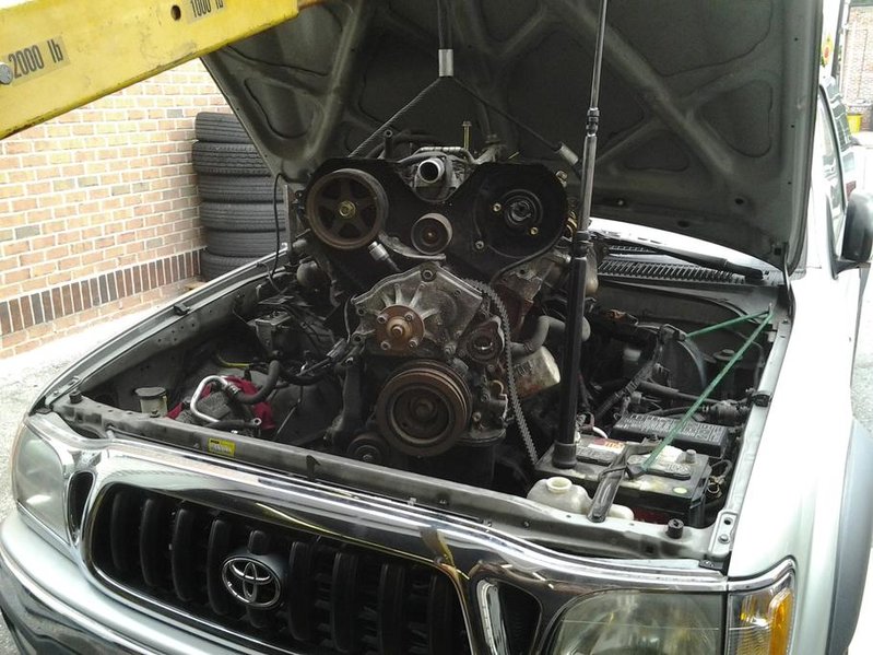

    Finally got around to pulling the motor out tonight. I degreased the engine bay, it was bad because of the leaking oil filter.

    Finally got the replacement motor installed and running last night. 69k miles on it. I replaced the t.b., w.p. and related parts, drive belts, rad. hoses, oil cooler hoses, Aisin clutch kit[wanted a marlin crawler kit but it's unavailable], t-stat, plugs and wires, valve cover gaskets, oil pan gasket sealant from toyota. Truck runs/drives good but now i have a po325 and po330 bank 1&2 knock sensor circuit malfunction codes, hopefully i just forgot to plug in a connector. I just picked up and quickly sold a 00 4runner, but before i sold it i removed the 2 brand new G.Y. wranglers RT/S from the rear and mounted them up on my taco. Now i just need to purchase 2 more matching tires.
