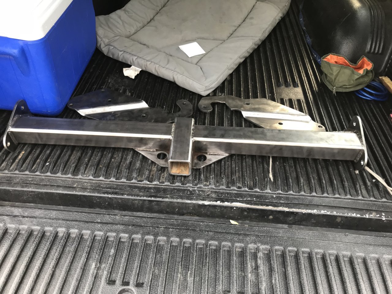

    Just picked this up today, all pro hitch. Now i gotta sand it and paint it.

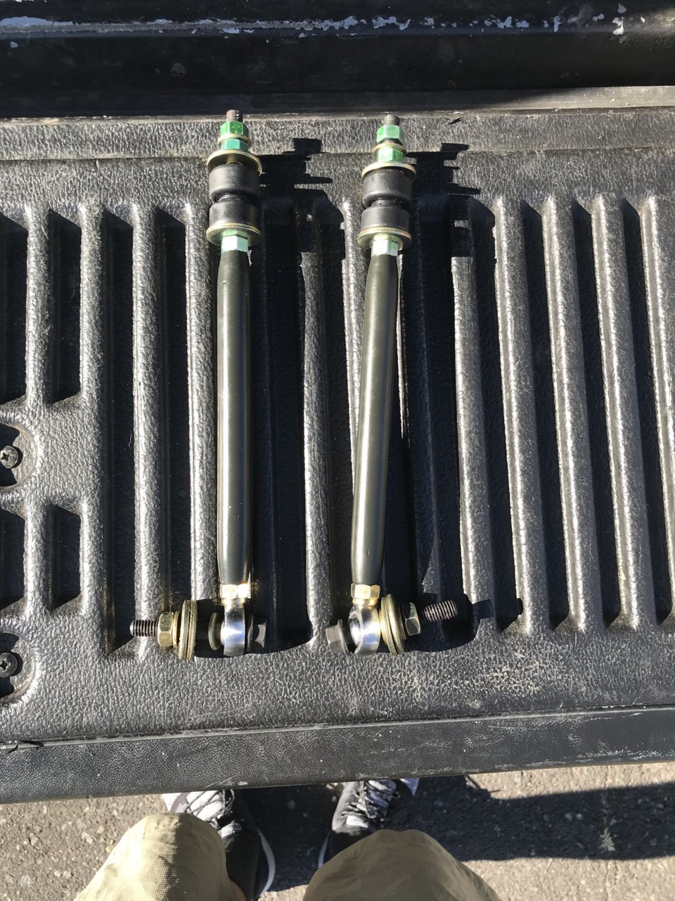

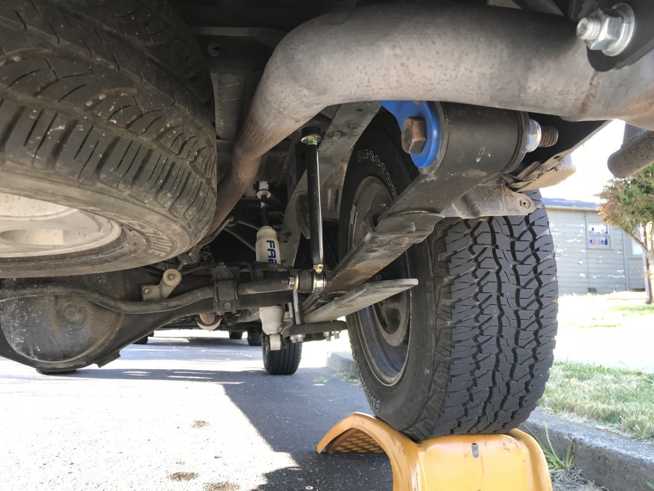

    Just got some custom rear sway bar linkage made by @Luv my yota , these things are sweet, had him make me extend linkage because after lifting my rear the stock one were to short and holding my rear axel up.

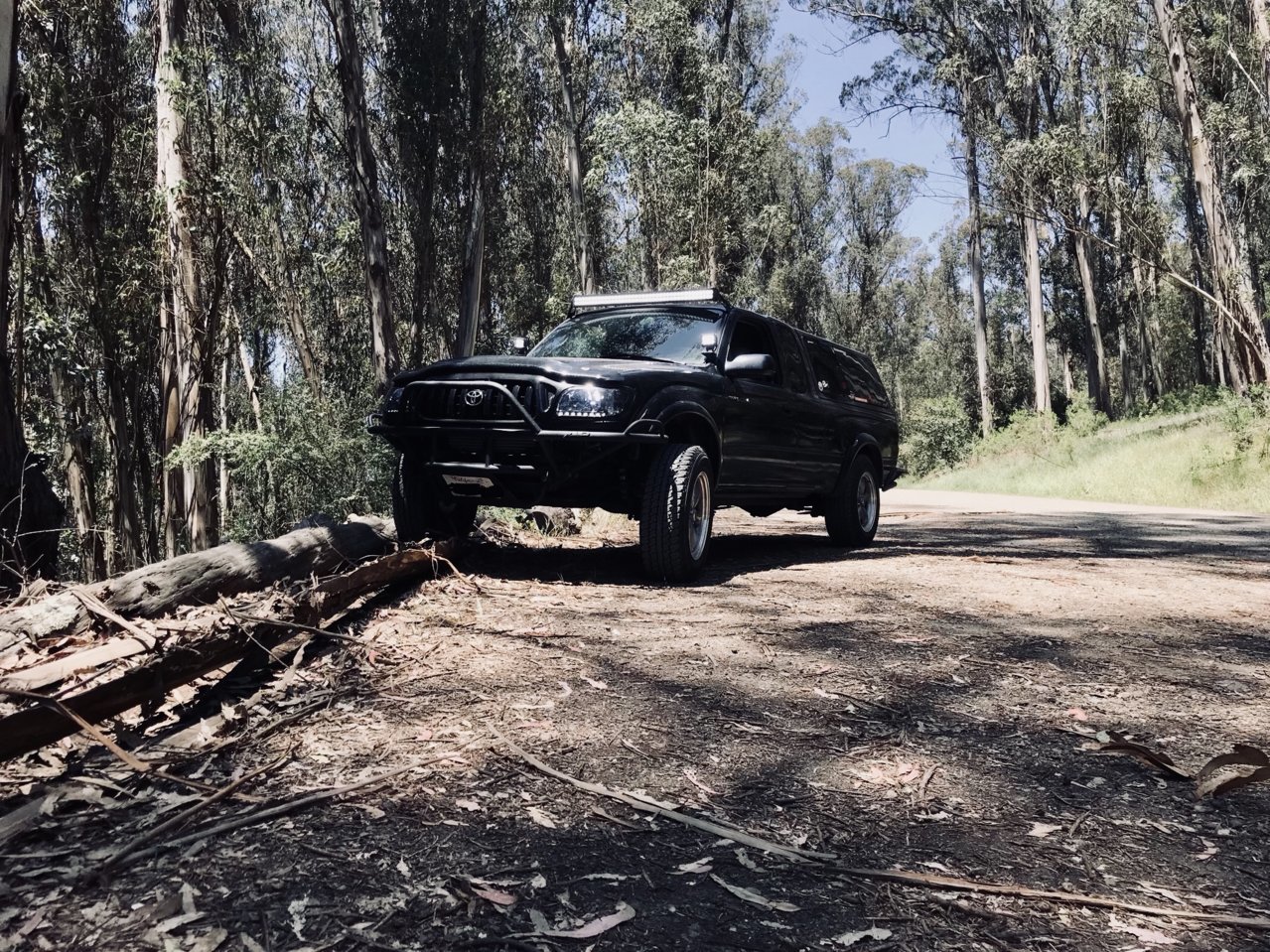

    Some more pics

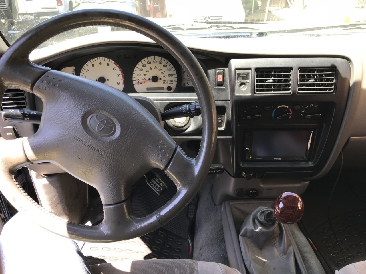

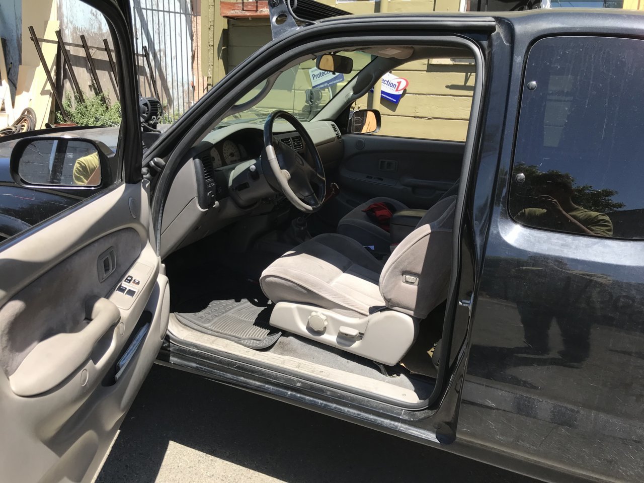

  11. Jun 2, 2018 at 11:30 AM
    #51
    J.A.92
    J.A.92 97 Tacoma 4x4 lx 5 speed manual.3.4L
    May 10, 2018
    #253130
    468
    Juan
    1997 Tacoma 4x4 lx xtra cab.3.4
    That’s a cool truck.Interior?
    Slashaar likes this.
  12. Jun 2, 2018 at 11:35 AM
    #52
    Sperrunner
    Sperrunner [OP] Respect the International Dibs Law
    Feb 23, 2018
    #245334
    48,291
    Miguel
    Berkeley, Ca
    2023 Ford F250
    Wd40, zipties, duck tape, and my hopes and dreams
    It’s mostly stock inside rn other then the shifter knob, sterro and voltage guage
    dasitmane420, Dalandser and Slashaar like this.
  13. Jun 2, 2018 at 11:36 AM
    #53
    J.A.92
    May 10, 2018
    #253130
    468
    Juan
    That things pretty nice.I like to keep everything clean and stock.

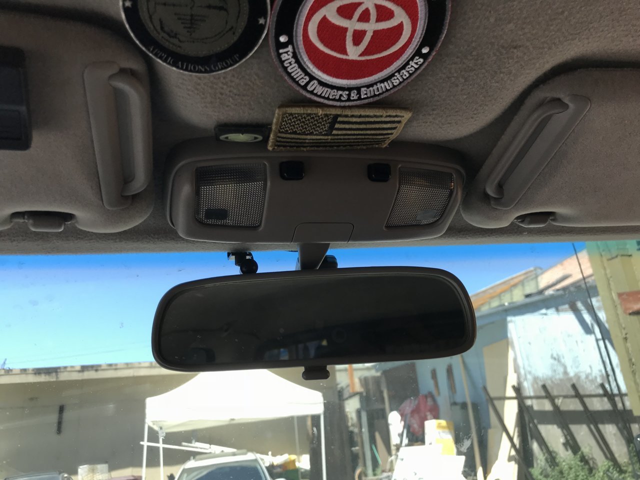

  14. Jun 2, 2018 at 11:37 AM
    #54
    J.A.92
    May 10, 2018
    #253130
    468
    Juan
    Does your truck have the map lights on the rear view mirror lol
