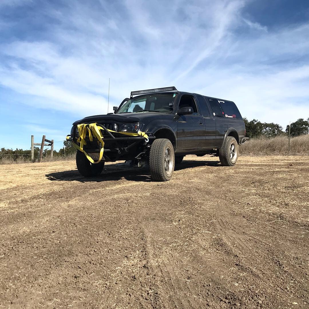

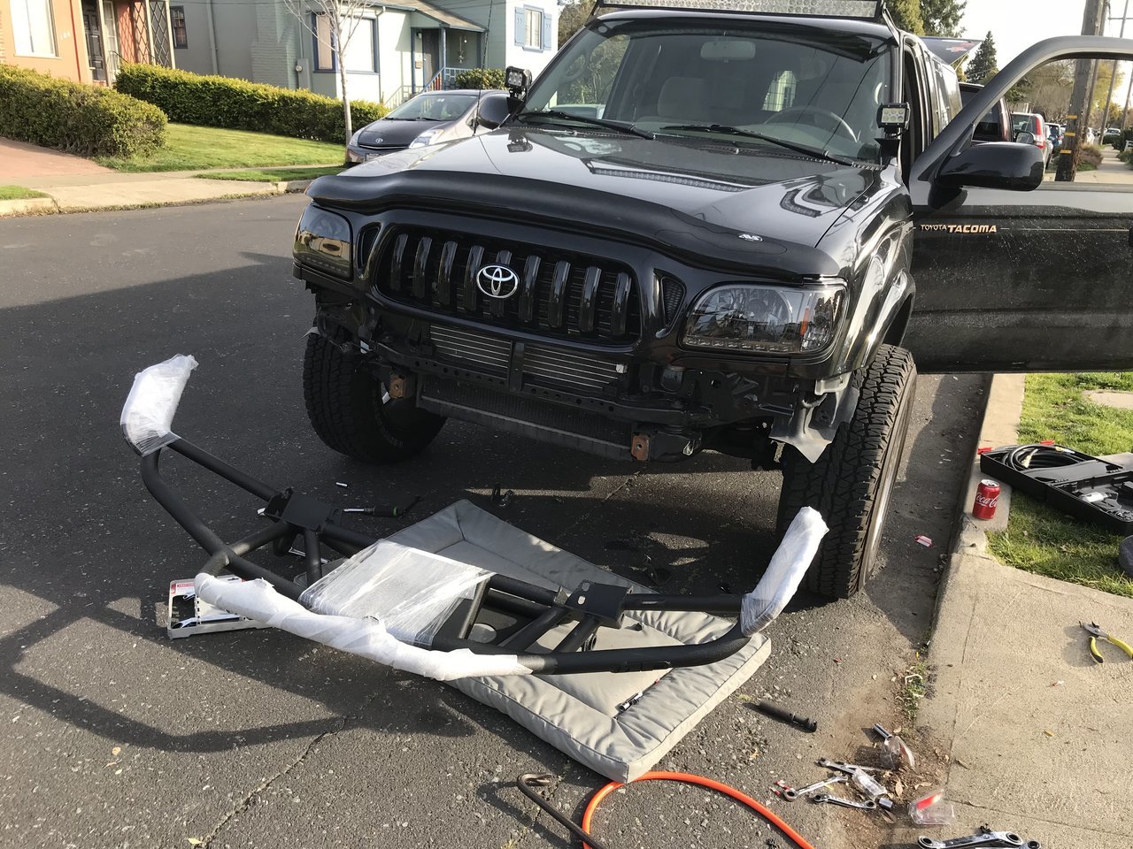

    Build update: all pro front bumper on

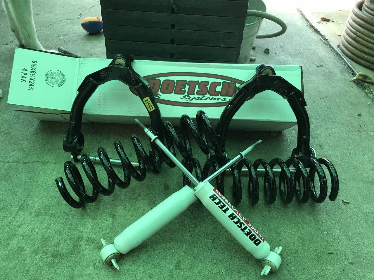

    The next step for my build, doestch lift coils and UCAs

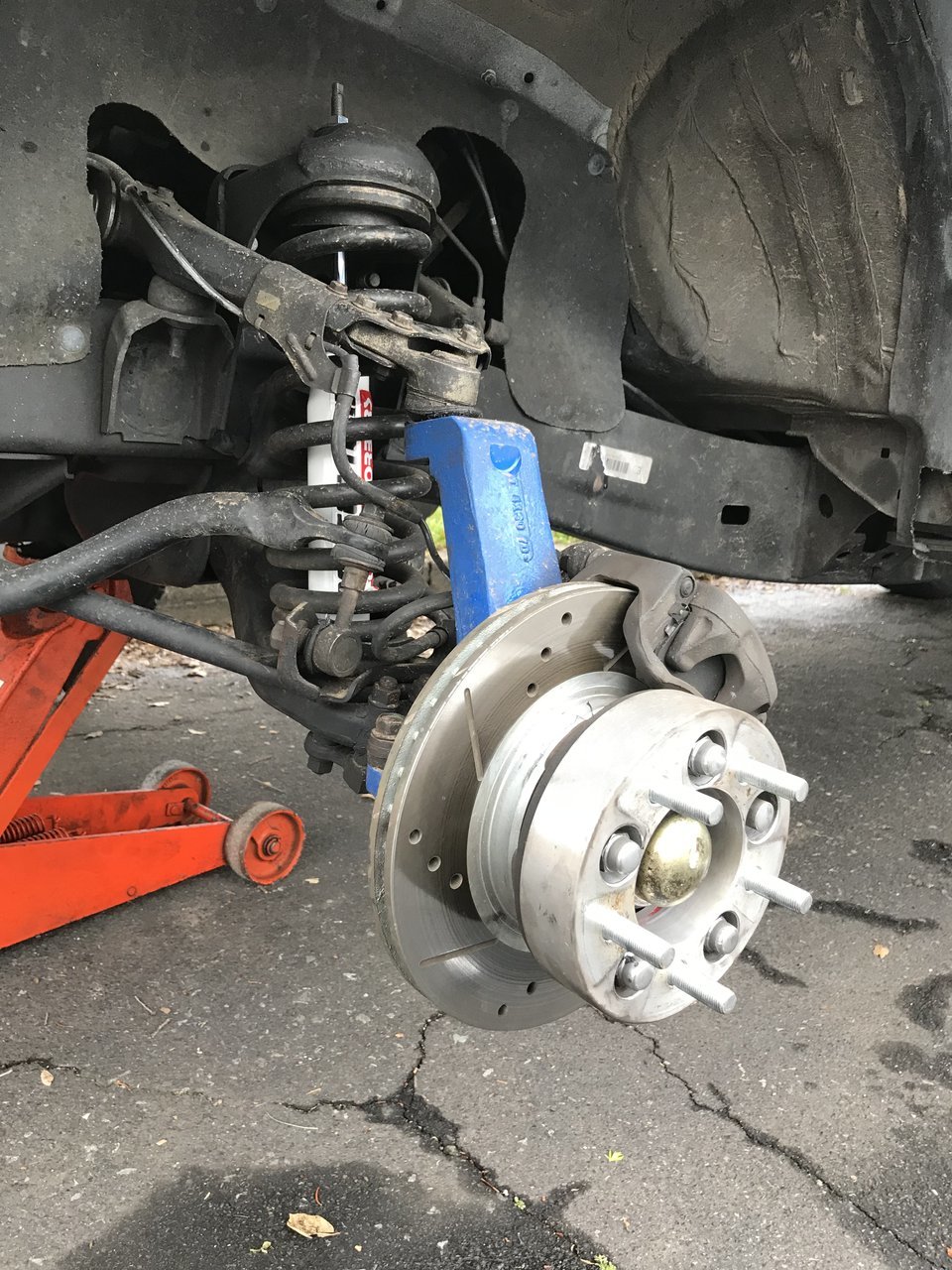

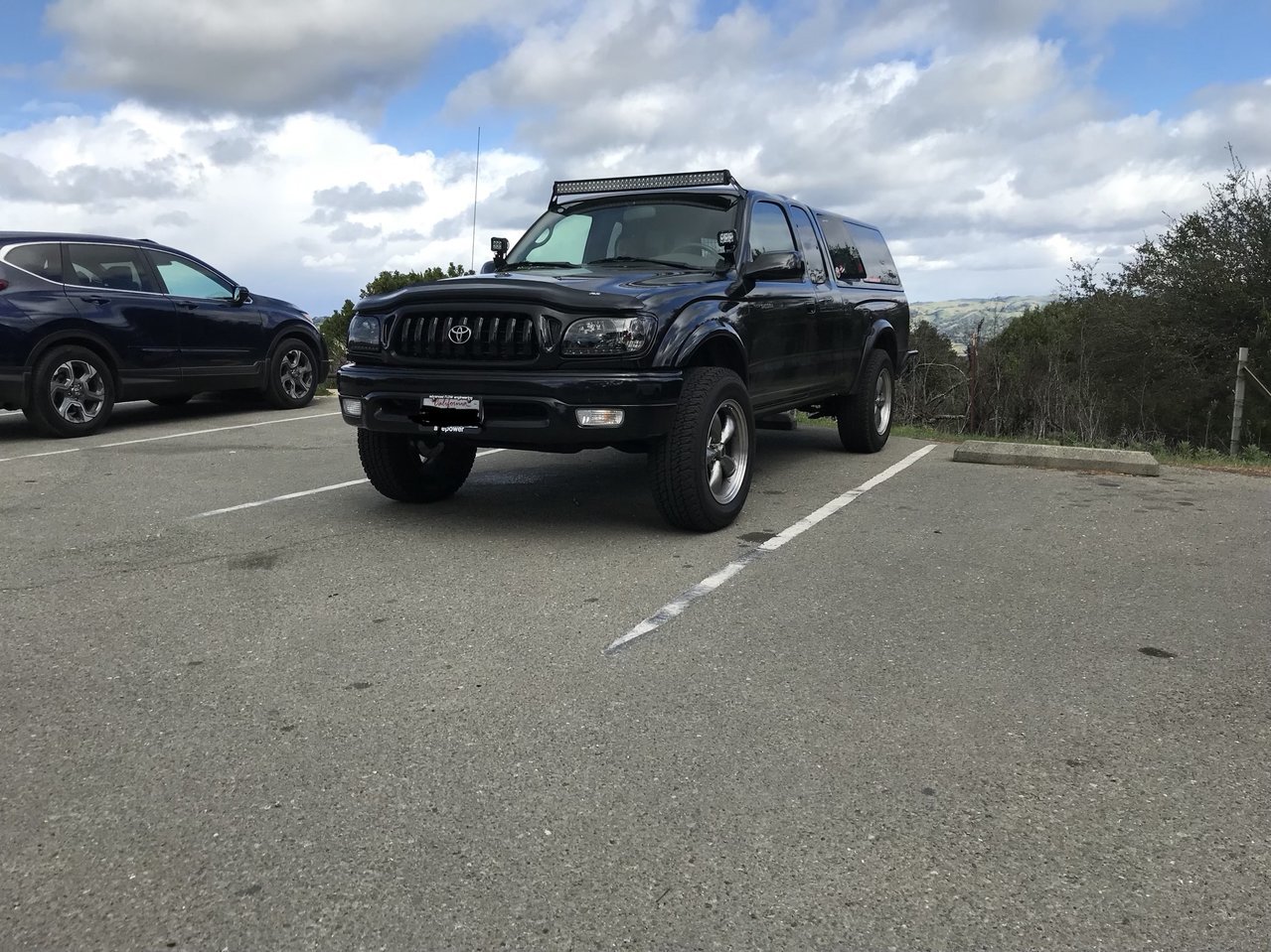

    Figure ill post a few pics of my setup on my lifted 03 5lug tacoma before i put this doestch lift on.
    Fabtech 3” spindles
    Daystar 1.5” coil spacer
    Power stop rotors and pads
    Doestch shocks
    Sixty auto 2” wheel spacers
    Energy suspension 2” bump stops for LCA
    Ride hight from floor to top of fender flare on 245x65x17 tires is roughly 35”

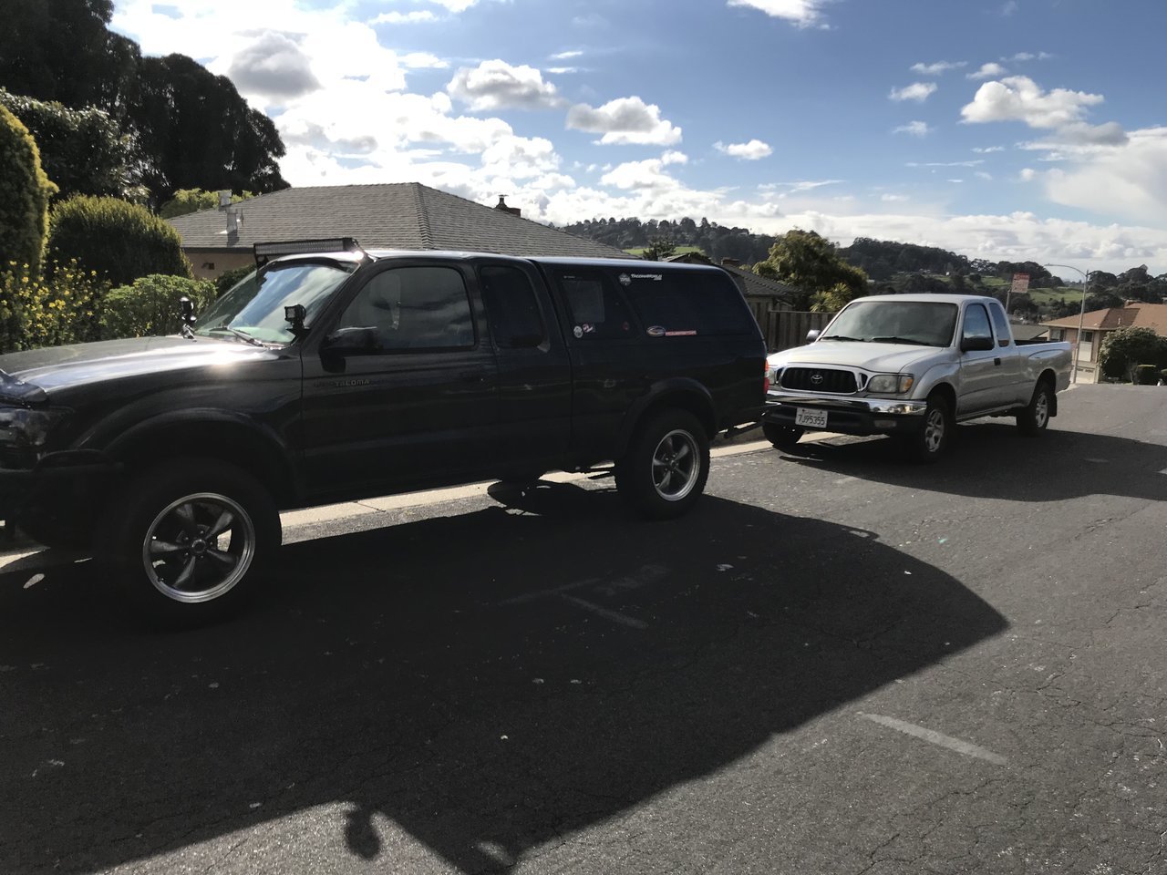

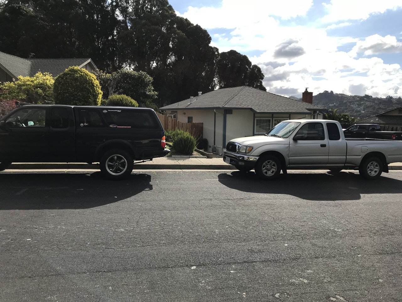

    Parked next to this stock 5lug yesterday, never realized how much taller i was over stock.
