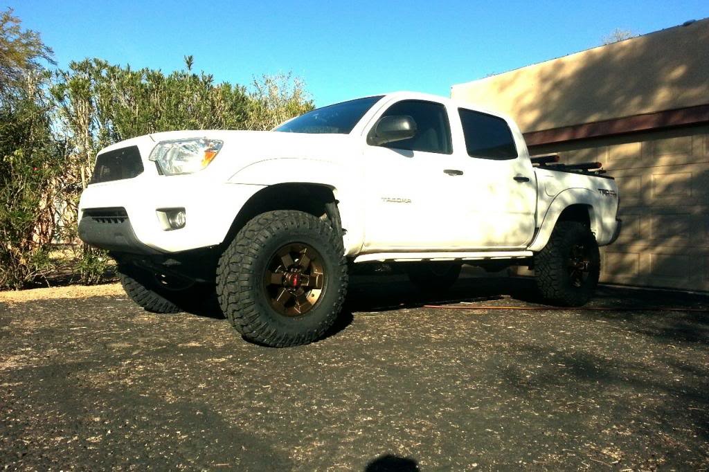

    Finally got it for the most part to the point where I can hold off and save up some more funds for next summer. Here is where I stand.
    2013 DCSB Superwhite TRD Tacoma
    9k miles
    Interior:
    LED Lights
    Weather Techs
    BenWa's Rear window electric Mod
    Exterior:
    AllPro 1.5" wheel spacers
    Bronze Painted FJ-TT Wheels
    33" Duratracs
    AVID Rock Sliders, Bedlinner textured and Painted White
    LED Bed Lighting
    Bed Rail Mounted SnowSki/Bike Rack
    33" spare tire stock location mod: stuffed it up under the bed
    Lift:
    5100 OME front: 3"
    AAL 5100 rear: 2"
    Future Plans:
    Daker Leaf pack, extended 5100's rear
    Hybrid Front Bumper
    Armor

    Looks good man!... Hey how much trimming was required to clear your 33 or did they not rub?

    None actually, i have the 5100 set on the .83" clip, 2nd one up, and have a 1/4" spacer on top. just had to unbolt the stupid black mini mud flap that was in front of the wheel. when i stuff the tire and am turning slight contact with bumper in the very corner, otherwise it clears nicely.
