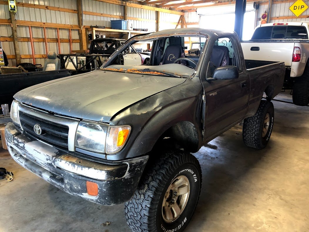

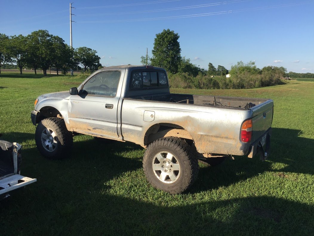

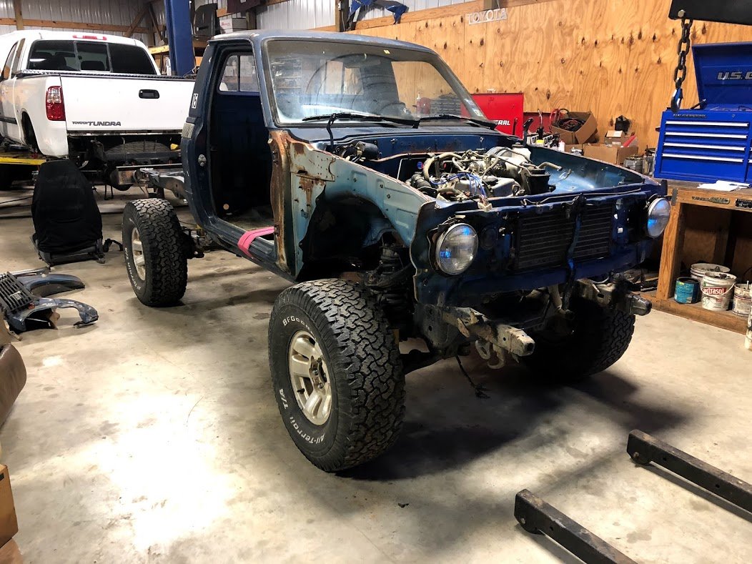

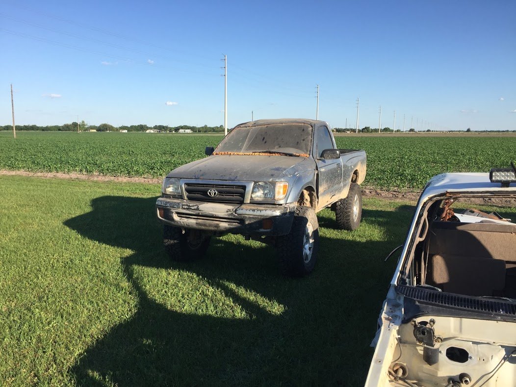

    A little backstory. I bought a rolled '98 Tacoma regular cab 4wd. Its a 3rz, 5-speed, 4x4 wtih 334k miles on it. Wouldnt run at all. Previous owner replaced everything he could think of to get it to run and then got fed up with it and sold it to me. I replaced the ECM and all was good. Runs great..ish.
    rLQ04MhiTQVCPIGKTiT8mmhn3LO2REfkqveyz9ju_4cd4e648606de9ca7f0424f2bcfa5aab4fd9c5f6.jpg
    It was in a slow roll that knocked out the windshield and crunched up the cab/doors/fenders/bed pretty good. Suspension-wise it has a full OME kit front and rear. Someone thought it would be a good idea to double stack lift kits and installed a strut spacer on top of the strut and lift blocks under the new leafs. Its all getting removed. The truck came with a beautiful looking e-locked rear end that i will be using to replace the one currently installed with a bad bearing.

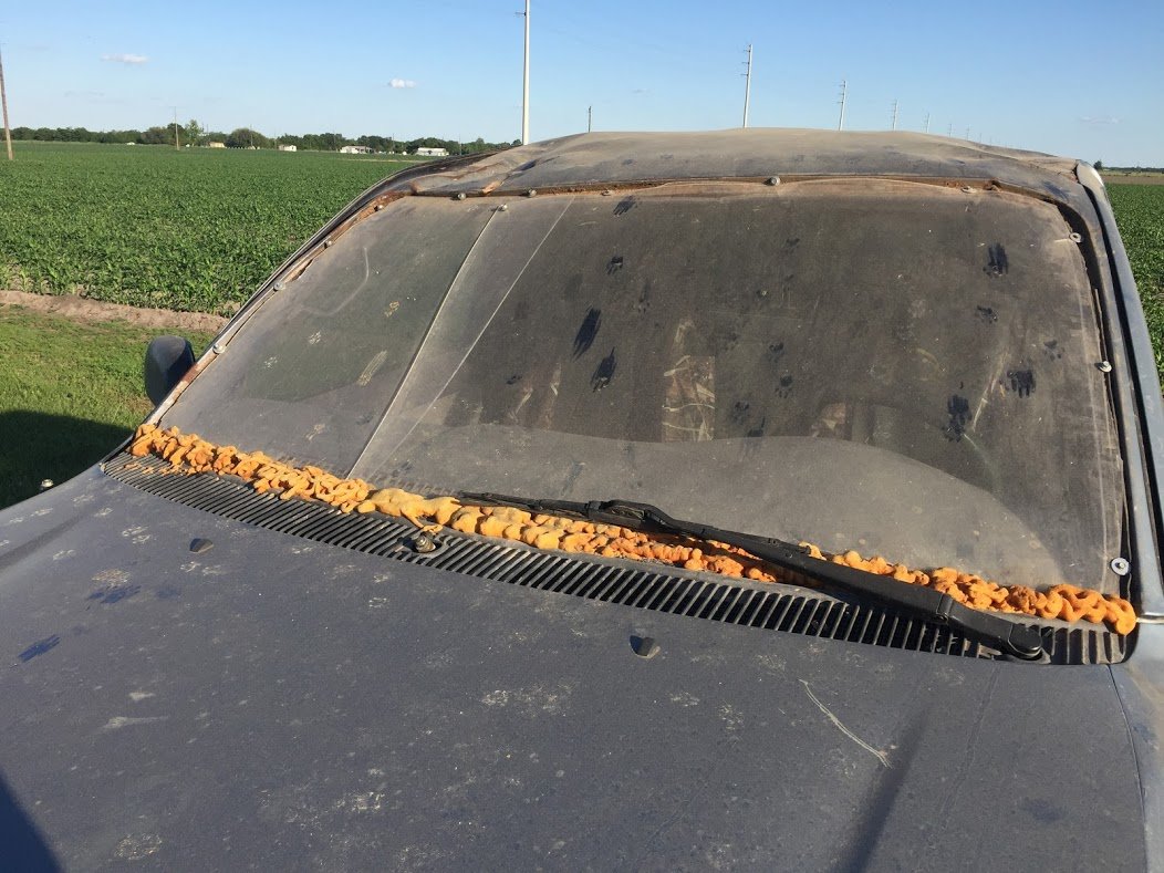

    Plexiglass windshield screwed into the cab and "sealed" with foam. This of course didnt work and soaked the ECM in the dash.
    0X_BZRtNxwMJk8Rc70KkeDq-MbiwNz9Xcf6aKpeU_685366bd516d3a88d50cedab5b2c706222ce9d12.jpglrRA-NtzP-cM8gY74eway74QKaTDkjLsLK2cvbus_b0270025c261a151ebdb283c0ac51d3eabf5116d.jpg

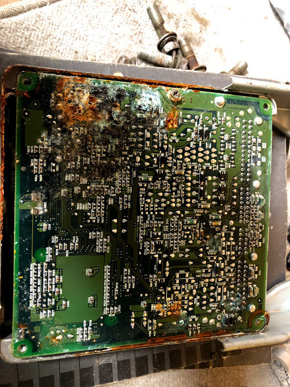

    The water damage in the ECM

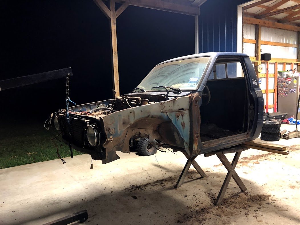

    I drove it around the yard for 6 months using it to pull junk around to and from my shop, when i started to try and figure out what i was going to do with it. I wanted to leave it outside instead of in the shop taking up space so i began to look for a new watertight cab.
    As some may know, i am kinda obsessed with first gen pickups. They are my jam. After some search i came across this little guy at an organic farm in Austin for cheap. My brother picked it up for me and it was on.
    vLc-RcPGKE-PpqeHu5oWTtyfDxa021f6py50Ojf8_9c59609bb356dc5652f2f9af2de54780fbf363f9.jpg
    mnV1rleGWYB9pA5A4YMrx4pLYyqTV0l2CQdw365y_c778709474f182a1d8e2a023b9efeb263ba0dfe9.jpg
    2a5Fa3sEXxbjD9YvWSvyF2SlFbNvtEYeBD9BLUBM_97feb106a03b385f46bc78091b48f8e3f02fa71f.jpg

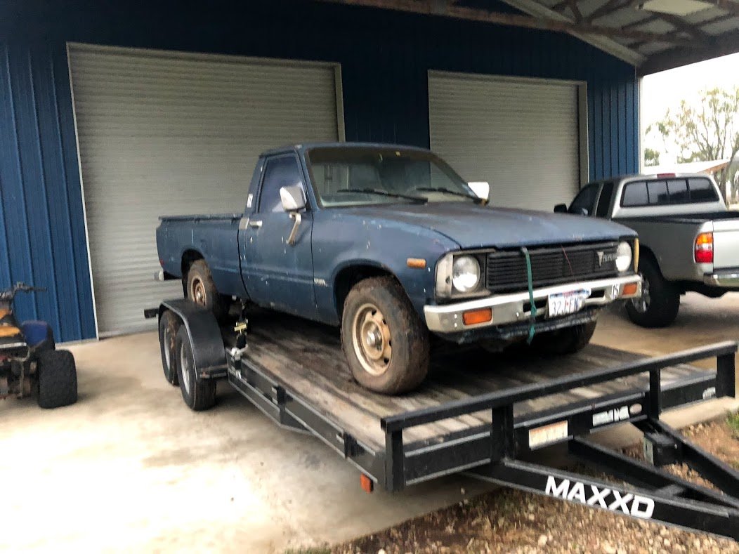

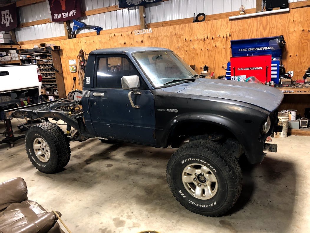

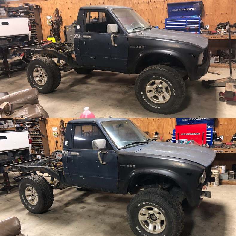

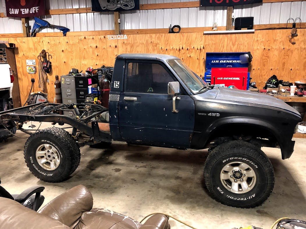

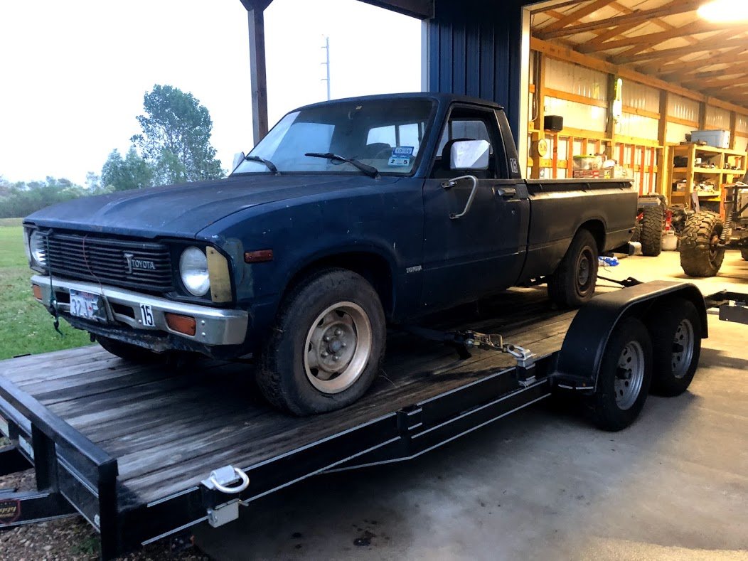

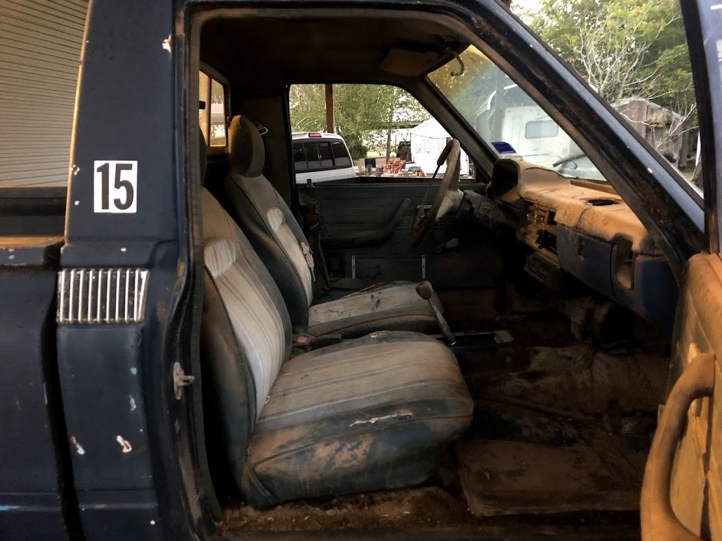

    The new truck is a 79 Sr5 with bucket seats, a 20r/5-speed and AC. Minimal rust all for $450, including title. truck was purchased wednesday of last week (10/30).
    First day i got the cab removed from the 79
    ZjPIHhqk9bxljp3GhMdP6D4wp0WT9mVG0-Je9tqK_8b9b83d93a8cc3533a958d931c6b2b62803ae71c.jpg
    Iywvd1sjPoEtsQZQ5eRmOUSFG3tYCuh2NkDk0cDL_2f93c48efcaf8fafe328a0af819f94197017a1c4.jpg

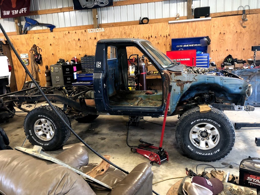

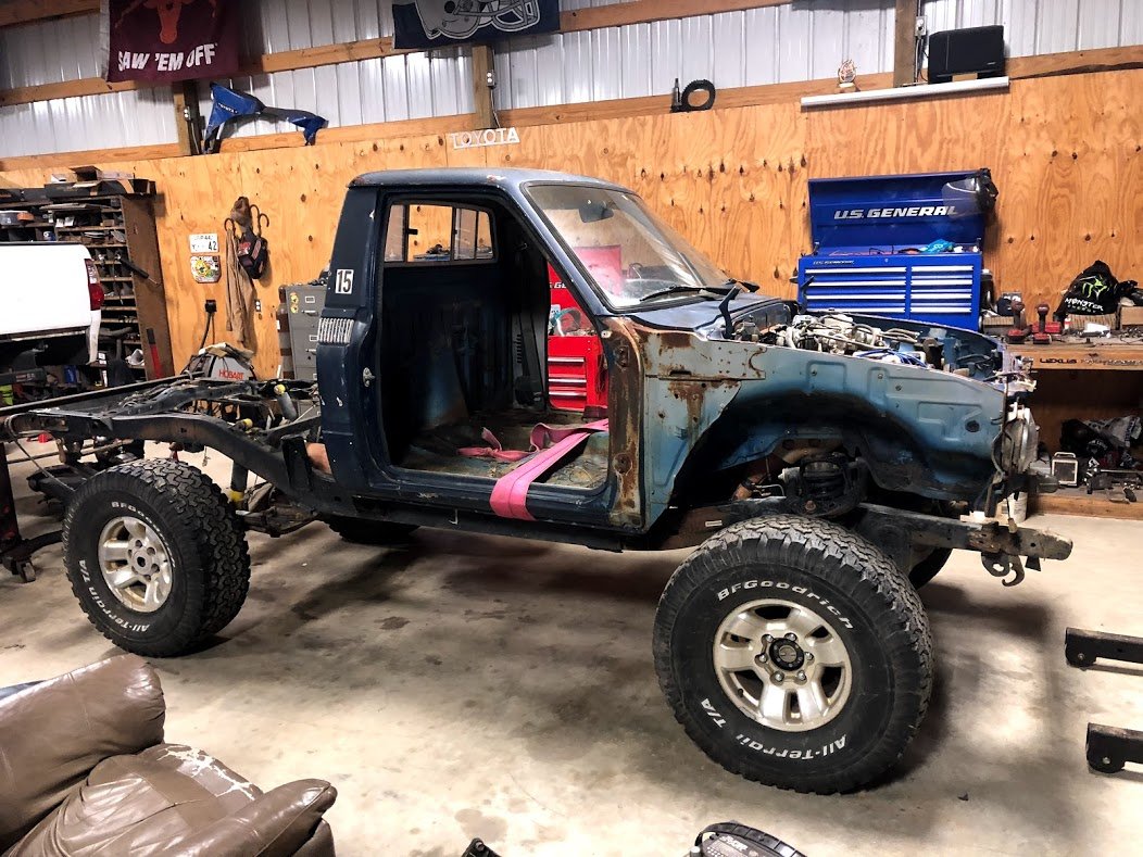

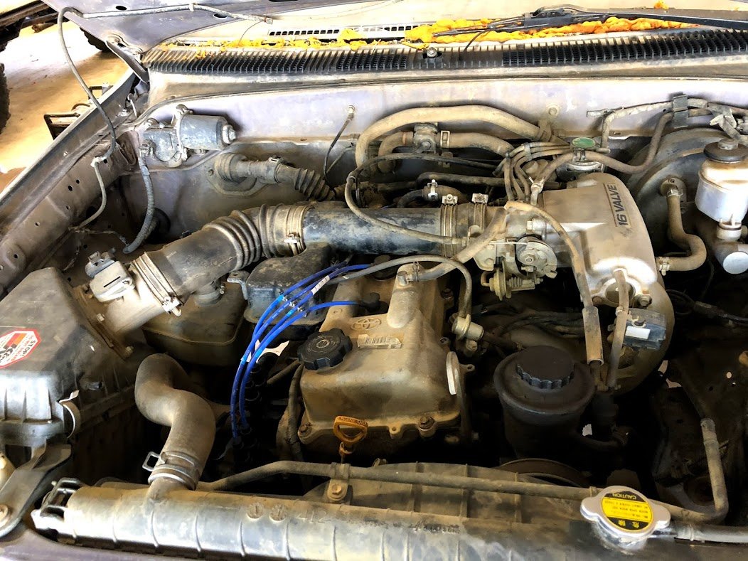

    Next was getting the tacoma ready to remove its cab. Took plenty of pics under the hood and disconnected the engine wiring from the cab. The powerful 3rz. I love these engines.
    P5951Y5mkJn2CXlFgGa28GbXnvykyg8uRyC0d-wj_70aff40ba656e0ba336f706bcd7a5dc89b6e87a6.jpg
    How she looked before tear down on some 33x12.5 BFG ATs.
    KPgjcvkaMBGQRHAnu7Wh03DDbm6va16khgkl6DpR_e94b0c844b7a3431b6fb84b8c775d9e9aa7877b3.jpg

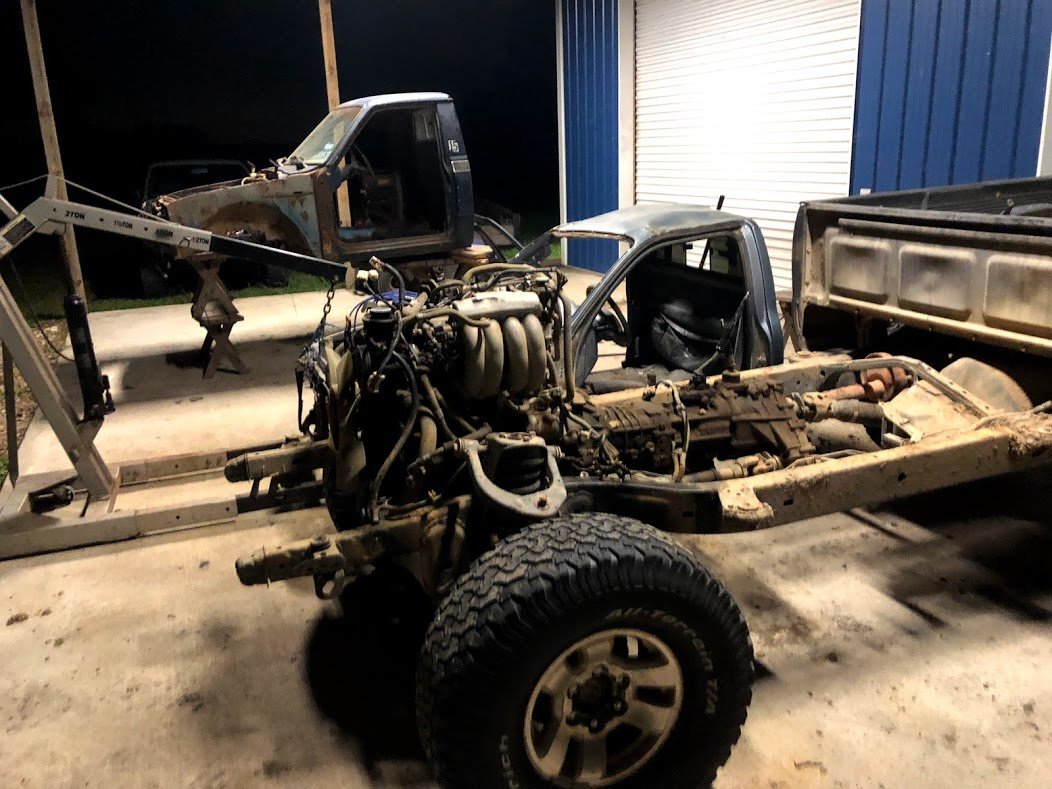

    Next up, taco cab removal.
    tahXpQVPH5wqQPvvLnFNeOQpim9vqYjR1UyqkBmW_f75d5bd6ce527615f6e05027e6a758b56f829d3a.jpg
    7-_TeqiEIQMFMSOVGsrXdwZ4AsNdNjA6O6gSjOQE_10ae310e78abab3cee94b24307573ef483c91b31.jpg

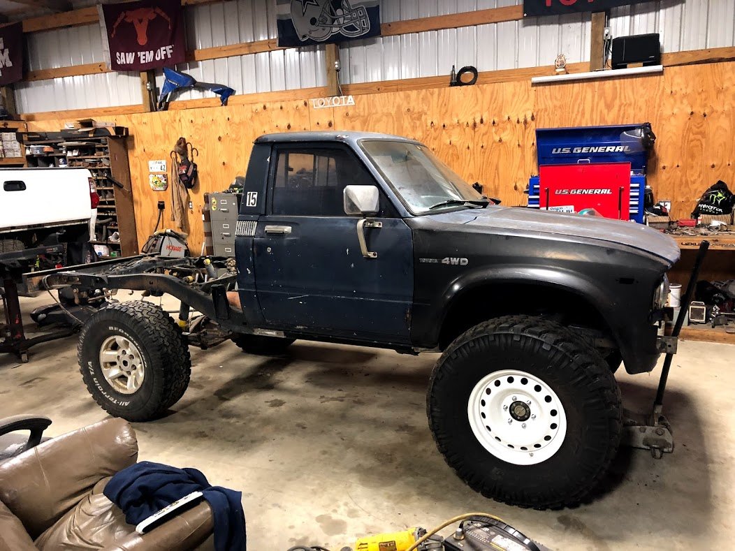

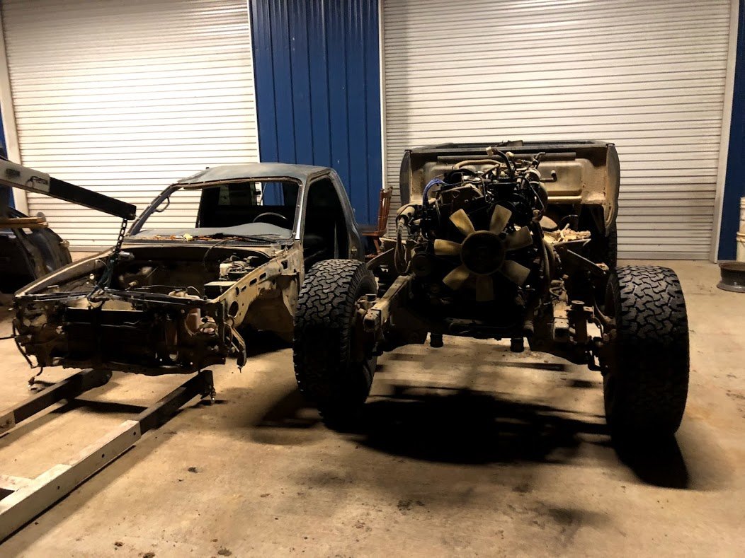

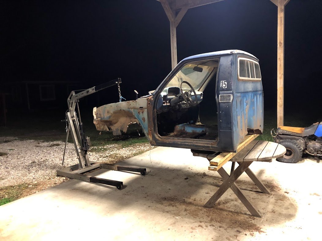

    With the help of a few buds and my Dad, we loaded up the 79 cab and got it sitting on the taco chassis. I spent a couple hours powerwashing the engine/transmission/chassis prior to this.
    Its just sitting here at this point. Still need to relocate the body mounts.

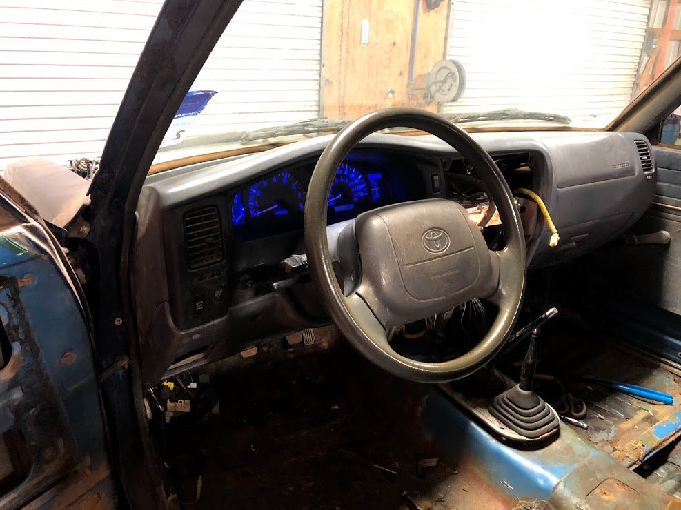

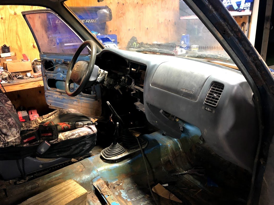

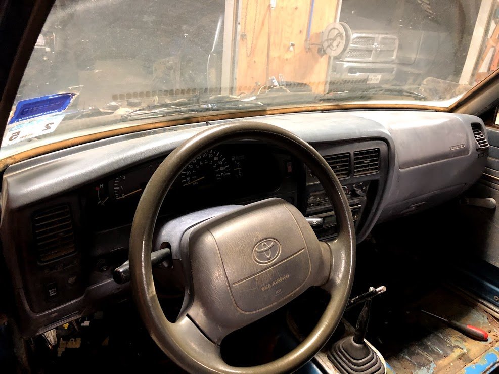

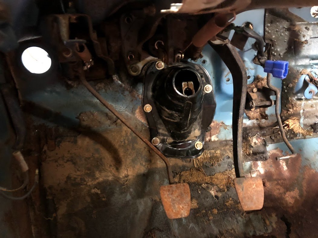

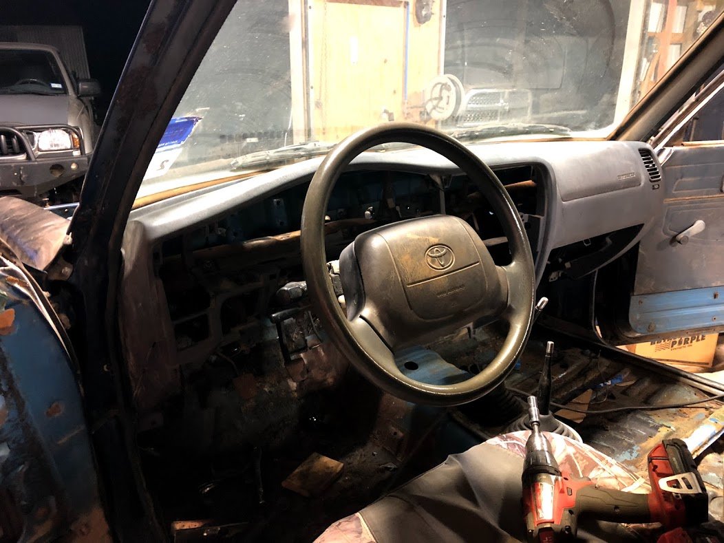

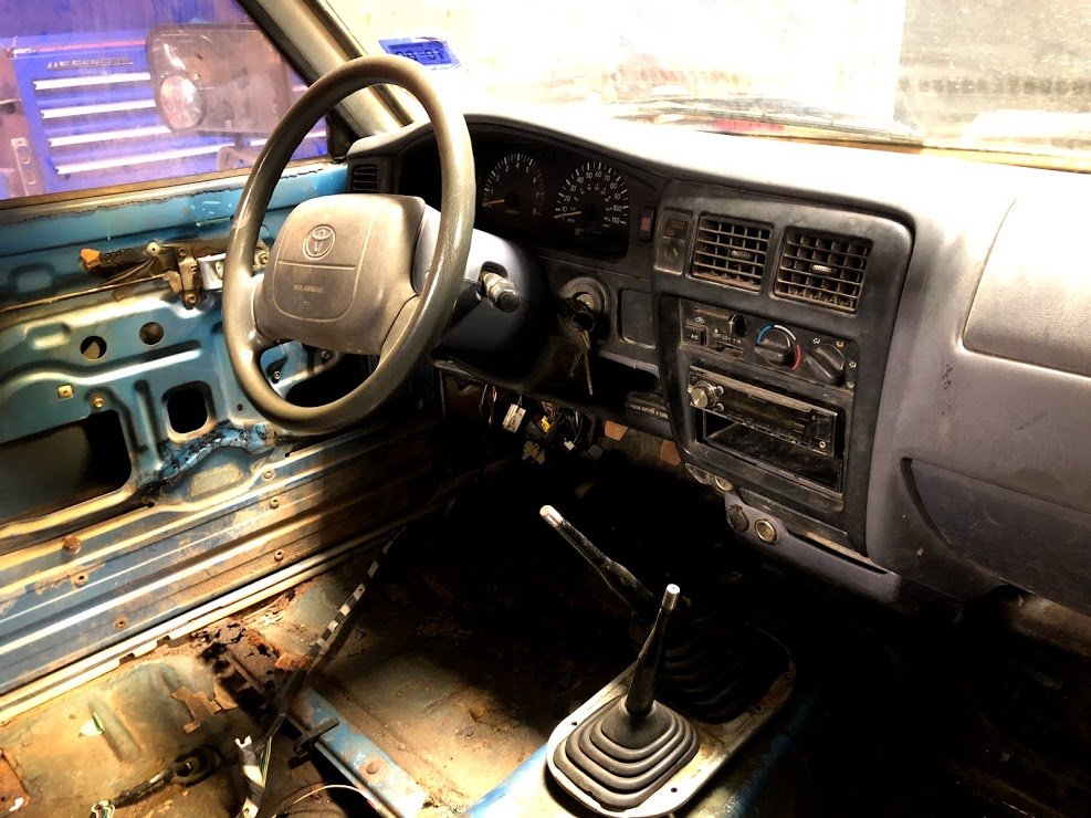

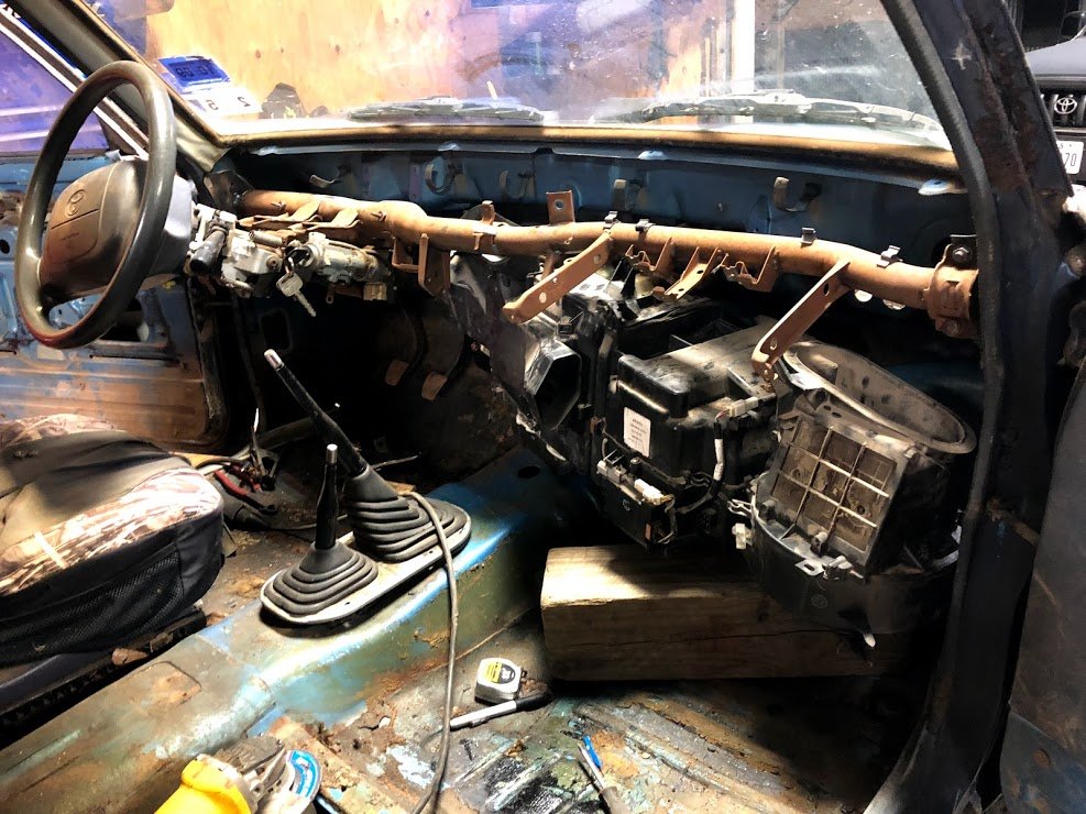

    Now for the fun part...everything else. I started on the Tacoma dash swap inyo the 79 cab. I reused the taco dash bar and modified it some to fit in the 79 cab. I made a couple plates that used existing bolt holes and welded the bar to them. I then set the steering column in place and trimmed the plastic dash to fit the curve of the windshield. Its almost in place but needs a little more trimming to fit nice.
    wdRL16IOZxlfTeOCu1wSmhu6HP1ooxQI0RnMQrBK_1b0fa0da0421d9b79e229244542d81f5f3080645.jpg-murhq4J870uNsT50Fl8oxVSJAsj4M73kLDmeabd_f81fd15f27b91f9e00613e6e8d14d2b6d17229d8.jpg
    Now i know this all works because i have had another first gen truck can on a tacoma chassis but in 2wd. Should have never sold it.
    5lueocNCJRwnnVkPRztfX7yb3WHVl9W2vhKiBCY7_4af3eda1b844dbf3aa065122c33fadfaf3356cdd.jpg
    qTTlXO2y2AOWSIkXMvMFaboe_xTeYfpCHEx5UPIB_32ffff041f2ec8cf71e797c14c23a37d1a4e5a3e.jpg
    IaZEVqSRmJqtX8BJssrWm_82Xp8gFV6SSm1BMYoh_0594e6170f91476c89a14dcac4bcb6e21a1271cf.jpg

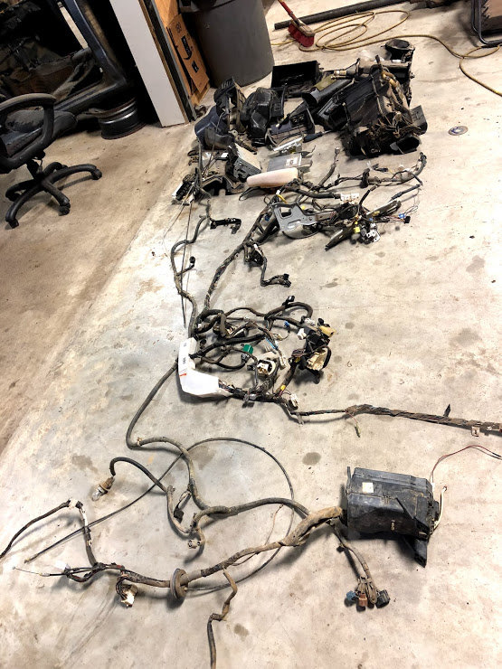

    I removed the entire harness from the tacoma last night in two pieces. Toyota was nice enough to use a connector connecting the under hood stuff to the under the dash harness. Makes it so much easier to remove. Its gonna be so much fun putting it back together.
    5BQ1im15nvFoK9HKw1CQ7YJ6F8X51j9Pf-Iwb1h3_7f0c5c8b28fffa6283cfeb610dc09e1bf70faa3e.jpg
    I also removed the HVAC system as well. I cleaned all the leaves and mud from the blower motor and tested it to good results. Some fabrication will be required to get all this shit to fit.

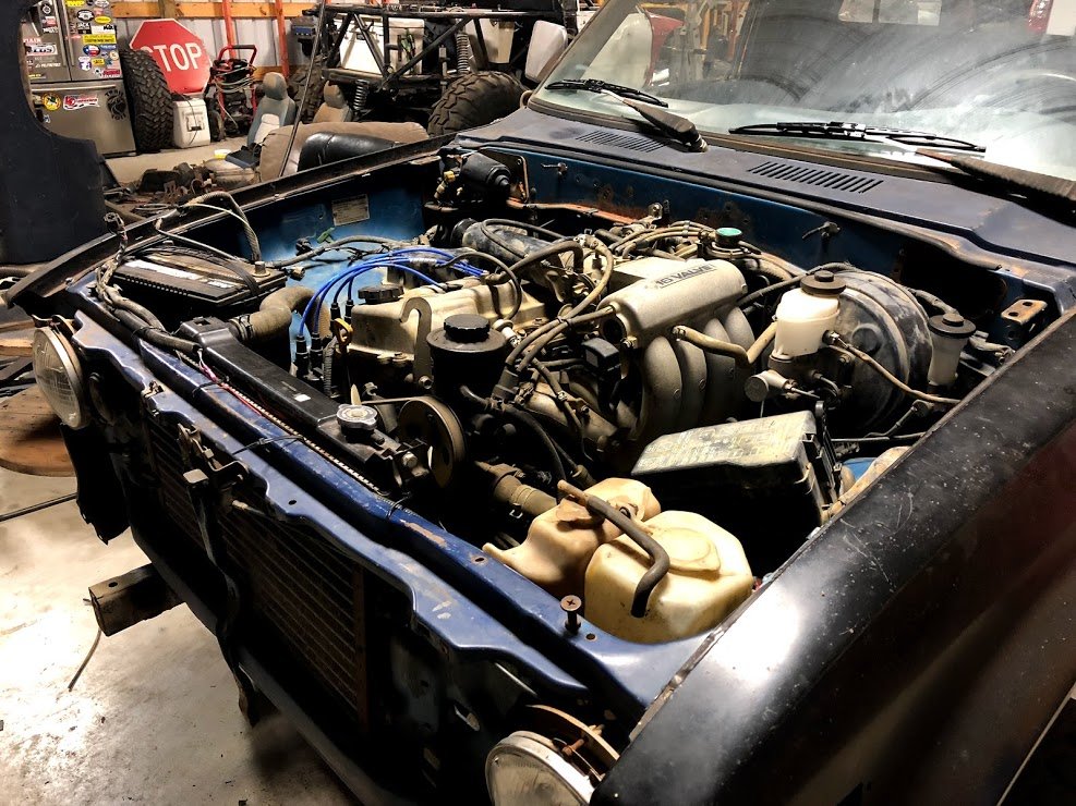

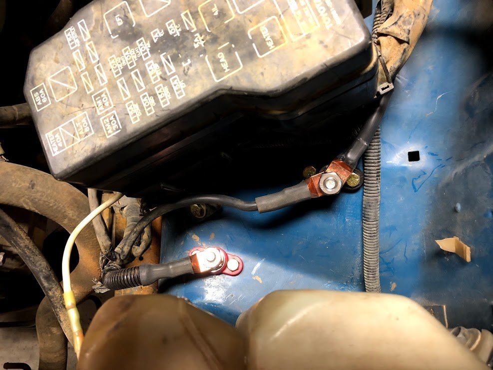

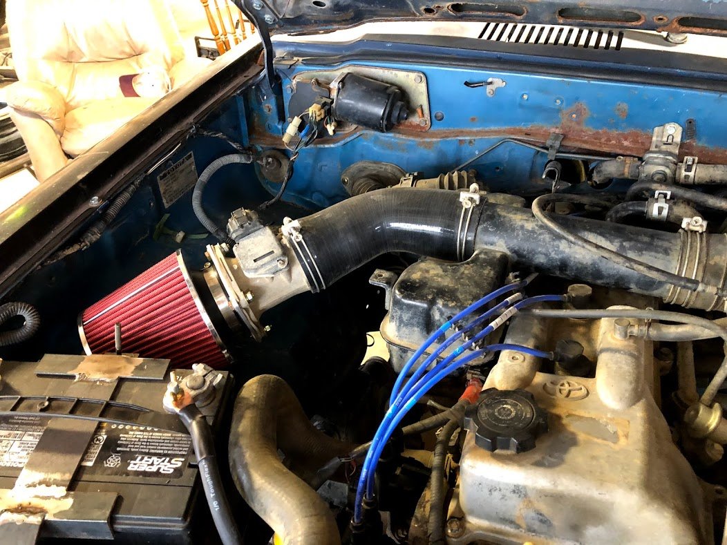

    I next moved my attention to cleaning stuff from under the hood. I knew the battery wouldnt stay on the drivers side (as per OEM tacoma) so moved it over to the passenger side where it was OE in 79. This meant i needed new longer pos/neg cables made and ran to the drivers side to make everything work. I bought some power studs on Amazon and started rewiring things. Im waiting on some 1/0 welding cable to come in, then ill connect everything up.
    KYmjpUkG7iLcbhV8Af6p3YYxdQ3pgpFOnol6xSv2_8c35417c9ecc385e4dd6fd11af810365360fc12a.jpg
    alKDynPaPjpHwm4tv1caJrOXKfwxwM_OJb7JvCZF_859892d408f2f44477ff8cee13d59e5d44adb668.jpg
    Because the battery in now in the way of the air filter box (which was too tall to fit under the hood anyways), i bought a MAF filter adapter and cone filter on Ebay to replace it all. I also bought a silicone 45 degree elbow to tuck it behind the battery.

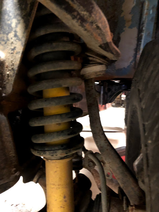

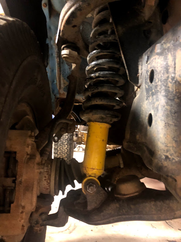

    I am also going to unfuck this abortion of a front suspension. Double stacked lift kits are no bueno. You can clearly see my issue here. Lowering it back down will help the UCAs, shaft angles, steering rack angles, etc. There is definite contact here. While i have everything torn down, ill swap on some tundra brakes/rotors that i have from my 05 tundra SAS project. Then i start on the rear E-locker axle swap and get rid of the lift blocks to level things back out.
    4ADl2o-9QZPpTouHNa2u7ufrVFx_B5lhe_a0OEh4_1f344ac6316a2bfff1d931b8740267167dc206e0.jpg

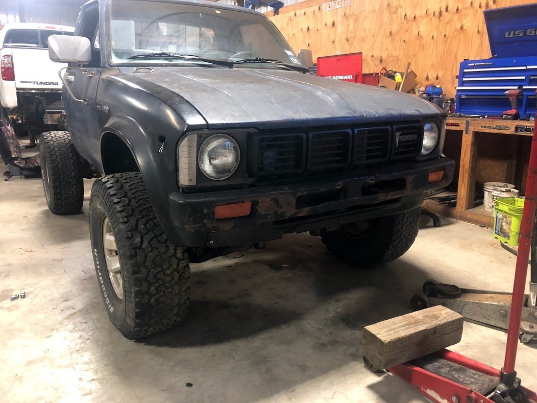

    Front end is no 99% complete. Swapped the grille and bumper for a 4wd one. the 2wd chrome one will not fit the 4wd fenders due to being narrower. Still need to buy some more parking lights for the fenders.
    IzPwb9AWn-YYpgAYeTW6dQ_x2E8Ry89eYFdiAfuI_087a7d2b0ec779dbccf280a0f9931c5fdffed184.jpg
    Also unfucked the front some. Removed the 2" spacer on top of the OME lift coilovers. Brought i down a lot.
    u19kqMh2kOBJh9Ai2zIYqDd12uGRvezxPT0hOVtb_92afe1d93cacea64fc3cb778533e80ee4e1146e0.jpg
    I now have suspension again and no binding.
    BogPJahIE1OrVfS3FqEnm6LXhVP6uYPOMtqU98aE_62b70ca07fa73d64dc632d7e1eee7e266056b9d9.jpg

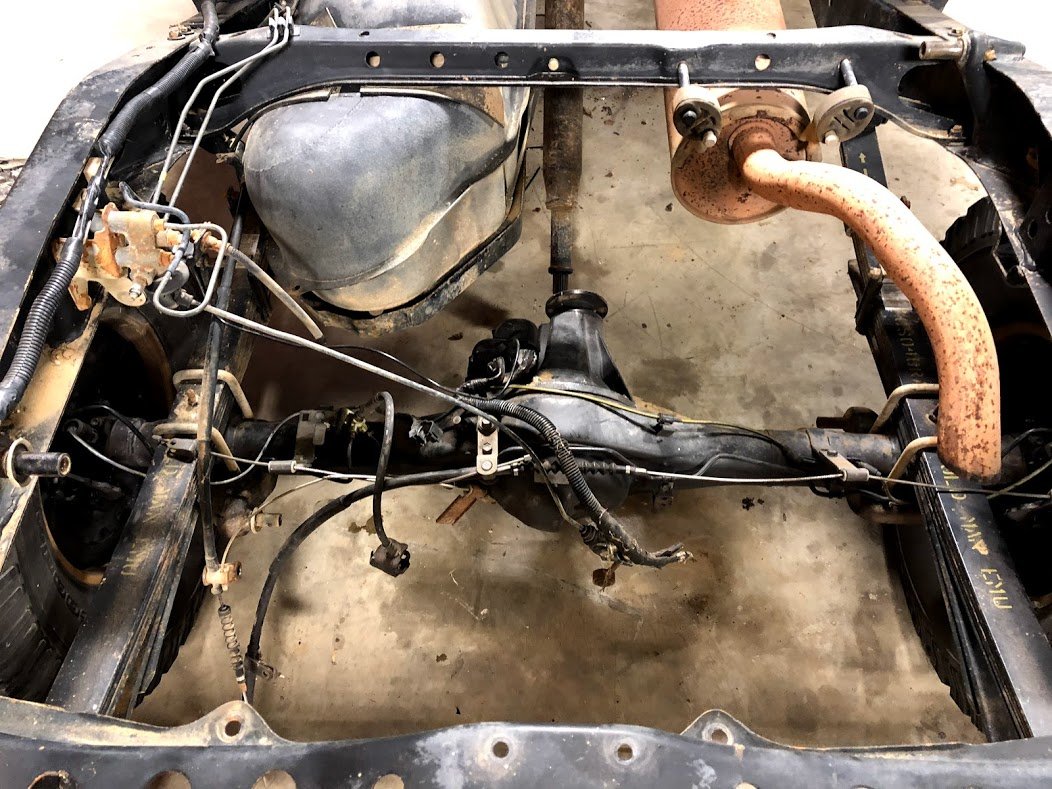

    933

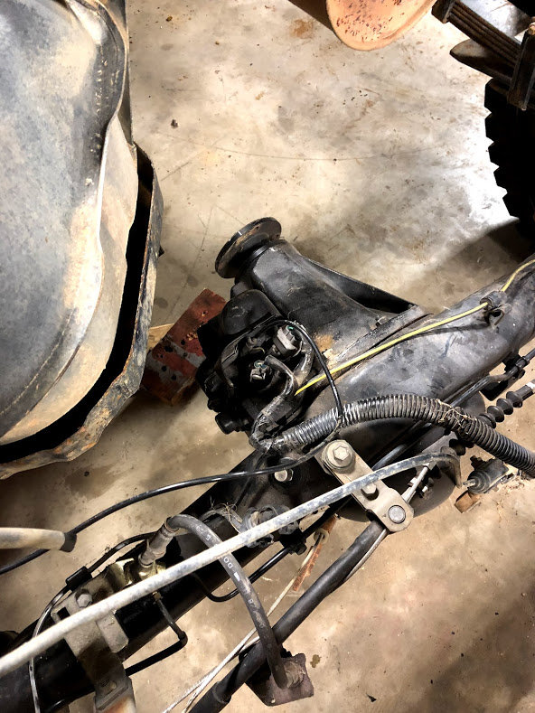

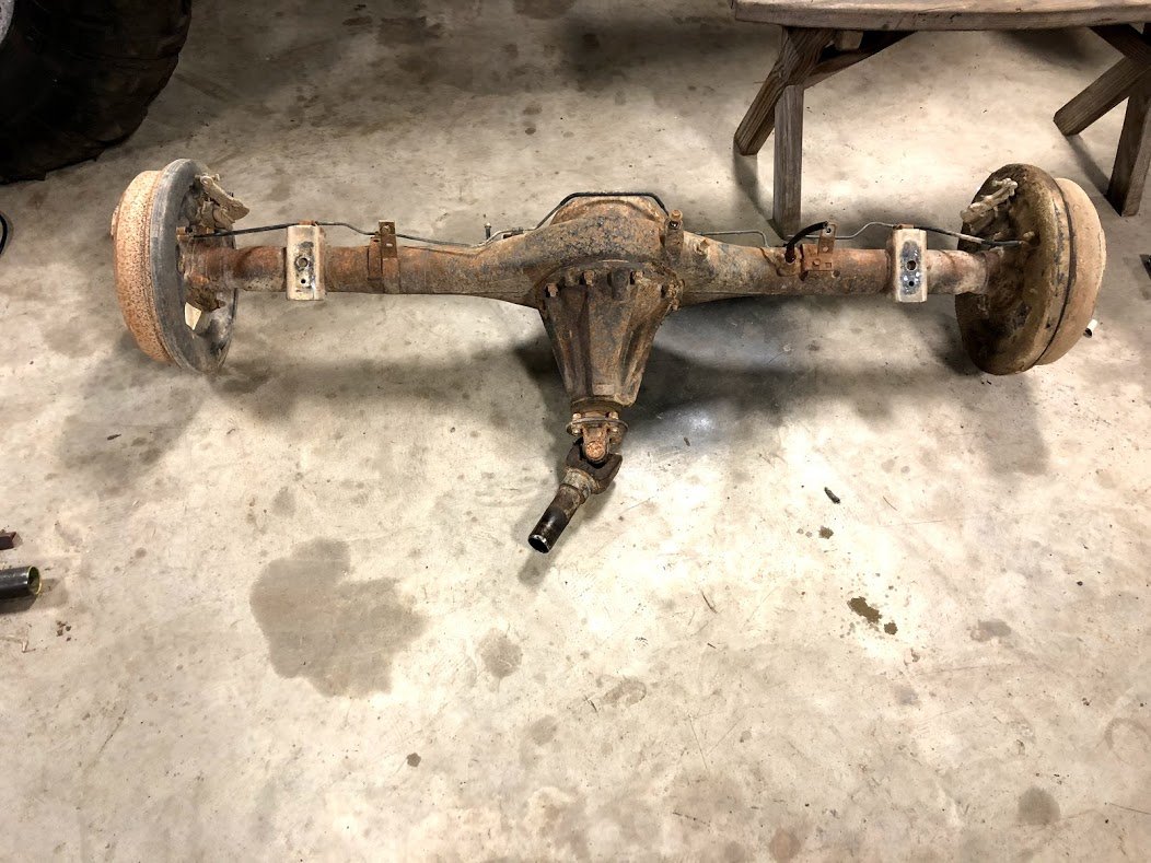

    Swapped out the bad rear end with the nice e-locker rear. Gears are the same and it was a straight bolt up. All i need to remove is the ABS wire since this truck didnt have it. The old one has a bad outer bearing and was making an awful knocking noise. Third member is good. Also removed the 2" lift block during the swap. The previous setup had the shocks fully extended due to the block. Rear rubber brake line was also banjo string tight. it was bad.
    oM-90X-uB2N9jL9X3TktXzM82VxSJ8X7pjZb00Ru_0fb4fae438dbdb818fd8dce4bd49f17fa0208e5e.jpg
    E-locker rear. Ill probably get the 12voltguy.com harness for easy install.
    http://12voltguy.net/product/e-locker-full-kit-switch-cable/
    jDCAH39s-0H8Cj2-xeIOm80RrL_Ct6MVUg1Zbpim_ef0cef6fc13439fde70dbddc16187b29d1e377b8.jpg
    The good stuff.

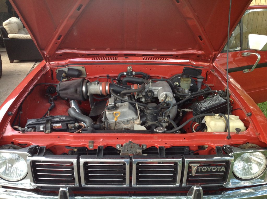

    Also bolted on 30-40hp with this MAF adapter and open air filter.
