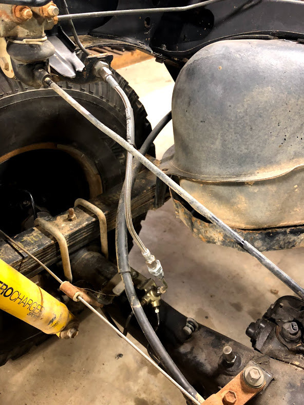

    Finishes the install of the rear last night, minus reconnecting the driveshaft. Parking brake and brake line hooked up. Shocks back on. I have suspension again. Next up is cutting the bed down to size and getting it mounted up. I hate welding toyota sheet metal.
    I had a stainless line on the shelf with some adapters that was left over from my mini truck days and got it bolted in.

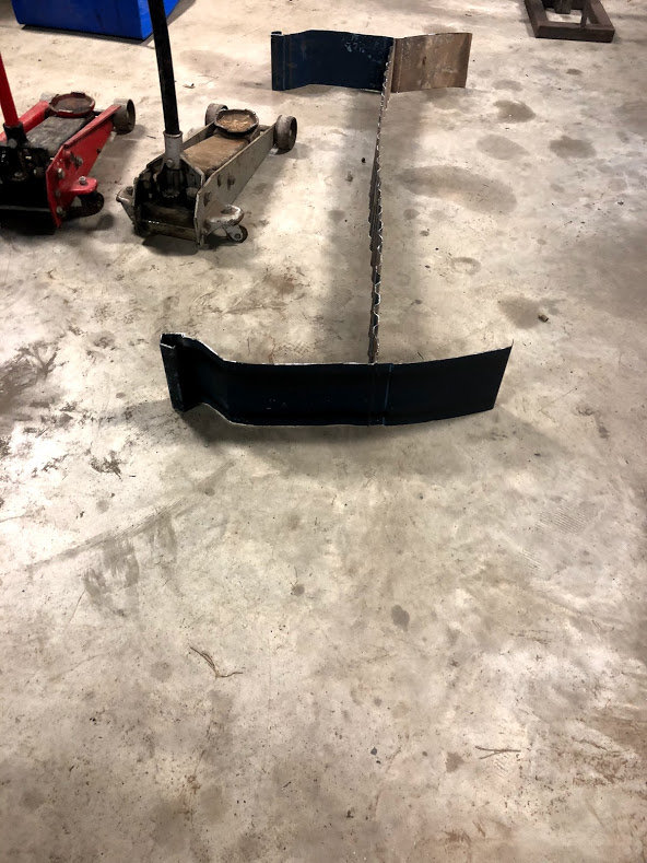

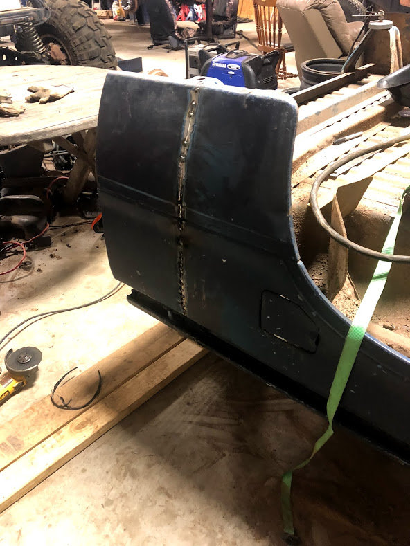

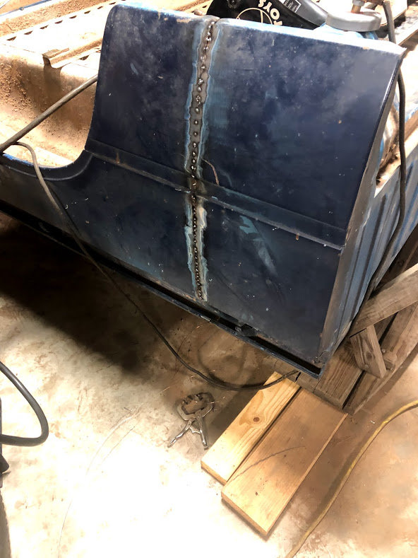

    7" taken out in front of the wheel wells. Its welding together nicely with some 0.024 wire and a low amperage. Minimal blow through.

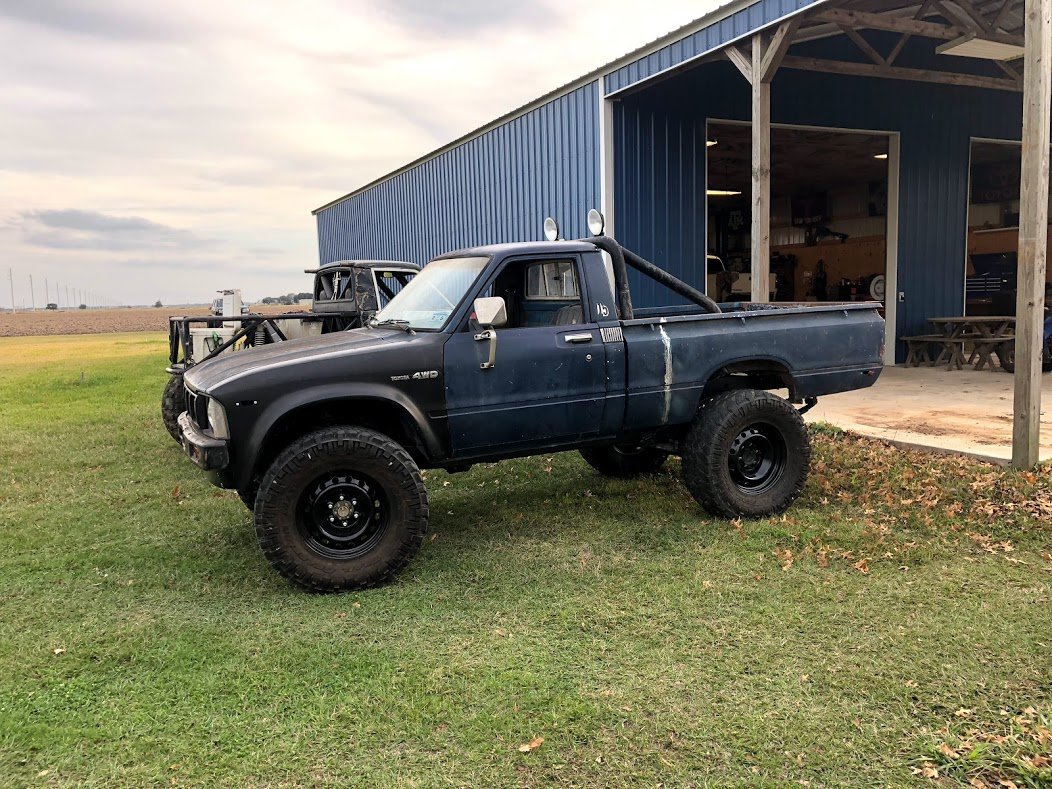

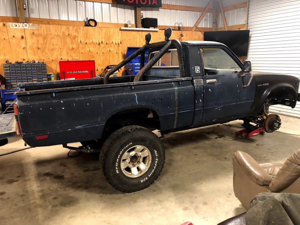

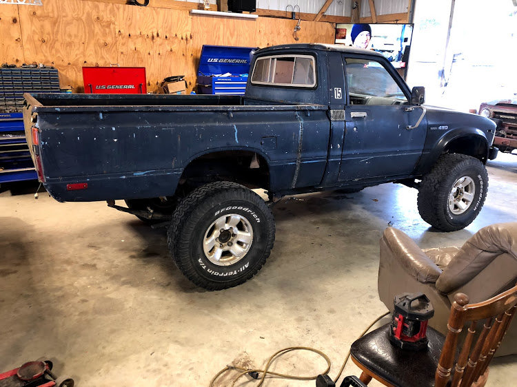

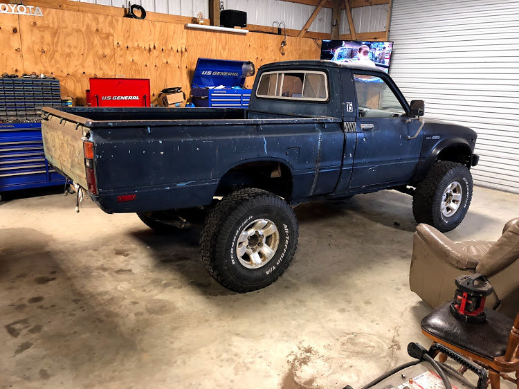

    Bed is mounted. Still need to finish weld out the bed but its on there.

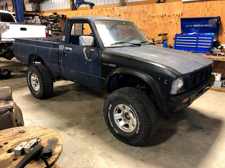

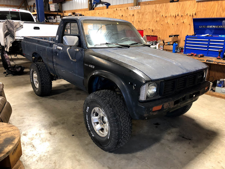

    here is what it looked like with the two OME overloads still installed in the leaf pack. Lowered it down a couple inches.

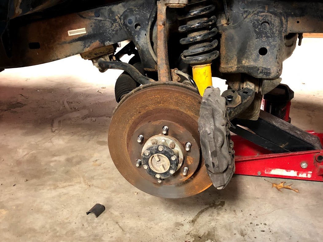

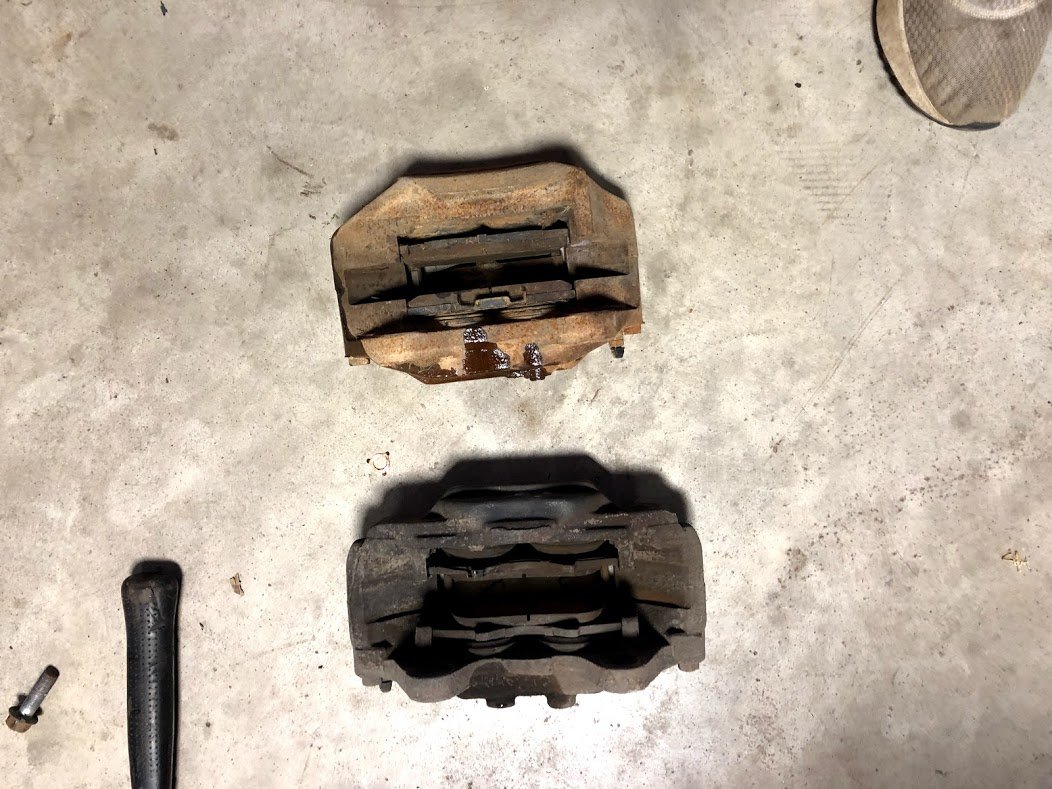

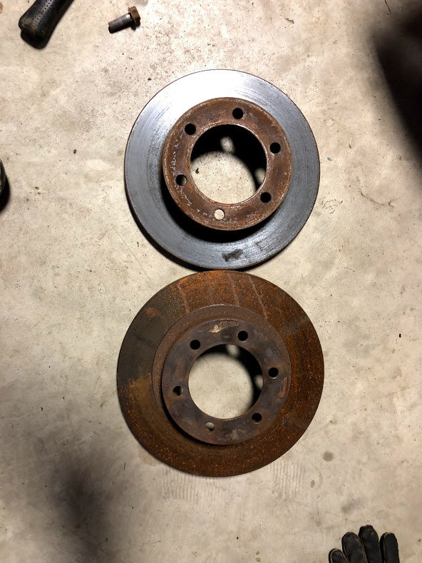

    Spent a little time in the shop yesterday and got the Tundra big brake kit installed. All parts are from my 05 Tundra. The size difference is impressive. This was a direct bolt in swap. I had to trim the backing plate 1/2' on the top side to clear the caliper. A 15" stock wheel will no longer fit, but im running 2" spacers and will eventually run some 17" FJC steelies and 35s.

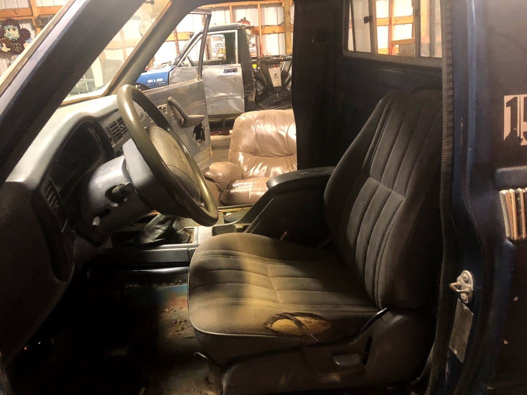

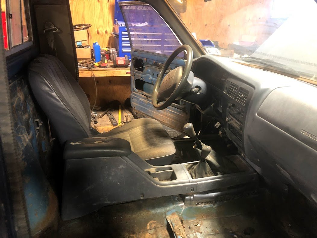

    Worked on the interior some last night. I cut out the mounts for the shift boots and welded it in to the first gen cab. I will seam seal it later. Also started on mounting the taco buckets. I cut off the rear mount that bolted to the tunnel and will weld on a new one so it bolts to the floor. They fit nice for the most part.
    ra-S3QcgOqNiu_6c2402wdgt5B6pjn5DA_M3S2pe_7bb209a75018df250ccd84a399fbd4542baa9774.jpg
    F3uhZxD3KVYSx5-s7OexaBphvrE2ujK3HxxR7thc_fffdcd1f3cb8268d66c2b727d895829d49f40b50.jpg

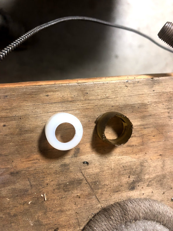

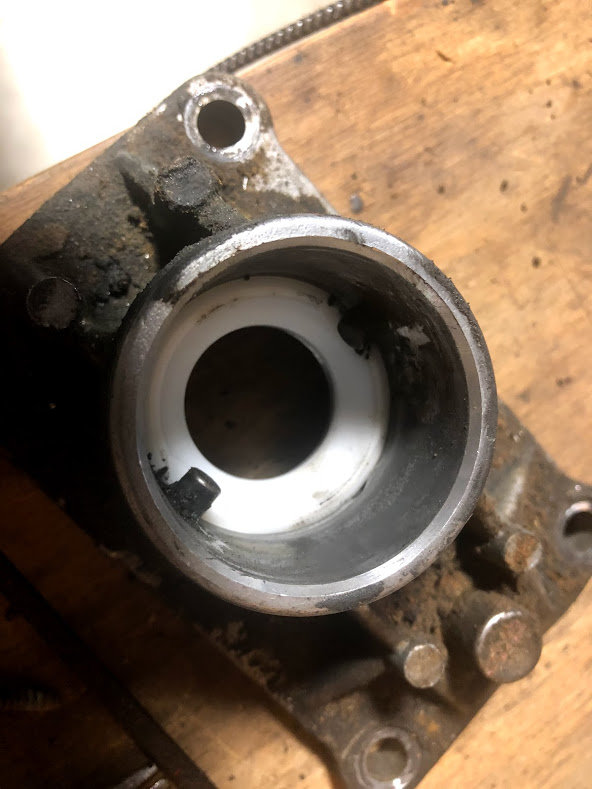

    Before i installed the boots and console surround i fixed the whored out shifter. The seat was nowhere to be found. Previously, it was hard to even find reverse because of the slop. This Marlin Crawler part fixed it. $25 from them.
    5Ni5uOArs6urHFnLn1UXkk6rPl538Q_6qxRfjzxU_d3b8fb64952220ecbb44804f178ed1ae2443ec9a.jpg
    cg2yTACaWu1Xx3ffv0FtyFZfNu30VVF5hpCbWEzo_5ac76c177fd9e8950cef552dd9e0f9018f5ec075.jpg
    Its coming along. Im going to order a Napa reman's rack and pinion with new TREs and bushing mounts. But before that, im going to test drive this pile this weekend hopefully.

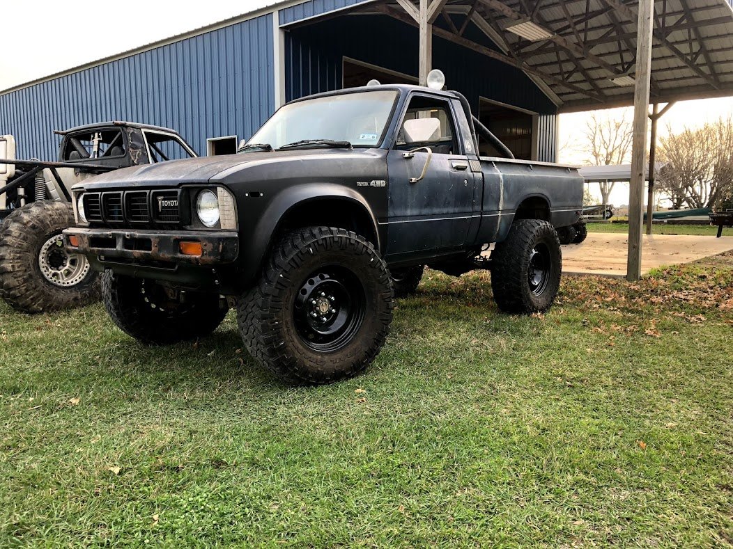

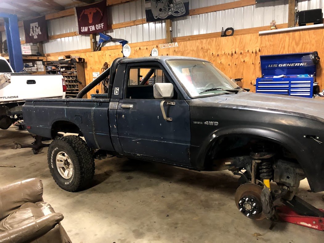

    I swapped in some 1" spacers (instead of 2") up front and did some slight fender trimming to clear the 35s. Overall the look is better. I finish welded the bed and drove it for the first time. Turns out the rear end doesnt have any gear oil in it. Thankfully it was only a short distance. Steering is fucked. Bushings are out and is quite scary to drive at speed. It also leaks badly. Im going to order a reman'd one today from Napa.
    Wheels are FJC steelies and tires are 35x12.5r17 Nitto Trail Grapplers in $100 condition.
